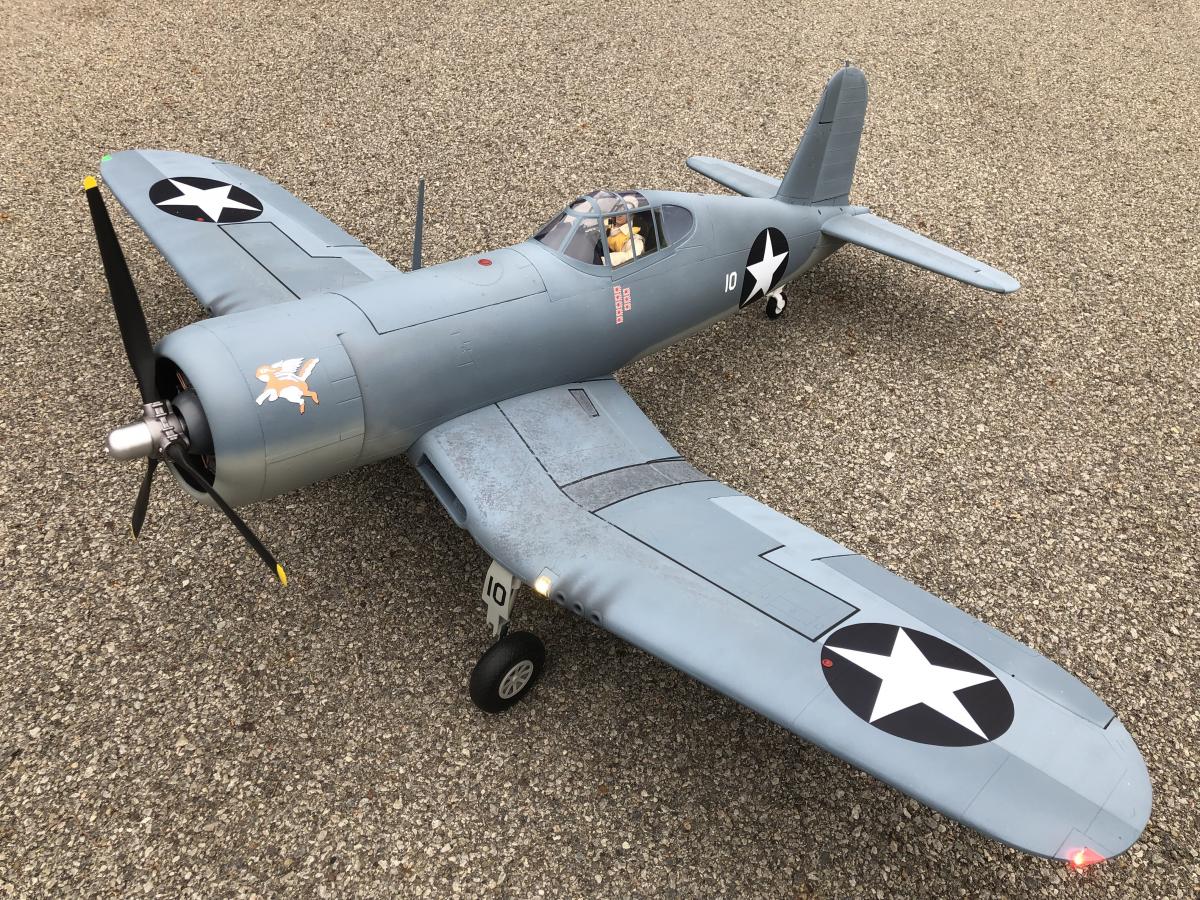

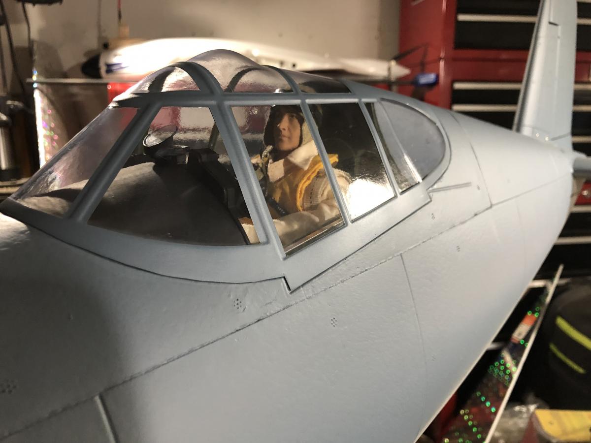

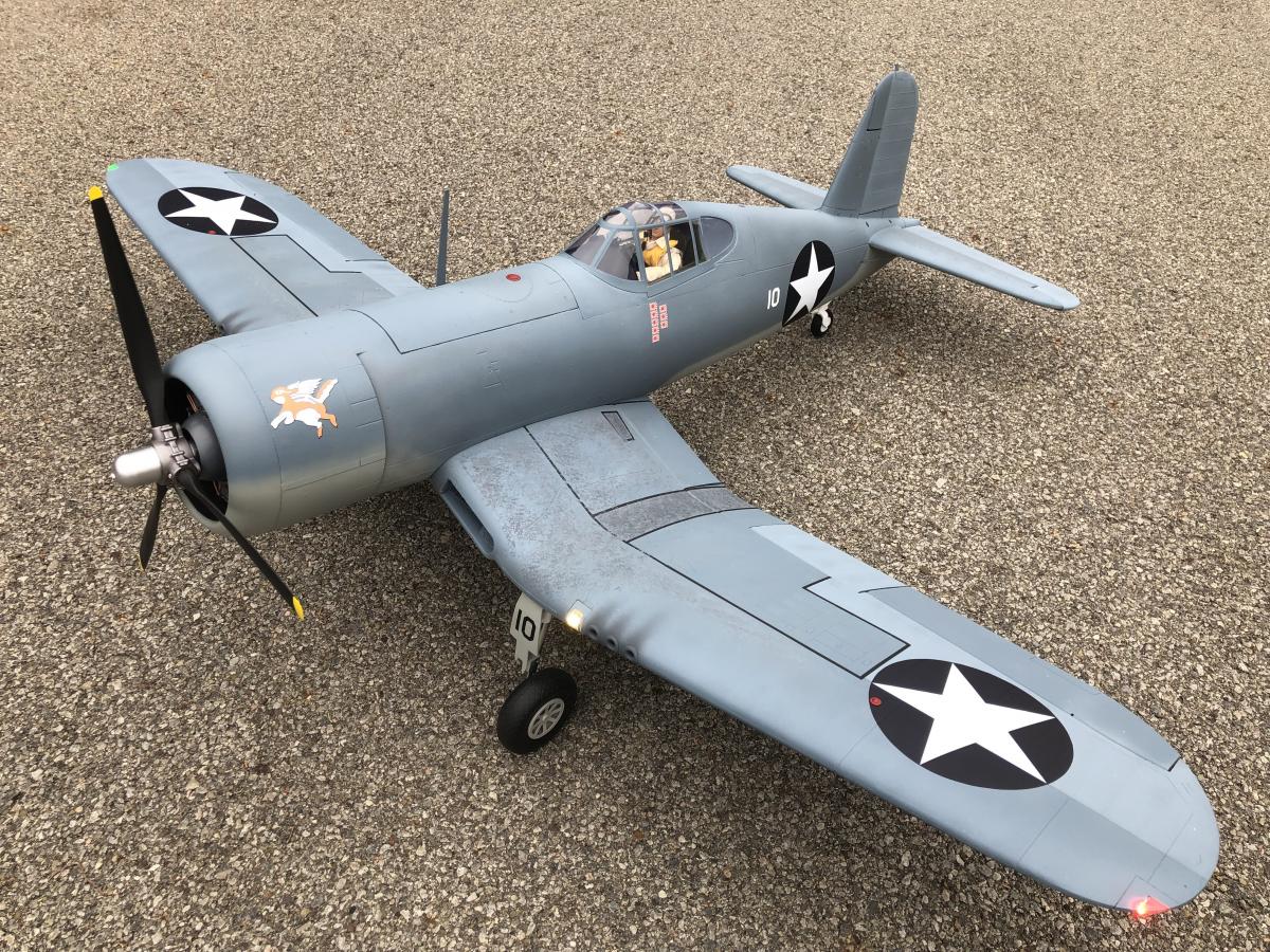

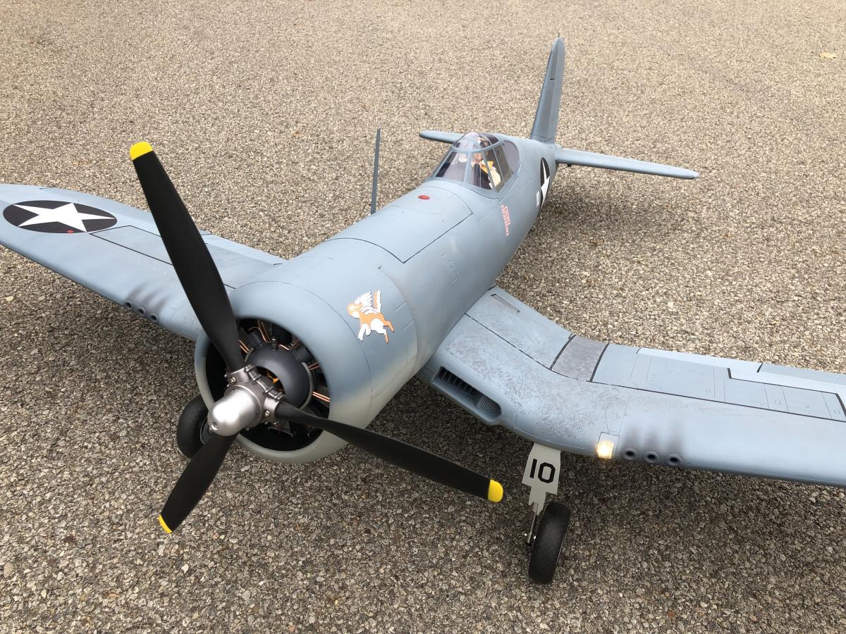

                • I’m nearing completion of Gus’s Gopher. Special thanks to “LB” as without his initial input and 3DP cockpit, this would be just another plain Jane warbird of mine!:Cool:Thanks LB!
                  3 3/4 inch Robart tires, 3DP cockpit, Warbird Pilot, canopy repaint, engine mods, gun port mods, fuel caps with pull for main tank battery access, Callie Graphics... a bit more weathering and such as time permits but it’s 90% and airworthy now.
                  Click image for larger version  Name:	1CDD1E80-6C4D-420A-A2FC-2A9E05B4F003.jpeg Views:	0 Size:	77.8 KB ID:	182677Click image for larger version  Name:	7C2D4019-927A-4DD9-8652-2CD9431A2E84.jpeg Views:	0 Size:	56.2 KB ID:	182678Click image for larger version  Name:	336F420B-7F75-4114-A216-A2DBEC6C9165.jpeg Views:	0 Size:	83.9 KB ID:	182676Click image for larger version  Name:	44330C76-7957-4A1A-8730-CD9020180E96.jpeg Views:	0 Size:	96.8 KB ID:	182679Click image for larger version  Name:	E95CD8FF-986F-45AC-8481-25121823365B.jpeg Views:	0 Size:	89.8 KB ID:	182680Click image for larger version  Name:	D2AA072A-E2C8-4B77-9420-17EC813E4891.jpeg Views:	0 Size:	376.9 KB ID:	182687Click image for larger version  Name:	FC606070-8991-4A1C-95A4-966CA5344B92.jpeg Views:	0 Size:	282.8 KB ID:	182681Click image for larger version  Name:	96363094-4053-4960-9234-53264D189D62.jpeg Views:	0 Size:	298.8 KB ID:	182682Click image for larger version  Name:	D352EEE3-22E9-460E-9157-E2BC048A9657.jpeg Views:	0 Size:	331.2 KB ID:	182683Click image for larger version  Name:	454FB22E-F033-46EF-9431-C34207165E1F.jpeg Views:	0 Size:	378.2 KB ID:	182684Click image for larger version  Name:	7EAB1B90-8F32-4A2C-AA55-BA7FCCA8F41A.jpeg Views:	0 Size:	371.2 KB ID:	182685Click image for larger version  Name:	F73B8C35-C3A6-4B16-B875-3EE920CE9768.jpeg Views:	0 Size:	363.4 KB ID:	182686Click image for larger version  Name:	3279D908-F2F4-49EA-ABF0-E88202F1D357.jpeg Views:	0 Size:	356.8 KB ID:	182688
                  • [QUOTE=Ole-Timer;n182675]I’m nearing completion of Gus’s Gopher. Special thanks to “LB” as without his initial input and 3DP cockpit, this would be just another plain Jane warbird of mine!:Cool:Thanks LB! 3 3/4 inch Robart tires, 3DP cockpit, Warbird Pilot, canopy repaint, engine mods, gun port mods, fuel caps with pull for main tank battery access, Callie Graphics... a bit more weathering and such as time permits but it’s 90% and airworthy now.[Quote]
                    O-T, WOW! She's Outstanding, Sir. Love the subtleness and the 'mottled' areas (Salt Technique?). Though no thanks necessary as I just like what you do. Bravo Zulu. Best, LB

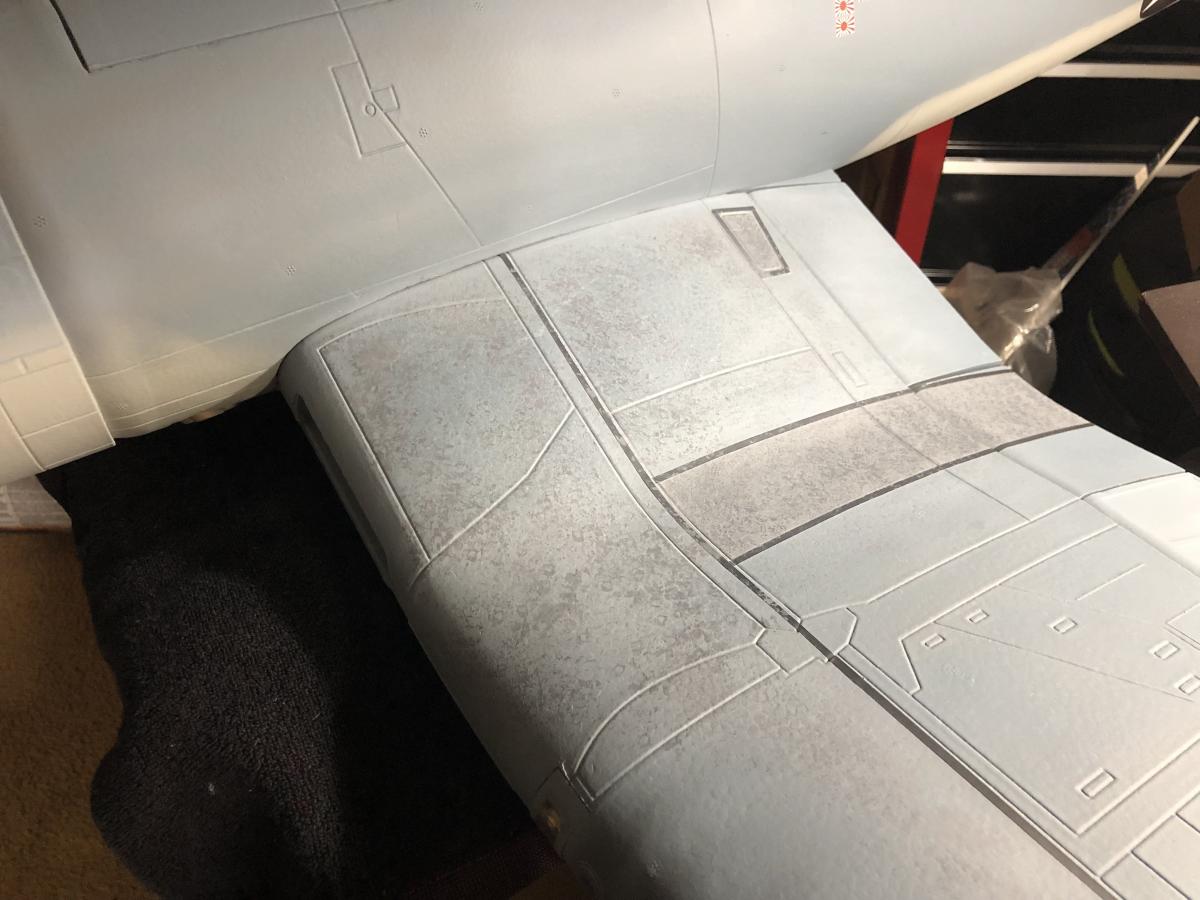

                    • Even Corsairs that remained stateside suffered countless oily boot scuff marks to the inboard wings from maintenance crews.

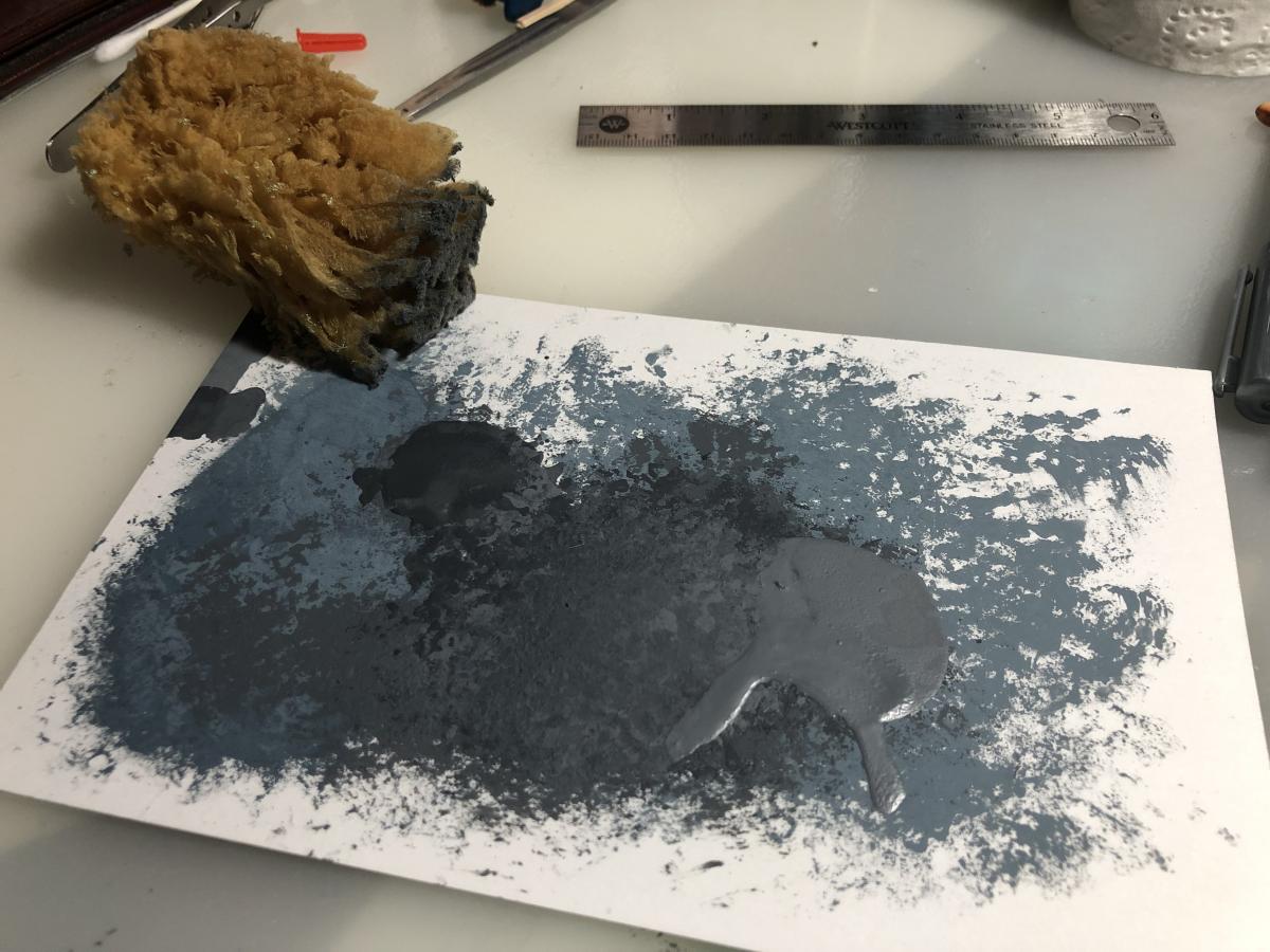

                      I used an old sea sponge from the craft store and a pallet of grey’s to daub that on. Best thing I could think of :Confused:
                      There’s a lot of fading different hue’s of blue n grey in this model to simulate sun fade all over it.
                      I’m ready to do some dry brushing here n there to help blend some areas and add a bit more tones.
                      After that some baby powder coral dust !

                      • Great work OT! Really like the subtle areas and the scuff marks is a unique and nice touch.

                            • OT:
                              Very nice! And I noticed that the foot step in the starboard flap is gone! Excellent detail. ;)
                              • Ole-timer
                                I really like that idea, where did you get the powder? Is it dry, wet or both?
                                Ken
                                • The mottled area that simulates foot scuffing was done with Model Master enamel paint. When you use a technique like this you are able to achieve a variety of texture, from nothing to rough. If you want a textured surface go heavy on the paint, but in this case I did the opposite, picked up a small load of paint on the sponge then work it over the pallet to achieve the correct color and work most of the paint off so when the sponge goes to the wing it’s barely wet and doesn’t build up a textured surface, just adds a thin coat of color. With a little practice it’s very easy to do.
                                  Yes, I’d filled in the flap hole with foam board and some 222 lite. That was a big enough boo boo it had to go.

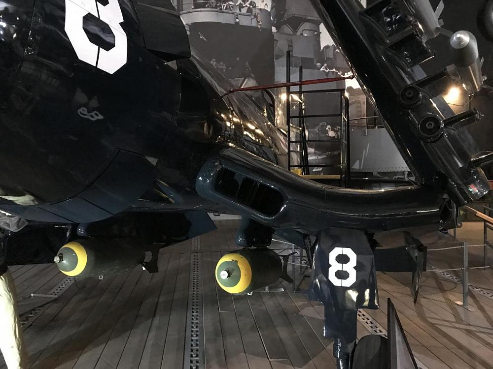

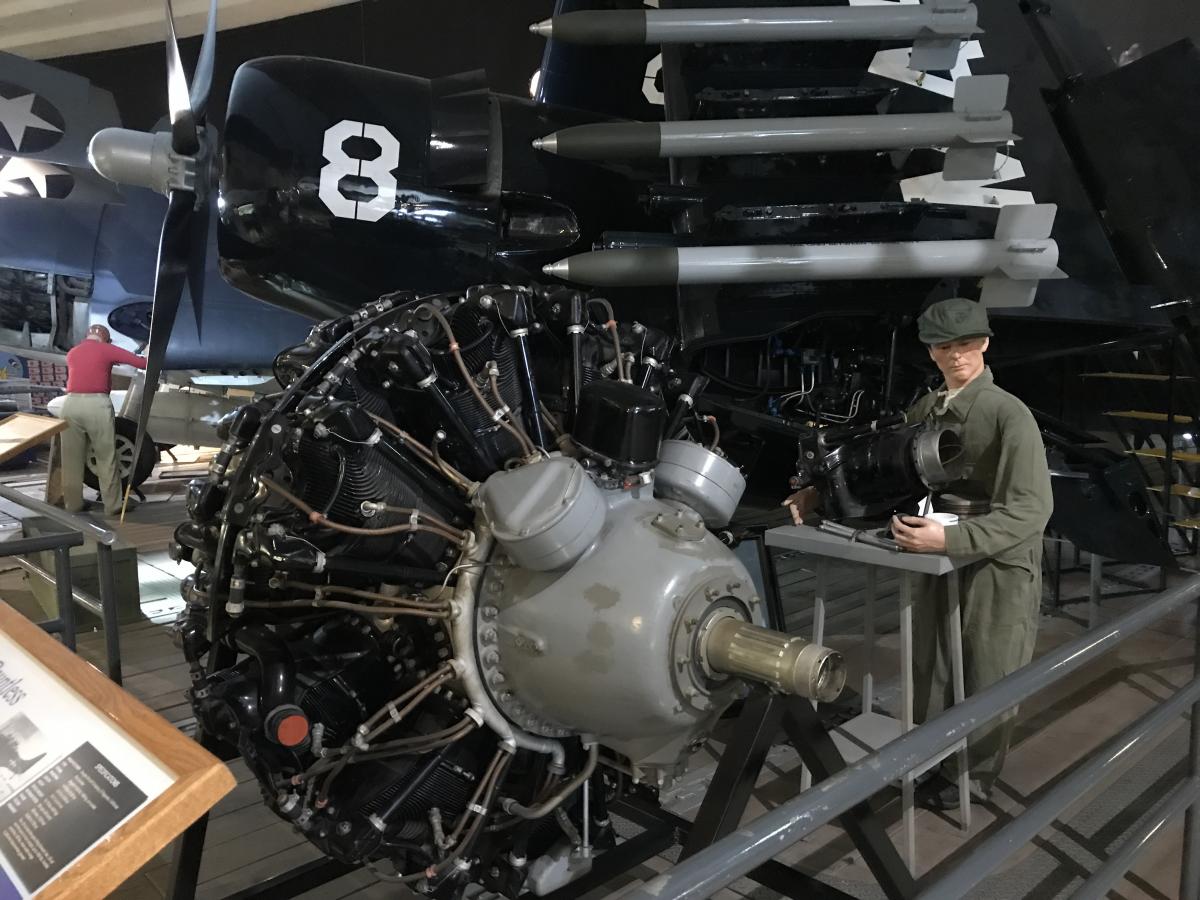

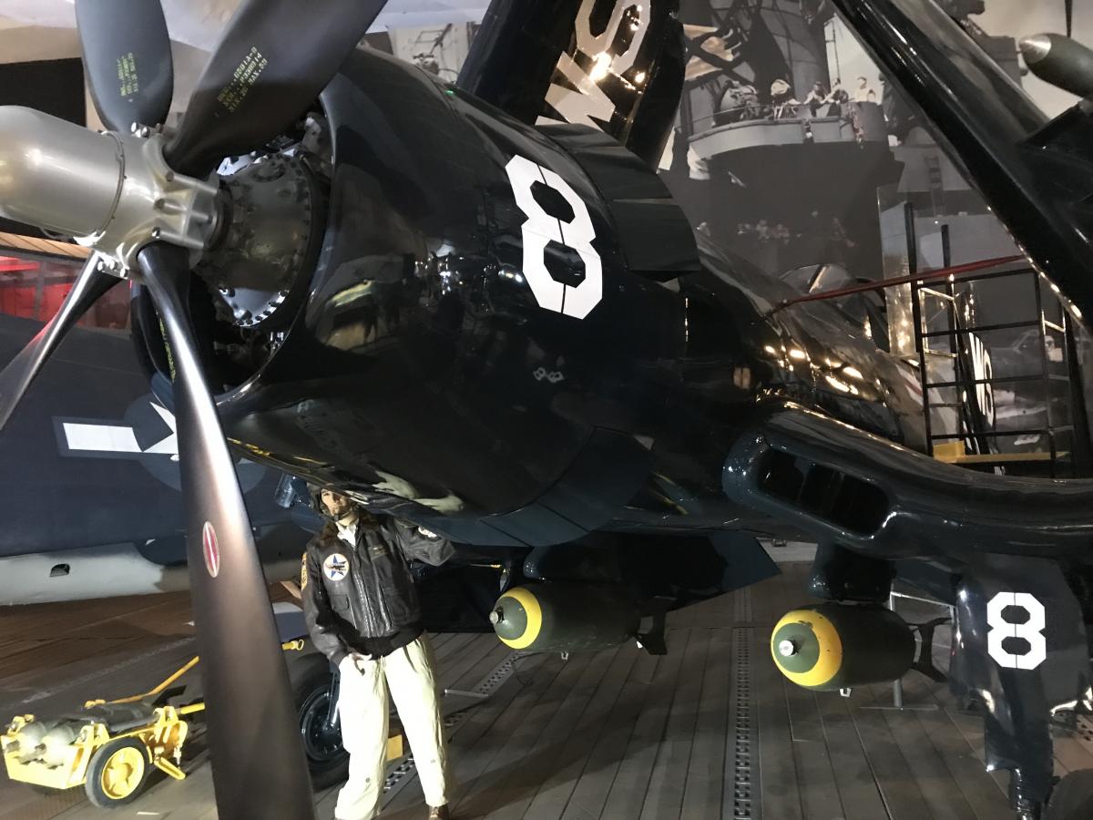

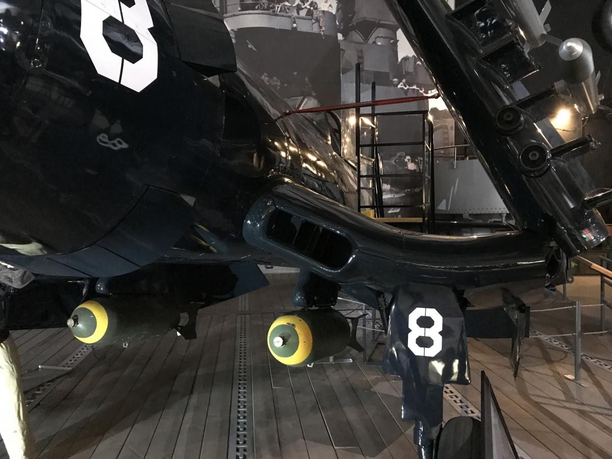

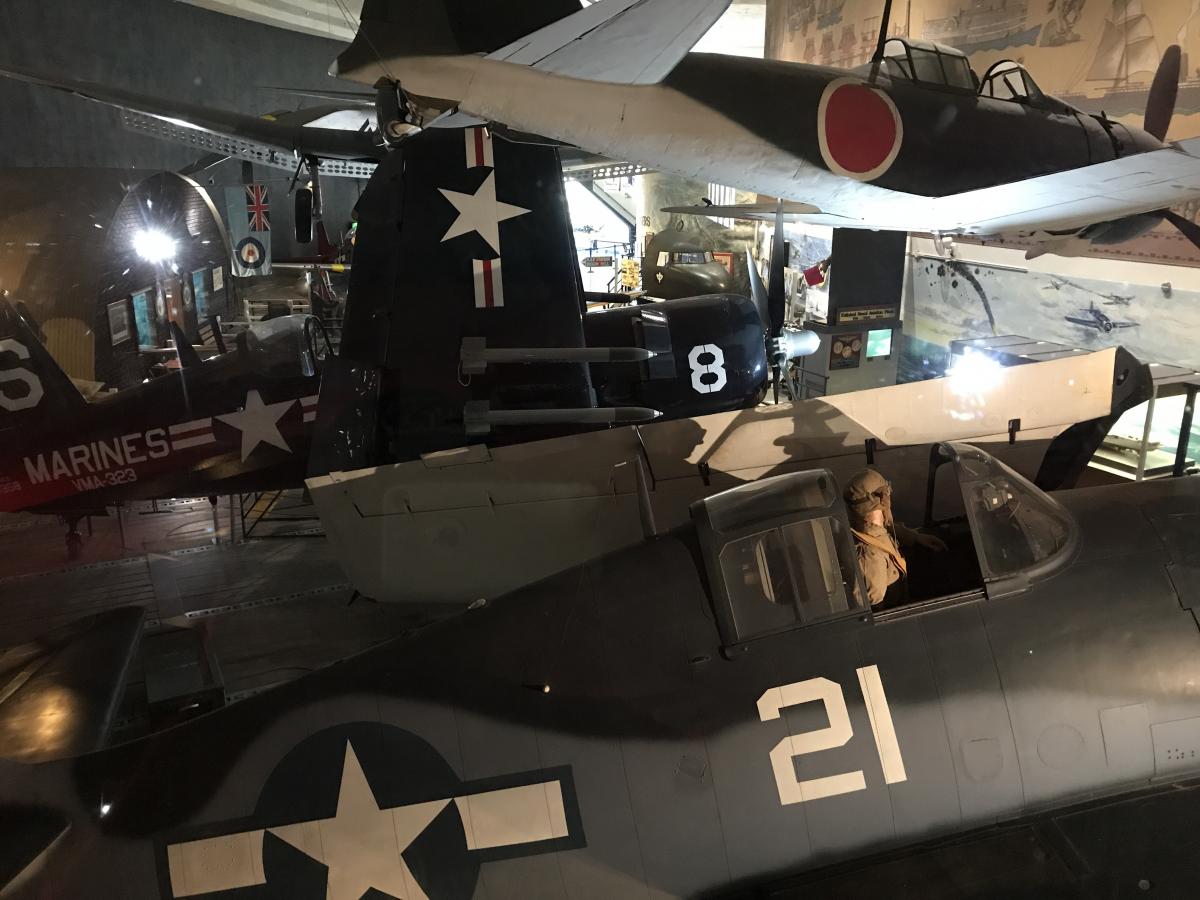

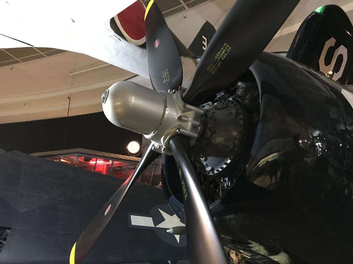

                                    • Hi Guys
                                      I found some scale detail photos that I took a couple of years ago at the San Diego air museum .. Hope you like the shots
ID:	182753Click image for larger version
ID:	182754Click image for larger version
ID:	182755Click image for larger version
ID:	182756Click image for larger version
                                      Rich
                                      • Originally posted by Ole-Timer View Post
                                        From the start I wanted to keep the mottled paint as thin as possible, primarily so I didn’t create lumps of paint on the wing. Keeping the paint thin also allowed me to sand the area with a piece of used 240 sandpaper. I did sand in the direction that feet would normally be clamoring around the wing at, envisioning coral encrusted boots at work. I was surprised at how little sanding was necessary to remove much of the harsh detail and blend the area into a more realistic appearance. I just dove into this pool headfirst but for some of you detail diehards out there, a little practice on an old wrecked piece should get you going on something really keen.
                                        Before sanding
                                        After sanding
