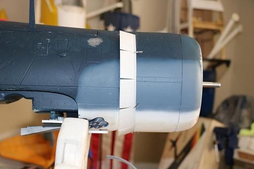

                • some pics of my corsair,
                  • Originally posted by coyote137 View Post
                    C1, She is a beautiful thing. Great weathering work, too. Bravo Zulu, Sir. Best, LB
