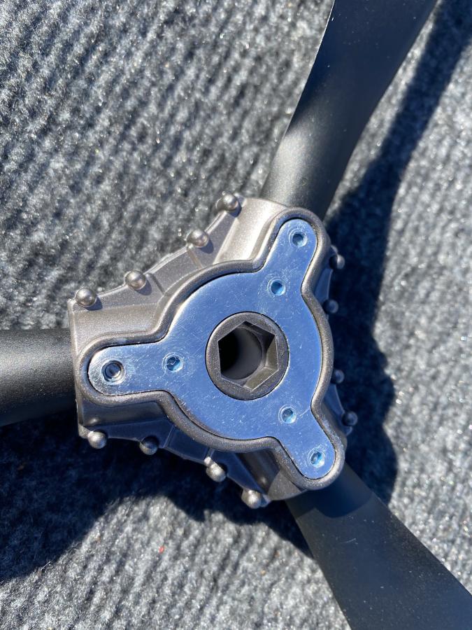

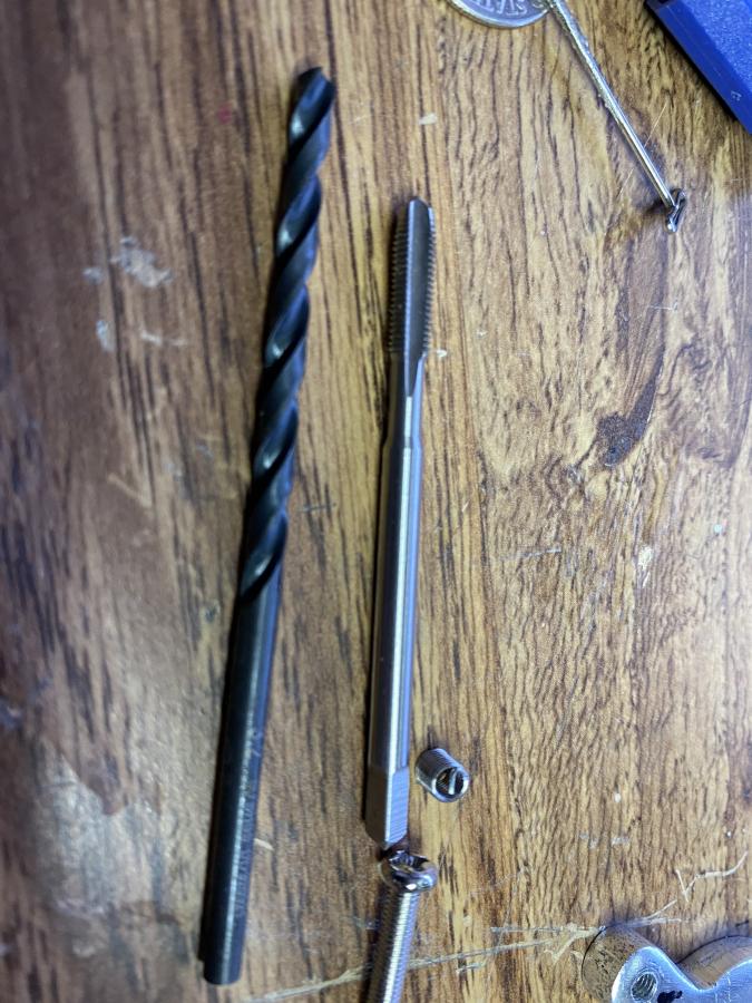

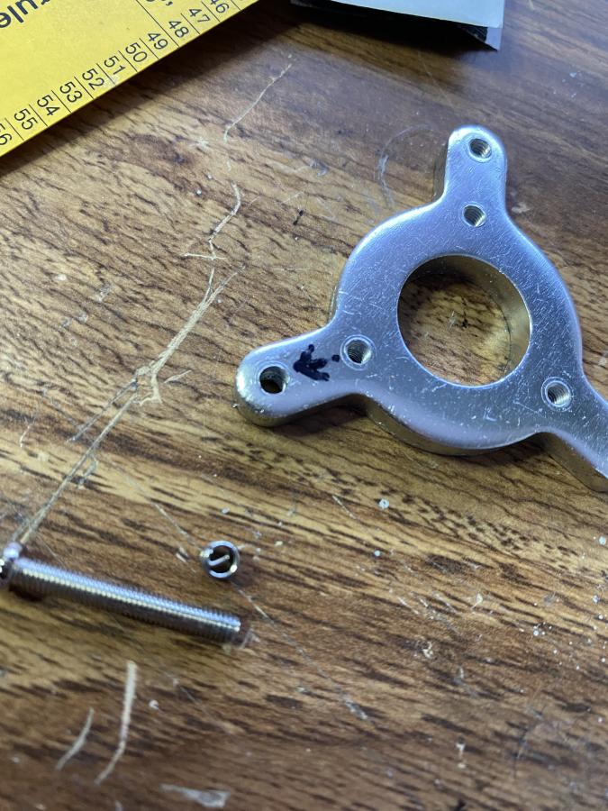

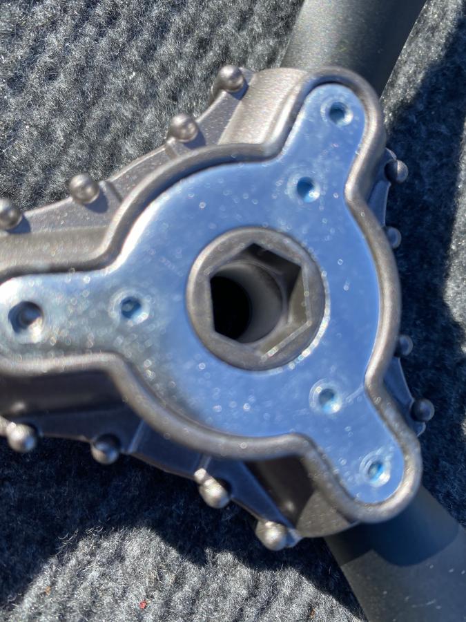

                                    hey Xviper
                                    i haven’t been on the thread for awhile and just in case someone else has trouble with the prop hub screws being stripped.
                                    I was able to fix Rob’s assembly by drilling it out and inserting a 3mm heli-coil. These can be purchased on Amazon
                                    Click image for larger version  Name:	269E819A-313E-48E7-BCD6-3F2AC675F691.jpeg Views:	0 Size:	118.7 KB ID:	289671
                                    Rich
                                      • 8831
                                      #4039
                                      Rich, very nice. I didn't even know they made heli-coils that small. I know them from my car wrenching days.
                                      • RichJ53
                                        • Nov 2018
                                        • 342
                                        • Southern Oregon
                                        #4040
                                        I didn’t either :). I had a Turbine jet with a stripped screw and started researching the possibilities of fixing it. Amazon had many kits with small metric sizes.
                                        the rest is history
                                        anyway this saved the Corsair prop hub in this case
