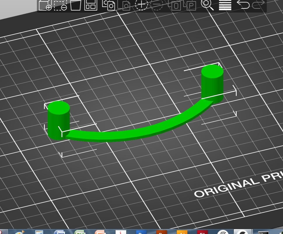

                  Hey Guys and Dolls,
                  Had to add all the OEM Weights to my Bubble Top Corsair and literally had no filament tape.
                  I designed and printed a quick fix some of you might find useful.
                  Attached are photos and the STL file.
                  I used a "dab" of E6000 glue on each weight and the 2 outside posts of the bar.
                  Happy Labor Day, btw.
                  Best, LB

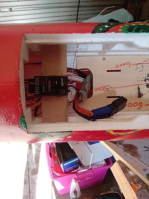

                                  Hey Gang,
                                  Question about RX antenna placement.
                                  I fly Futaba R2008SB Rx's with duel antennae.
                                  I have not had a problem with antenna placement with any other airframe, but due to the abundance of extras I have a great deal of wiring, servos, and whatnot with very limited free space to run the antennae at 90o to one another.
                                  My solution is to split the leads one going one way and down to the fuselage bottom (all good) though the other will run across the fuselage width opposite the Rx body by some length.
                                  By doing that, the antennae ends are now 6" plus apart, but running at 90o.
                                  The question: Is this acceptable radio reception procedure, am I good to run these leads this way?
                                  Any assist is immensely appreciated.
                                  Best, LB

                                    #6037
                                    Hi lb hope u r well.. my 2 cents worth, with my minimal years, take it with a grain of salt.... i have used dynam (detrum) radio since day dot.. never had signal loss.... the rx has 2 wires good length.. only use 1 rx (sr86) gyro 8 chanel.. always have (consistancy).. anyway b4 i saw people doing the 90 dgree thing i always did 180 dgree.. left side right side,, but small hole in foam to expose the wire.. most wont want holes and visual eyesores, i get that.. but works 4 me.. point dont no if they need to b 90.... that may or maynot make it easier 4 u.. and as u no i have an f4 that i LOVE ,,and i upgrded to spectrum.. its a single wire ar631 gyro as3x etc. Dx7 buts its also exposed at the top ... dont if any of this helps.. but hope it does,, b safe and heres couple pics Click image for larger version

                                      Thanks f4u ausie,
                                      I have always poked a bit of the antenna out of the fuselage, homage to my early RC days of the 'long' antennae.
                                      I have not had an issue ever before but I had always gone by the diagrams in my Futaba Owners Manual.
                                      Not going to sweat it, but will do all the range checks, twice.
                                      Thanks again, Brother.
                                      Best, LB
