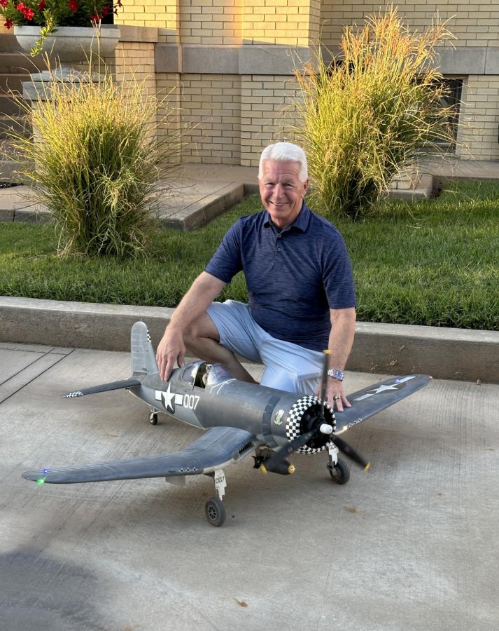

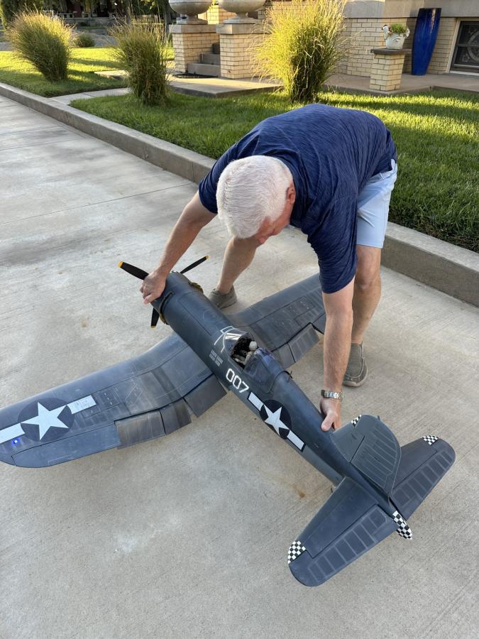

                            Hey y'all,
                            Taxi test done, needed about a 1/4" of right rudder trim to straighten the tail wheel.
                            Adjusted the tail wheel steering linkage and all is well.
                            Tamms took some vid and pics of a 'proud papa'.
                            With some luck, first check flight nearer the end of the week, as lawn maintenance, fall chores, and higher winds than I like are imminent for a few days.
                            Best, LB
                            Click image for larger version  Name:	Corsair and Steve Sept 2024.jpg Views:	10 Size:	109.5 KB ID:	411209 Click image for larger version  Name:	Stevie_Corsair_Sept_2204.jpg Views:	8 Size:	133.2 KB ID:	411210

                              Elbee,
                              Getting closer and closer to test flight day. Corsair looks really great in the sunshine. We both have the same color of hair LOL

                              #6057
                              Yes 1 heck of a smile. The smile on your face is big too,,, looks stunning:stuck_out_tongue:
