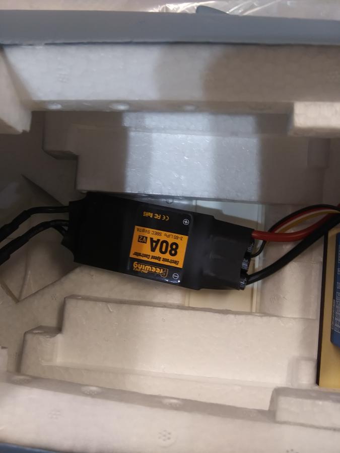

                        So, opened the box and checked everything out, wow the foam just gets better and better on these models. The only thing I noticed was when I removed the battery hatch cover, the battery tray and mount were not attached to the fuse. They were screwed together, but not glued in place.
ID:	413442 Click image for larger version
                        As you can see, there is not glue residue on the foam but there's a fair amount of glue on the wooden attachments. Looks like it was never put in place. No big deal, had some of the "White Tube" glue that came with the Avanti (?) so ladled it on and put the unit in place.
                        So like WOW, it's big, I have a spare Spitfire prop assembly and compared the blades, the Corsairs are a fair amount longer.

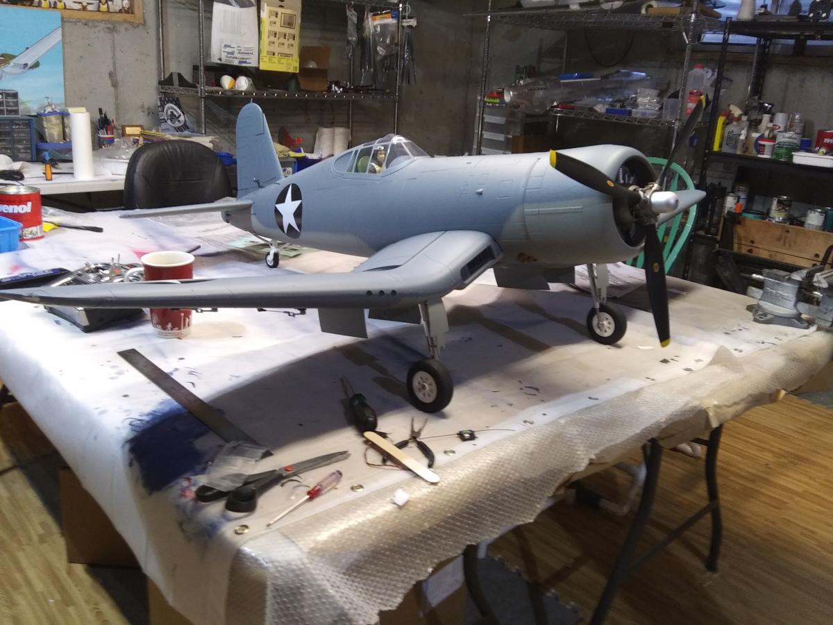

                                So basically she's assembled now. Had a bit of wrinkling on the portside wing tip but no biggie. Added the two nose weights and putting one of the 4500 Admirals all the way forward the CG looks good, basically she's now the same as the two Spitfires, 4500s all the way forward and 5000s slightly back, perfect!
                                So what are you guys using for elevator throws. I've heard through Wes' videos that he's turned them down to 42% and ailerons to 85%. I realize everyone is a bit different but I'm thinking of setting my highs on 50 mids on 42 and lows on 40. Opinions??
                                BTW, the barn doors aka flaps are literally hanging way down. Got to get together with DaveGee and to some comparisons.
                                Here she is in all her glory. That prop is huge, compared to the Spitfire, each blade looks to be at least 3/4" bigger, so an increase of about 1-1/2" in diameter. Wow.
                                So, are the spare springs softer or harder than the installed strut springs? The stock tires are just short of a rock but not by much. Robarts!

                                  Lookin' good, Dan! I highly recommend the 3.5" Robarts in place of the stock tires. It's not as big a deal as it was replacing the stock tires on the E Flite 1.5m P-51D that in my opinion REALLY needed them, but the Corsair lands much better with them on.
                                  Have you thought about which aircraft you plan to represent with your model?
                                  davegee

                                      So basically she's assembled now.Grossman56
                                      G56, Looking Sah-Weet. Robarts are the way to go in my opinion. Helps with the spring rates, too. Full throws were a bloody nightmare for me on my first check flight, especially in roll. Pitch rate was too high as well. I did not tune in any Expo, however. Best, LB
