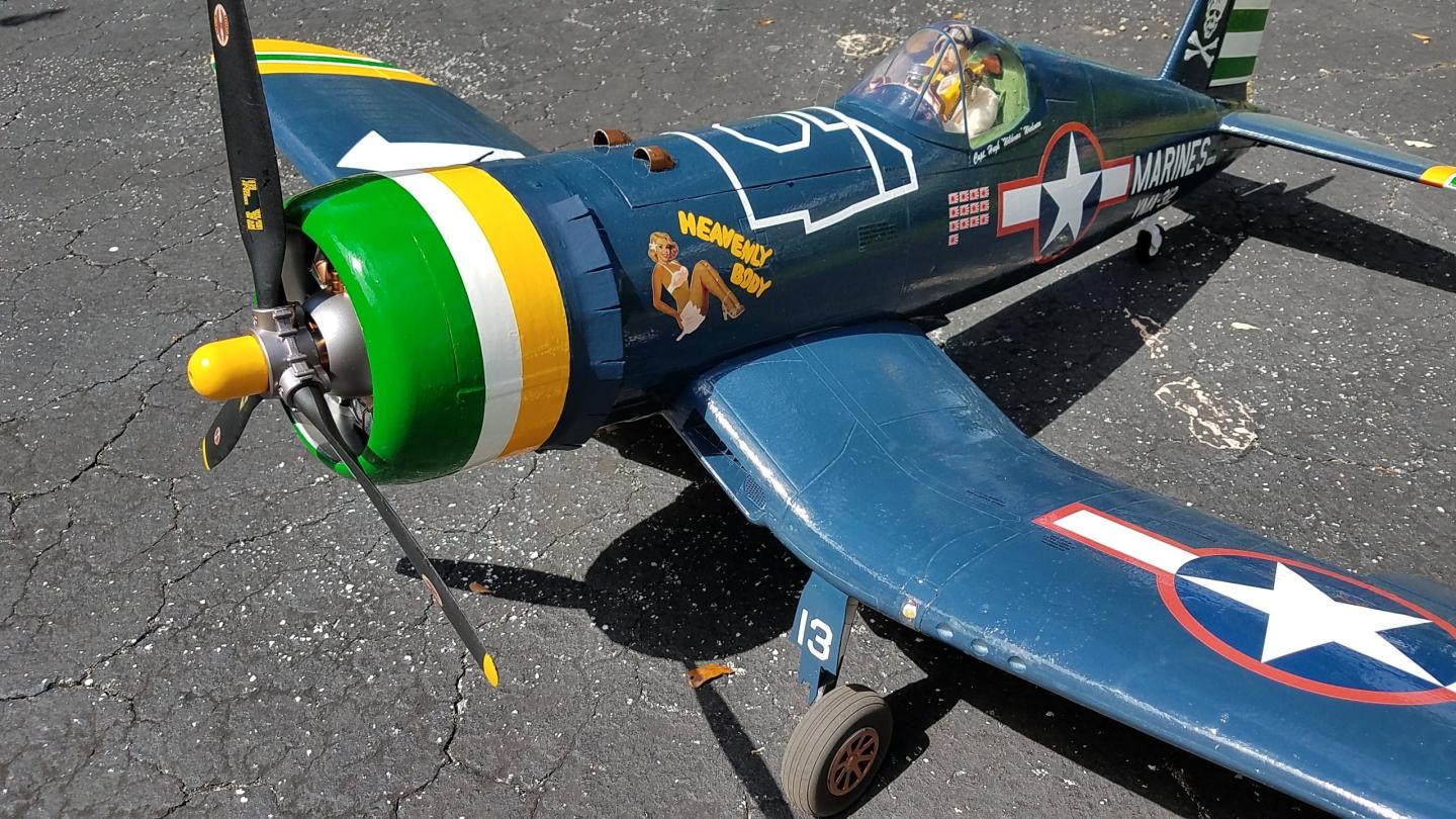

    Haven't been able to fly for over a month due to crazy windy/rainy weather, including a couple hurricanes, so I've been spending time on other important duties (although what could be more important that RC building/flying ). Finally going out tomorrow with a couple of my regular buddies as the winds are finally at or below 10mph. Now if I can just steal my CO's Apprentice so I can "re-learn" how to fly, I'll be good! Is it "push forward" to go up, or will that result in a lawn dart?
    Up, because you were inverted.

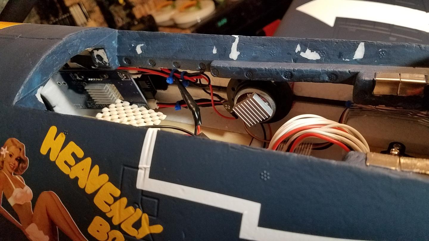

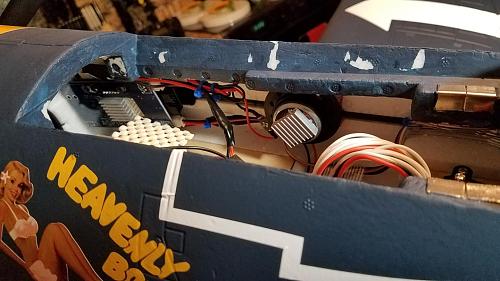

              I've got the Mr. RC Sound, Aspire board and 2 transducers. It sounds good. Recommend you also put heat sinks on the transducers, as the P&W Double Wasp selection creates the most heat. I also installed some copper 45 degree water line angles to act as hood scoops to bring cool air directly over the transducers. I've put those in 8 aircraft with the sound system, but you probably don't need them up north, as it gets brutally hot here in the summer and those transducers get so hot after 10 minutes it could melt electric wires, so be careful not to let any wires/battery cables come into contact while flying.
              Model Sounds also has a nice system from what I've heard for foam but never tried those. I do have their twin 4" speakers in a FW 190 and the sound is incredible, especially compared to these transducers, but the Corsair may not be large enough to get that system in without some major surgery and they are considerable heavier. They need open holes cut where the speakers are for the sound to get out.

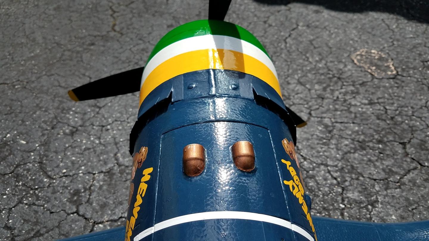

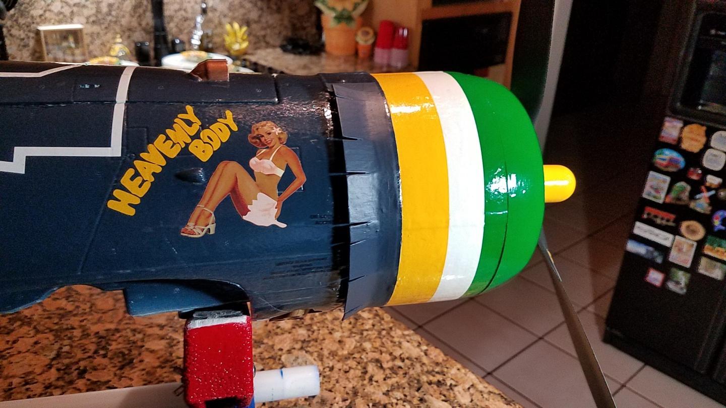

              Photos of the system location and the hood scoops:
ID:	361463Click image for larger version
ID:	361464Click image for larger version

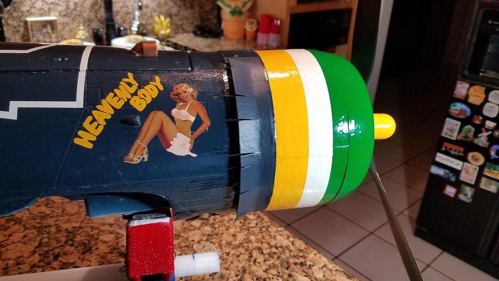

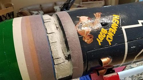

                              Rex, thank you for the compliment, I just build 'em how I see 'em which isn't always super scale, but I like it. The cowl flaps mount on a ring via an old guitar string of all things.
                              Hugh Wiedman used Evergreen Scale Model ABS sheet, I believe to do open cowl flaps.
                              As for 3D printing I would look at 3D printing services offered by Chris Wolfe aka TheRCGeek. His work is amazing. Check out his website sometime.
                              I could alter the Cowl Flap design to simply glue into the fuselage, but I couldn't post anything very soon. Let me know when you start your build after the Holidays and we'll see how I can assist.
                              I hear you about finishing long builds. Life has put me in the 'start/stop then start/stop then..." over the last year and it gets difficult to stay focused on completion of even the smallest things.

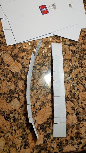

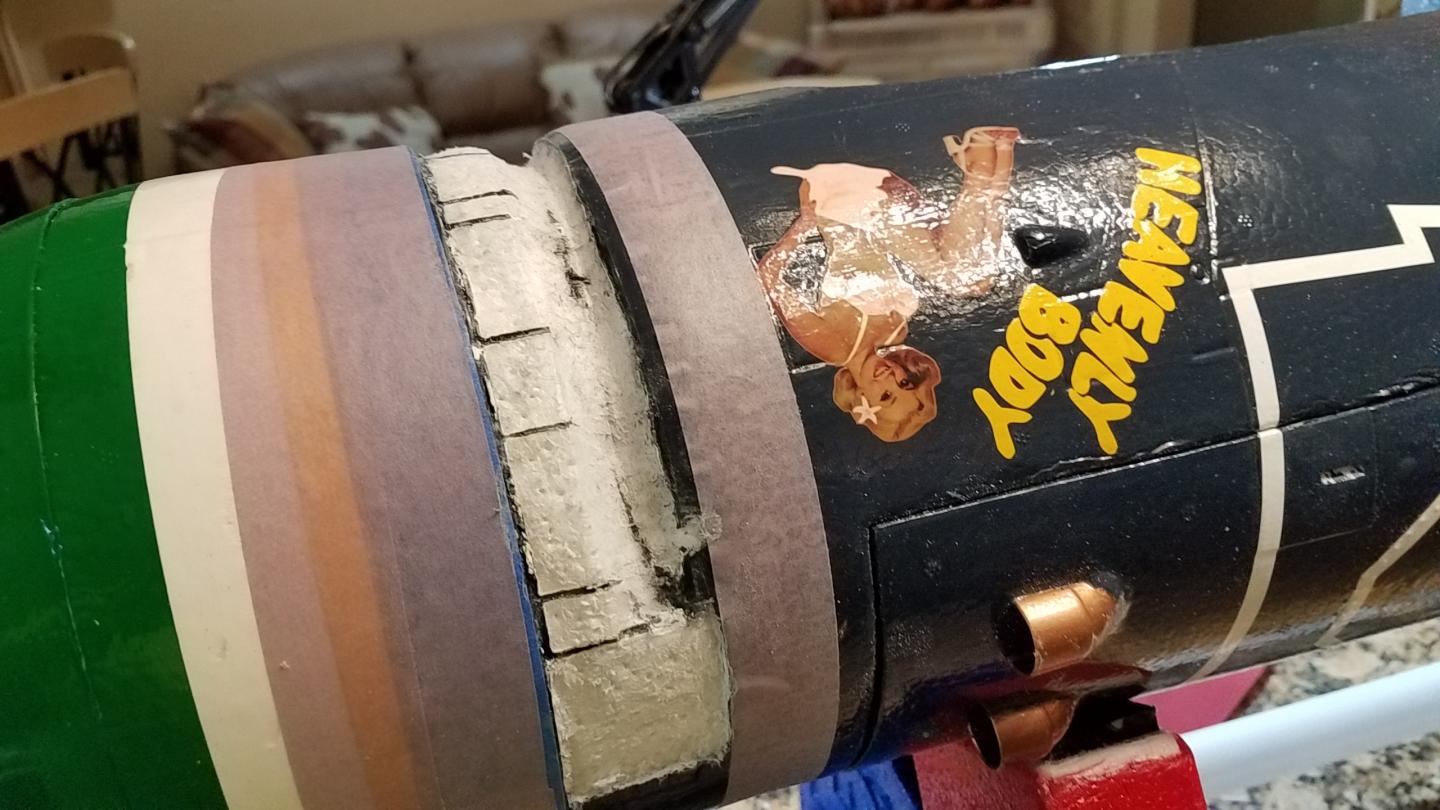

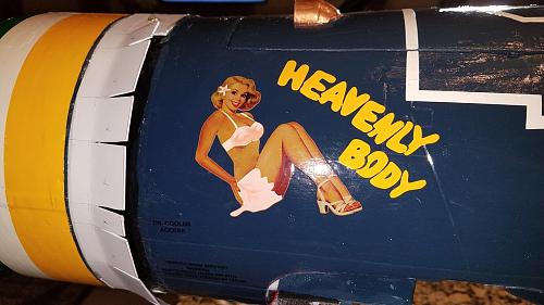

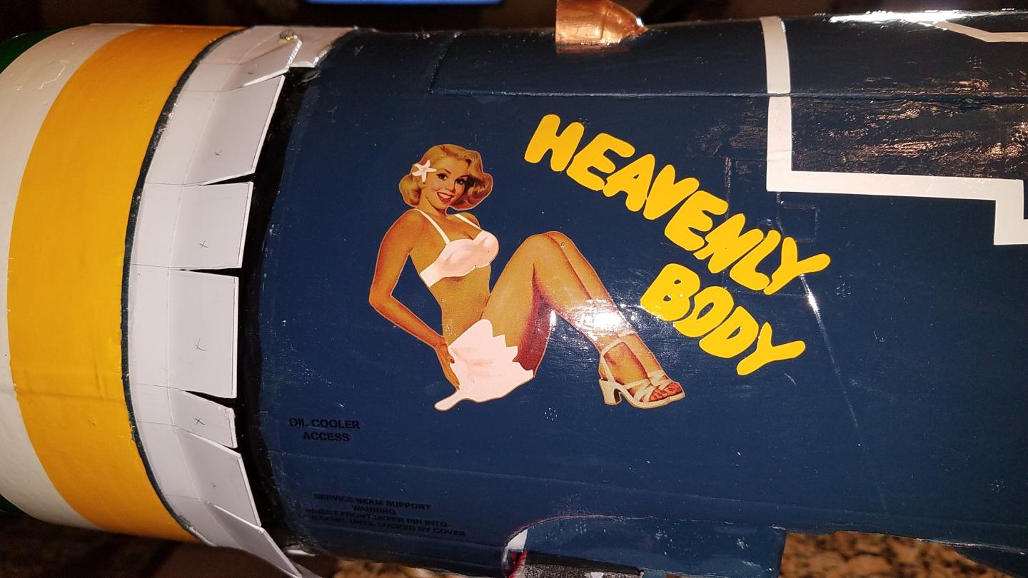

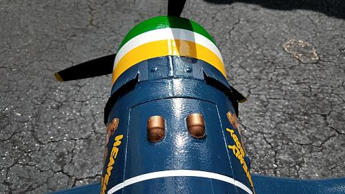

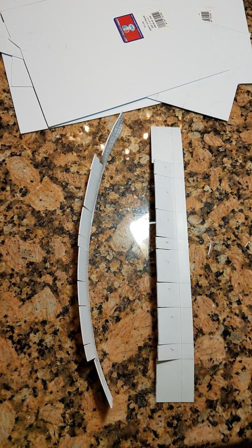

                                      Regarding the cowl flaps, I used the .060 Polystyrene from Mid West Products (available from HH also in .040 thickness), then just cut into the foam to "inlay" the two pieces in. It wasn't until I glued the pieces in and painted them to match the fuselage that I came to the conclusion that I should have made them just a bit longer (front to back) so they would stick out more, but too late to change them. A rather crude solution, no where near the LB Operating flaps, but better than nuttin!
                                      Click image for larger version  Name:	20200225_142348.jpg Views:	0 Size:	94.2 KB ID:	361866Click image for larger version  Name:	20200225_154010.jpg Views:	0 Size:	144.2 KB ID:	361867Click image for larger version  Name:	20200226_214417.jpg Views:	0 Size:	133.8 KB ID:	361868Click image for larger version  Name:	20200229_191640.jpg Views:	0 Size:	158.0 KB ID:	361869
