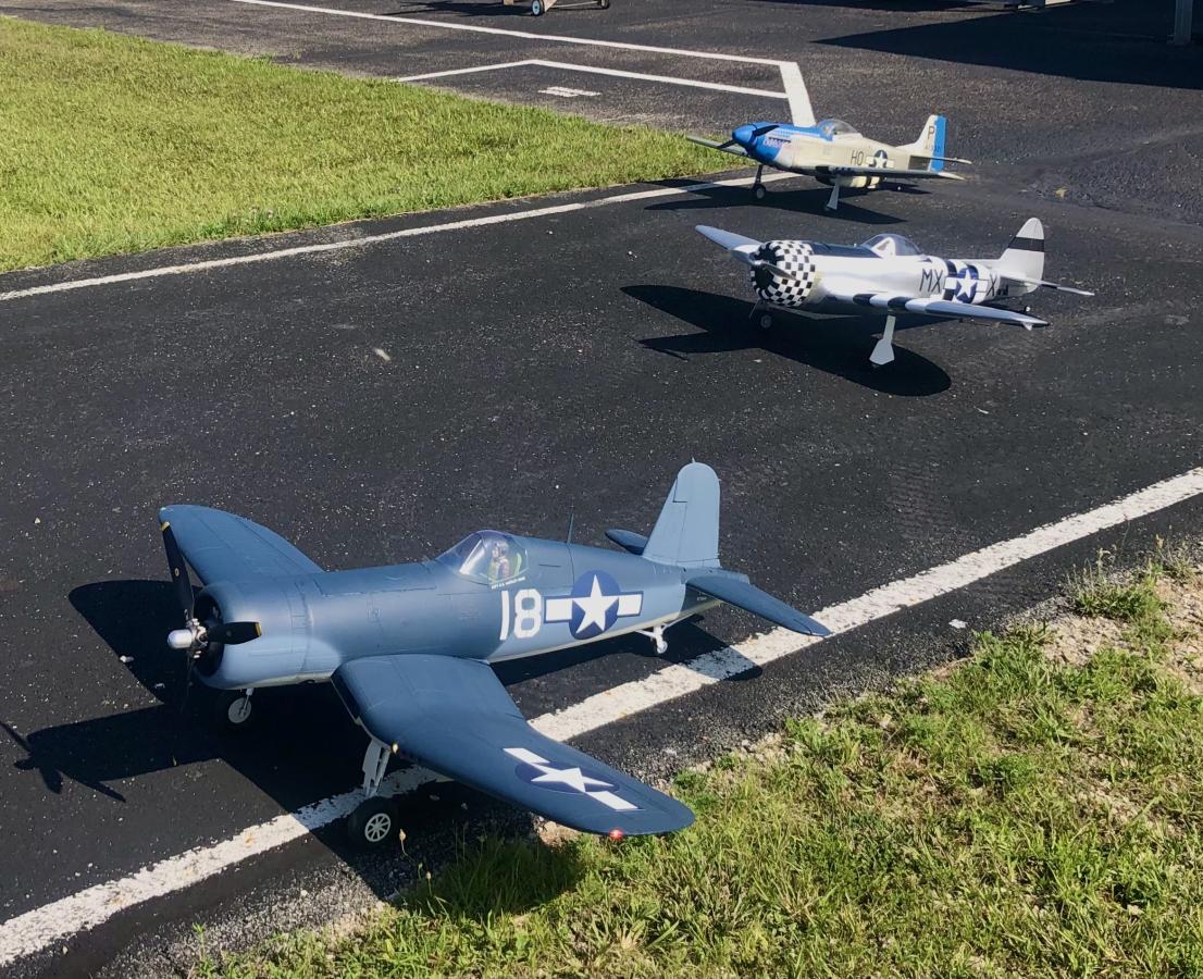

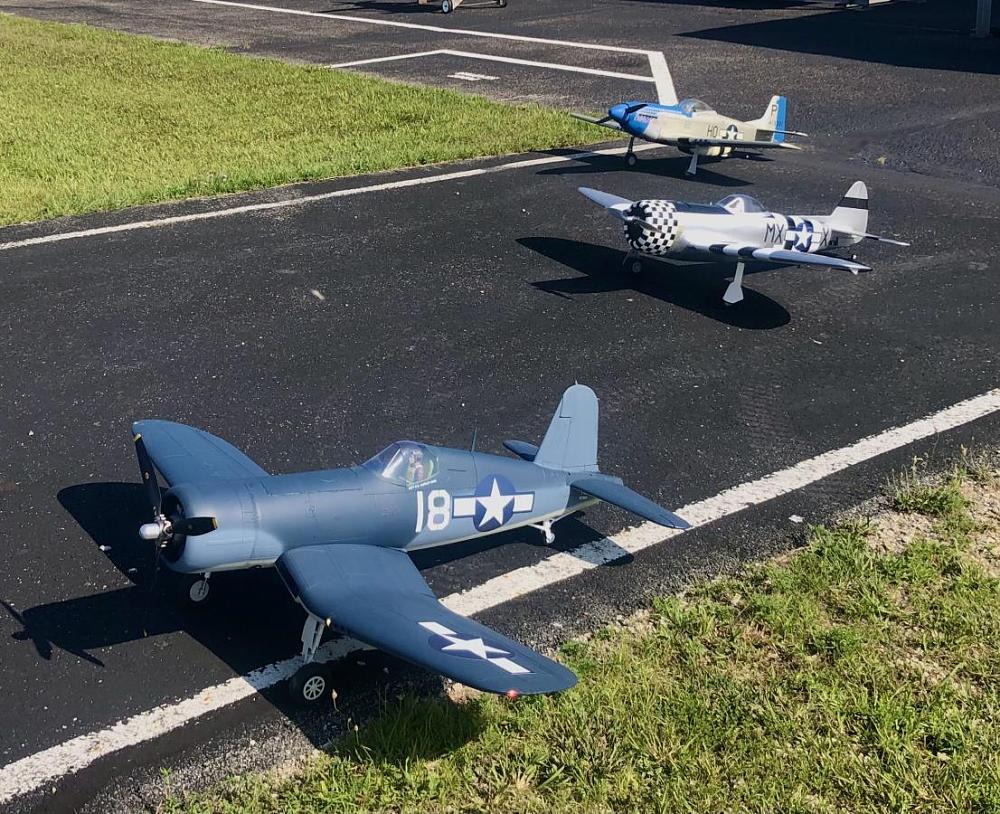

        • Elbee, enjoyed reading your progress reports just now. What a beauty that plane will be. Flew mine this morning with a few other club member’s warbirds. Click image for larger version

            E6. Thanks. Your Corsair is a beauty. I do have a question, which paints did you use and were those ANA (FS) matches? I know about different lighting and many times most photos are not completely color accurate, your tri-color looks good in your pictures. Best, LB

              Honestly, I went to Home Depot and matched the model’s original dark blue, and picked out the medium color and the grey from a chart. Guess I got lucky!

                I believe ya. I did similarly when I began this project, I then found the Mig Ammo ANA set. I had gotten pretty close, too. In any event you did well. Best, Steve

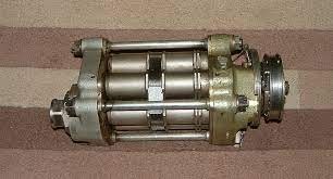

                  I think he's working on a miniature Coffman Cartridge Starter to fire up that bad boy like they did in the Pacific in WWII!🤣🤣

                  • Hugh Wiedman davegee Belching smoke and "Pop-Bang-kachuka-kachuka-whir" What great ideas. Best, LB

                      A good friend of mine's dad was a marine Corsair mechanic in the Solomons during WWII. The cartridge starter was standard operations for flying from those remote islands back then!
                      Yes, well said! "Pop-Bang-kachuka-kachuka-whir" is a good approximation! Plus, add copious amounts of black smoke, per Hugh!👍😁

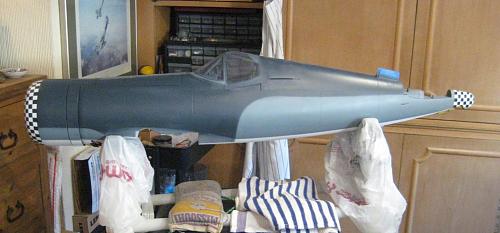

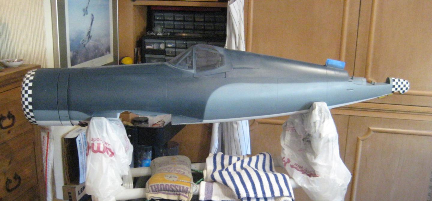

                      • Hey all, I airbrushed first layer of Sea Blue. This poor girl hasn't been this blue since last October. (Insert Smilies) I will add a 2nd layer in a day or so after a light wet sanding. The color is certainly not a weathered blue to start. In my picture, the airframe looks to have fairly fresh paint, but it is definitely weathered some. I suppose when the checkers and squadron logo was added, it might have gotten a freshening, don't know. Best, LB

                          Hi Elbee: just from looking at the picture, your colors "seem" to be about right. You know how deceiving a photo and light conditions can be, but I'm liking the colors you have on it. Carry On, my man!!👍
                          Question: to you and anyone else out there: Why did they paint the underneath of the outer wing panels the intermediate blue that you have as the lighter blue on your fuselage? I know the answer, maybe a lot of others do, too, not sure.

                            Dave,
                            1) The picture I posted shows the blues much lighter than actual. So, you might be correct, Sir.
                            2) I believe it was done to change the intensity and contrast of the white when the wings were folded up while the aircraft were stored on the deck of an aircraft carrier.
                            Lower visibility from the side angles and from the top downward.
                            Not that you can easily hide a carrier, but a reflection off the white to a recon aircraft or boat would be easier to see from further away, I am certain.
                            Reference photos I used for my F-18C are the same. The folded portion of the underwing is painted gray like the upper surfaces.
                            Best, Steve

                              You're right on the button! As you say, probably hard to hide an aircraft carrier, but I guess they figured at the time that when the wings are folded on the flight deck, that those areas would be less visible than had they been painted white. Of course, that beautiful color scheme (IMHO) didn't fare well in the extreme conditions of the South Pacific, so the entire aircraft were painted the sea blue later in the war. Don't know if that color on folded wings on the carrier was any better, or worse.

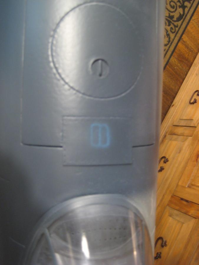

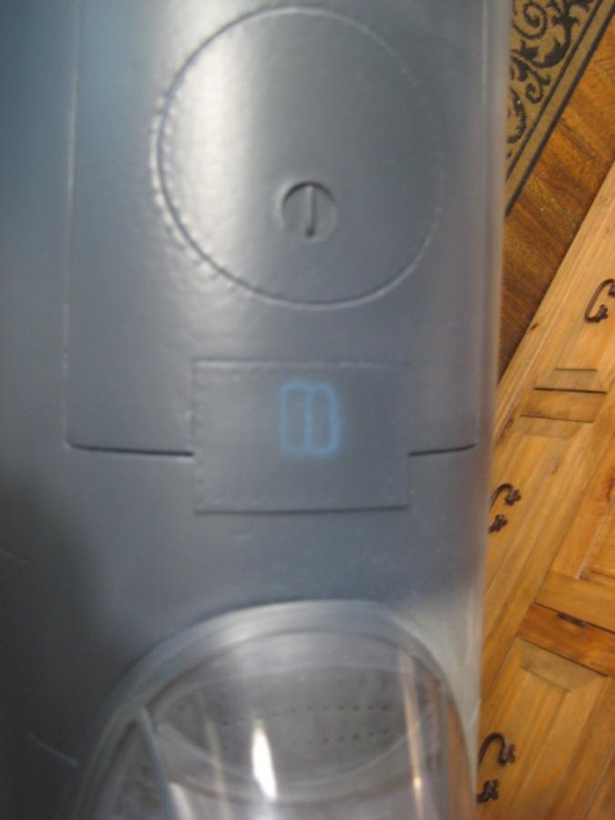

                              • HI Ya'all, so, I am airbrushing more Sea Blue (Ammo by Mig) and I get this strange artifact in the paint. It dawns on me that location is a magnet location for the battery hatch. Logic dictates there is ferrite in the Sea Blue paint. I grabbed a bigger magnet and held it next to my waste airbrush alcohol bottle and sure enough all the pigment in the bottom moved left-right-up-down. Remarkable to me, but paint gets its color from all types of places. Not sure how to fix the mark, will try hand brushing it in or Tamms said, hey just leave it. It is a good story. Best, :LB

                                  That is a strange one, with that pattern and everything! Fortunately, it is very small on a particular panel that could be masked off and resprayed or hand painted so as to leave no trace, other than this photo. I had not come across this phenomenon before!
                                  Good luck, whatever you do!

                                    The magnet is .25" cube. It magnetized the paint immediately when sprayed. I saw the pattern and cracked up.
                                • Amazing! Good headwork on using the magnet on the inside and another one to pull the hatch off from the top. Very unexpected results with the magnet on the paint! But maybe hand painting that little square with a good brush that doesn't leave brushmarks, or very little of them, might be your solution.

                                  • I wonder if it would help to remove the magnet and repaint, let it thoroughly dry then replace the magnet. Maybe reverse the magnet and metal so that the magnet is on the fuse and the metal piece is on the hatch. Just brainstorming....
