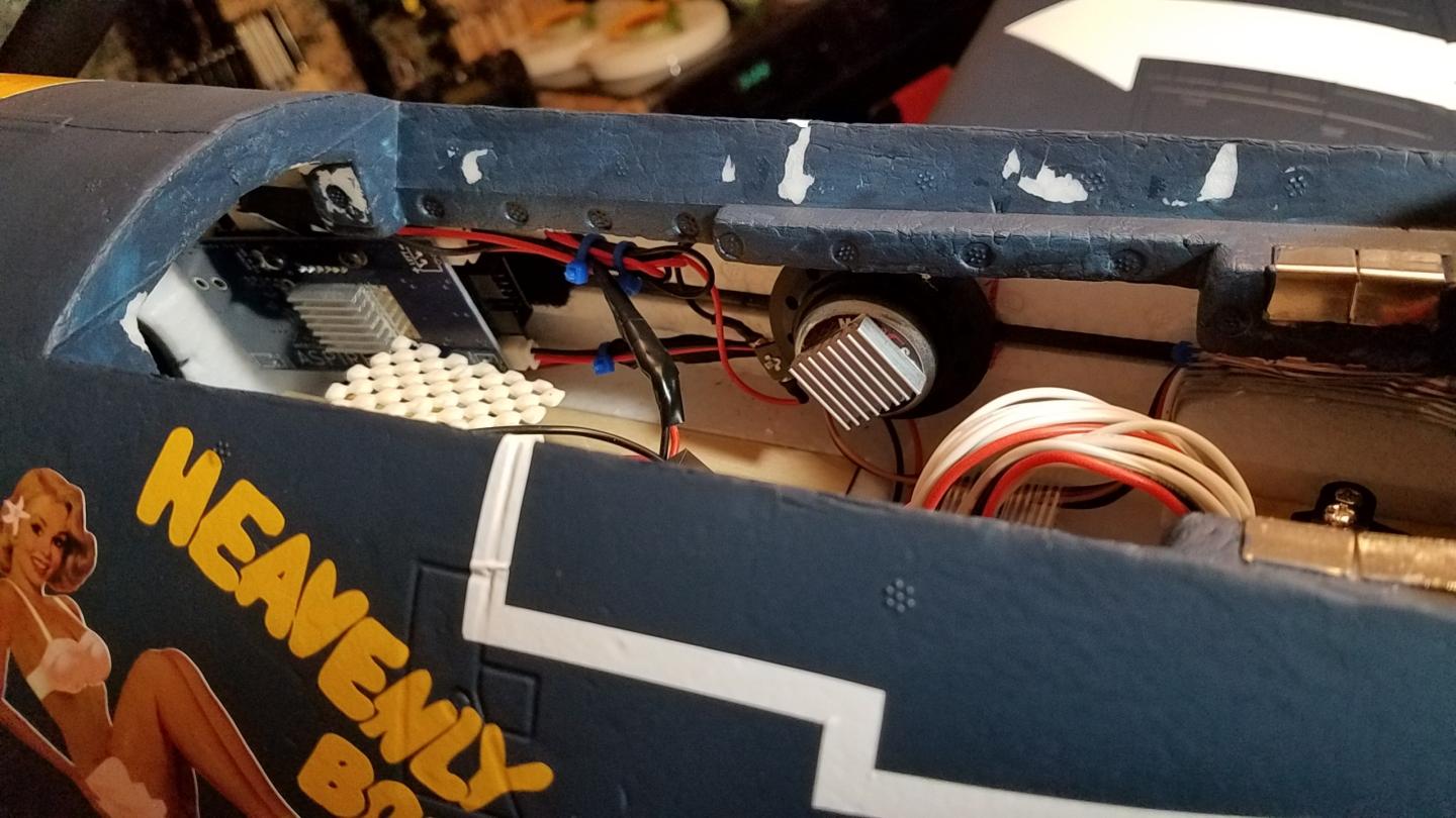

      UPDATE! Don't use foam tac to glue in the transducers from Mr. Sound. I had one come off mid flight. It swung around the battery area and it knocked the battery cover off. I had my favorite $20 camera wedged in the battery cover when I lost it. The transducer then got wedged between the elevator and rudder servos. Thankfully I was able to land, but it could have been worse. Use a stronger glue. My fault, lesson learned. New 4K spy camera ordered from ebay. I like how the camera is on an 18 cm lead, should be able to place it in neat spots around the plane.
        https://www.ebay.com/itm/194249036918?var=494348595063
        Amen to that! Tried that with my first sound set-up and one transducer came off on it's 2nd flight. Since then, and 8 sound systems later with 2 transducers each glued in with epoxy, never had one come loose again after maybe well over 100 flights. I also use a toothpick and poke holes in the foam where the transducers sit, not sure if that made any difference, but they've been rock solid for some time now. You should also consider putting heat sinks on each transducer because it really cuts down on the overheating, especially with the double wasp sound for the Corsair as that particular one generates the most heat. Before I put the heat sinks on, I must have "blown out" about 5 transducers which Andrew replaced immediately (back when he sold them directly).

          I like those heat sinks, where can I get some?
          A comment about Foam-tac - its not that its "not strong enough". The reason Foam-Tac isn't best for this application is because the transducers get fairly hot, and Foam-Tac will soften when its heated. So its not the right glue for mounting transducers, epoxy is!
          p.s. -- don't leave foamies that were constructed using Foam-Tac in a hot car in the summer. Besides the gatoring problem, they will turn back into kits! Also, if you want to remove something that's been glued in with Foam-tac, to separate the parts all you need to do is gently (carefully) heat it.
            They come in all shapes and sizes, the link below just happens to go to one particular size, not even sure those are the ones I got, but look around for different sizes that meet your needs. The Company is Luxeon Star LED's by Quadica, sells mostly LED's of all kinds but also sells heat sinks. I've gotten maybe 6 or 7 different sizes from them with different blade lengths and arrangements, some metal, some a hard carbon fiber I think. Some come with special 2 sided heat resistant tape, some don't, so you should also get some tape there as well to cut to the proper size. I'm generally using the ones that are 20-25mm square and 5-10mm in blade height for the transducers, depending on location and how much room I have without contacting any wires.
            You can also find tons of them on Amazon, in all shapes and colors.
