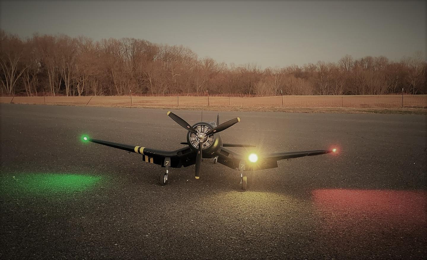

          Successful re-maiden! I powered up the Aspire sound card this time. It is dual transducers, but volume was at 10% because dogs were barking. Landing went well... full flaps. I need some minor adjustments tonight (rudder/ tailwheel) and will let her rip tomorrow morning. Thanks for all the tips.

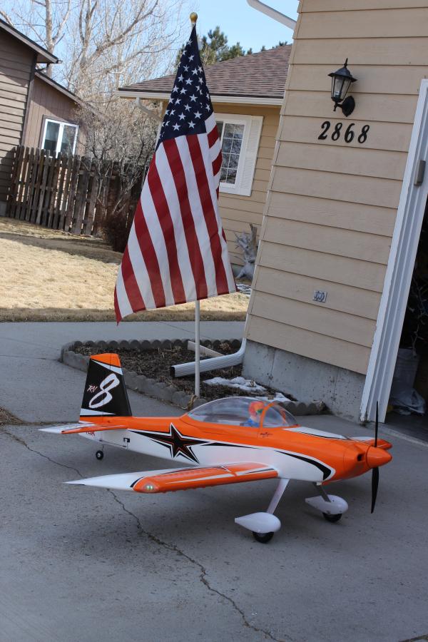

                  If you want an airplane that will teach you how to land while being very forgiving, and I think Rifleman can attest to this too, buy a Flex Innovations RV 8. This is THE easiest airplane to fly and improved my landings ten fold.

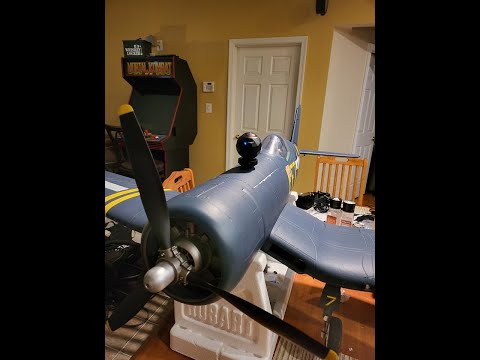

                    Lunch time flight today. Attached my really old and dying 360 Fly HD camera (138g). The fully charged battery dies after 2 minutes. Flight is over railroad tracks and the Potomac River in Brunswick, MD. Windy, 10-15 mph gusts. You can change the POV with your mouse.
                    Does anyone have a suggestion for a newer, lighter 360 degree camera for our planes?

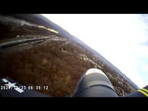

                              Pretty cool two minute clip tonight. Corsair onboard cam. 1 barrel roll, 3 loops, low pass and landing with Mr. RC Sound Aspire Card. Wind blocks out Aspire card being picked up on camera mic. Dual speakers. Will adjust mic and try again. Dive whistle, engine and machine guns sounded great at field. MD/VA/WV Potomac River and railroad tracks.

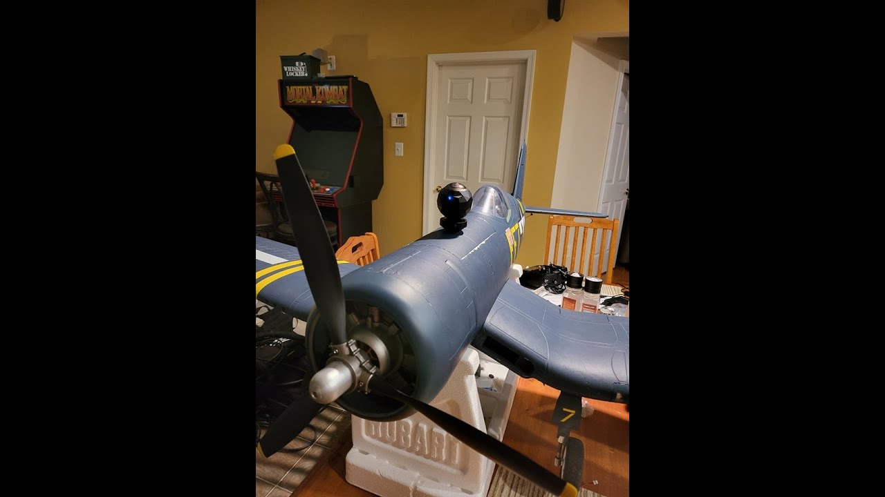

                                        That's the new camera location. The mic is inside the battery area. I was bummed with the results. Uploading video now.
