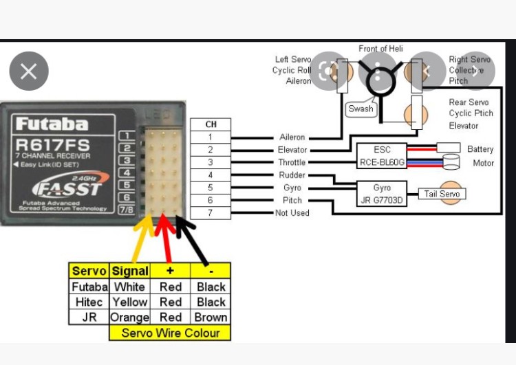

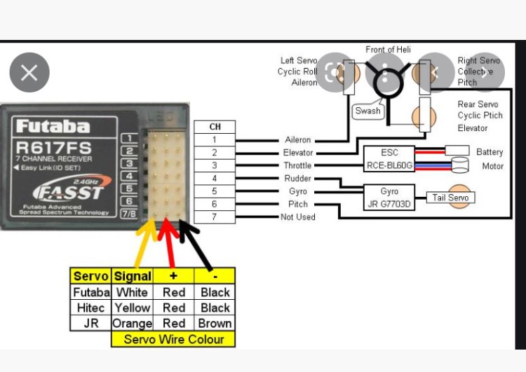

Hi Guys,
im having a difficult time linking my receiver to my transmitter. I have a Futaba T6K controller and R3006SB receiver
Could anyone give me some advice on:
- what connection I need to connect battery to receiver to power it?
any other things I need to know to get it linked?
thanks3 PhotosComment
The battery connects to the reciever through the esc in the plane. Do not connect a 22 volt battery directly to the reciever or you will absolutely blow it. The esc has a voltage regulator that only allows 5-6 volts to pass to the reciever for power. If you want to power the reciever outside the plane you need a li-fe 6.6 volt or a nimh 4.8-6volt pack that can plug into any servo port on the reciever.Comment

Hi Fin121, Once you get the ESC’s 5V output located, follow these steps:Hi Guys,
thanks
- Turn on the transmitter….should be close to the receiver (close helps the binding process)
- Plug in the 5V ESC output into the receiver any unused site
(see photo below…captured from the Internet). I use it! Then connect the ESC to your 22V battery
- With a plastic tool, Press the SW (down in the hole) for more than ONE SECOND to start the binding process
- Wait for receiver LED to turn steady green
On all my birds, I have had to reverse the throttle in the transmitter programming to make the motors work.
IMPORTANT!!! Calibrate your ESC after binding. You can Google how to or come back here. REMOVE THE PROP FIRST or risk injury.
Cheers,
GG
