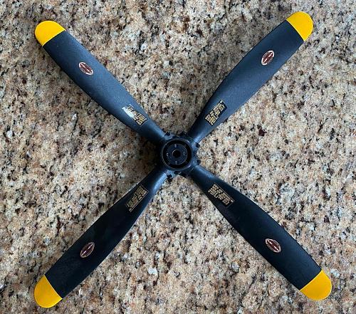

      Plus one on the 4 blade.... what are the details? is it the old sky raider prop or is it the prop off the FMS Corsair? And.... what additional hardware did you need to mount if any?
      Details on amp draw would be a plus, Thanks :-)

        Originally posted by I-fly-rc-aircraft
        mudduck, what 4 blade prop you using? cool beans man
        Tom
        Hey Tom,
        TiredIron posted waaaaaaaay back in this thread, that is the 17" 4-blade prop from the old 1700mm FMS P-47. That plane was discontinued but the prop parts are still available if you're lucky to find them (I got mine on ebay) - you need to purchase the hub, spinner, and the props. Don't buy the FMS prop adapter, it will not fit the Corsair's motor, but the prop will fit the original Flightline prop adapter with some very minor modification. Basically you need to enlarge the hex on the adapter a little (I used masking tape) so that the slightly larger FMS hub fits tight. The FL adapter is a little short but with a little fiddling you can make it work. I carefully shortened the base of the spinner cone so that the recessed nut would engage the threads.
        The FMS hub and spinner are black, so I painted them.
        The 4-blade prop pulls a little more but the model is not as fast. I love the look and it flies very realistically.

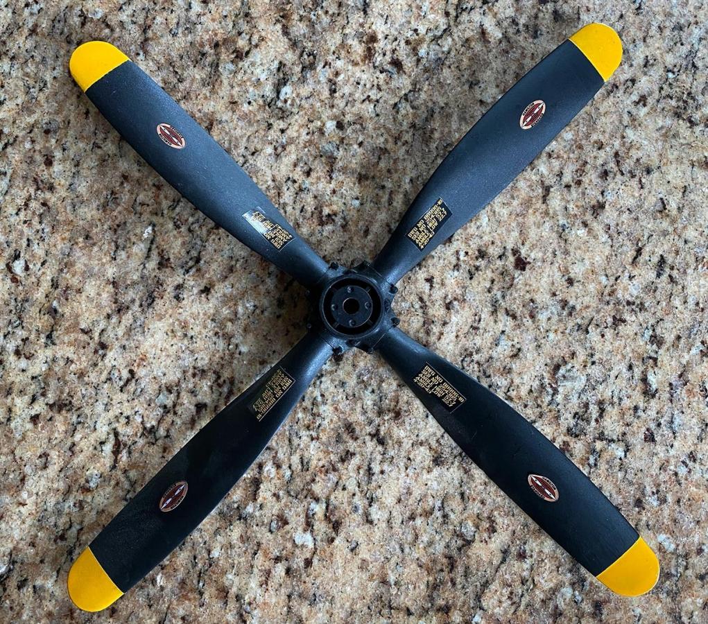

            I'm not sure if this is helpful or not but I have a 16" 4-blade prop from a Skyraider I bought a few years back to upgrade the FMS Razorback but I never did use it. Just sits collecting dust now. If anyone thinks they can use it just let me know. There's no hub/mounting hardware, just the 4-blade prop.

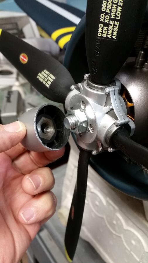

                      Thanks guys, that 4 blade is going to look sweet on mine.
                      Tom
                      Its good to see the parts are listed by Horizon (and FMS) - to repeat, you'll only need the "spinner" (Part# FMMSI310BLU, currently on backorder) and the blades (Part# FMMPROP002, currently in stock).
                      Then a little modification is needed to make it work. You'll find that the hub's hex mounting hole is too big, its too loose on the original prop adapter. So what I did was carefully wrap several layers of masking tape around the hex on the original prop adapter until the hub fit properly. It seems odd but it works because the main nut holds the hub on very tight. (The hex on the prop adapter just stops it from turning when you're tightening down the nut.) Then the second thing that I found was that there wasn't enough of the bolt sticking out for the acorn hub to grab onto. I thinned the back of the hub a little (its very thick), and shortened the skirt of the acorn hub a little, until the acorn nut could grab the threads. If you guys do this mod this will make more sense when you see it! The acorn nut is just a decoration, so installing it finger tight is all you need. I've had no problem with mine... except I painted the hub and acorn silver and the paint keeps rubbing off!
