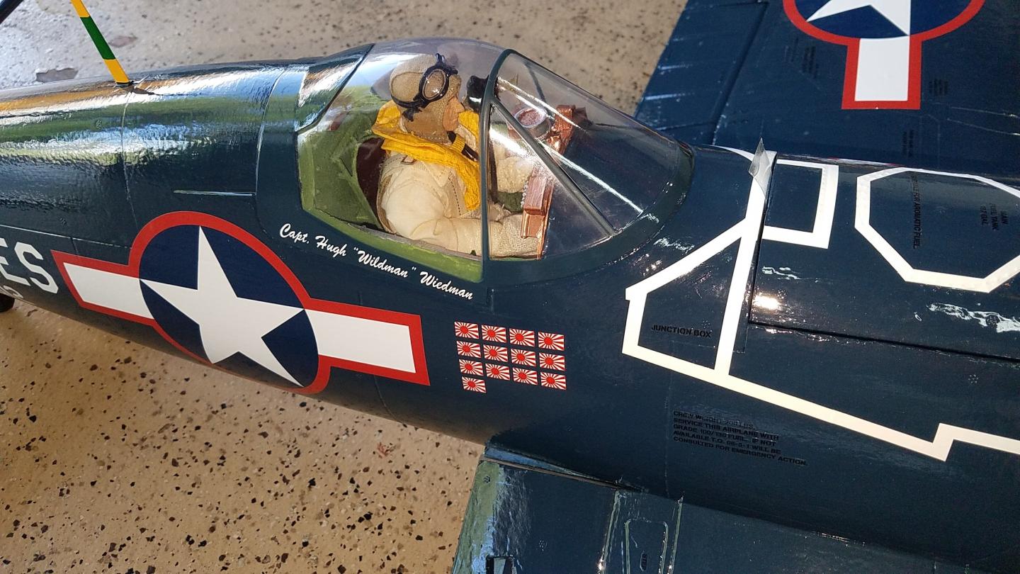

  • Folding wings and a retractable tail hook. Yeah but I've done enough to this great flyer and am done. FYI, the fuse aft of where the aft antenna is, is solid foam. So, I'm not going to actuate the canopy.
    So, in total I have:
    A tri-color paint scheme. Some weathering.
    A center external drop tank. For static display.
    Scissor links on the mains
    A fuel cap that doubles as a hatch release
    Functional cowl flaps
    A manually operated sliding canopy.
    A well fitting instrument panel
    I still need to install the cowl flaps and sliding canopy to my flying Corsair.
    It's been fun but I'm done.

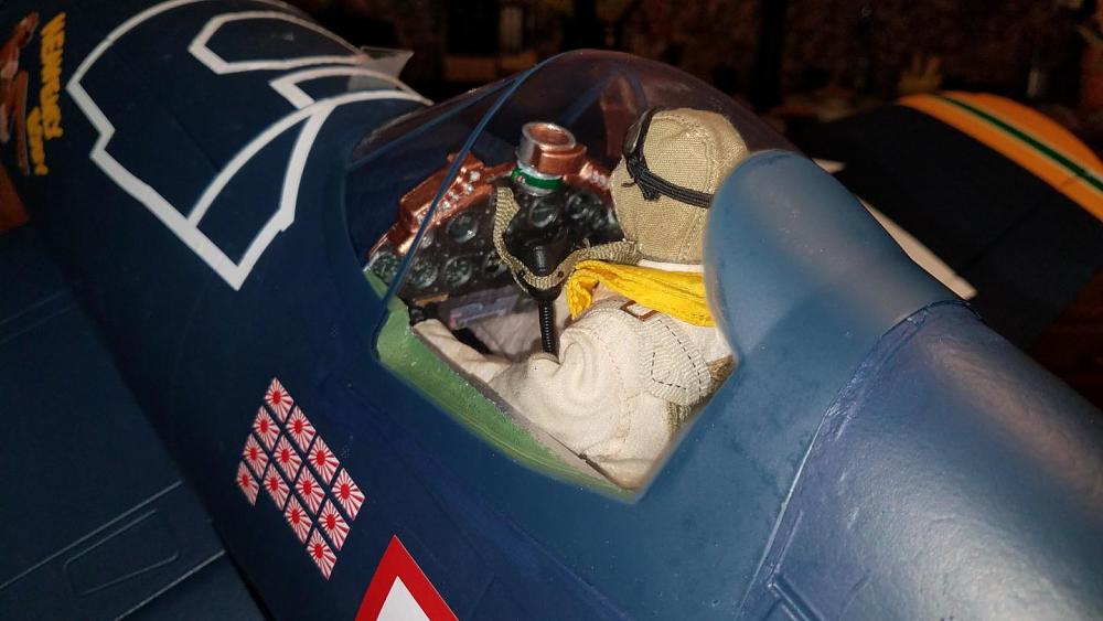

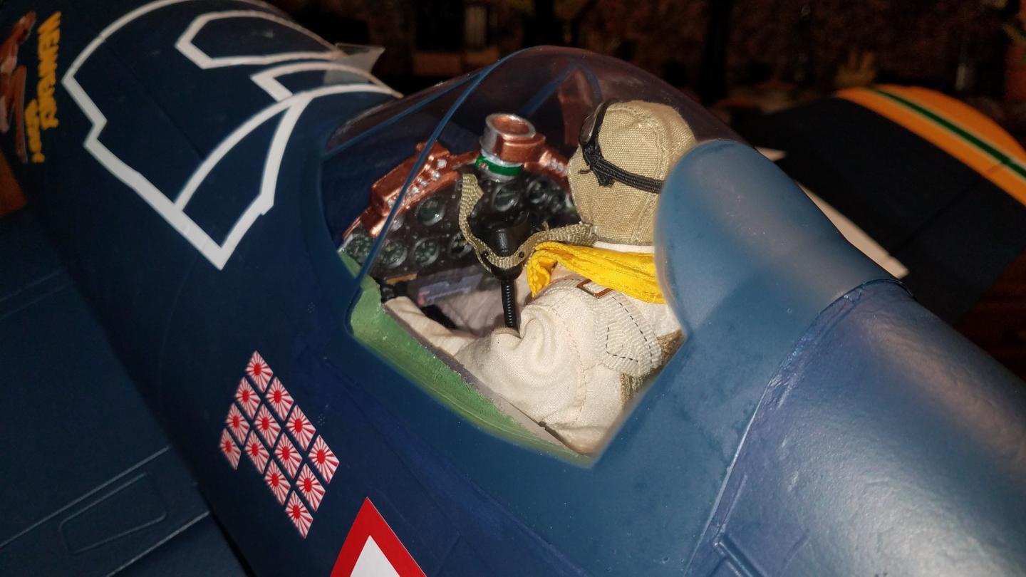

            Tom, you have such great modifications, you should get the warbirdspilots.com figure with the moving head, just hook it up to say the rudder, looking left and right. I put it in mine, granted he is a little bigger than your average bear, but it sure looks cool, especially since you can move the canopy back to fully expose him! You can cut the legs off if you want, but I just took his boots off and left his feet hang into the fuselage (where he can manually push the servos if he sees fit). Everyone at the field calls him Clint Walker.

            • I-fly-rc-aircraft I really like your sliding canopy mod, well done!
              • Tom, one more "modification" you might think about is the sound card and transducers with the double wasp sound. The Corsair's fuselage is the perfect environment for the sound, it's loud even in the air. These mods are simple compared to what you have incorporated and really get peoples attention at the field.
                Below is one of my stupid videos that I posted quite a while ago before putting the cowl flaps on showing the pilot's moving head and the engine sounds.

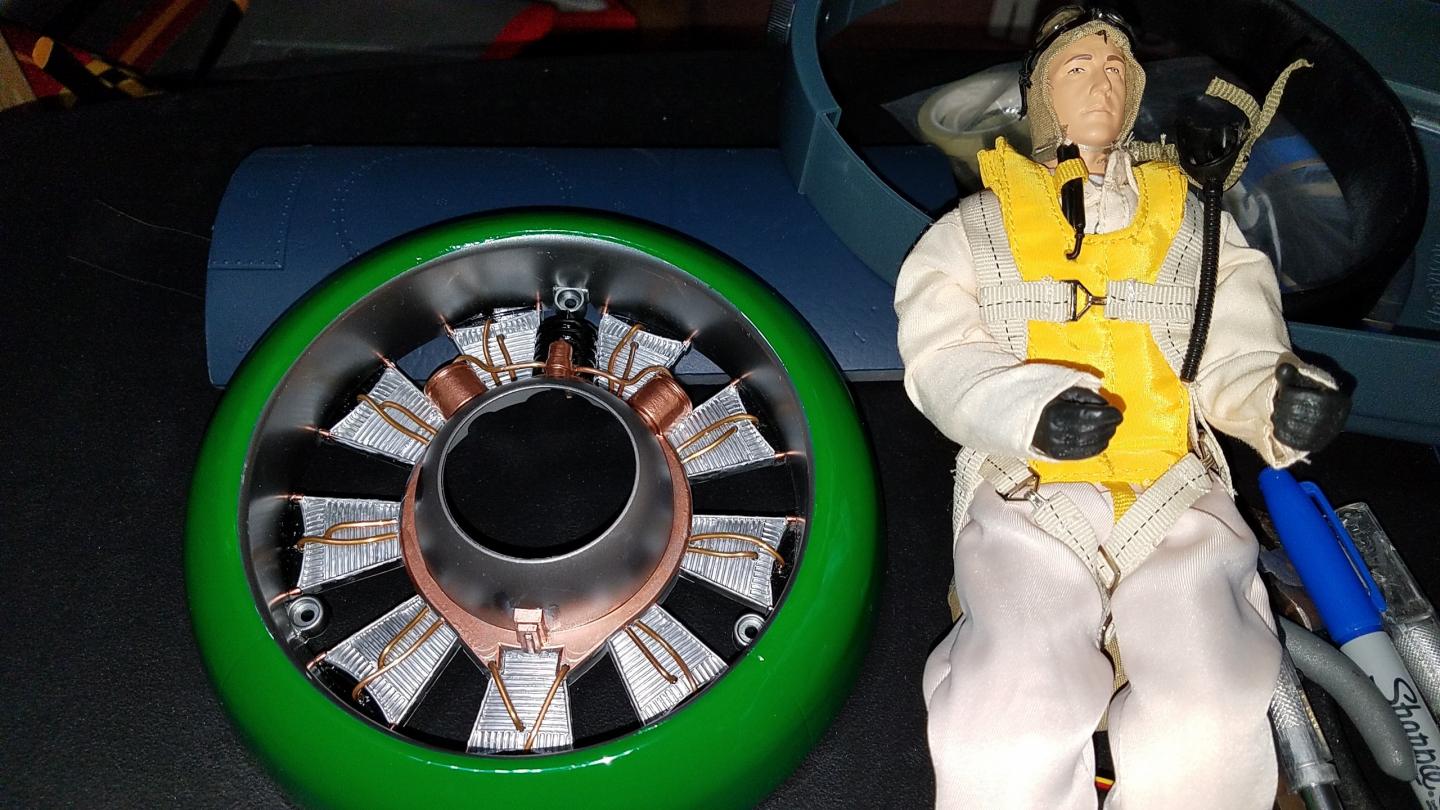

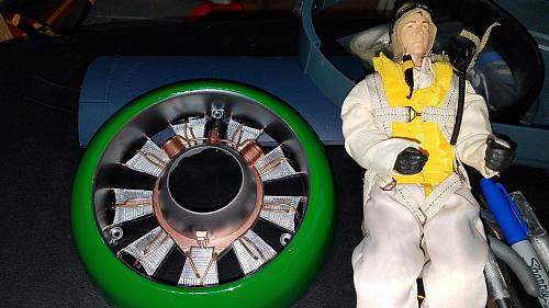

                • hugh luv the cowl detail !! and the pilot.....the wire looks intricate ..mutch time in that??
                  • Originally posted by f4u ausie View Post
                    Not really that much time, maybe a couple hours or less for the wires. Used electrical wire. Ole-Timer (post #833 & 1293) first posted the engine tubes he did, then Brandon Moon & Davegee posted their work on the engine tubes around March of last year and I saw it and tried to emulate. They also added cylinders between each of the existing ones to better depict the double wasp engine-really outstanding work on their part. The cowls took quite a bit more time, did it over about 4 days, couple hours every day, no 3D files, just elbow grease, styrene and epoxy.
