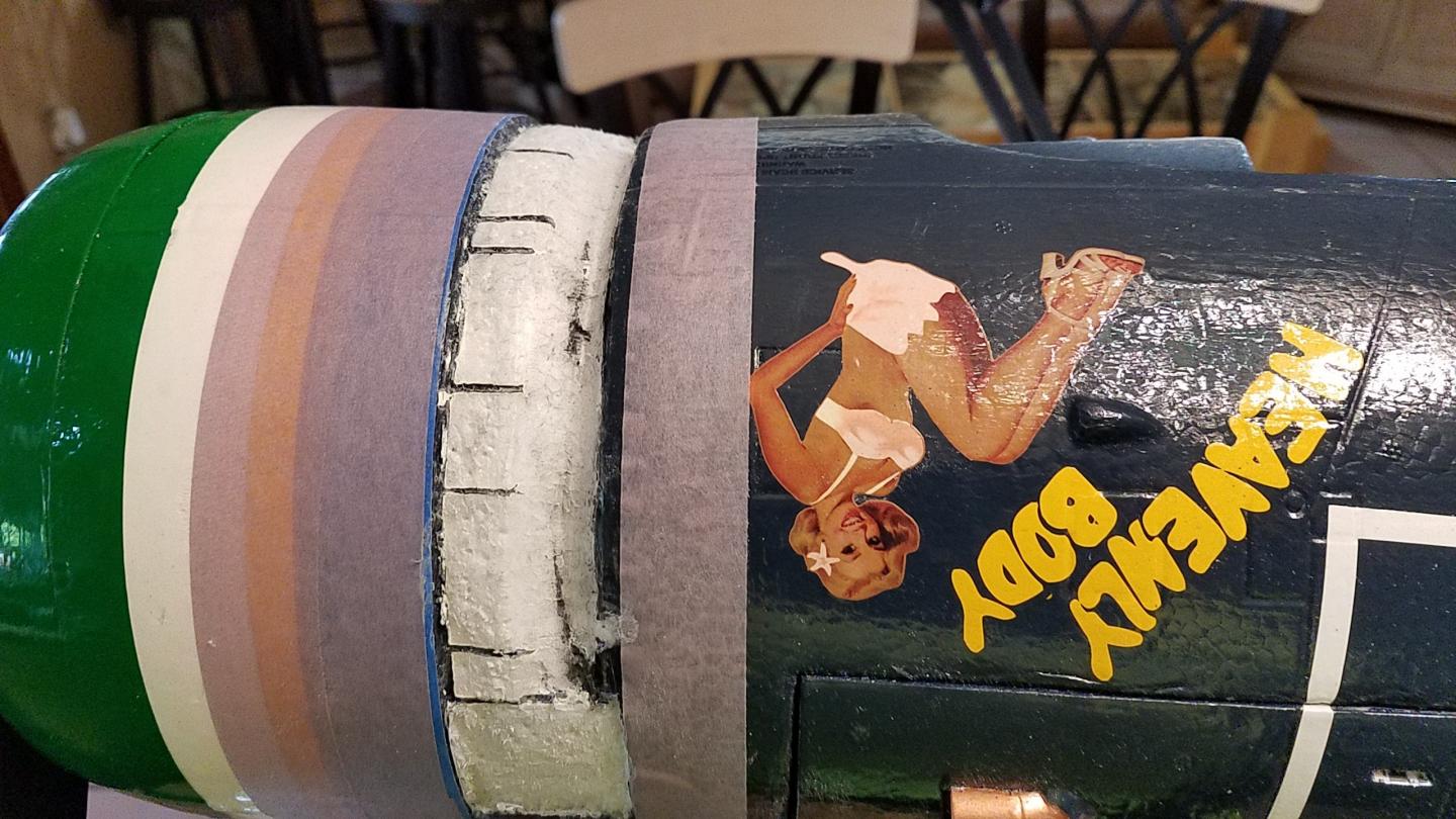

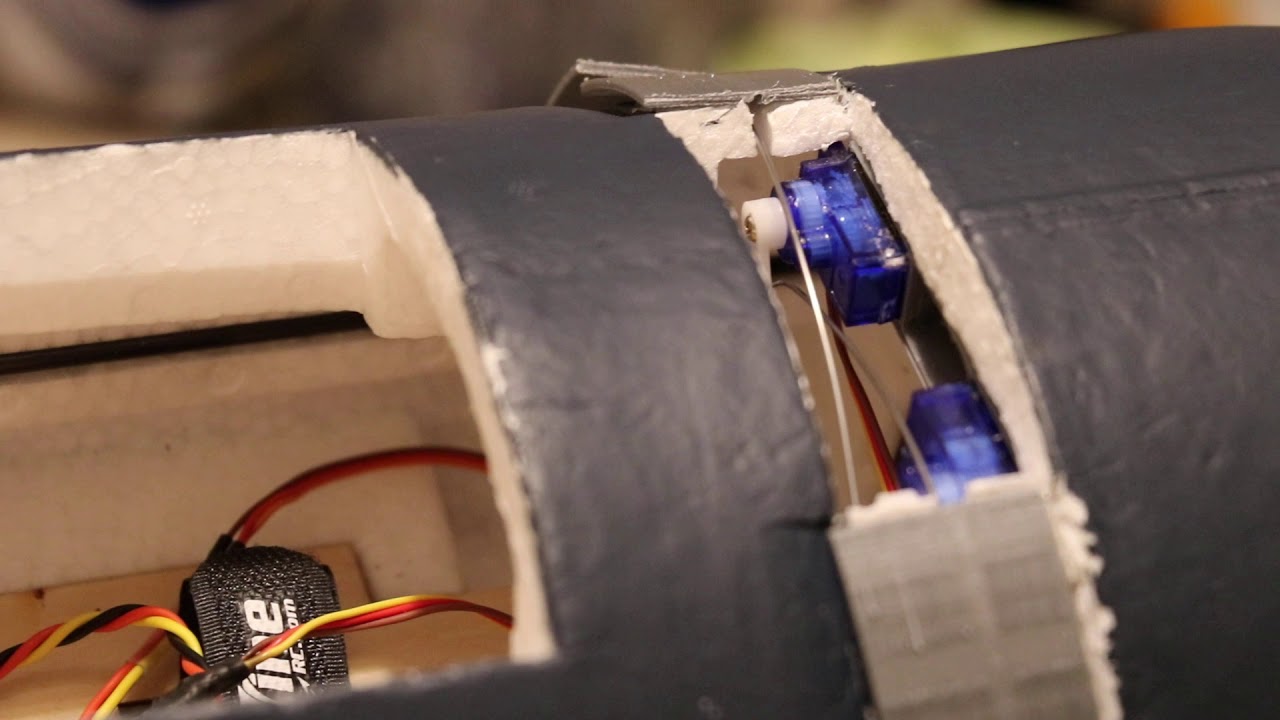

            • Some progress with the functional cowl flaps. Very tedious work but worth it.
              Tom

              • Originally posted by I-fly-rc-aircraft View Post
                Tom
                PS: Sliding canopy next?
                OMG you are too much, that is so cool.
                  Niiiiiiiiiiice!!!
                    Tom
                    Tom, You're crazy like fox, only not fox, person, and clever like otter, but not otter. Whoa, I gotta stop watching Russian television. Anyway, outstanding, Sir. Best, Steve

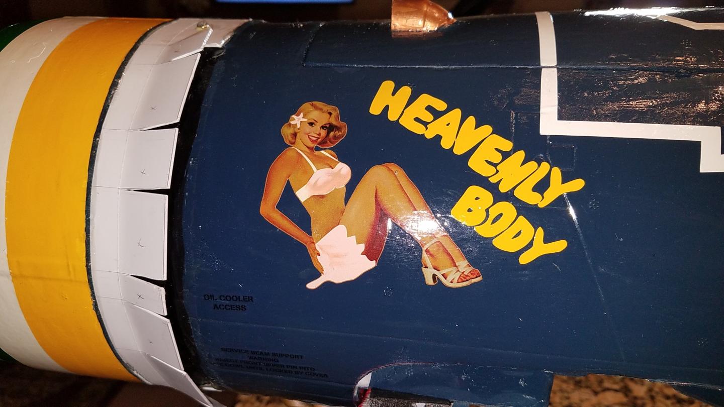

                        • Going to have to take a step or two back. Seems the CA doesn't hold the nylon hinges to the PLA very well. Maybe Epoxy would bond better. I'll keep you all posted.
                          Tom

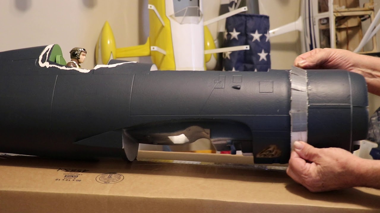

                              • A little tweaking to do but happy where I'm at
                                Tom
                                  Tom
                                  Un-Freaking Believable, almost can't believe you got it to work so well! You are the master and "I'm not worthy". Can you now get it to spit out some black smoke when you fire the engine up?

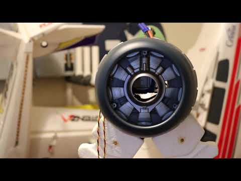

                                  • Done ..I know it will work. Can now install on my flying Corsair (With some modifications of course).
                                    Tom
                                    • A better angle..I'm not the best videographer.
                                      Tom
                                      • You get the gold star of the month! Well done sir, cannot wait to see the final version!

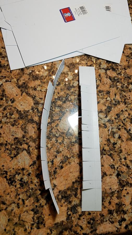

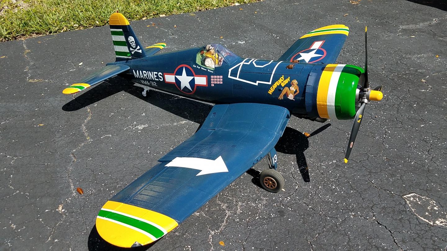

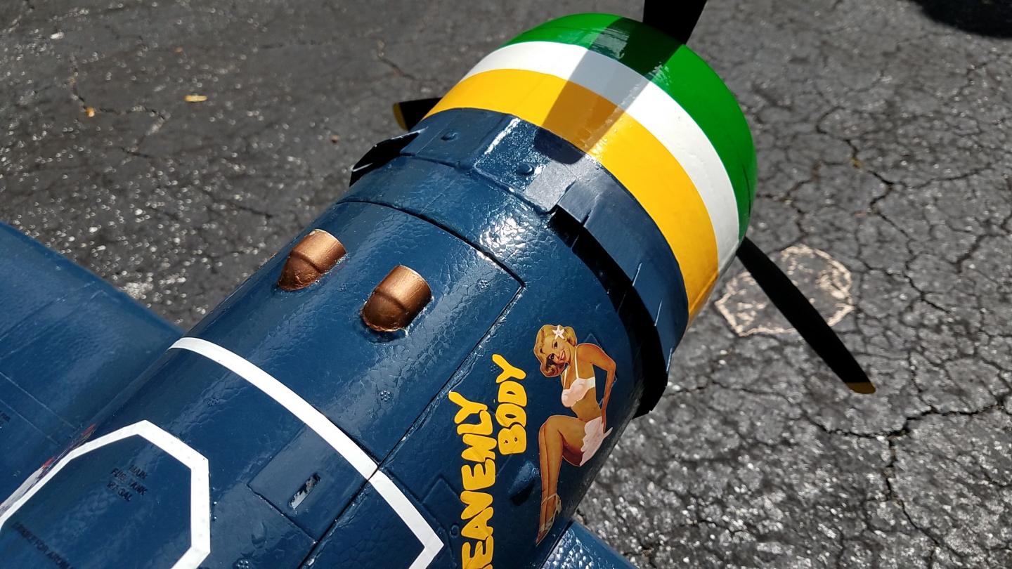

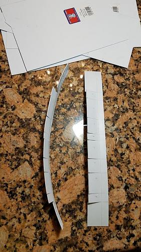

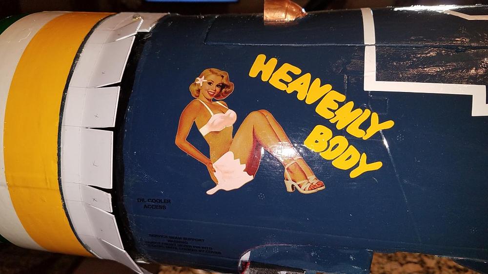

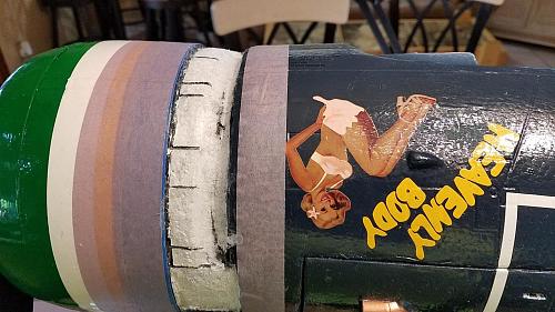

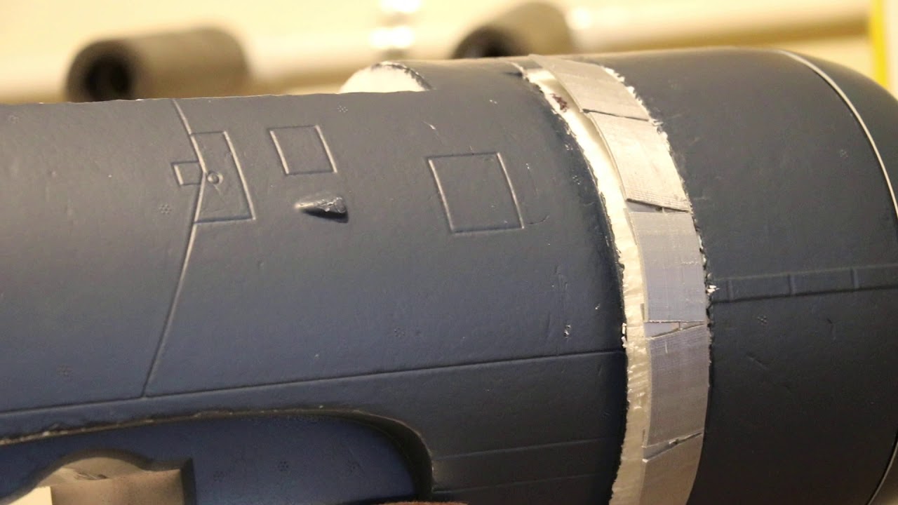

                                        • OK, finally finished my version of the cowl flaps, without using a 3D printer (or 98% of my brain-which is mostly dormant). I've always loved this plane, but for over a year, been disappointed in the panel lines that were used to simulate cowl flaps. C'mon, a Corsair has 2 distinctive features, the gull wing and cowl flaps. Ever since Brandon Moon (I think he did a cowl flap mod-forgive me if it was someone else) did his mods over a year ago, I've been itching to do something with mine. Then Tom starts with operational cowl flaps, and I have to admit, never thought it could be pulled off. Well congrats to him, he's a superstar. On second thought, I think he's part of a technologically advanced alien species on this planet just to give us mortal earthlings "cowl flap envy". I can't imagine what he's going to come up with next.
                                          Anyway, couldn't come close to his work, so have to live with my non-functional 2nd rate substitutes, but still better than the stock I think. After finishing, I think I should have made them slightly longer and open wider (but the 2% in my brain insanely had the idea that it would mess up the aerodynamics of a beautifully flying machine-how crazy is that). I used .020 styrene and cut a strip and the flaps into it, then inlaid it into the foam.
                                          I'm almost embarrassed to post these pictures following Tom's work, but what the hell, I ain't shy about showing my .
