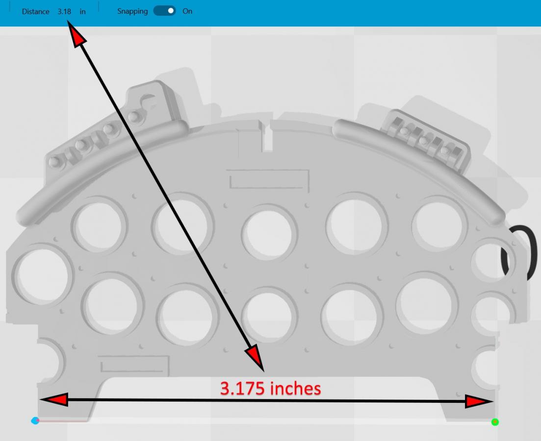

        It measures 3.175 inches with calipers. If I clip it that size, it does cut into some of the gauge openings. Which leads me to believe that those gauges on the 2D print, as well at others, do not sit under the openings in the STL file.

          KMD, I figured that was the case, though I understand some have cut the foam back to the rear cockpit bulkhead to accommodate the width of the IP. The "Bubble Top" rear bulkhead is not complete in that it needs to be 'filled in' at the top edges to be more scale. I am uncertain whether it would also need to be widened if foam were removed from the cockpit sides. I believe Hardway has done this. Hopefully, he can chime in here. In the meantime, if there's anything I can do to assist, let me know. Best, LB

            Elbee, Yes, the cockpit sides also do not fit. I printed them on paper first to check.

              Motion RC should maybe remove the link to those files, or mention that they do not fit the "Bubble Top" as-is.

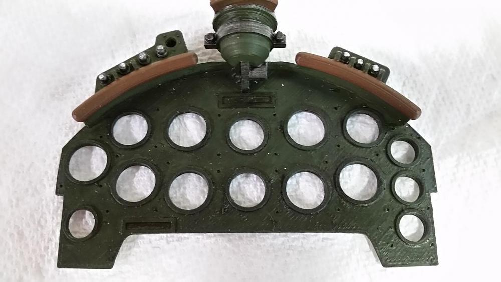

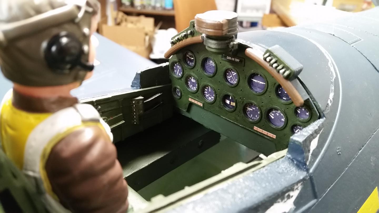

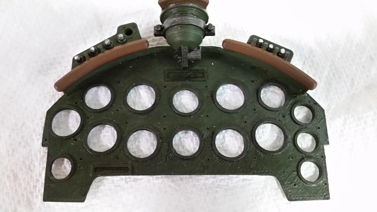

                I've been lurking... but decided to chime in. I printed mine out much earlier in this thread... last year I think,.. I have the bubble-top version. I got my 3D part to fit very nicely by clipping off the pointy corners - all the instruments are still there. I widened the plane's mounting area by making the foam fuselage sides slightly narrower. (I cut away some foam to make the sides narrower). I also installed the new seat and back armor-plate as well. (I made a booster for the seat)
                I removed the smaller (earlier model) reflector sight and installed the new one as you can see here.... and modified the 3D side pieces a bit as well, and made some filler to make the top edges of the cockpit match... It sounds like a lot but it really wasn't that big of a deal and the final product turned out quite ice I think. I do agree with Katman that the 3D files should at least have a disclaimer. I don't know, maybe this was designed for the birdcage? Anyway I made it work.
                The original printed dashboard decal that comes with the model definitely does not match the 3D dash, I threw it out because Callie's glossy instrument decal (which is installed on the back side) matches it absolutely perfectly and it looks fantastic!
                Here's what mine looks like after painting. I didn't really spend that much time -there are only three colors and a little black wash to make it look dirty.

                  JUST AMAZING! Love your work!

                    TMD, I thank you for your update on these files. I know the updated file sets work better than the first sets. We all went round and round when this aircraft was first introduced about the cockpit parts, but in MotionRC's defense, if that is even required, the files were offered at no cost and we are modelers, right?, so a bit of adjusting and creativity is just part of the hobby, I think. The files can be reworked by anyone with a basic CAD Program. I own the Bubble Top, but have yet begun to build it. Pretty certain I'd rather cut away foam than give up on a full IP when the time comes. Great call on the Callie Graphics IP Photo! She did a great job with that. Best, LB

                      Absolutely agree with you LB, 100%. I do enjoy building and modeling and putting these extra details on. And thanks for your comment E4dragonrunner, but my work pales in comparison with what some others have shown here. But I'm happy with how my foray into cockpit detailing turned out!!
                      (I have to say that once the canopy is back on it's really hard to see this detail. But I know its there. If I was doing it again I think I'd install a pilot with legs....! My model looks like Douglas Bader is flying it. )

                        TMD, ...and your pilot appreciates that it is there. I feel the same way about 'knowing it's there'. I would look into the cockpit and think, I need to dress that up. Matters not whether anyone else notices the details, cuz I know it's there and if it weren't I'd have trouble sleeping at night. Best, LB
