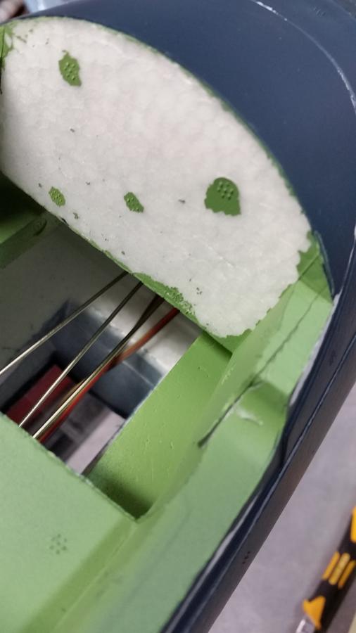

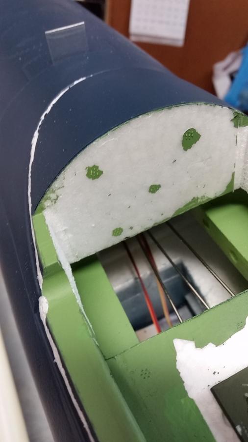

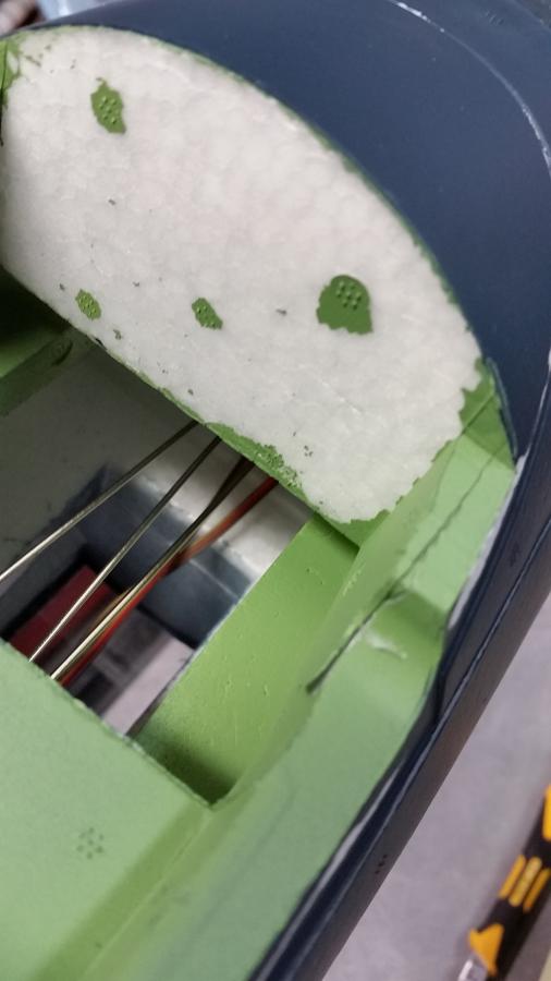

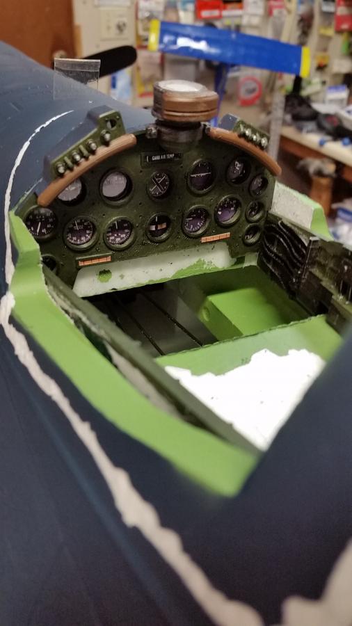

                  We've had some discussion here about the 3D-printed cockpit (panel, sides, seat, and back armor plate) and how the panel and sides aren't quite a perfect fit. Some work is needed to make these parts fit.
                  I had the opportunity to install mine a second time (long story) so I took some pictures to illustrate the entire process.
                  (This is on the bubble top model. I added the later-model gunsight, the birdcage uses the original gunsight. The panel's instruments are a glossy decal from Callie Graphics that fits perfectly)
                  All the 3D parts were painted ahead of time.

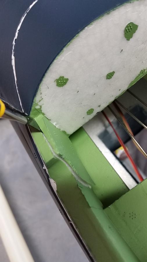

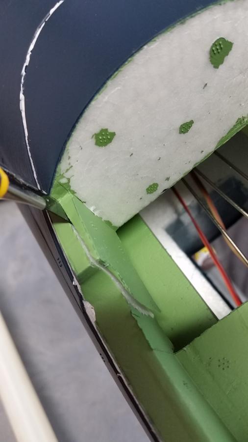

                  The first step is to peel off the plastic cockpit canopy. Then, remove the original instrument panel decal, the pilot and the entire original chair. Keep the pilot!

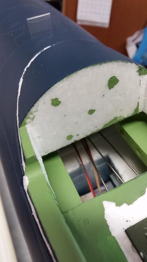

                  1) use a very sharp blade to "straighten" the cockpit side, because it's necessary to widen the space for the instrument panel. Trim to bring it about 1/16 from the edge. This shows the first cut in the right side.
                  I use an OLFA 9mm, the sharpest knife I've ever used on foam. It makes straight cuts very easy
                  Click image for larger version  Name:	20191229_165343.jpg Views:	0 Size:	38.6 KB ID:	225261
                  Here's what it looks like after the sliver of foam is cut away.
                  Click image for larger version  Name:	20191229_165518.jpg Views:	0 Size:	42.5 KB ID:	225262
                  Then I repeated on the other side
                  Click image for larger version  Name:	20191229_165813.jpg Views:	0 Size:	40.0 KB ID:	225263Click image for larger version  Name:	20191229_165953.jpg Views:	0 Size:	40.3 KB ID:	225264

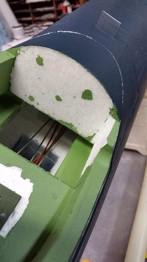

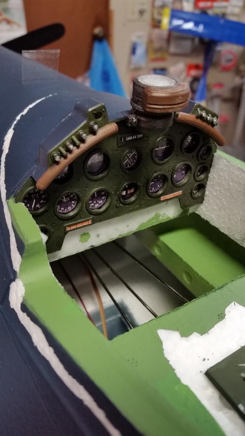

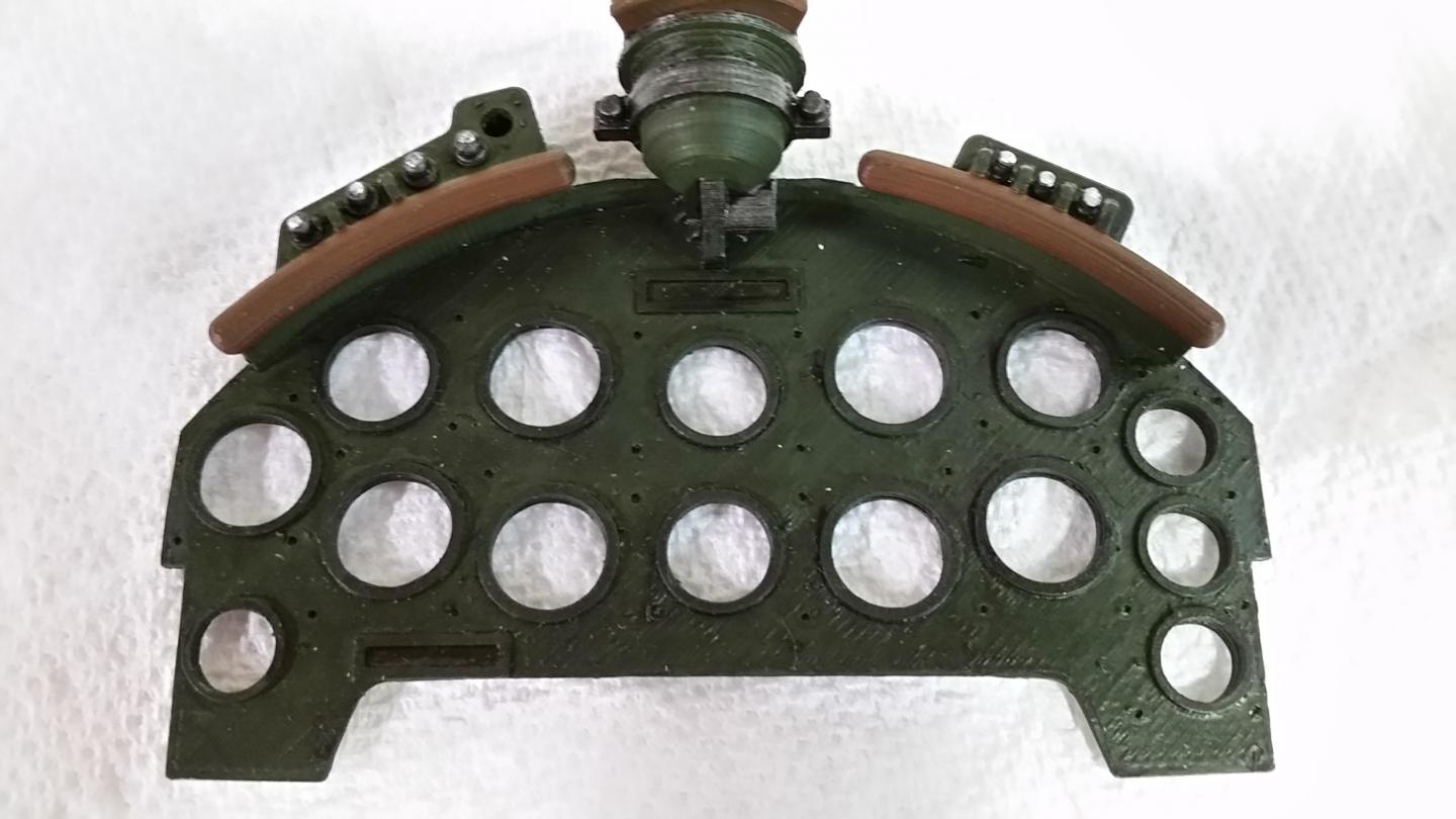

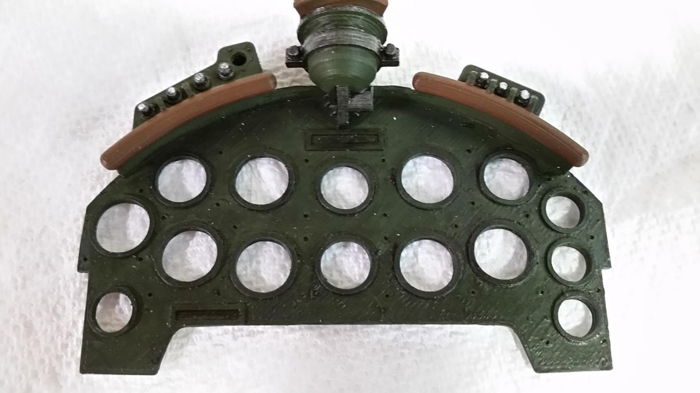

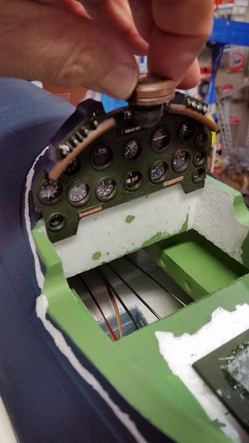

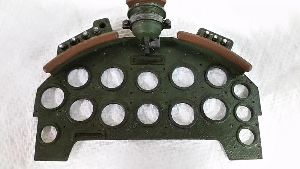

                  2) Here is a picture of the panel - I've trimmed off a bit from the outside ends, but all of the instruments are still there.

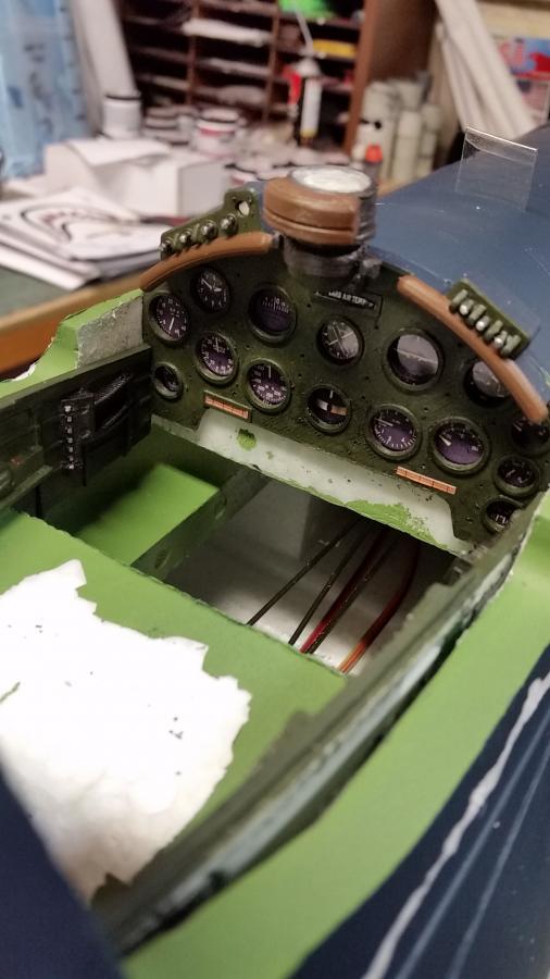

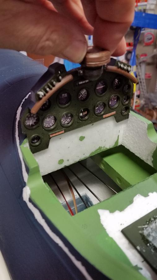

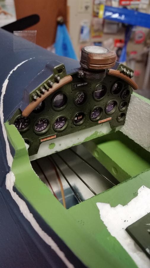

                  2) I placed the 3D parts into place to make sure they fit. Here is the panel going in.
                  Click image for larger version  Name:	20191229_170530.jpg Views:	0 Size:	48.7 KB ID:	225265Click image for larger version  Name:	20191229_170550.jpg Views:	0 Size:	52.6 KB ID:	225266

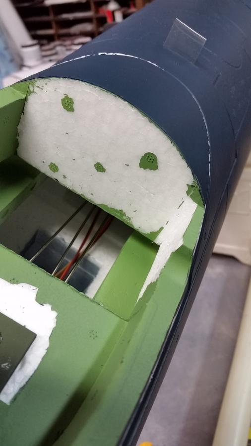

                  It was too tight and so I trimmed off another 1/8 inch of foam from the sides, you can see that the sides are slightly thinner in the next pics.

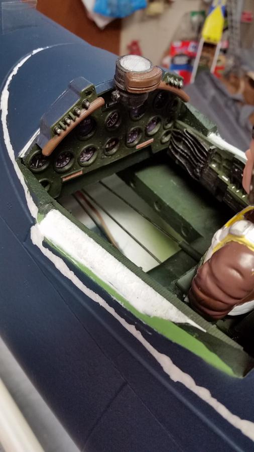

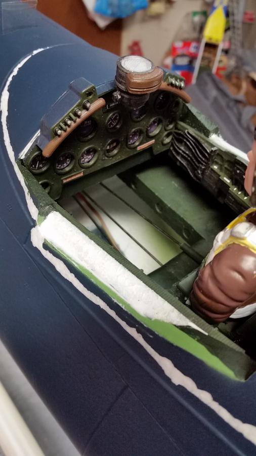

                  3) the left and right side panel parts are installed. They are designed to slot into the side of the front panel and they sit on the bottom edge (on either side of the seat)
                  Click image for larger version  Name:	20191229_171527.jpg Views:	0 Size:	54.5 KB ID:	225267Click image for larger version  Name:	20191229_171552.jpg Views:	0 Size:	51.8 KB ID:	225268
                  You'll notice some exposed white foam in the left and right front corners where the sides were widened, and below the panel. I painted all these exposed interior surfaces a green color to pull everything together.
                  The front panel, the two sides, and the seat back are all glued in once the fit is adjusted. I found that the side pieces were a little too long, so I just shorted them a little bit.
                  I also trimmed the top edges of the side pieces so that they were straight and flat.
                  Once this is all done, the side panels will sit too high - the edges will be sticking up over the edge of the cockpit.
                  Click image for larger version  Name:	20191229_183056.jpg Views:	0 Size:	59.8 KB ID:	225269

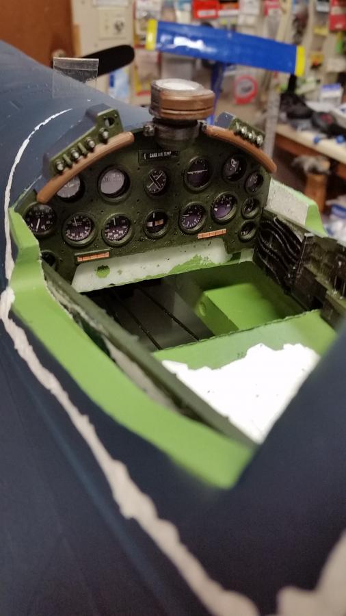

                  3) Last step - I used a little scrap foam to even out the sides. Then I used a little foam-filler to hide the seams, and painted.
                  "Before" and "After":
                  Click image for larger version  Name:	20191229_220352.jpg Views:	0 Size:	58.0 KB ID:	225270Click image for larger version  Name:	20191229_222847.jpg Views:	0 Size:	60.4 KB ID:	225271

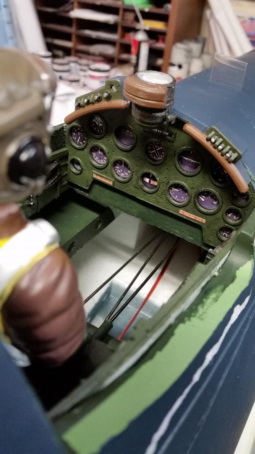

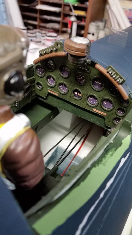

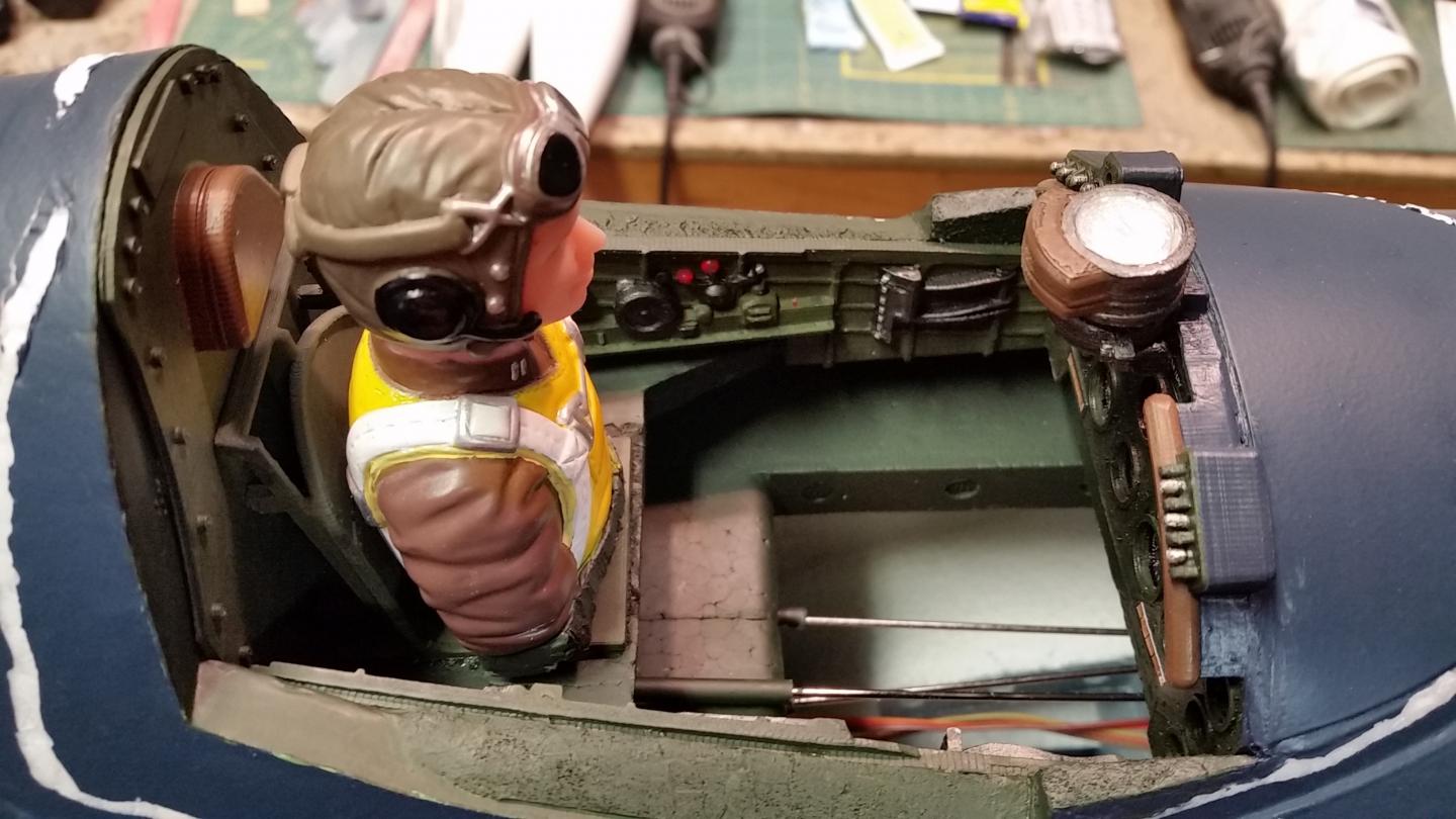

                  The only thing I am missing is legs for the pilot. I am hoping to install a pilot with legs one day!
                  By the way I glued the pilot to the chair and then added a 1/4" thick piece of foam under the 3D-printed seat to raise the pilot a bit, so that his head would be even with the backrest. (this is the original MRC pilot).
                  Then I glued the chair and pilot into place.

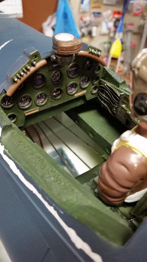

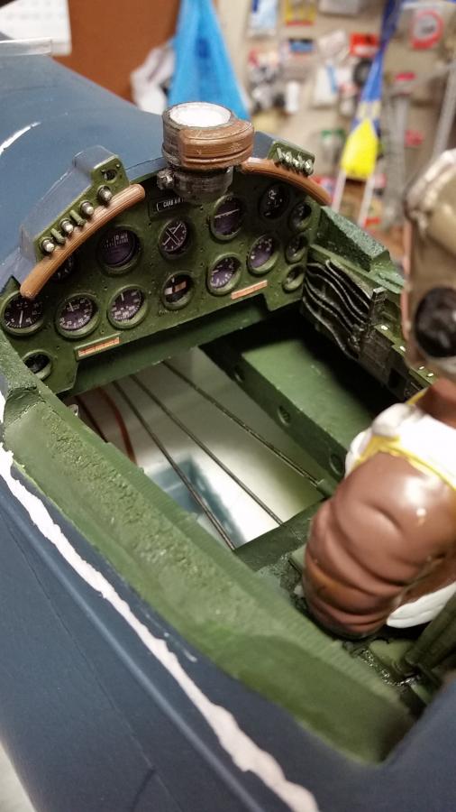

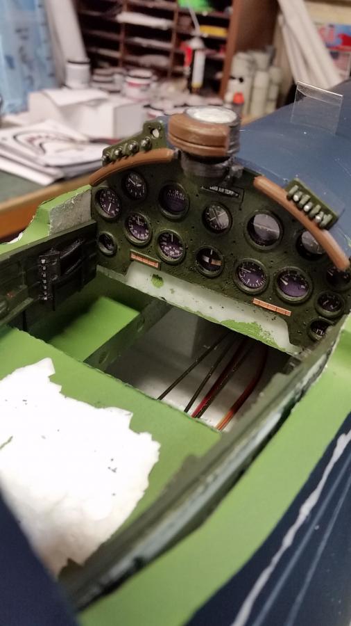

                  Here's a closeup pic showing the entire cockpit, without the canopy. (The interior center is all green, the camera made it look brown in the middle)
                  The sides look a little rough but that's just the camera showing the closeup detail - in person this isn't very noticeable and won't be seen after the cockpit is reinstalled.
                  Click image for larger version  Name:	20191229_225126.jpg Views:	0 Size:	130.9 KB ID:	225272

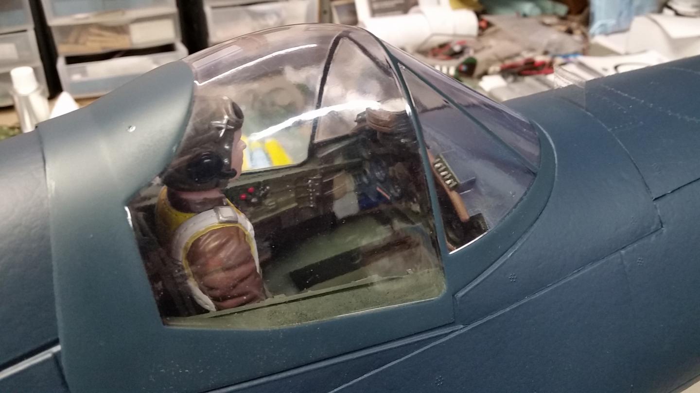

                  Here's a pic with the canopy on.
                  Click image for larger version  Name:	20191229_231923.jpg Views:	0 Size:	105.0 KB ID:	225274

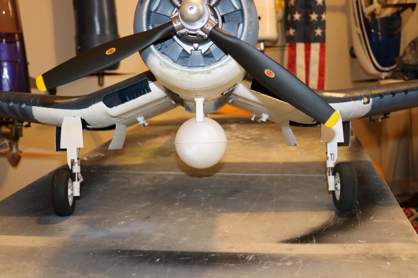

                  #3430

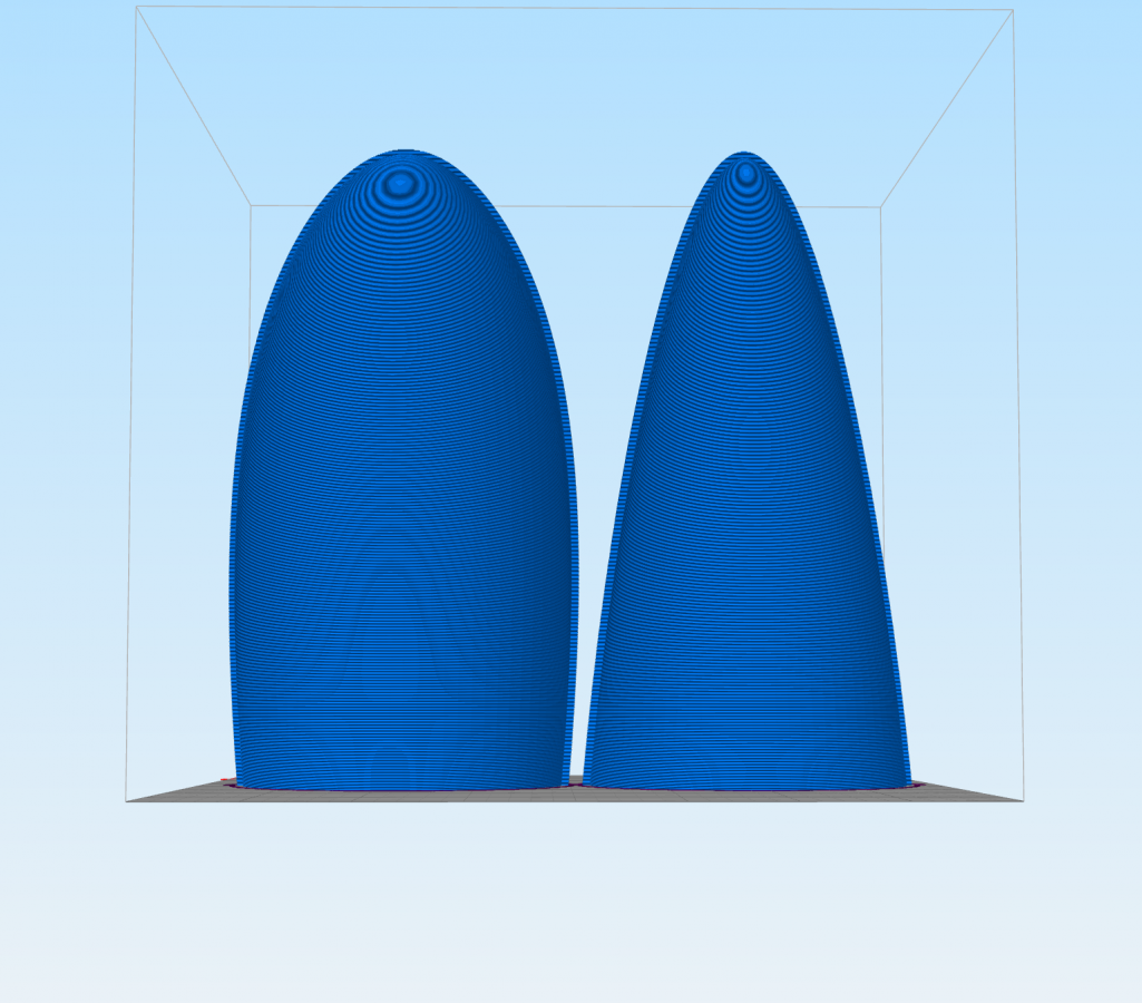

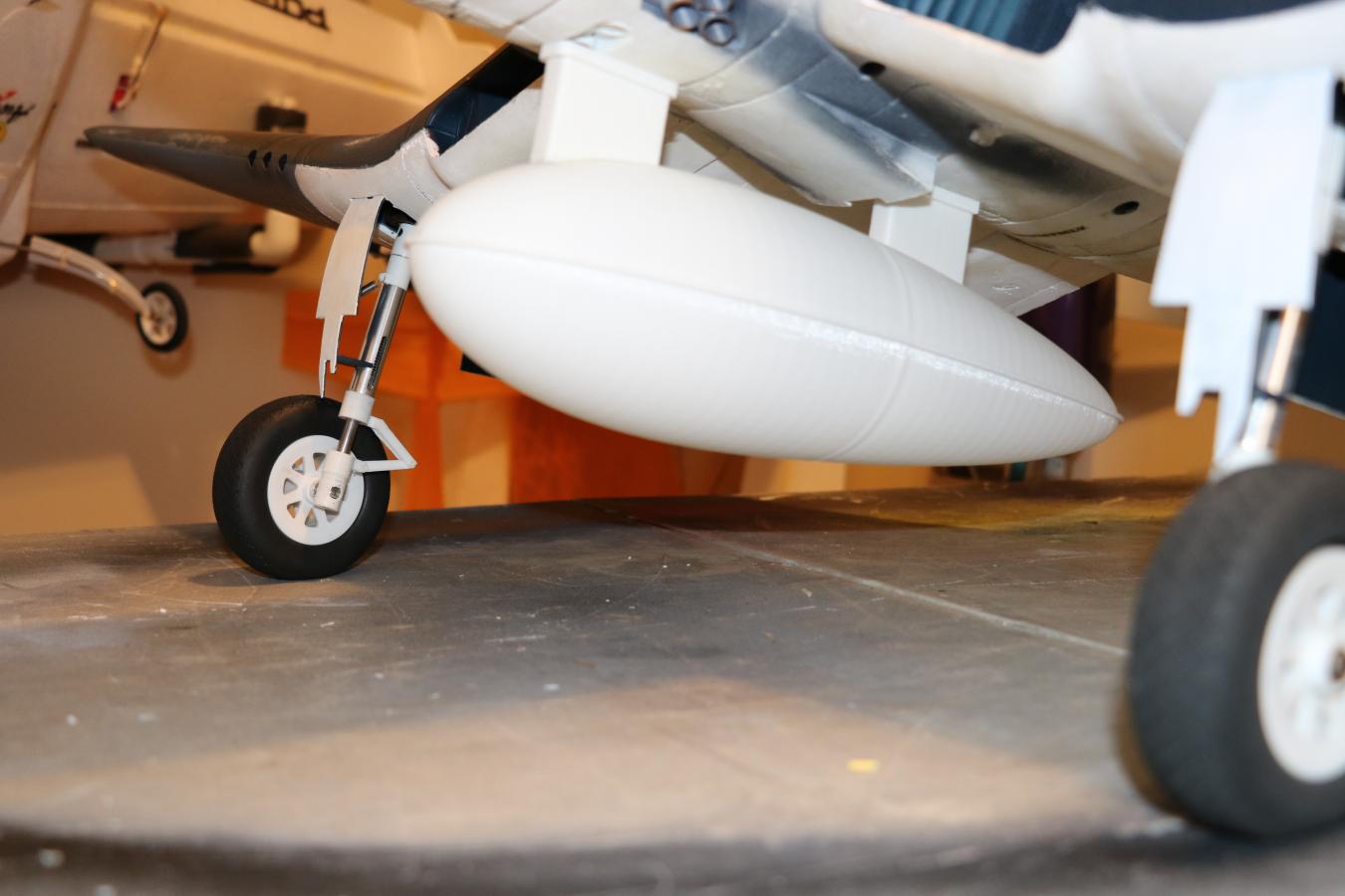

                  I finally finished designing and 3D printing a drop tank and scissor links for my Bubble top Corsair. Installed them today. Happy New Year to All.
                    • 4820
                    #3431
                    IFRCA, Great work, Sir. Looks good to me. What material did you print? Best, LB

                      #3432
                      Thank you LB. Everything was printed in PLA

                          Here are the ,STLs for the strut mod. I used 1.75 filament as pins to hold the links on.
                          The bottom sleeve was printed in half and may need to be scaled up a bit on x and y.
                          Any problems don't be afraid to PM me or ask questions in here.

                            #3435
                            These are the .STLs for the drop tank. I had to print the tank in two pieces lengthwise.(stood it vertically on my bed). I used magnets to join the front tank support to the plane and the rear support slid into it's plate. I used magnets from a crashed F16's cockpit for the front mount.
                            I can modify the front support to slide on. Just PM me if you need it. I don't plan to fly the plane with the tnak mounted.

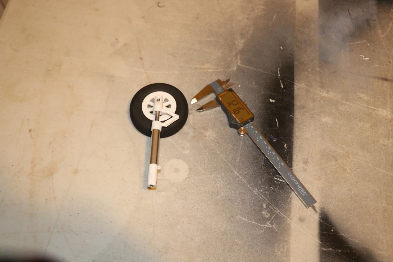

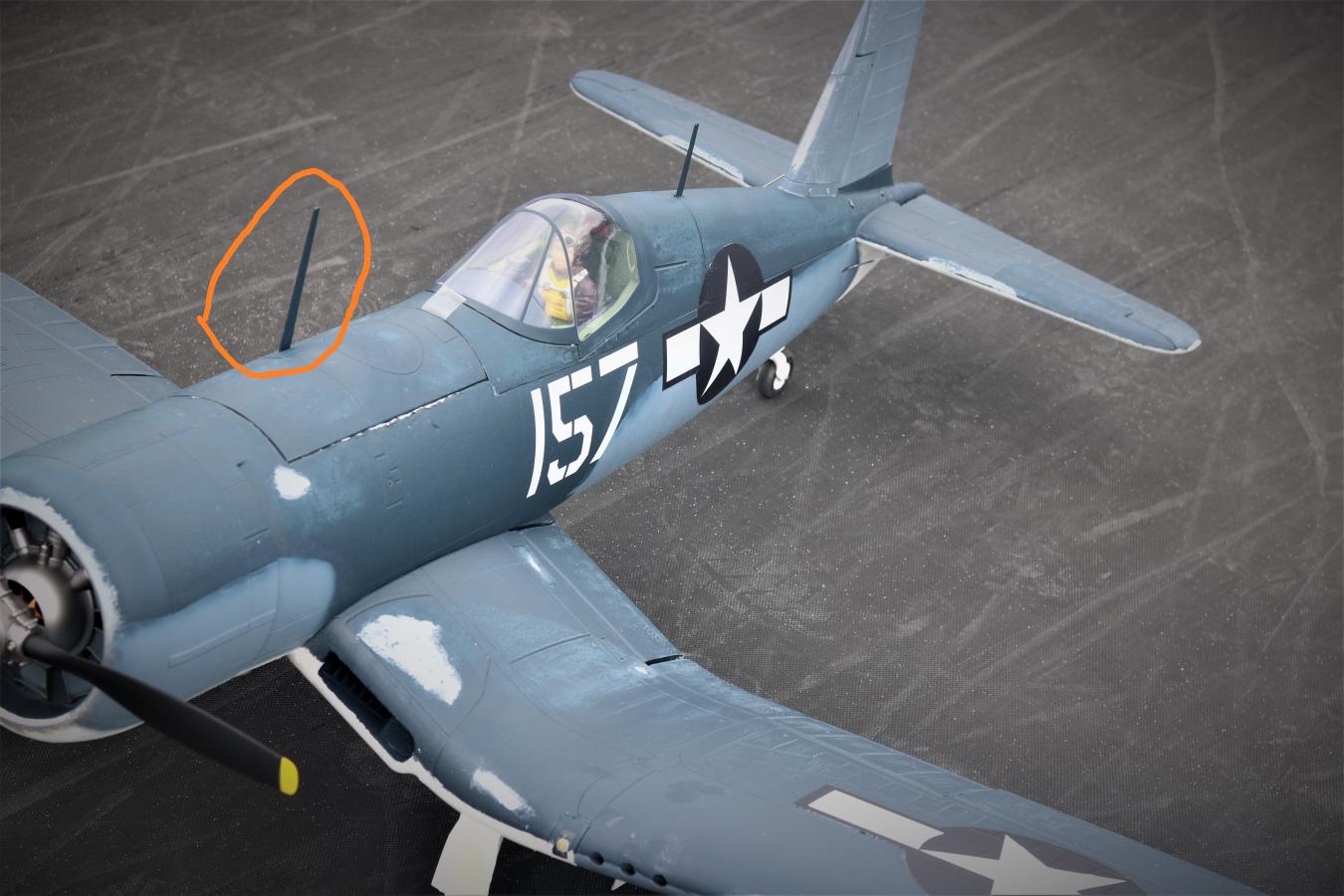

                                Can someone measure the length and width of the front mast on the 1600 mm Corsair?
                                TIA,
                                Tom
                                • themudduck
                                  -TMD- Foaming at the Mouth!
                                  • 1041
                                  • Burton OH (near Cleveland)
                                  #3439
                                  TIA,
                                  Tom
                                  The part that plugs into the plane is 2mm thick, and 11mm x 11mm. The part of the mast that sticks up tapers a bit.
                                  The entire piece is 11cm tall (including the part that plugs into the model)
                                  So its 110mm long x 11mm wide at the base, and 2mm thick.

                                    Thanks man. Lost mine at Fall Nall in the grass but didn't notice it until I was back home.
                                    How did you make out with the scissor links?
