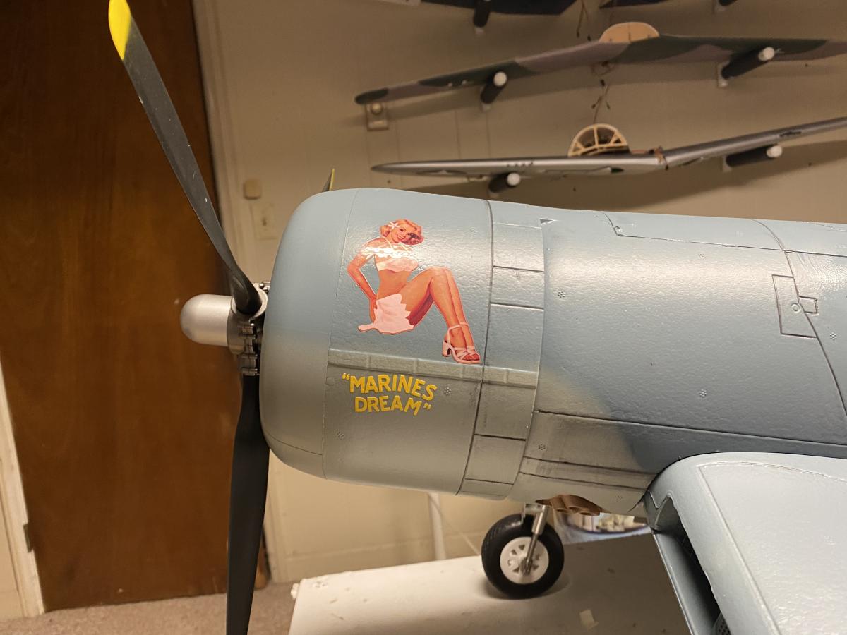

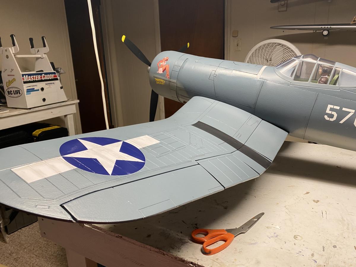

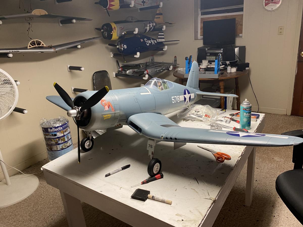

        Joined Hobbysquawk a few years ago but never been really active. Looking forward to being more active here! Here’s my Corsair

          Steppin' outta the shadows! Love it! Great job on the Corsair!

              NCF, Welcome back, some more. Love your livery, like who wouldn't. Bravo Zulu, Sir. Best, LB

                  Thanks!! I’m looking forward to being more active here

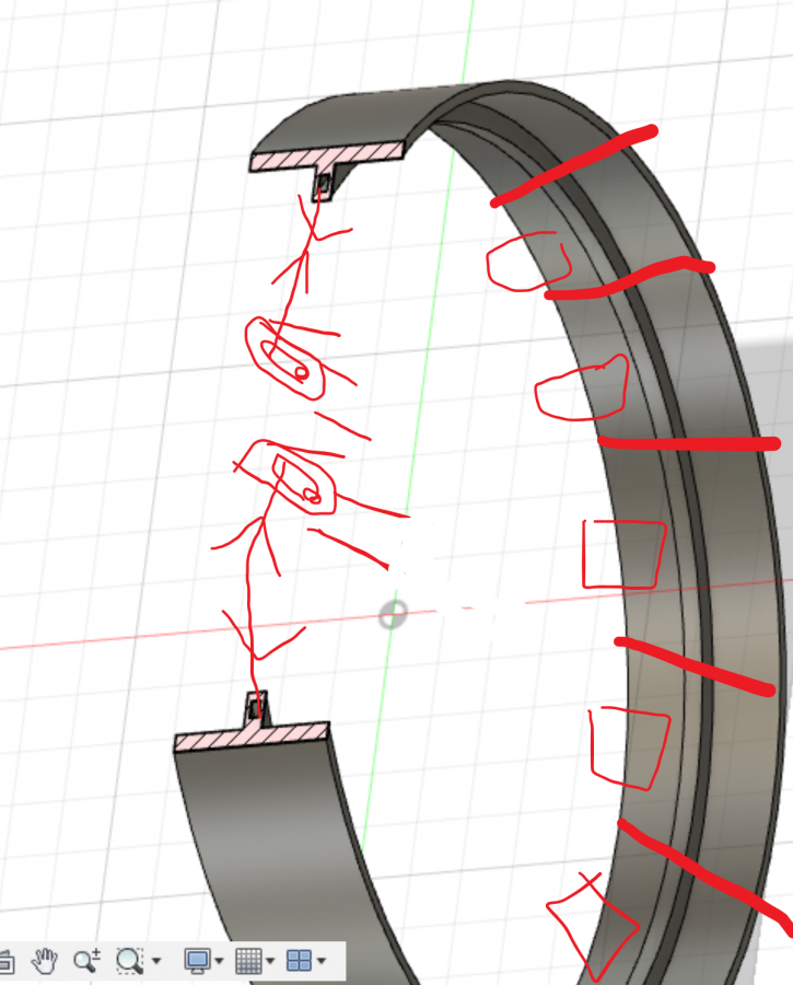

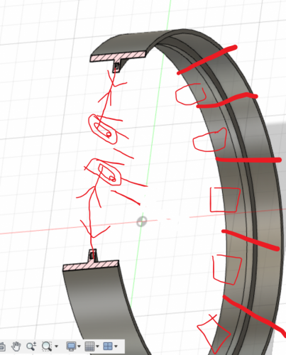

                                      So, been working on the cowl flaps. Printed the ring with a channel for music wire to open and close them. pic shows my design.Tom

                                        Tom, I'm liking it. So the design you have in mind will use a cable and attach to the flaps per the original? Best, Steve
