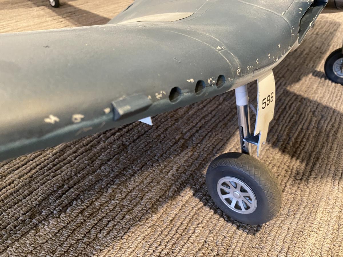

    For any Corsair fans who like to explore the history and development of this classic aircraft, the latest issue (July 2021) of Air & Space Smithsonian magazine has a great article on it.
    Of particular note, and one I found fascinating is how they conquered the problem of getting the Corsair safely onto a carrier deck. In a few trials with a test pilot, they met with near disaster as the plane wanted to suddenly and violently drop its left wing and roll to the left, just short of landing on the carrier! This would be a fatal flaw, and early on, the plane was relegated to land based assignments, mostly with the Marines.
    The fix seemed to be a little triangular piece of metal, 6 inches long, that they put on the leading edge of the Right wing. It was called a "stall strip" and allowed the right wing to stall at the same time as the left wing, hopefully a couple inches above the deck of the carrier for a safe landing!
    I have built several Corsair airplanes large and small, and have always included this stall strip, mainly because I was so impressed how they managed to figure out the problem and save the airplane to be able to land aboard carriers, a primary goal from the very beginning.

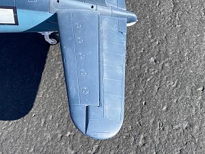

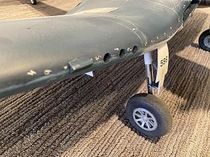

    I'll attach a photo of the stall strip on my Flightline Corsair, and a couple of photos from the latest A&S Smithsonian article. Well worth reading, if you have the time and interest Click image for larger version

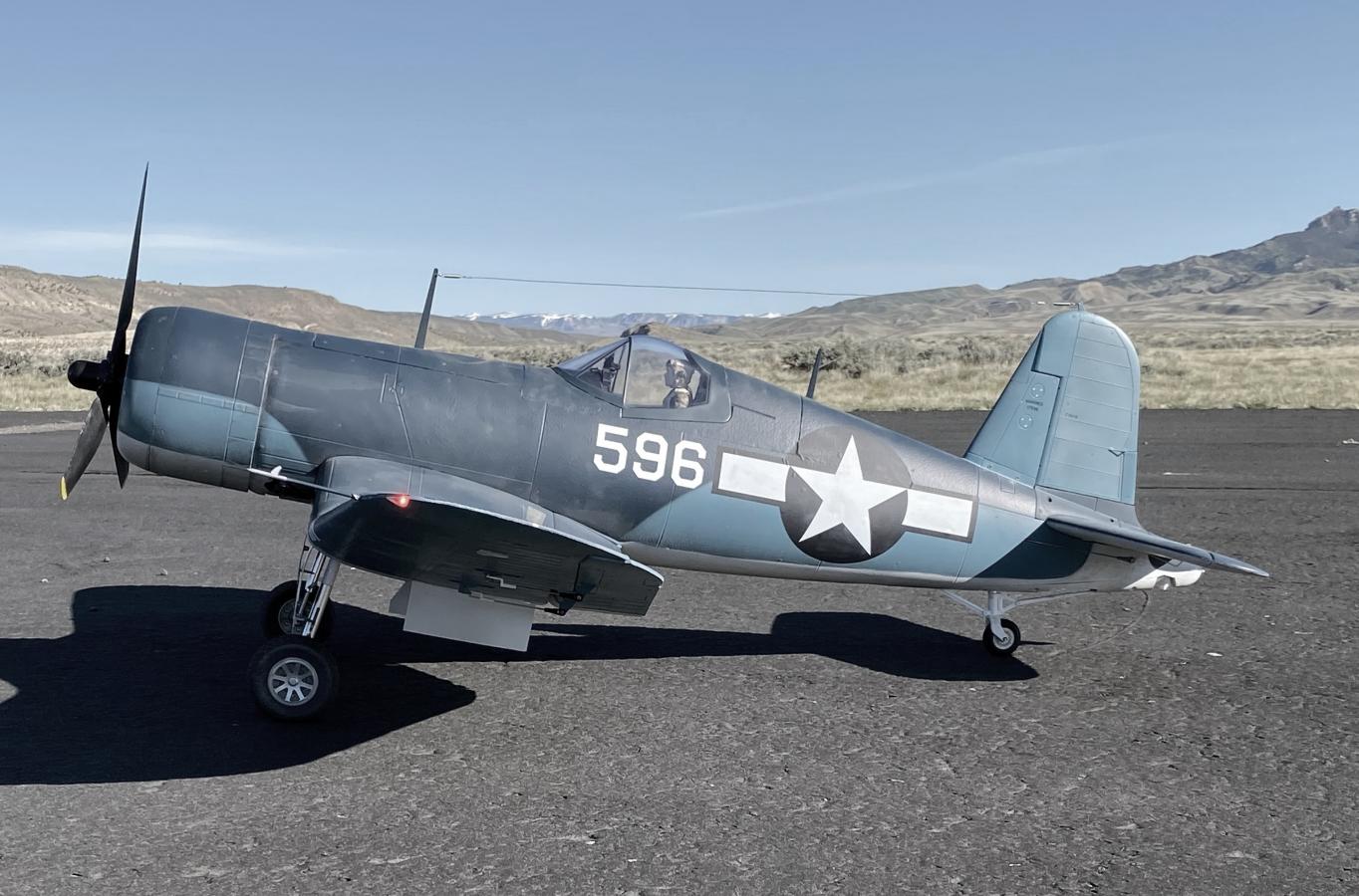

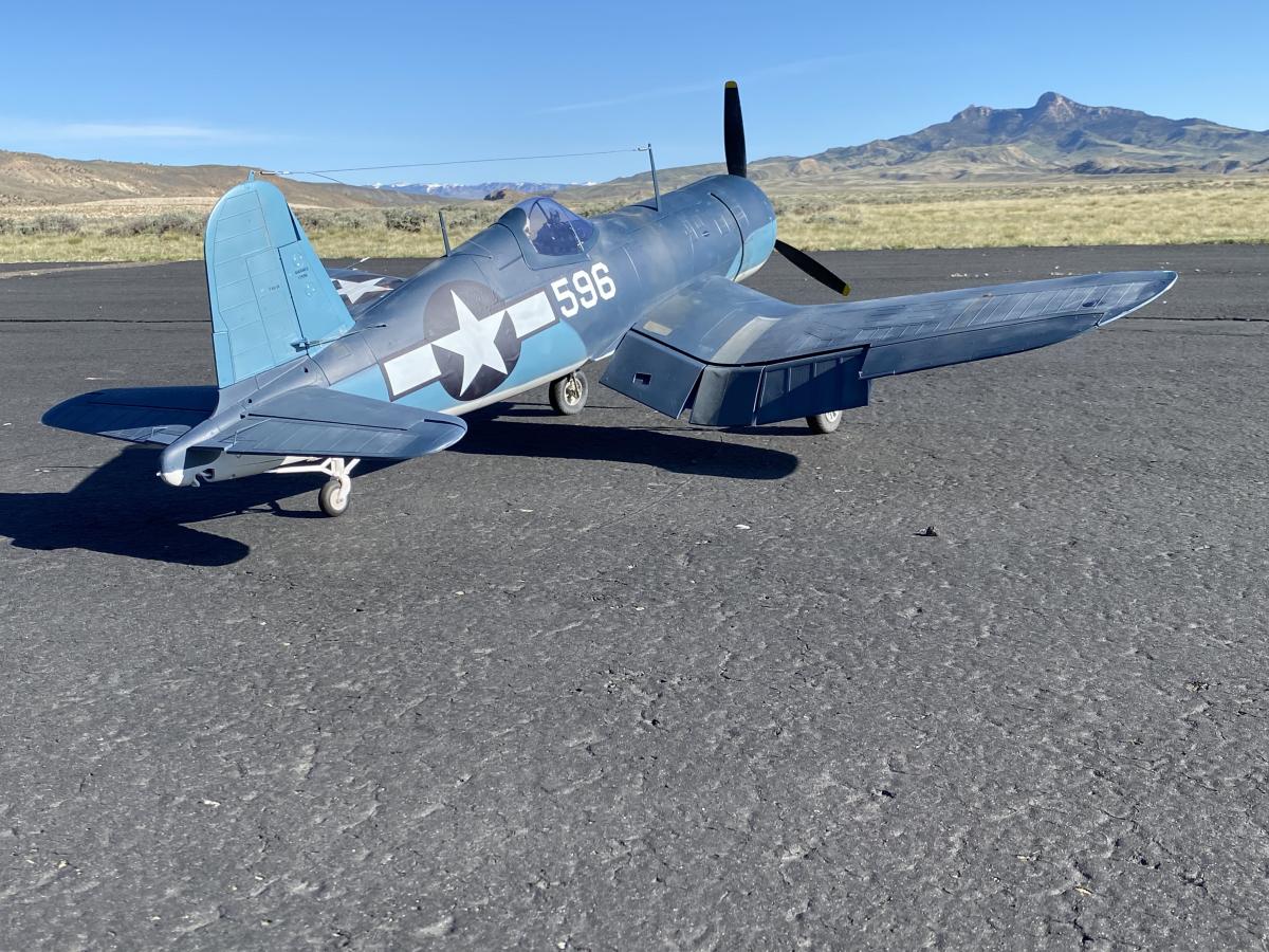

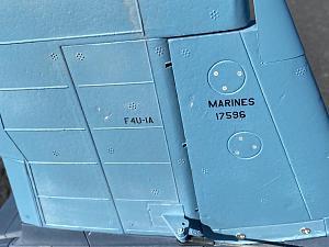

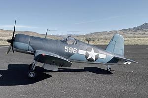

            Successful Maiden this morning!! I went out early to the field to do the final checks and then try the maiden on my new Flightline Corsair. I don't really like doing the maidens on my own airplanes, prefer to have a better pilot than me at the sticks on that first foray into the air. But, since that isn't possible these days like at my old field, I have to bite the bullet and see how it goes!
            The Corsair took off ok, still need to work on the overall flying from takeoff to landing. I did install the 3.5" Robarts for the mains, I think that helped. They got a bit loose by the end of the second flight, although the second landing wasn't all that bad, a two-point, tail low like I usually try to do these warbirds.
            I had WAY too much elevator and aileron throw in at first, even in low rates, per the manual. Once I got it back on the ground after the first flight, I dialed them down quite a bit and I think it flew much better.
            So, that hurdle has been jumped, now to continue to work on flying it better and getting used to it some more. I now have this plane to add to my FMS 1500mm P-47, and the E-Flite P-51, and Flightline Spitfire that I now fly of the tailwheel warbirds.
            Took a few pics at the field of the Corsair with my I phone, not the best for lighting being early morning, but you can at least see it.
            Oh, and this being Memorial Day weekend, I couldn't leave out that this plane is based on one flown by the top ace in the Corsair aircraft, Lt., Robert M. Hanson, USMCR. He scored 25 kills in the Corsair in just a matter of months in 1943-44. Sadly, he was shot down on a fighter sweep in the Solomon Islands in early February 1944, the day before his 23rd birthday. He was due to ship home in just a few days. He was awarded the MOH, posthumously.

            davegee Click image for larger version

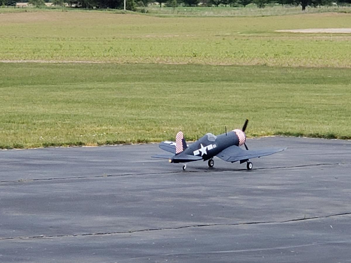

                          Finally got the Corsair redone in the colors of the FG-1D from the Kalamazoo Airzoo! Takeoff in a 15 mph Left hand crosswind was Not successful. The Damage sofar is the Right retract and Maybe a slightly bent prop shaft. Now to wait for parts!

                            Originally posted by KC8REH
                            Finally got the Corsair redone in the colors of the FG-1D from the Kalamazoo Airzoo! Takeoff in 15 mph crosswinds was Not successful. The Damage sofar is the Right retract and Maybe a slightly bent prop shaft. Now to wait for parts!
                            Bummer, some of us, including me, have been there. Just have to get back up on the horse! I've found that the only crosswind I'll take-off in with the Corsair is a wind coming from the aircrafts right hand side. This directly opposes the Corsairs natural tendency to take a hard left from the prop wash when the tail lifts up and it is easier to keep on the runway than a crosswind from the left, which is almost impossible. On the other hand, that wind from the right also tends to lift the right wing first, which is also the same direction that the Corsair goes in a stall when it drops it's left wing. On second thought, I'll stick with a headwind!

                                Originally posted by davegee
                                I'm good going with the Headwind, or No wind!!👍
                                Today's Crosswind was from the Left! I should have known better than push a bad situation but I wanted to get some flight time on it and also some inflight pics. Oh well, I will get it fixed and try again!
