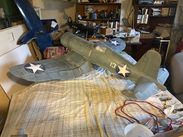

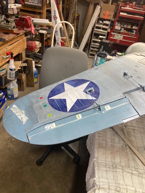

    Cleaned off the chalk where my stars go and can't believe how much weathering chalk came off in those areas. A muddy mess .LOL Now I will go back and add the weathering over this.
    Rex

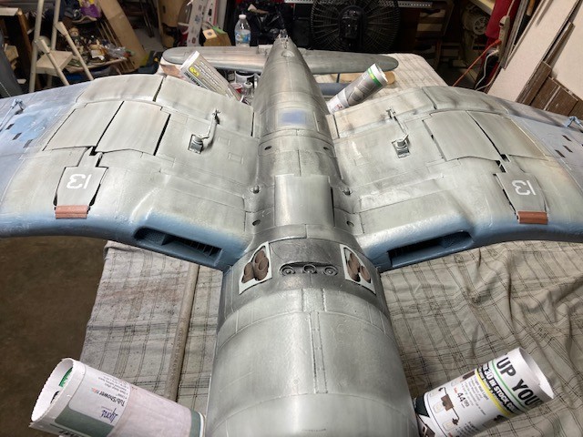

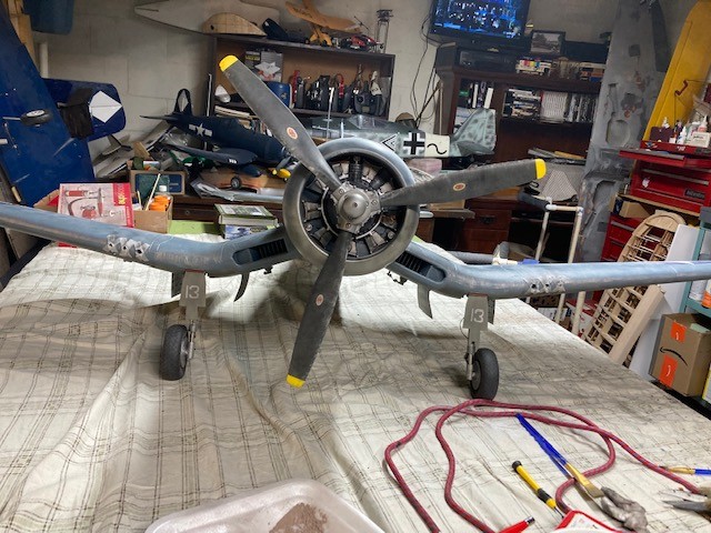

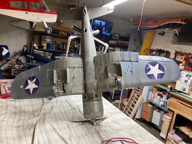

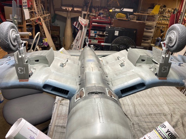

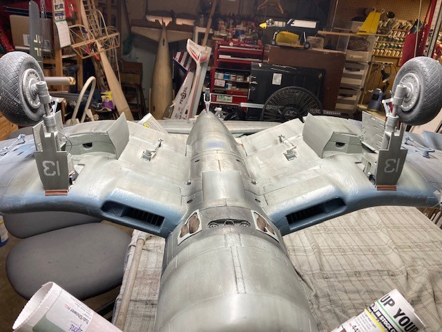

    • Sunshine shining thru the shop window this morning. Started weathering the bottom today. Lots of coral dust on the bottom, oil seepage on bottom, oil/grease stains from flap hinges, ect. Exhaust shrouds need to be imbedded in the foam. Exhaust shrouds are the original paint that the bottom started out as, sure has changed. Will spray the exhaust stain last. May tone down the weathering tomorrow after sleeping on it.
      Installed the leather strut cover they used on the original. Retracts work fine with this added and the cover looks like my photos
      Still need to add the mud splatters on lower fuselage.
      Best Regards, Rex

      You can see the leather covers on landing cover

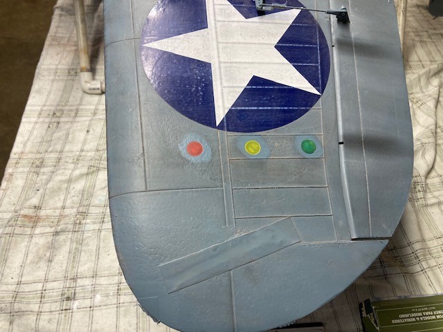

                  Identification lights

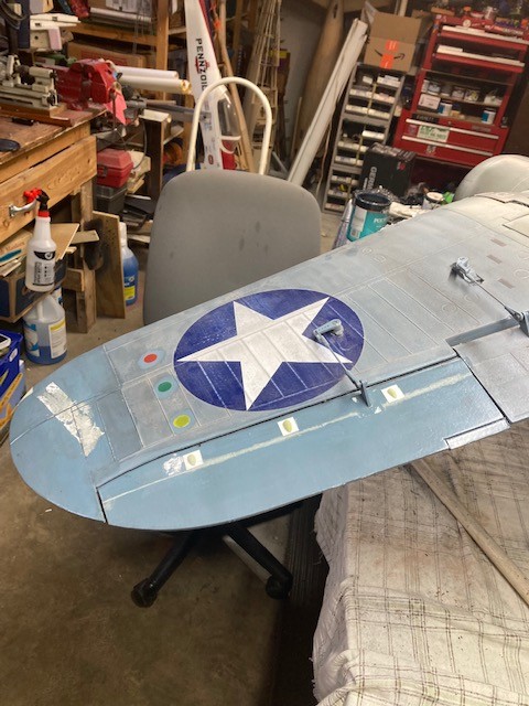

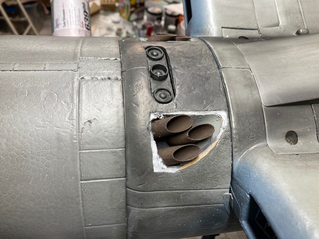

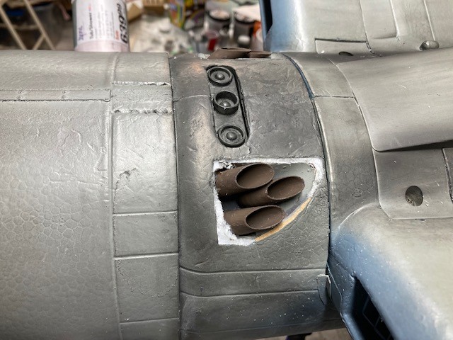

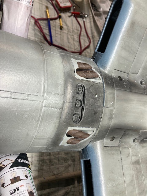

                  • Installed the shrouds around the scale exhaust. Will need a little filler and sanding then I can weather this. Thank you Elbee for the scale accessories. Rex

                      That really looks great, Rex! I really like the mottled look as part of the weathering scheme, very close to what the real ones looked like under those conditions.
                      The only thing I would correct (and probably very few people would even know) but the proper sequence of the identification lights from front to back is RED, GREEN, and Amber at the very back. But who would know? Looks very sharp!

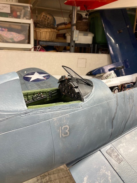

                      • She looks awesome, Rex. I remember not too long ago you couldn't wait for Christmas Day to open the box. Now, we're in March and watch how much you accomplish already.
                        • Thank you, Coconut This has been an enjoyable journey. My favorite airplane and FL has produced a quality Corsair that has unlimited possibilities. Stock or modified it is very impressing.
                          Retired so I spend 4-8 hrs a day working on it and looking at all the other Corsairs on the net. Everyone is impressive!
                          Still need to finish cockpit and more details as I find them. Spring is coming and impatiently waiting to do taxi tests, system check, engine synchronization, C/G. Also need to fly some practice planes before the maiden.

                          Davegee, Thanks for pointing that out to me. I had it layed out correctly but had a BRAIN PHART. I have since corrected. Also noticed from your picture I had not filled the lower aileron seams or added the hinge covers. Tomorrow I will remove the weathering and start over. I have added the gun camera too.
                          Nice to have a senior flight officer point out I need to use my check list.

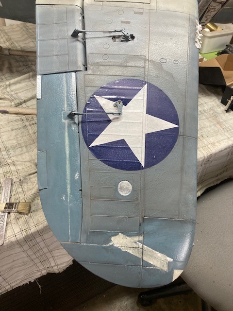

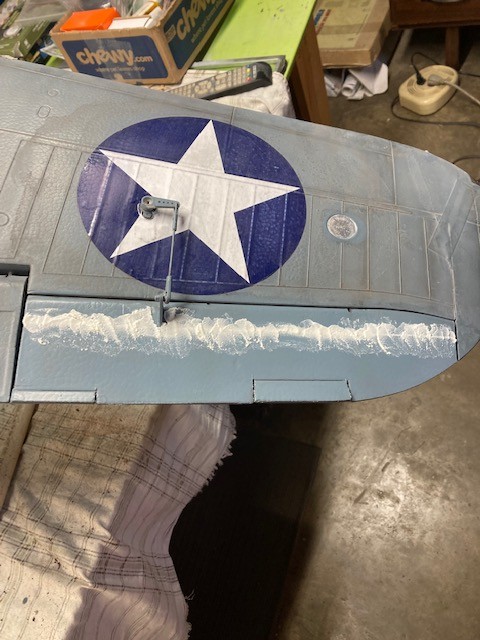

                                  Guys I started to install the cockpit today and I also decided to redo the aileron seams on the bottom. First cleaned the weathering off, then added filler. Will sand, add polyurethane clear to harden the filler and repaint. Then re-weather it again. Funny how dirty the original paint gets after weathering.
                                  Best Regards, Rex

                                  • Grossman56,
                                    Just jump in with the chalk weathering. I wasn't sure at first but as you can see if it isn't what you want just clean off with wet paper towel and start over. Davegee has been a great inspiration to me. Rex

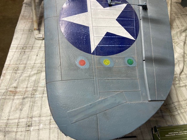

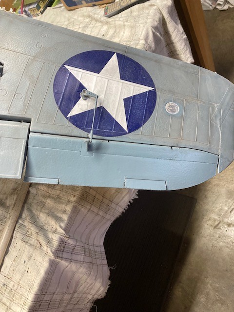

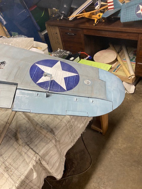

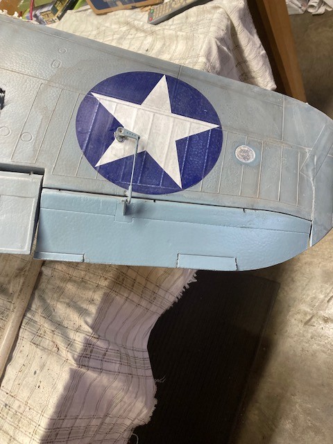

                                    • Been a few days but I have filled the seams, sanded them out. Applied 3 clear coats of polyacrylic and added the hinge covers. I applied new paint and will weather this area again, Getting down to the final weathering Sprayed the exhaust stains on bottom of fuselage. Best Regards, Rex Click image for larger version

                                        Looks awesome, Rex!! Really like that you redid the tape on the wingtips. I never liked that on the model.
                                        Cheers
                                        davegee
                                        • Thanks, Davegee. I forgot to remove the tape and fill the seams when I bagan. It looks a lot better now. Thought the exhaust would have more gray smoke but most photos show mostly black.
