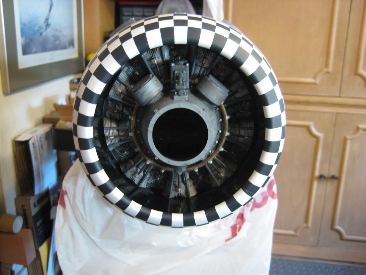

    Even without 'hacking foam' it is a thing of beauty.
    Bravo Zulu to each of you.
    Best, LB

      Yes absolutely incredible rendition of the r2800

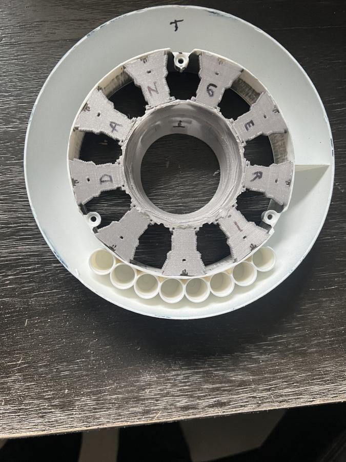

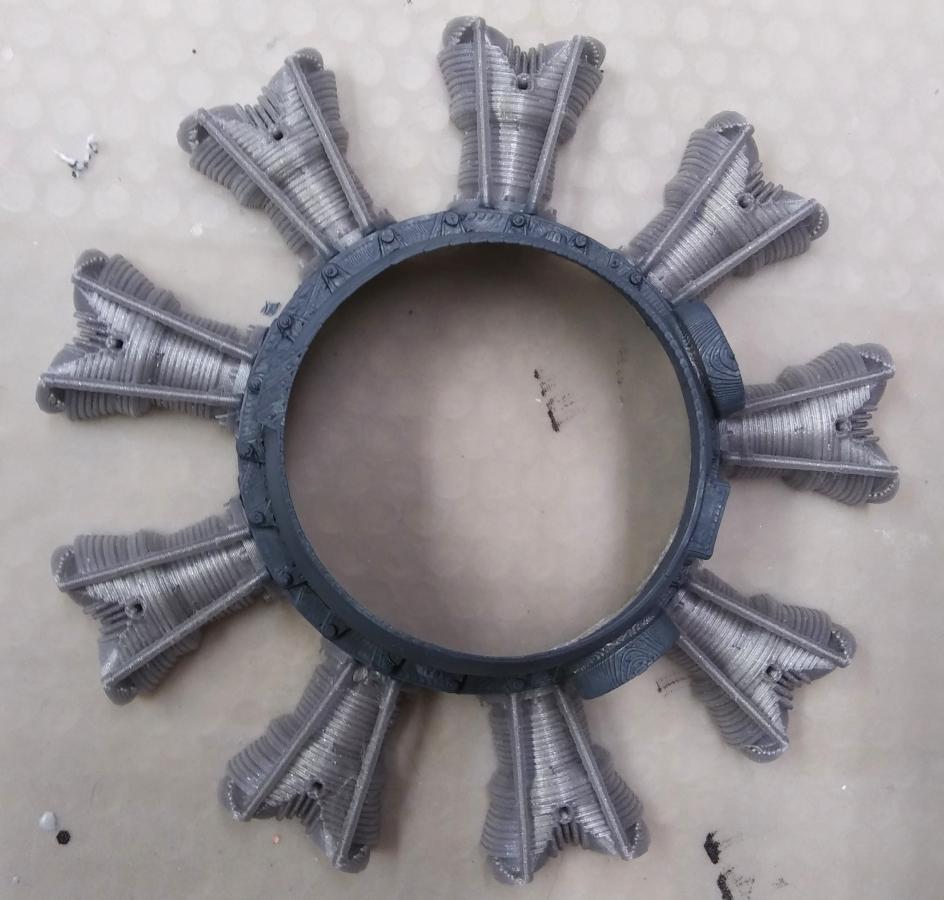

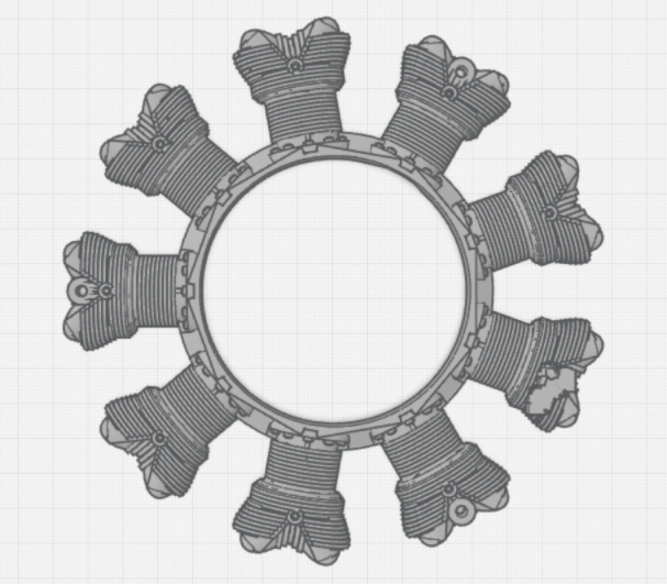

        When Dave sent me those pics, taken at our field last week, I just sat and stared. It looked so real!
        The original bellhousing is really long and in order to get it to fit over the motor with enough clearance and to meet the maximum length of the overall project ( which was around 2.5"), we had to leave a fair amount of the front of the motor open, what we gained for the sacrifice in looks was the amount of air cooling flowing across the electric motor, a good trade off.

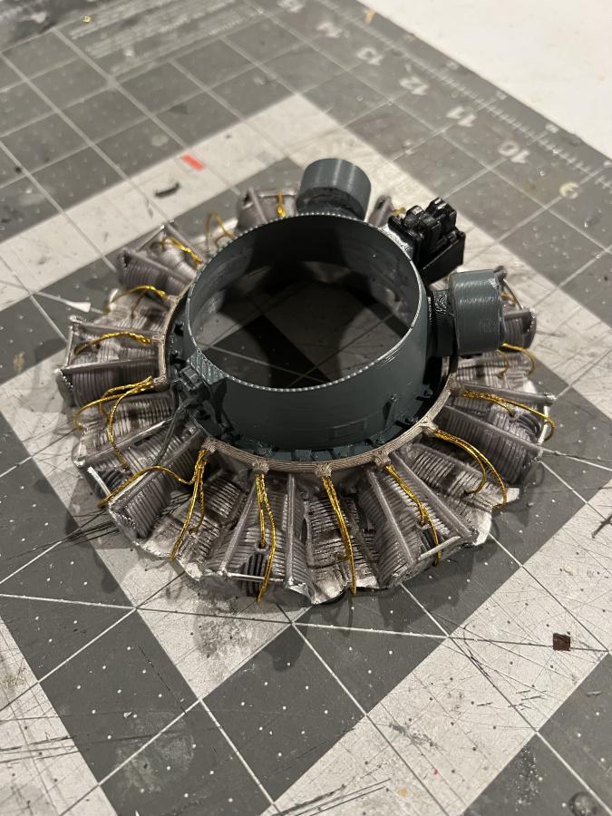

        Here's a shot of the bellhousing with the front row of cylinders glued on:
        Click image for larger version  Name:	20250429_155726.jpg Views:	0 Size:	80.3 KB ID:	425404
        Then, I washed the cylinders down with black and placed it onto the photo of the back cylinders.
        Click image for larger version  Name:	20250430_163225.jpg Views:	0 Size:	40.6 KB ID:	425405
        I used some elastic thread, the kind you find on greeting cards, for the spark plug wires, unfortunately for me, I had to use two different kinds, they were different shades of gold so I decided to go black and be a little different than Dave's. BTW, I designed the ring that the wires come off of.
        this is what the rear cylinders look like:
        Click image for larger version  Name:	rear cylinders 3.1.png Views:	0 Size:	457.3 KB ID:	425406
        I just printed it off on photo paper in black and white and it worked quite well. A lot easier than trying to get a proper picture.

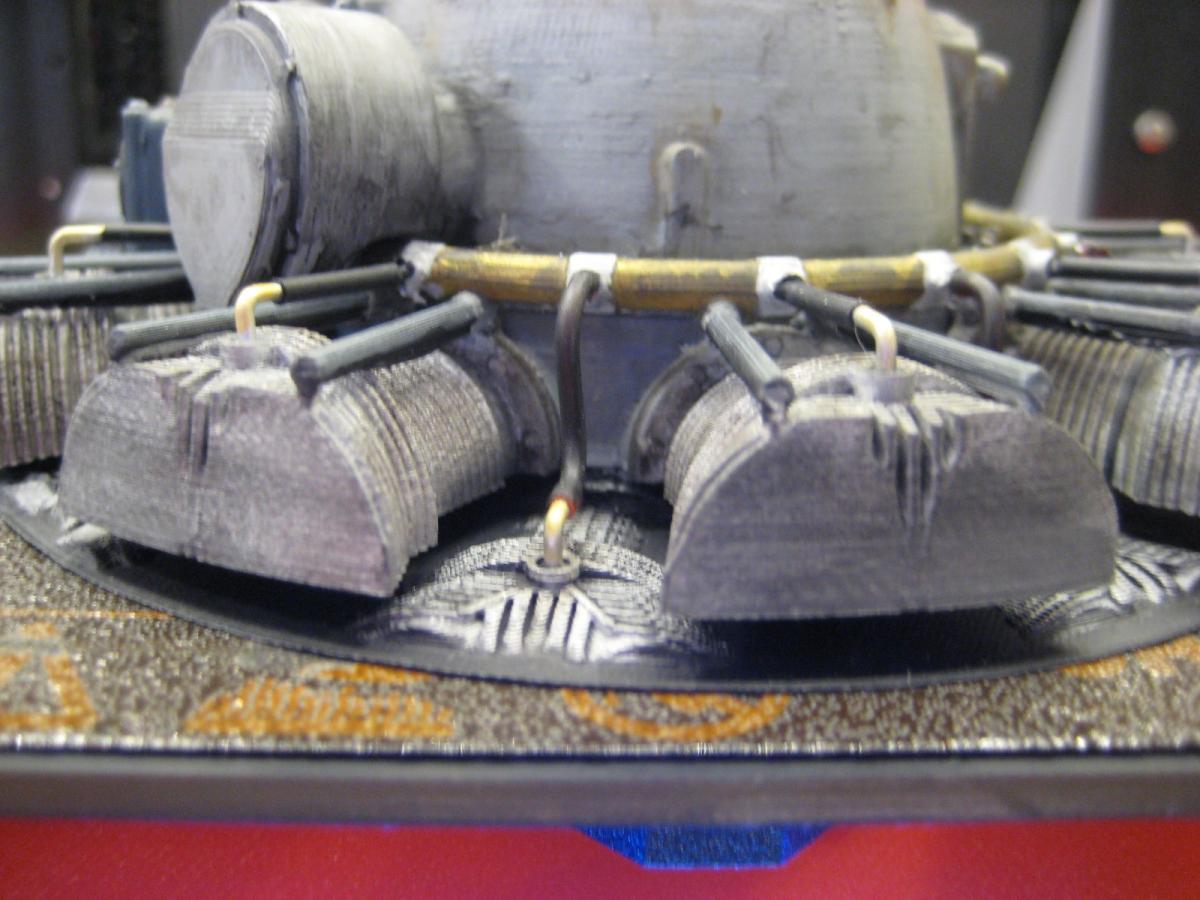

        Here's one of the concepts we tried using the 1/8th" thick rear cylinders:
        Click image for larger version  Name:	IMG_2753.jpg Views:	0 Size:	95.0 KB ID:	425407
        And these are after removing the original motor from the cowling and trial fitting the new motor:
        Click image for larger version  Name:	IMG_2787.jpg Views:	0 Size:	126.9 KB ID:	425408 Click image for larger version  Name:	IMG_2788.jpg Views:	0 Size:	103.5 KB ID:	425409
        This is Dave's finished product, all ready for final installation:
        Click image for larger version  Name:	IMG_2796.jpg Views:	0 Size:	106.4 KB ID:	425410

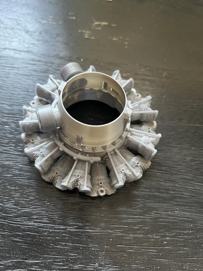

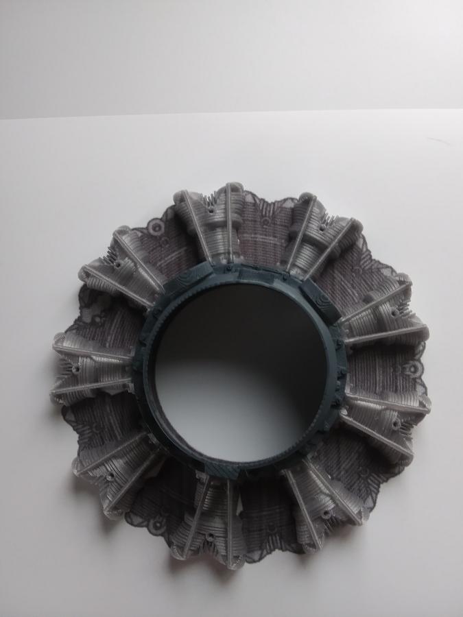

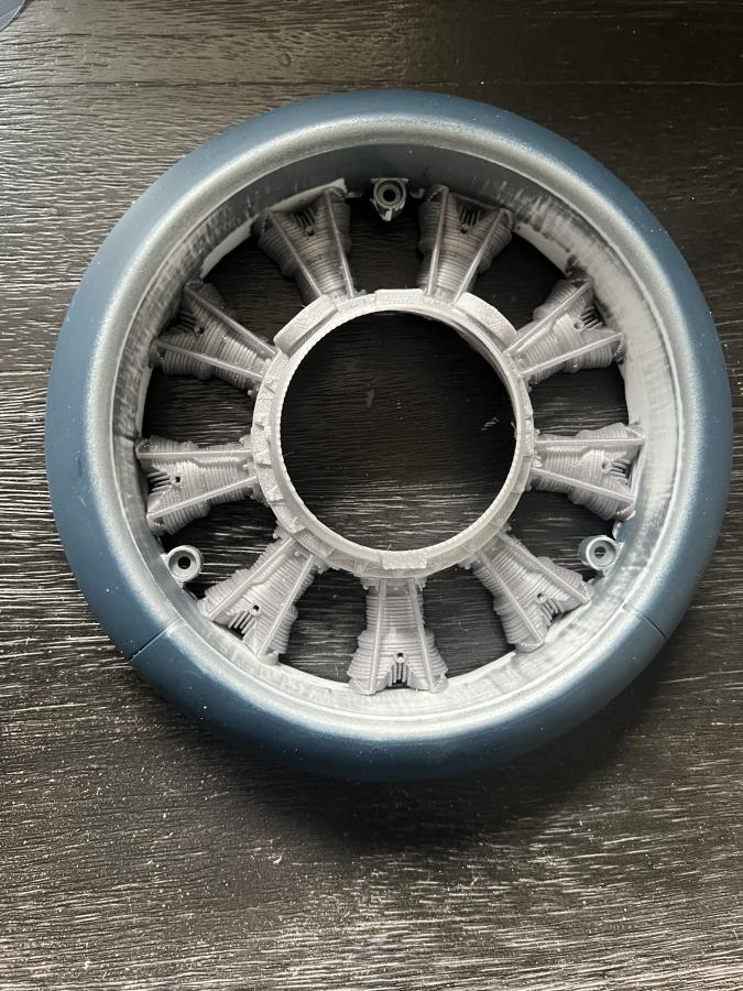

            With all due deference, cutting back the foam allowed for a longer bell which in turn allowed for a smaller opening for the electric motor.
            For my build, this also allowed the first cylinder row to set back closer to scale location aft of the cowl ring.
            I compensated for the motor thrust line offsets and the tighter tolerance at the motor by angling that portion of the print to match the thrust line offsets and prop adapter.
            Different strokes for different folks.
            I love the idea of the photo for back row of cylinders which have saved me about 1/4" of foam surgery.
            Again, really nice work gentlemen; you guys are awesome.
            Best, LB

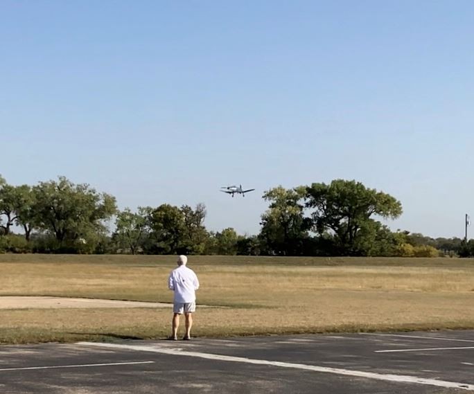

                          ps: I did my first check flight in Aug and loved it.
Name:	Corsair First Check Flight.jpg

                                      Hugh Wiedman
                                      You impugn my honor, Sir, KJP took that photo.
                                      Best, LB
Name:	Corsair First Check Flight_2.jpg
