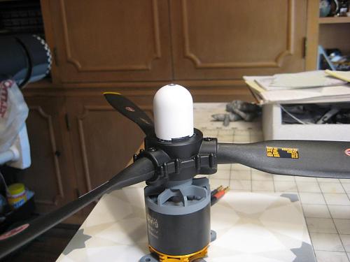

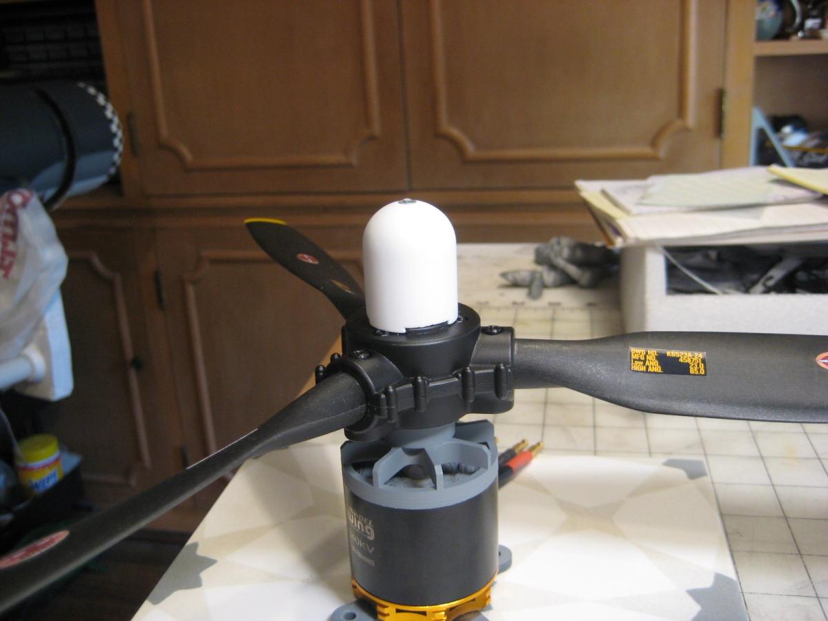

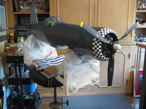

    Corsair Crew,

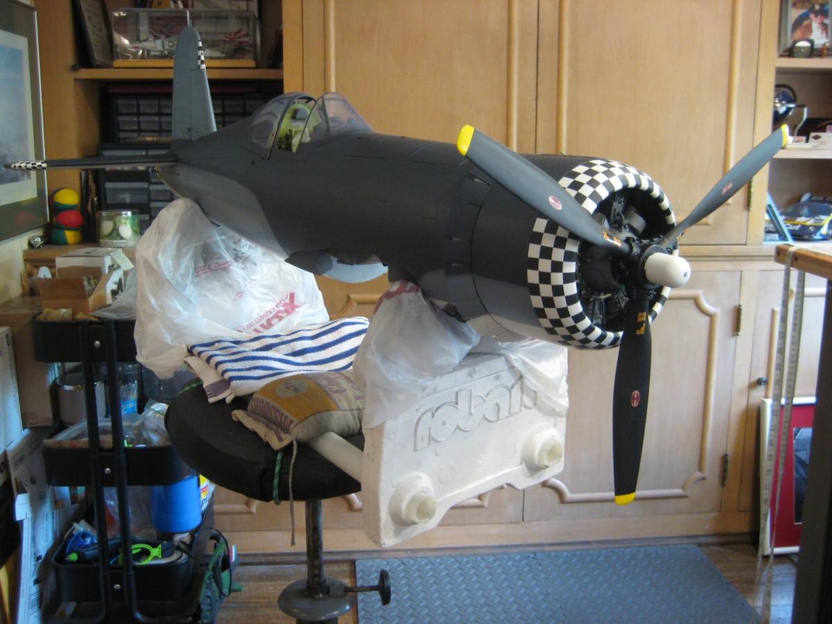

    Here is a picture of the 'modified' Corsair Spinner.
    It is a bit smaller and looks less "Bozo Nose" IMHO.
    It uses all the OEM hardware.
    I wiped it down with Acetone, primed and sanded it, then finish color.
    It fits like a dream.
    I will email the G-Code for a Prusa Mini to Grossman56 / davegee if y'all want it.
    Best, LB

      Looks good Elbee!
      I've just been looking for the STL files that you made to augment the Spitfire cockpit. Are they available?

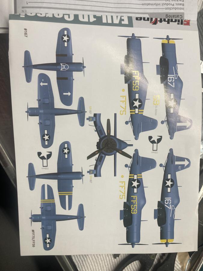

        Beatlerat,
        Here is the FL Corsair decal sheet that came with my model. Hope this helps

          Those sheets alone are works of art, don't throw them away!

                Awesome! Thanks!

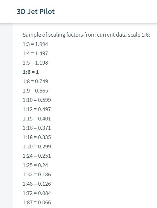

                            Danger,
                            If your GI Joe is 12" he's considered 1/6th scale,i.e., 72" dude = 6'/1' = 1/6th scale'
                            72' man / 10" figure is 1/7.2 scale
                            72" dude / 8" figure is 1/9th scale and so on.
                            So, whatever height your figure might be divide that number in inches into 72" for 6' dude and you'll be close enough.
                            Make sense?
                            The FlightLine Corsair is what...1:8th scale. so if you want a 6' (72") pilot you'd simply divide 72/8=9 and your fully standing pilot would need to be 9" overall.
                            The FlightLine B-25 is listed as 1:13th scale but is closer to 1:12.8 averaging the scaled wingspan and fuselage length into a single number.
                            I scaled my design parts to that and it is working out nicely.
                            Best, LB
                            PS:BTW: Max Greuter includes a Scaling Chart for his 1/6th pilot figures. See attachment.

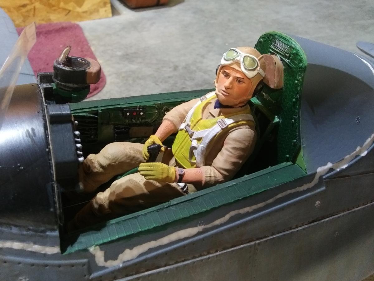

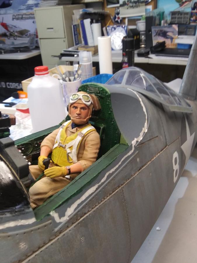

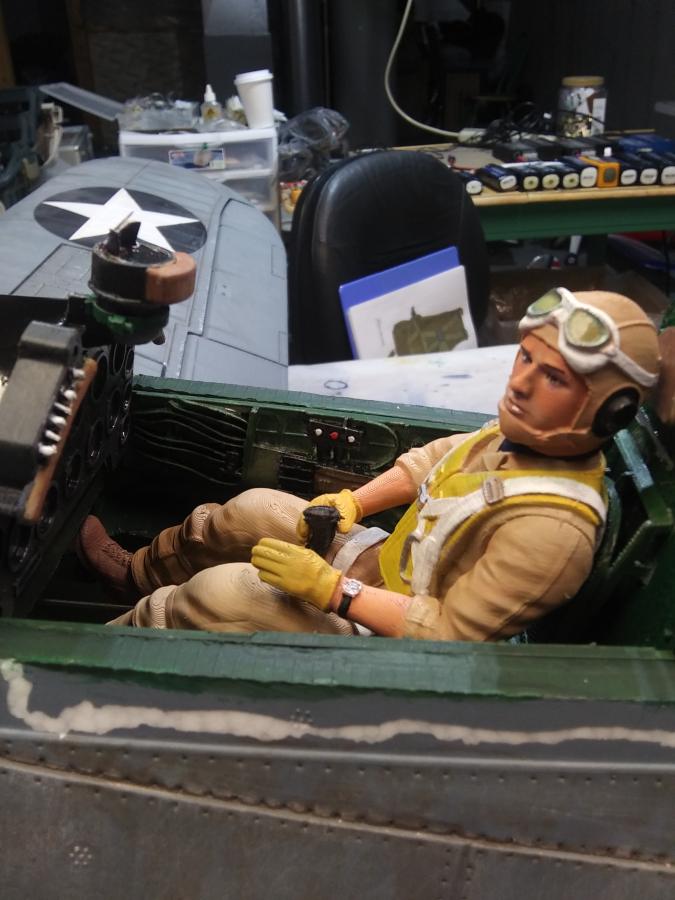

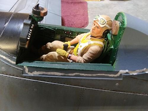

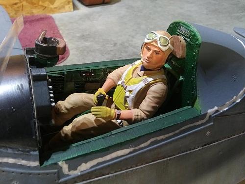

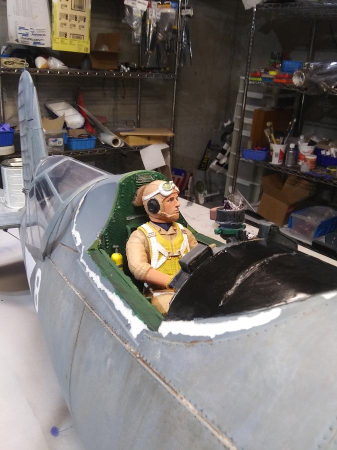

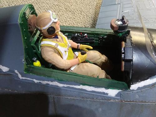

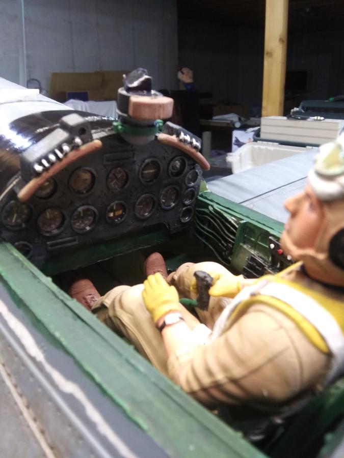

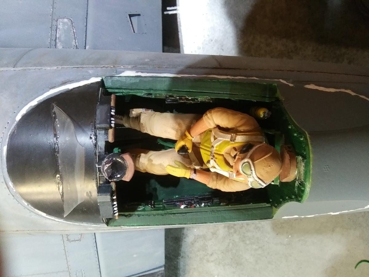

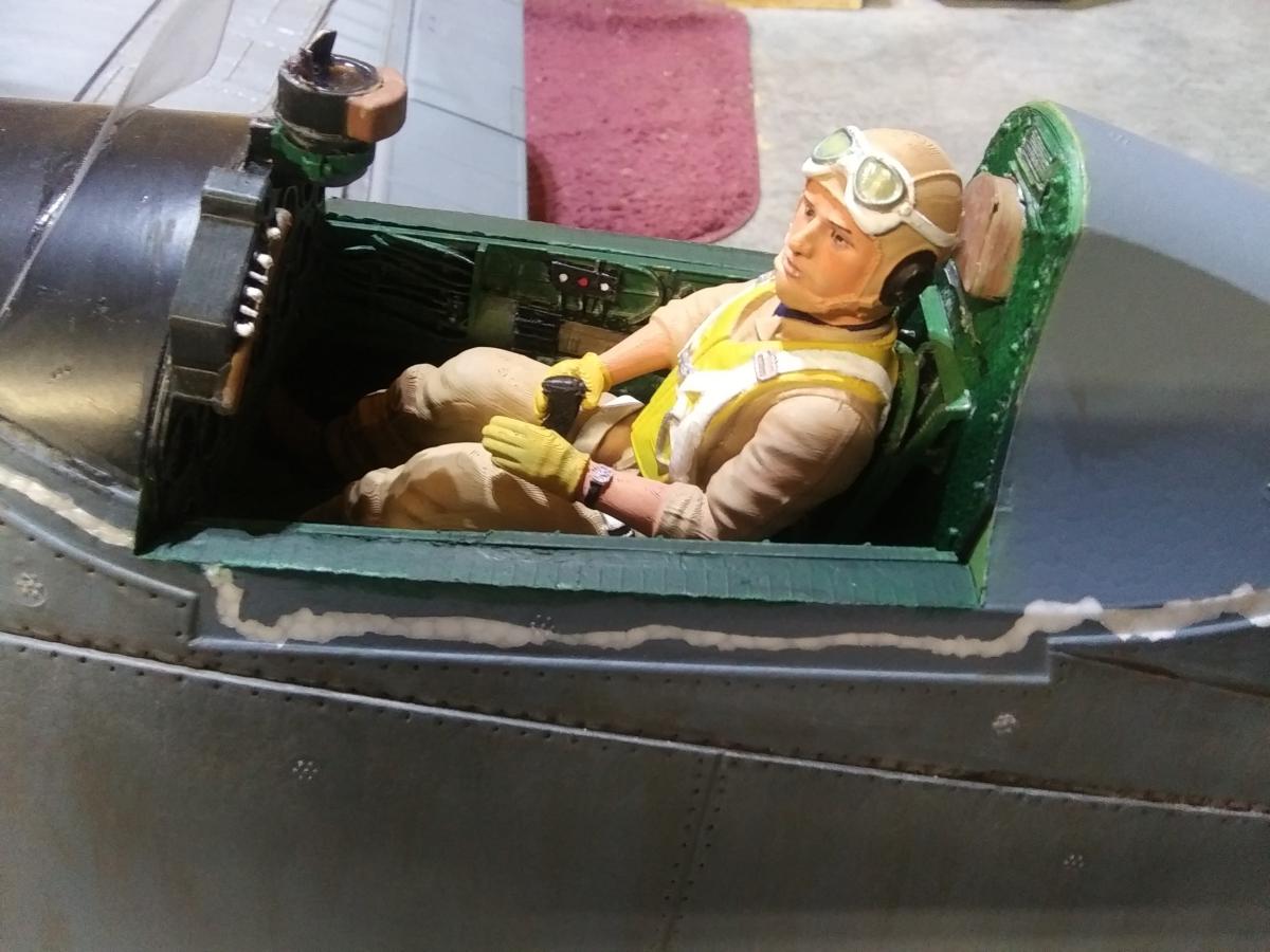

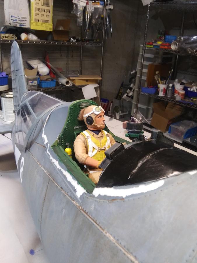

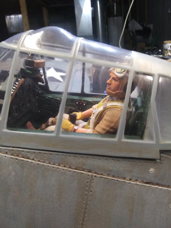

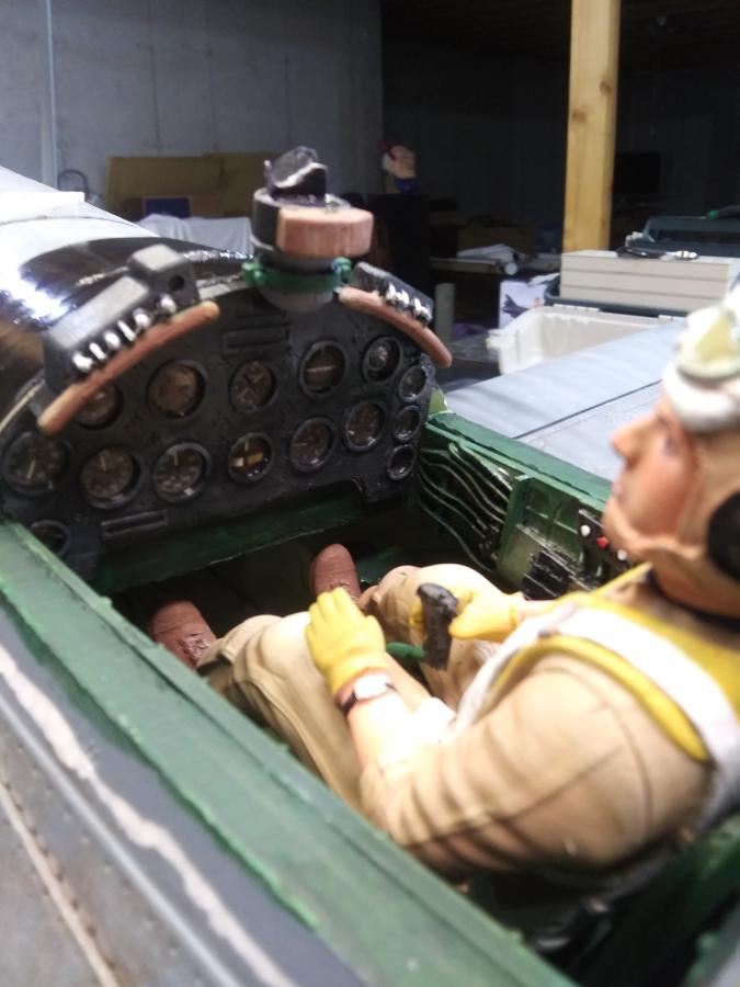

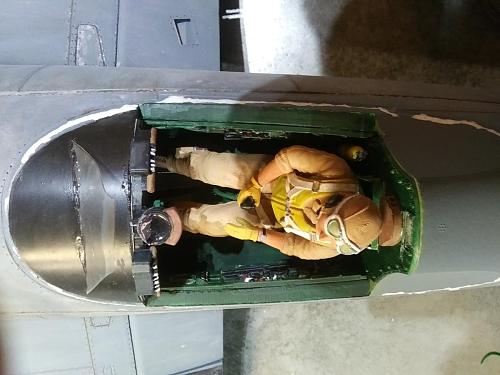

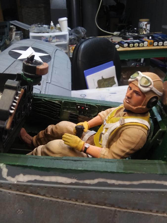

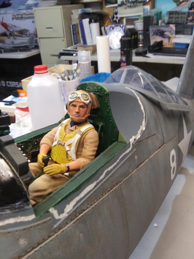

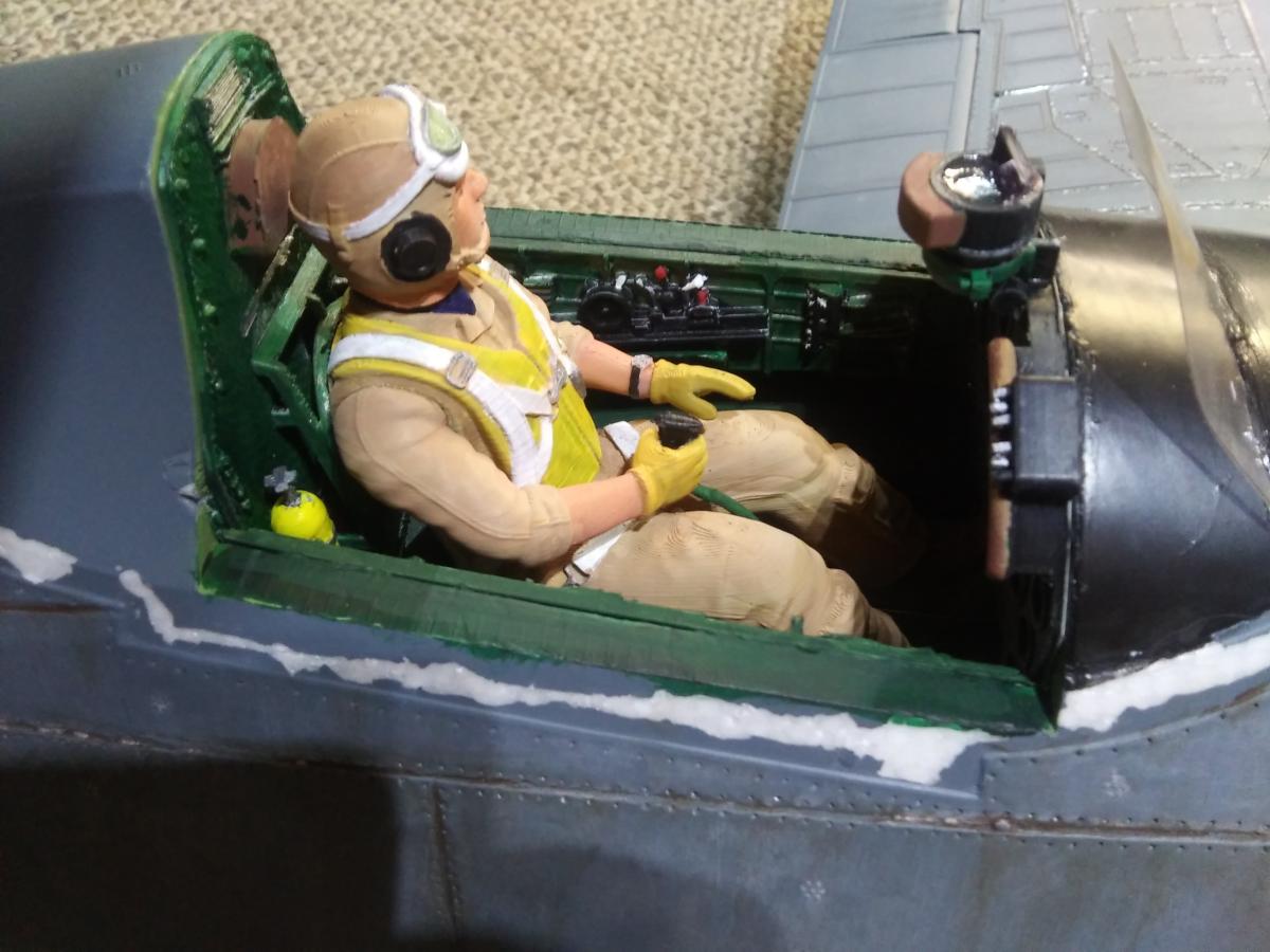

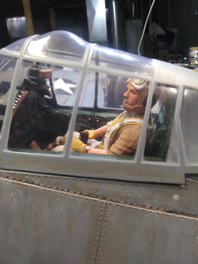

                              The man in his cockpit. One more piece coming, the frame around the bullet proof glass, then he gets sealed in.
ID:	420010 Click image for larger version
ID:	420011 Click image for larger version
ID:	420012 Click image for larger version
ID:	420013 Click image for larger version
                              Thanks for the inspiration Rex, Steve and Dave!!
                              He looks just like ME!!
                              (Dangerous Dan)

                                Looks very nice Dangerous. Your going to have a beautiful aircraft.
