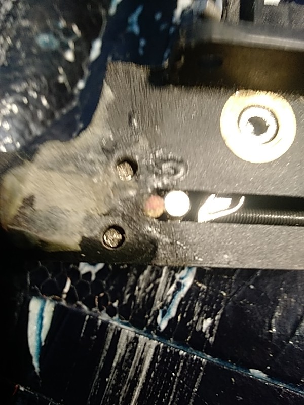

    • Well, an interesting day at the field to say the least. Had the Corsair up and flew fairly well, although we seemed to have some good breezes at around 100 feet. Made the rooky mistake of landing short of the runway (I believe that's a first for me). I managed to snap the pin that attaches the retract to the strut, fortunately, on the same retract that I just replaced, so I had a spare 'claw'. All fixed up and ready to fly again.
      I got one of the last with the smaller pins so I ordered a complete set of retracts with the bigger sized pins, if I have to replace the retracts again, they're ready to go.
      Speaking of retracts, the first one had a hairline crack, right where Dave said it would be, from the first landing so when I replaced it, I wrapped a couple of winds of electrical tape around the 'arm' of the retract to give it some more strength, no cracks this time.
      Has anyone upgraded to the bigger sized pins and if so, has it helped?
      (Dangerous Dan)

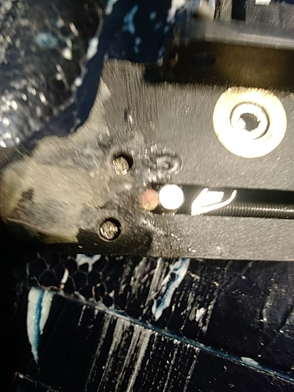

      • The only solution I found was to reinforce the area from new.with A hard 2 part plastic glue. Epoxy did not help. The other thing I found the claw as U call call it jumps over the peice that moves along the jackscrew.... Meaning the retract is open,, but the wheel flops open to closed.. I shorten the slot in the side of the retract.
        Stops it jumping over.. pics when Home from work
        • A pic here i shorten the slot .. takes out the slack.. have done this on my f4 also... hope explanation is ok... u can c plastic glue on the side ​ u can see the 3 or4mm rod glued in place. Ive used bbq skewers.. cut down,, carbon rod would b better.. it reduces the freeplay ,,, its in 2 peices from either side.. hope ive been helpful
          • Sounds like a great solution F4U, but the pic didn't post, can you try again?

            • The dumb Ozzy was sure pics worked. Soon as home from work

                  • Yee. Hope helps.. having horrible trouble doing pics.. gotta get those young ones t help. Or elbbee.. hese a clever dic?? But I reckon use carbon rod.. the glue is an automotive. 2 part bumper repair glue.. dries rock hard... B safe have fun
                    • f4u ausie
                      Great fix! I've thought about how to do that very thing when I cracked the retract on my A-10.
                      Best, LB
                      PS: Doing the picture attachments is not always easy.
