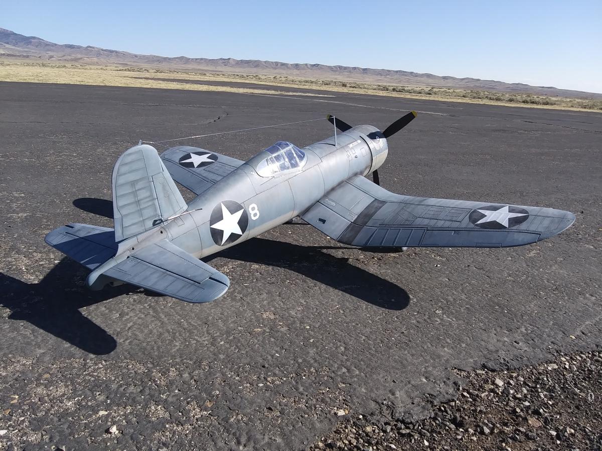

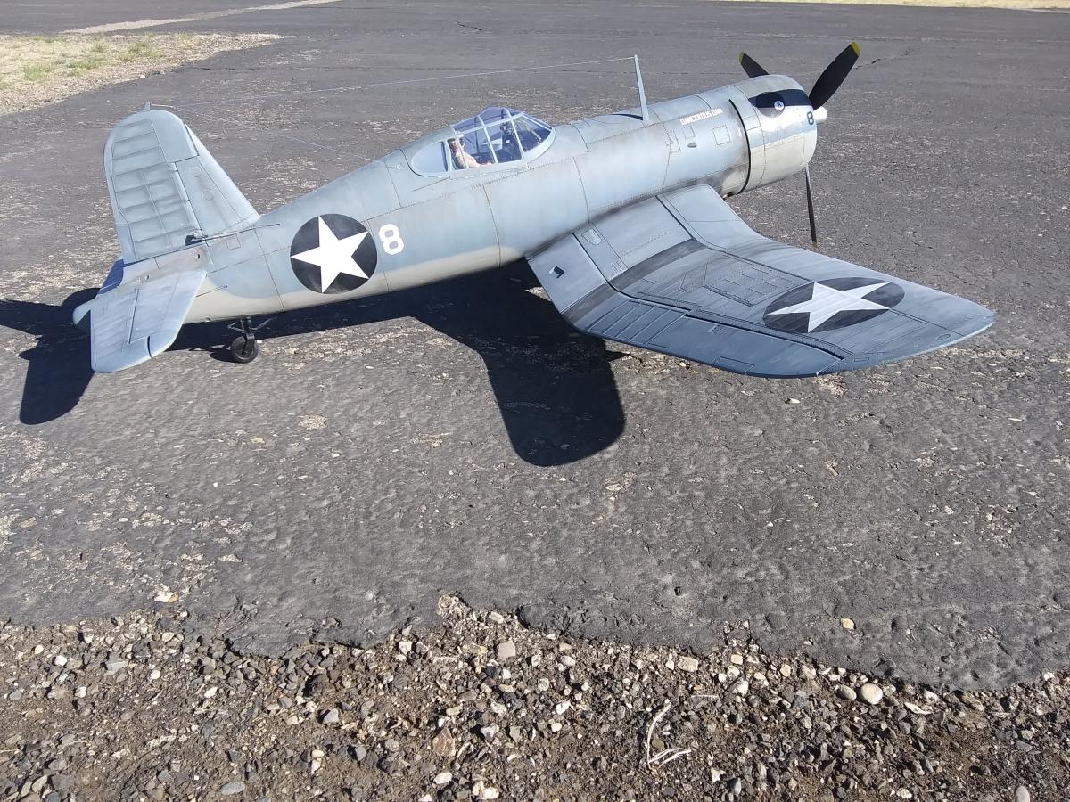

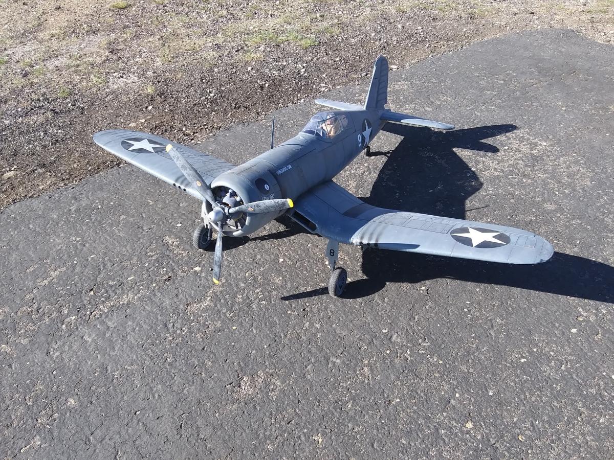

      Maiden in the books!!
      Did as I said, ranged checked the poop out of her and tried a flight, not bad, a bit rough on the landing. My gut is to go with the same D/R and Expo that I have on the Spitfires. The antennae mast on the tail came unglued and , in an old guy moment, I misplaced it. I spent more time searching for the darned thing than flying!!
      I finally gave up and came home. Lo and behold, it was inside the airplane. I remember thinking about guys storing the masts and things inside the plane so, I dropped it in there. So now it's glued back in place using E6000 so it never comes off again!
ID:	424058 Click image for larger version
ID:	424059 Click image for larger version
      Somewhere in the Solomons!!
      I also had the old Bearcat out, I love that plane, a survivor of a crash on Muncie back in 2017, she's back in the air and a great og to plane. Proof, I had a good flight and landed her no problem, taxied her in to find that the portside aileron came unglue and was just hanging there. THAT'S a lovable bird!
      (Dangerous Dan)

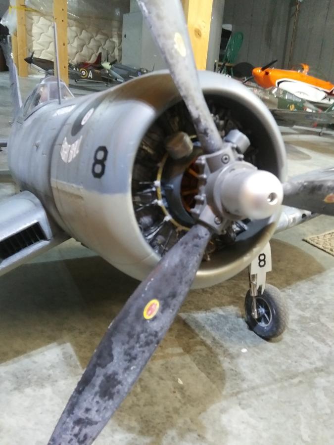

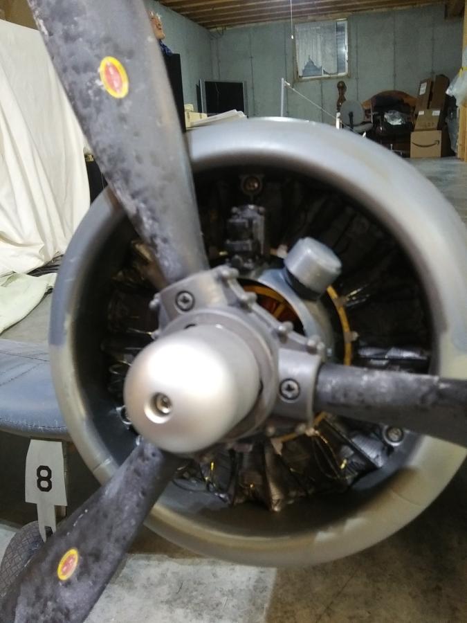

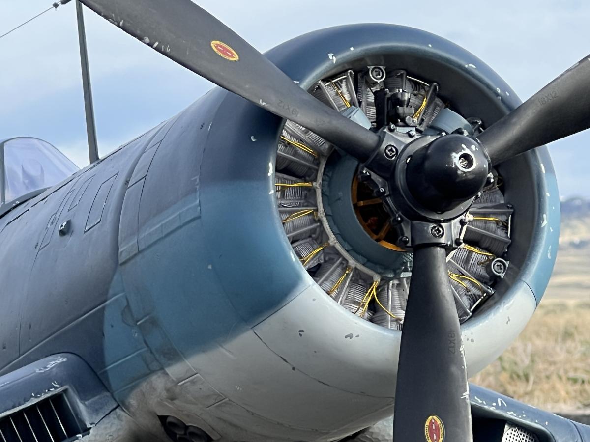

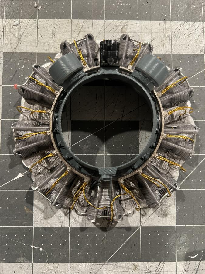

                                      So, here it is guys, the new and improved R 2800s, after a lot of redesigning, refitting and playing around around with shapes and numbers, we finally came up with a pretty good design.
ID:	425393 Click image for larger version
ID:	425392 Click image for larger version
ID:	425391 Click image for larger version
                                      Better than the stock one!
                                      I bought the STL file for the R2800 but it was too large to fit straight in.
                                      The original has the bellhousing and the rear cylinders all in one piece, I ended up modifying that by slicing off the rear cylinders and shrinking the remaining part to the correct diameter, then altering the height to fit. This meant recreating the circular base that the mags sit on, which wasn't hard and then trimming the nose of the bellhousing for the angle(s) of the motor. Once that was done, I handed it over to Dave to work his magic on the printer and he came up with a great set of parts. The rear cylinders ended up being a picture blown up to size. On mine, I resized the rear cylinder part using Tinker Cad and printed a picture of that in black and white on photo paper, came out great! I did try 'squashing' the part in Tinker Cad so that it was 1/8" thick, but there just wasn't enough room without hacking foam, wasn't worth it.
                                      Have to get mine out in the sun next weekend, it's supposed to be in the 80's, right now we're clouded over and had a bit of snow. Wyoming has five seasons, this being 'Sprinter'
                                      where we can go from the 70's to snow in a day, sucks, but it's worth it to live here!
                                      Anyway, got our creative juices flowing!!
                                      (Dangerous Dan)
                                        #6519

                                          #6520
                                          Fantastic Dangerous!
