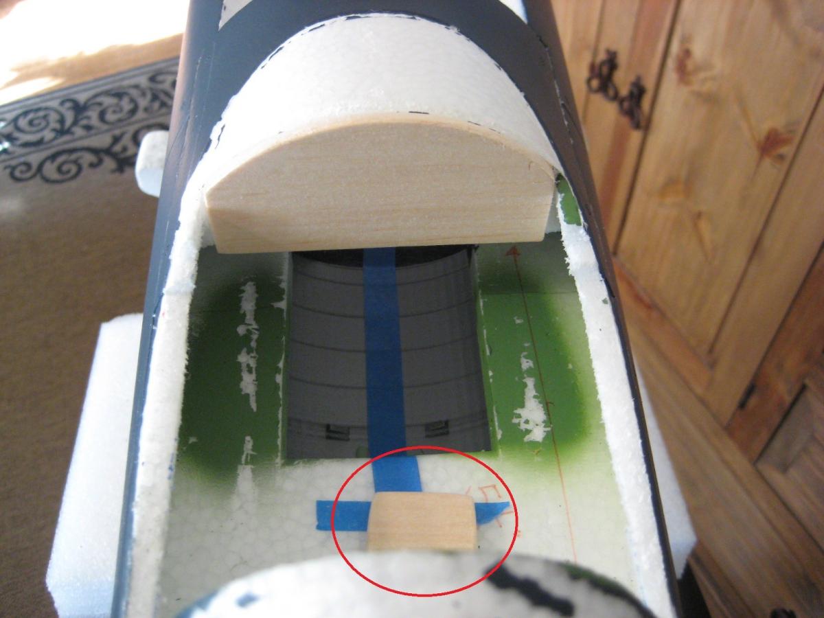

    Been trying to figure out how to seat the pilot in the cockpit with all the pesky control rods running just where his feet are. The biggest problem is the rudder control rod as it comes right up where he should sit, Dave, you said you made a wedge to seat him in but for the life of me, I can't envision what you did, can you send a pic of the wedge in place! I know there's a joke in there about giving the pilot a wedgey.
    (Dangerous Dan)

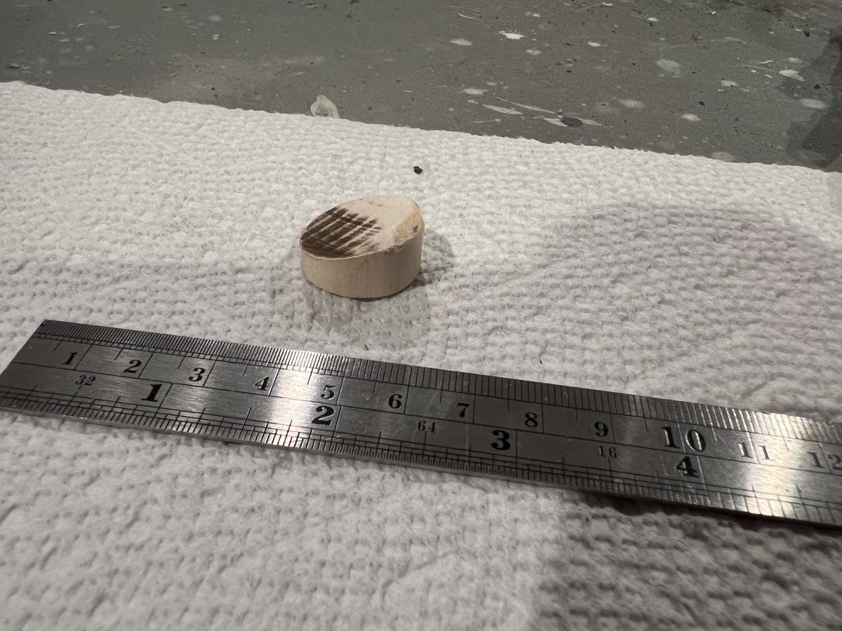

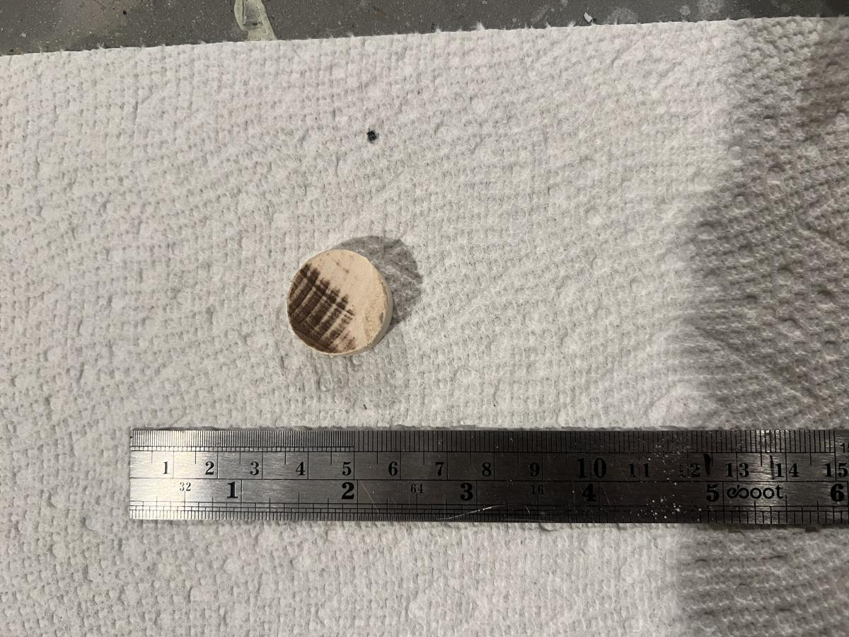

    Hi Dan: I used a 7/8 inch dimeter dowel (you can use anything approximately that diameter that should work) and cut a disc about 1/2 inch thick. I then took a sander to one side, beveling it from the original thickness on one end and tapering it so it was basically flush with the bottom at the other side of the disc. I put the thickest part of the disc facing forward and glued it in place with some foam glue in case I want'ed to change it again, or remove the pilot. You'lll just have to experiment but you want to put the pilot's butt so it sits on the disc and the legs go up a bit, clearing the control cables with his boots. Once he is glued in, he should remain free of touching the controls with his boots. It is a fairly tight fit for clearance, but it works, on mine, anyway.
    Here's a couple pics of the disc that I cut this morning to serve as an example.
    Click image for larger version  Name:	IMG_2548.jpg Views:	0 Size:	150.7 KB ID:	417707 Click image for larger version  Name:	IMG_2549.jpg Views:	0 Size:	194.9 KB ID:	417708

      Hi Dan: I used a 7/8 inch dimeter dowel (you can use anything approximately that diameter that should work) and cut a disc about 1/2 inch thick. I then took a sander to one side, beveling it from the original thickness on one end and tapering it so it was basically flush with the bottom at the other side of the disc. I put the thickest part of the disc facing forward and glued it in place with some foam glue in case I want'ed to change it again, or remove the pilot. You'lll just have to experiment but you want to put the pilot's butt so it sits on the disc and the legs go up a bit, clearing the control cables with his boots. Once he is glued in, he should remain free of touching the controls with his boots. It is a fairly tight fit for clearance, but it works on mine, anyway. Let me know if you have more problems with it. We have the same pilot so it should work for you as well, maybe with a little fiddling around to get it to sit right.

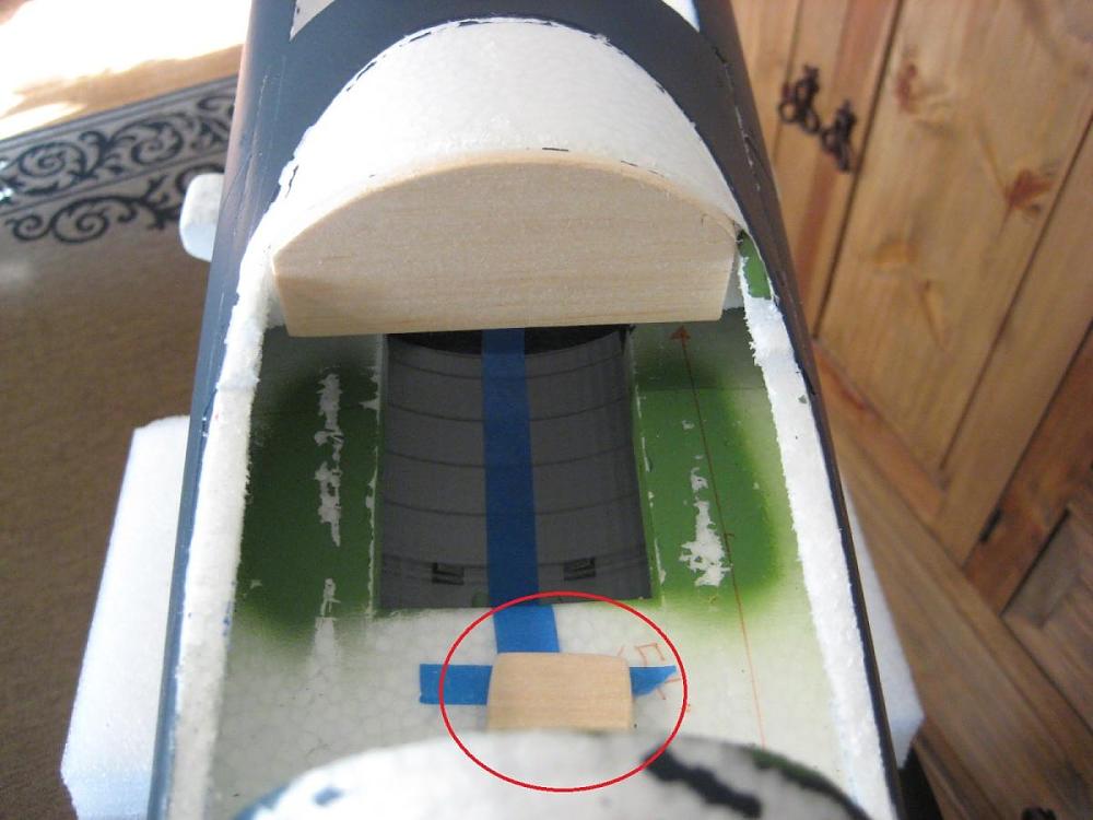

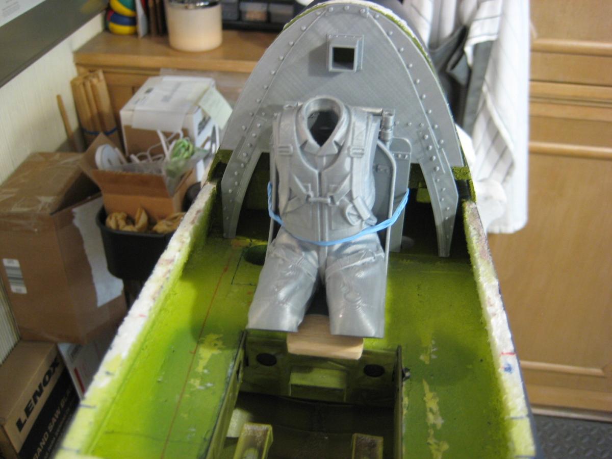

        I used a 1"+/- square of balsa 3/16" thick that I sanded a little at a time to get the height I needed in the end.
        That height was determined by the sliding the canopy aft until the balsa was short enough to allow the canopy to clear the pilot's head.
        I sanded another 1/32nd or so to allow for the glue, then glued the square to the assembled seat/pilot into the cockpit.
        Is goes without saying, I centered the balsa square under the seat bottom.
        Click image for larger version  Name:	IMG_0694a.jpg Views:	0 Size:	91.0 KB ID:	417712

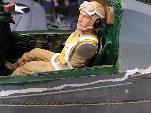

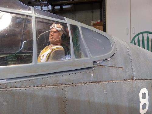

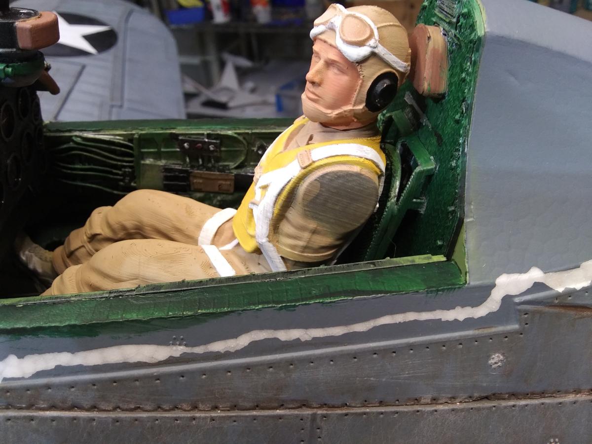

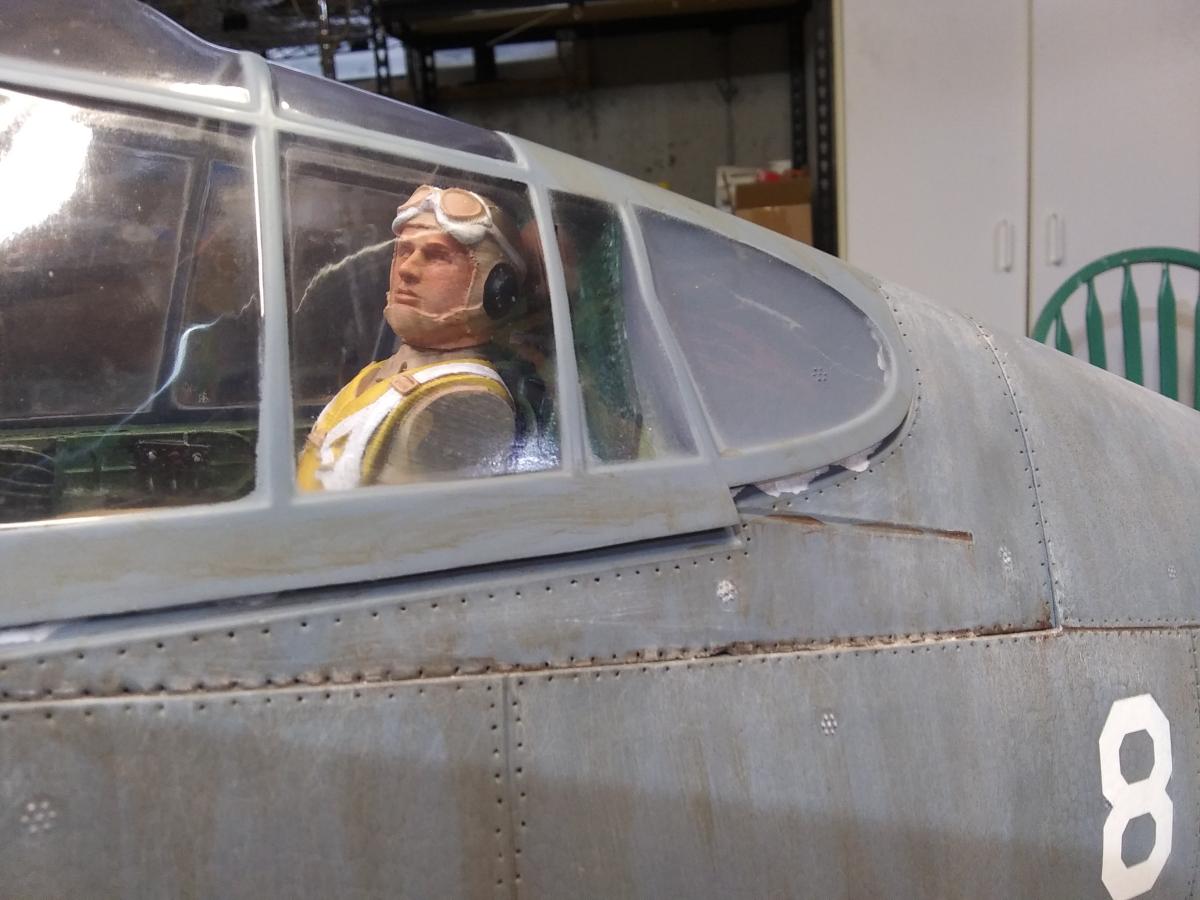

        • check this out, a bit of surgery and a couple of shims and there he sits!
          Click image for larger version  Name:	20250110_135611.jpg Views:	0 Size:	99.4 KB ID:	417796 Click image for larger version  Name:	20250110_135626.jpg Views:	0 Size:	124.8 KB ID:	417797
          He looks like he owns the plane! Gluing him in shouldn't be a problem as he sits just fine. As you can see the painting is coming along, harness straps are painted in, have to dirty them up a bit yet. The arms look good as well, just have to decide how to angle them. I was thinking, Dave, if you have a control stick, I'd maybe trim the bottom a bit and put the top in his hand.
          Just waiting for my fine detail paint brush to arrive and I also ordered a magnifying set of glass, up to 5X so I can zoom right in on those eyeballs. Man, if I was really creative, it would have been cool to run a rod up to the head and have it swivel with the rudder. Maybe next time. The pilot is so good that it would look so real!

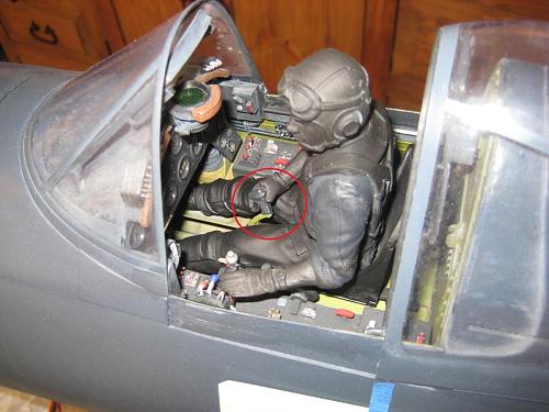

              This is a G-Code file for DG's Prusa Mini.
              The 'joystick' is of my own design from references and is a great fit for the Corsair & the Max Greuter WW II Navy Pilot.
              Max Greuter also has an RAF Pilot.
              Funny, I'd been waiting for a Pacific Theatre Pilot that looked the part, you know, no flying jacket etc and now you need one with sleeves.
              Hope this Joystick is useful to you, Dan, it took a bit to get the design right.

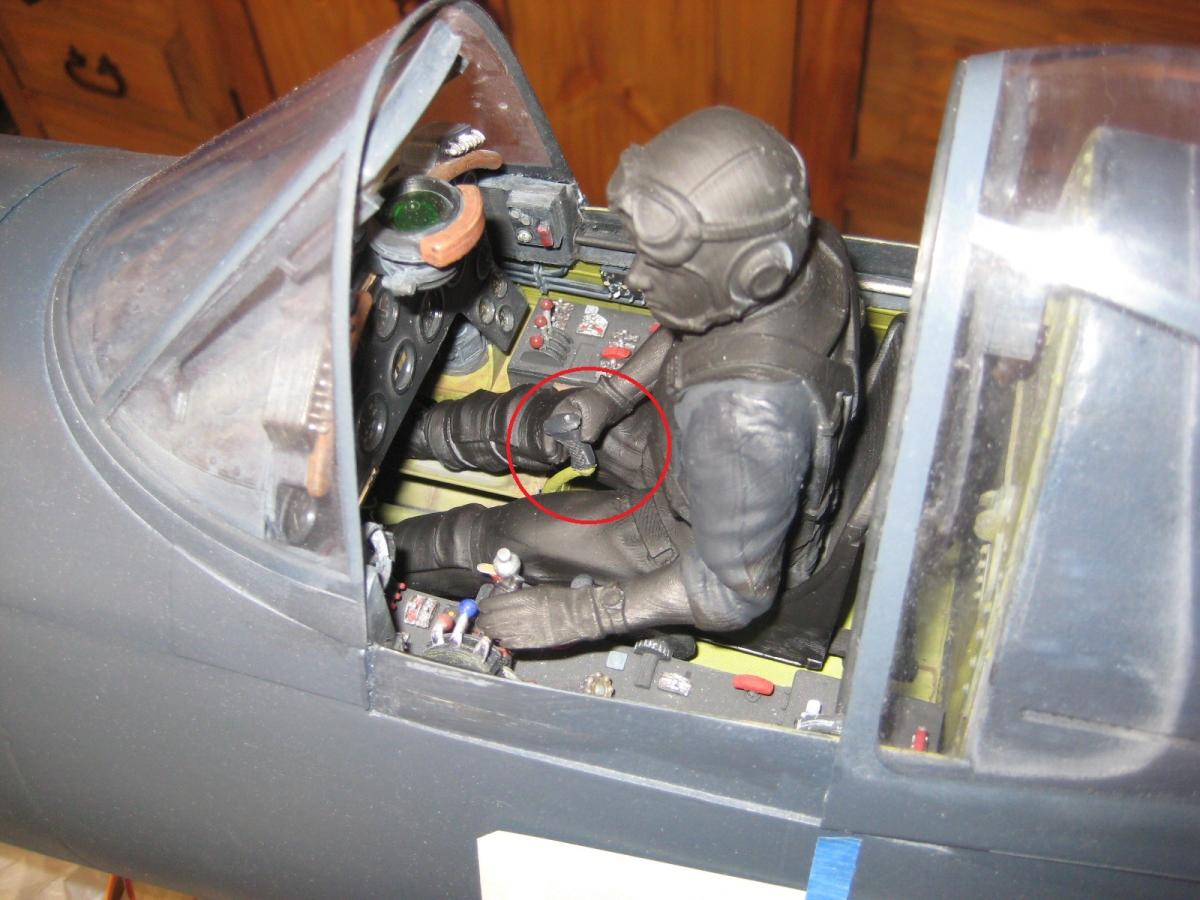

                                    Hey Dan,
                                    A my Corsair project went along, I had my pilot in the cockpit, but had not glued it in place.
                                    The joystick would glue in last thing, so every time I'd look at him sitting there, his right hand was...well...where it was and I had to smile thinking I gotta get him glued in soon, 'cuz that looks funny to me, but probably not to anyone else.
                                    Dave got the joystick G_Code file to transfer, so there ya go.
                                    If you do buy and build that "bubble top" let me know and we'll see about getting you some parts.
                                    Best, Steve
