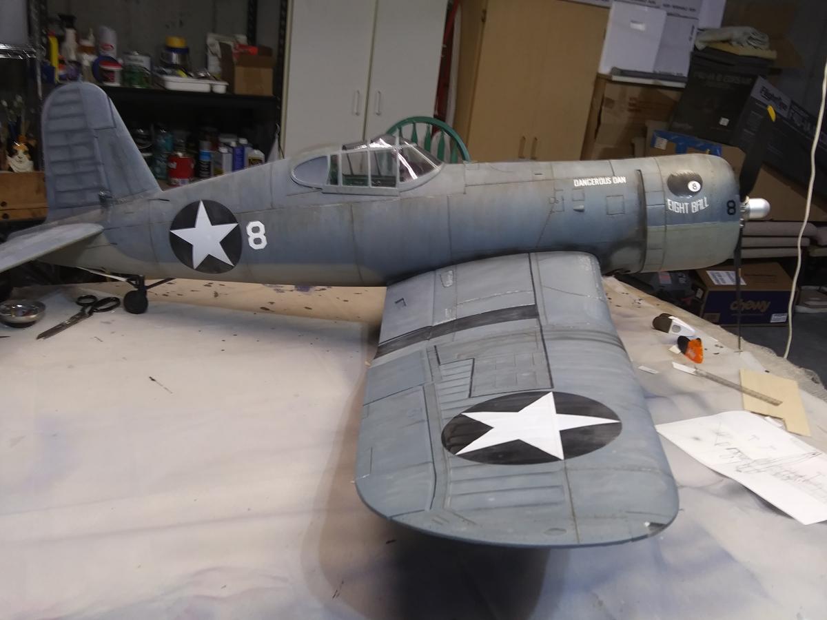

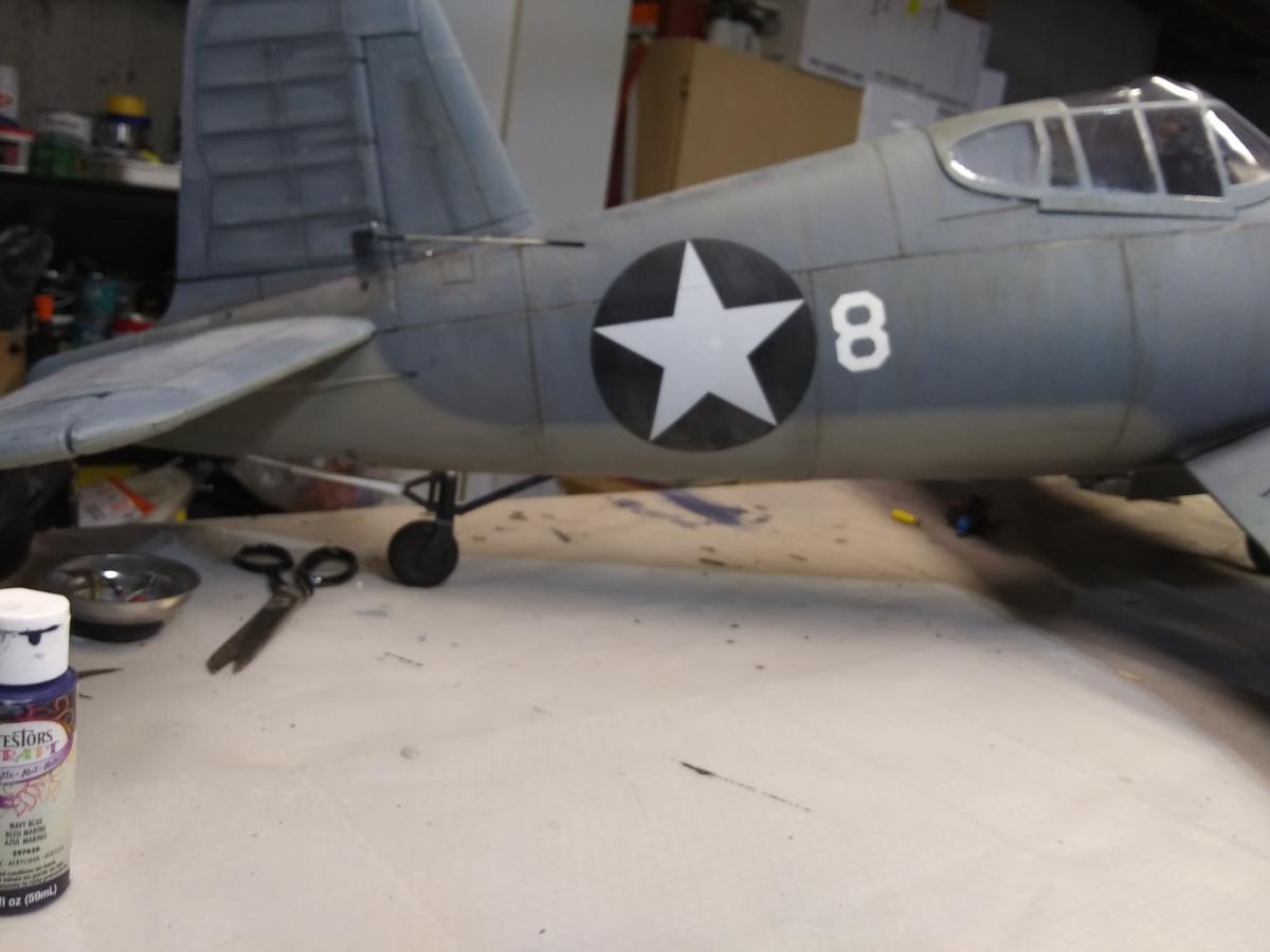

    Some pics of the tail wheel, to me it looks more authentic than the white, beside, I'll guarantee there was nothing on these birds that stayed white for very long
ID:	417023 Click image for larger version
    Now the question of the arrester hook, color, remove??

      Looking great, Dan!
      Although I haven’t done it on my Marine Corsair yet, I think the best answer, as far as realism goes, is to remove it. It was 70 pounds of dead weight, and period photos show them removed for their island- based operations in the Pacific.

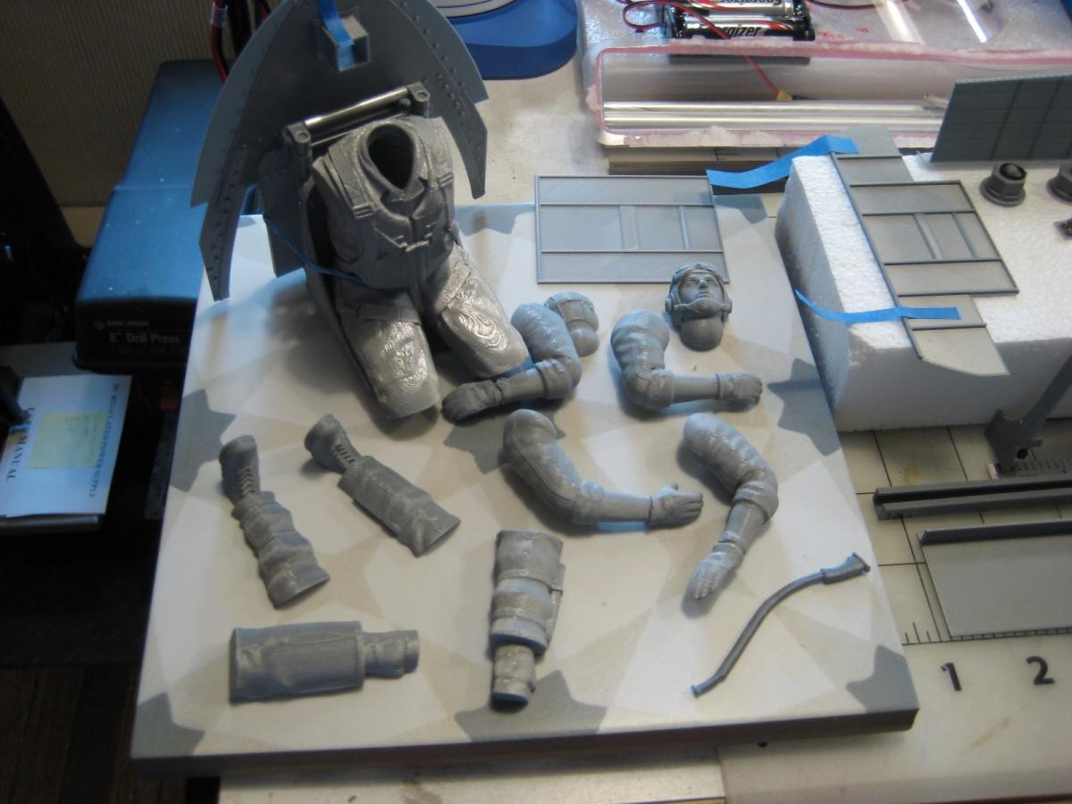

            Hello Danger,
            You had commented some time back about how I had printed Max Grueter's WWII Navy/Marine Pilot.
            I ran across a picture of the pilot before final mods.
            I think I 'cut' the legs into more parts in Prusa Slicer than the original STLs.
            I sized the upper body to look wide enough in the cockpit and sized the lower body to best fit the seat.
            There is no real formula for this, I used seat width and then an overall height I needed to fit beneath the sliding canopy.
            The Seat Height in the cockpit was my variable as the foam floor was fixed.
            Leaning the pilot forward helped with a better fit and actual seating according to most reference pix I have.
            I printed the pilot parts with 5% infill to save weight,
            I had to carve and fit each piece a little to get arms/hands where I wanted those and used thick CA and epoxy putty to assemble/fill the parts.
            Painted the all up weight was around 4 ounces for a full sized pilot, as I recall.
            I hope this helps, but let me know if you have any other questions/comments.

              I was thinking that too. It wasn't until later in the war (post birdcage) that the Marines started serving on A/C carriers so it would make sense. They probably didn't even ship the planes with them, just hoisted them onto the carriers I would think.
              Broke down and ordered the salt for the salt trick off Amazon, I'm still thinking of using it on the gear bays, paint them salmon and then Zinc Chromate over top of that using the salt. Will experiment on some cardboard first though.
              As for the bushings, I checked the mail a few minutes ago and still nothing. How many Bordellos can there be between here and Indiana??

                  Hey Dan: If you want to purchase the files from Max Grueter, I'd be willing to try to print up a couple of pilots on my printer. Let me know if you want to give it a try. I think it would probably work.

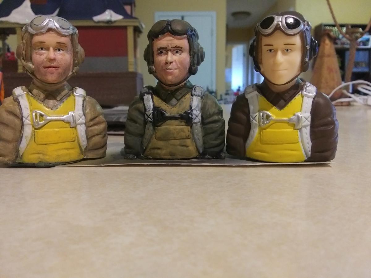

                    Sounds like a plane Dave.
                    Meanwhile, I've been doing some painting on my collection of "Porcelain Pete's
                    Click image for larger version  Name:	20250101_114447.jpg Views:	0 Size:	95.2 KB ID:	417127
                    Still some more work to do as you can see, but useful tools to get some experience.

                        Your skills are quite good. They don't look bad at all. If you do the Max Grueter pilot, you will probably enjoy it more in your Corsair. Elbee's pilot is outstanding. I need one for mine.
