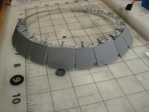

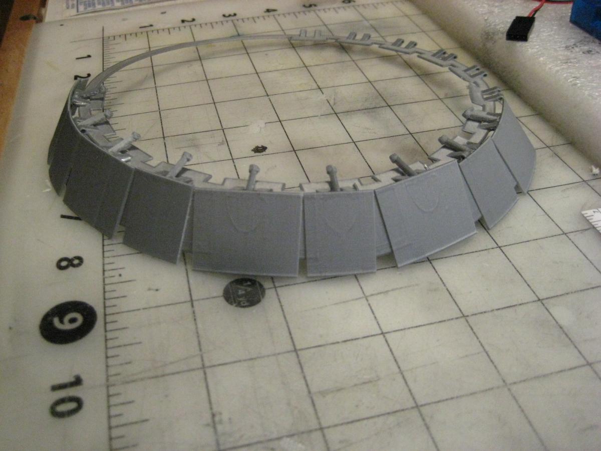

    Your work is Amazing Elbee. I have always thought it would be awesome to have these on a Corsair even if they were open all the time Scale Maestro Designer and 3DP genius OH I have a question can I have it LOL!!!!!! just kidding Sir
    WM, Yeah, everyone can have it once it is proven. I will post anything once I complete the model if there is interest. My thought is to have the cowl flaps always open, but spring loaded so natural airflow might close 'em down somewhat. The optimum might be to use a servo slaved to the throttle and open and close with throttle setting. Easy to do, I think, but is it needed? Probably not. So I like the idea of using the air to move 'em in or out. Purely conjecture at this time, but I like the design so far. A serious issue is finding expansion springs like Freewing/Flightline have access. I know 'diddly' about springs and all I have access to is at the hardware store. Make my own, sure, but why if I could source 'em. Best, LB
      Elbee when you get done Even if they are open all the time I would love to be the first to buy a set from you price is up to you, they will be quite an option to add to my Bird Cage Corsair I just finished up but have not had a chance to test fly due to all the bad weather and 18" of snow we recently got here in the Black Hills of SD
      • LB, those look great. Nice work! Instead of springs tho, I would simply run a thin braided steel cable thru holes in each horn. The cable slides thru all horns in a big concentric loop. Connect the ends of the cable to a double (180') servo arm (one each side), or anchor one end and connect the other to the servo. Pulling the cable tightens the loop thus opening the flaps. Pushing it, expands the loop and closes the flaps. The extra servo weight is needed up front anyway, so mix it to throttle like you said and there ya go. Open at the low end and fully closed at around half to three quarters throttle.
        Sorry, after re-reading your post you probably already knew this technique as I realize you were working on a way without a servo and air pressure only. Either way, I plan to incorporate it on mine. Thanks for wanting to put it out there.

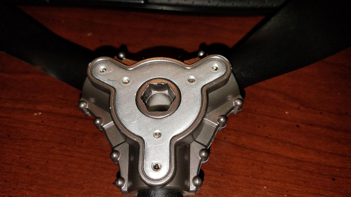

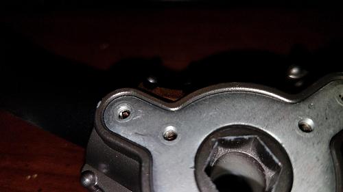

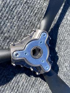

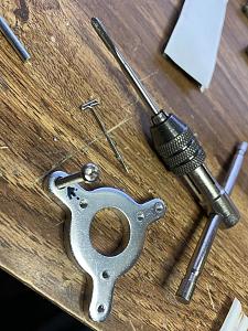

            • Well this is slightly annoying. Did anyone else have an issue on the prop assembly where the short outer screws don't grab the back plate threads? All 3 of my outer screws just spin in place and barely grab. It's almost like the outer threads on the backplate were machined sloppy.
              • Originally posted by evensen007 View Post
                No, I don't recall having any issues with assembling the prop. This may be stating the obvious, but perhaps you got the screws mixed up. There are 2 sets of screws, each set are different lengths and sizes. Did you try to reverse their positions? It's been a long time since I put this plane together, but are you sure the short screws are the outer ones?
                  Legit question, but yes. The shorter screws are for the outer holes. The longer middle screws do thread and lock to the plate. Looks like I'm going to need a replacement part. Bummer, wanted to fly it today.

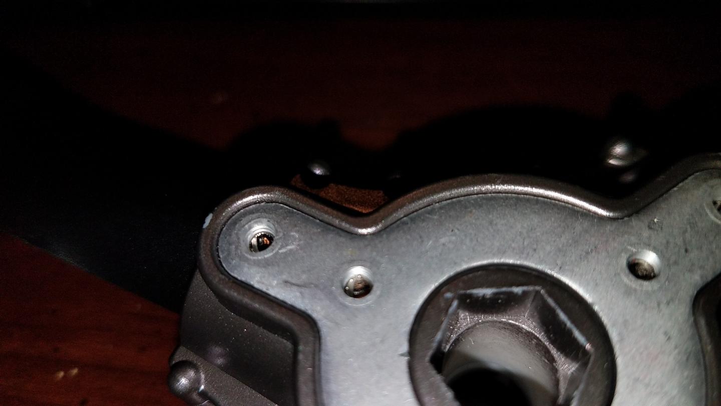

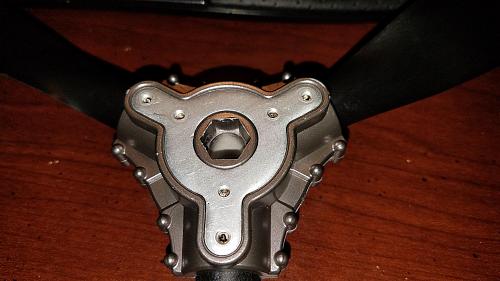

                    You've got a legitimate beef there. I have over 100 flights on mine and frankly never noticed till you just mentioned it. I just looked at my spare prop I always take out with it (fortunately never needed it but as Scarlet O'Hara said, "Tomorrow is another Day") and it's about the same. Short screws on the outside, longer inside and they definitely do not extend to the absolute bottom of the plate, maybe about 1 mm short. Can't remember how thick that bottom plate is, but it seemed to me to get enough threads into the plate to not cause much concern when I first put them together. All six screws extend into the plate the same distance, but stop just short of extending beyond the bottom of the plate, which I thought was appropriate. If yours don't even extend that far in, then yes, 'Houston, we've got a problem". And I have each of the six screws cranked in as hard as I can and they didn't strip out.
                    I don't know if you can see anything from these photos, but this prop has run fine for many flights.

                    • Yep, looks like it's grounded for a while then. My outer screws don't grab nearly that deep. In fact, I can take a needle driver and just push them right out from the bottom of the backplate. I'll have motion send me new screws and a new backplate since I'm not 100% sure which is the problem.

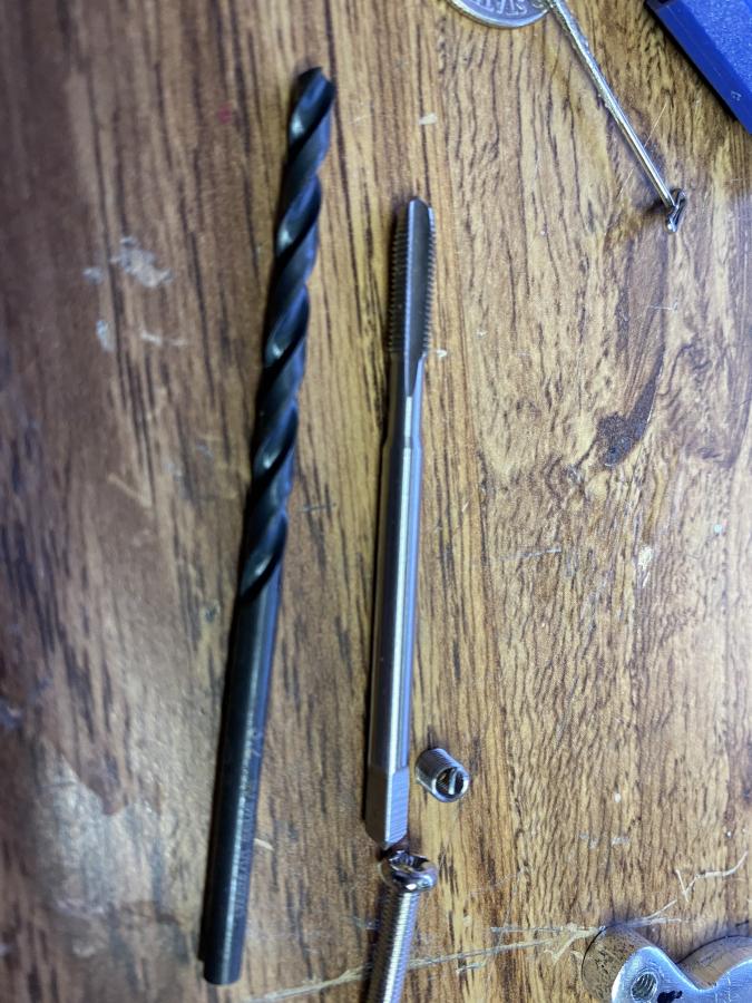

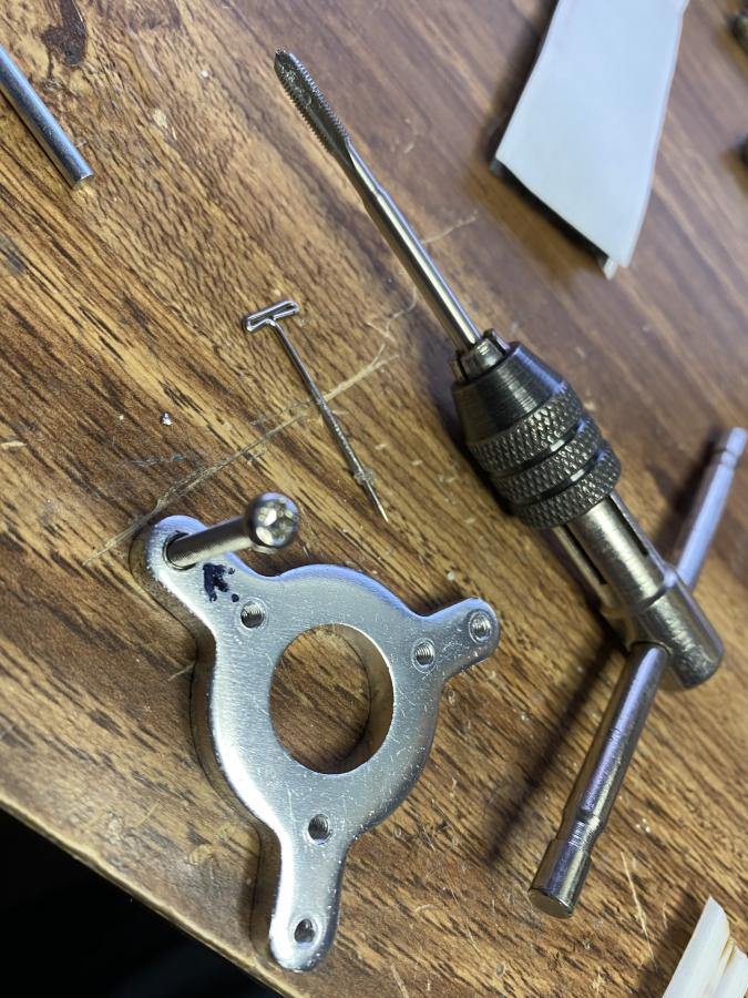

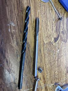

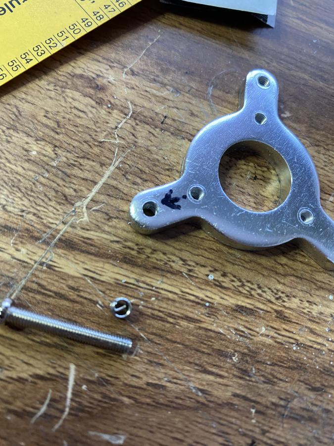

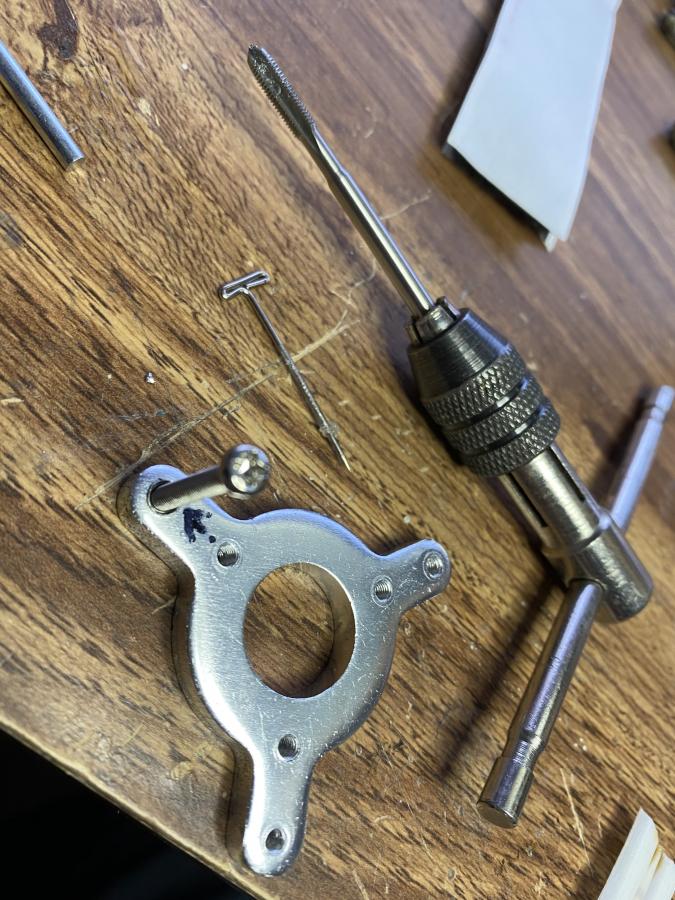

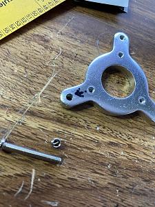

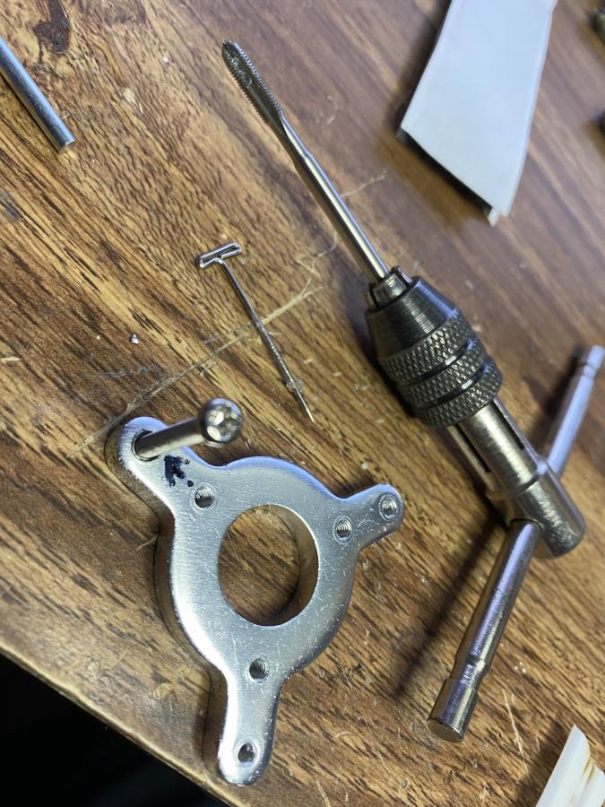

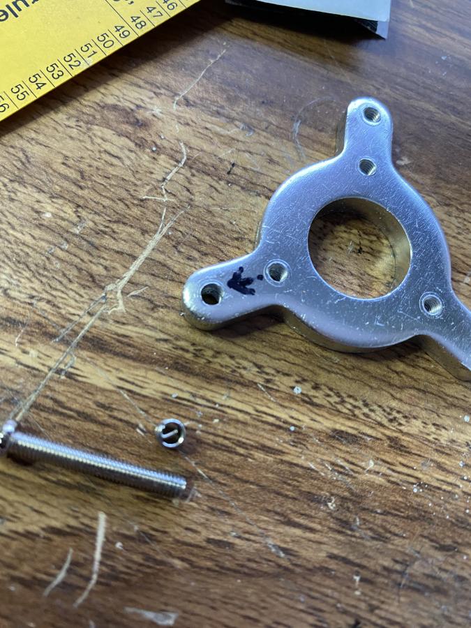

                                    I helped my friend Rob with his new prop hub that had issues with the screw stripping out. The length was just a tad bit short
                                    MRC replaced the first set of hardware but it was the same problem. I ended installing a 2.5mm Helicoil
                                    Rich

                                    Click image for larger version  Name:	72294950-422B-4EAC-9EA9-52E72684A959.jpeg Views:	0 Size:	118.7 KB ID:	305173Click image for larger version  Name:	image_65366.jpg Views:	5 Size:	107.9 KB ID:	305168Click image for larger version  Name:	image_65365.jpg Views:	5 Size:	115.8 KB ID:	305170
                                    • Originally posted by RichJ53 View Post
                                      Rich
                                      Great work, and I see you have some "lockTight" or something in there as well. So I guess this is not an uncommon issue.
