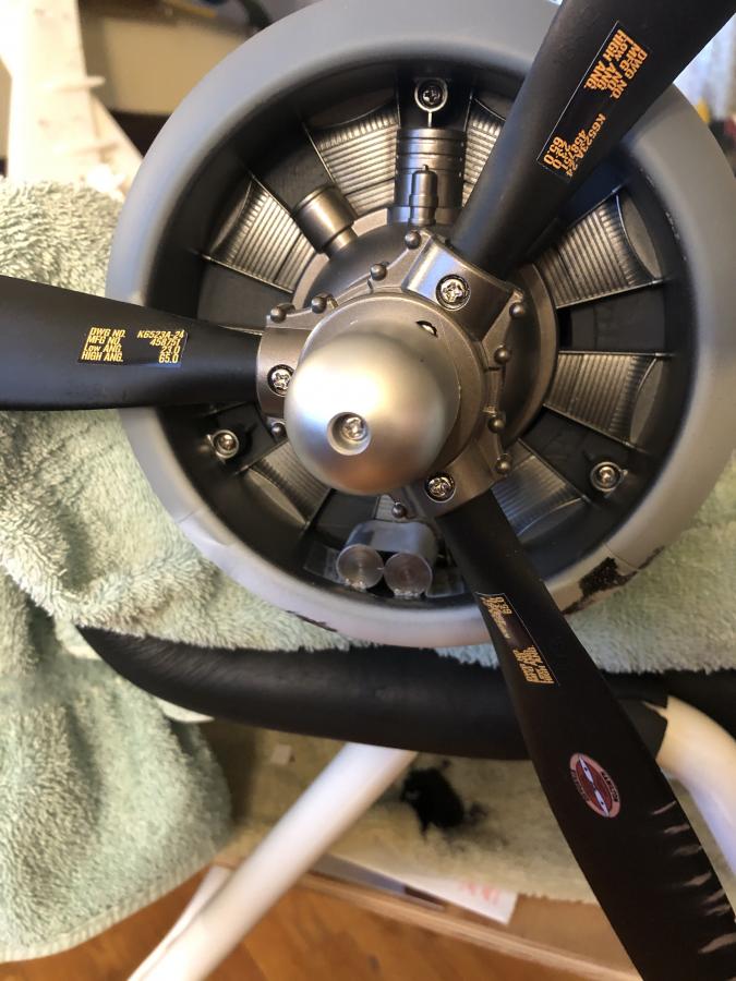

                        #4311
                        You've got a legitimate beef there. I have over 100 flights on mine and frankly never noticed till you just mentioned it. I just looked at my spare prop I always take out with it (fortunately never needed it but as Scarlet O'Hara said, "Tomorrow is another Day") and it's about the same. Short screws on the outside, longer inside and they definitely do not extend to the absolute bottom of the plate, maybe about 1 mm short. Can't remember how thick that bottom plate is, but it seemed to me to get enough threads into the plate to not cause much concern when I first put them together. All six screws extend into the plate the same distance, but stop just short of extending beyond the bottom of the plate, which I thought was appropriate. If yours don't even extend that far in, then yes, 'Houston, we've got a problem". And I have each of the six screws cranked in as hard as I can and they didn't strip out.
                        I don't know if you can see anything from these photos, but this prop has run fine for many flights.
ID:	305034Click image for larger version
                        Argh. Received the replacement prop assembly from Motion today. It has the EXACT same issue as the first one. Even the longer screws won't lock on the outside holes of the plate. It's almost as if the outer plate holes are machined too large for the screws. You can actually push them back out from the underside. Guess I will look for the screws mentioned by another user that had the same issue above. Not a great start.
                        • Md_cobra
                          RC Pilot
                          • Jan 2019
                          • 49
                          • Nashville, TN
                          #4312
                          On the cable issue. I used a sharpie and put a dot on the box and on one cable so I always plug it into the same slot.
                          • RCAV8R
                            Certified Plane Nut
                            • 355
                            • Medford, Oregon
                            #4313
                            I haven't looked to see how far my screws go into the plate, but I had a similar frustration when I set mine up...I wanted to snug the screws and one in particular just gave up and stripped very early. I called MRC, and they sent a second set and it was the same issue. Always just one of the screws, and not all of them. I looked at after market screws and had difficulty finding a replacement that didn't have issues with the thickness, the head being too large, etc. I ended up just not tightening as much as I would have, and living with it. Very frustrating though!
                            Rob
                            • nuts-n-volts
                              Duke City Electric Flyers
                              • 262
                              • Albuquerque, New Mexico
                              #4314
                              Not to be overbearing, but wouldn't just buying some longer bolts in the right thread size solve this? That and just a bit of medium locktight in the threaded backplate.

                                #4315
                                When doing a large quantity run on these plates. I can see that the tooling they use to do so will wear. and cause this kind of problem. I checked the plates on mine while assembling and the bolts were fine, went in flush and the plates were also ok. Sounds like a problem with quality control, and checking and changing out worn tooling

                                    #4317
                                    I confess my memory about this is a bit fuzzy, but I remember getting the exact dimension off the description in the directions, and yet still had a problem with fit. (The length was going to have to be cut, but it just seemed that the one hole in the plate out of the bunch was not consistent.)
                                    Rob
                                    • Agwagon
                                      • Feb 2021
                                      • 5
                                      #4318
                                      Had the same problem! Stripped out instantly. Replaced with slightly longer Allen head screws with no washer and red locktite. Motion knows this is a problem!

                                        #4319
                                        Which is kind of funny, because after I had already complained the first time, and received the replacement for free, I complained further about what I was seeing and was told they had checked with others and confirmed they not had any problems before. My point was that I thought it was suspicious that on two different plates there was just one hole that seemed to strip easily, and always in the same position...the rest were fine. I knew I was guilty of liking things tight, so concluded I was just going too far.
                                        I remember now that once it happened I could almost pull the screw through the hole without any resistance in the threads. I did get an after market screw of the same thickness and had the same result, so the only other fix would have to involve tapping it to the next size up.

                                          #4320
                                          Not when the actual plate is machined incorrectly (or not at all in 1 case). Motion did have a bad run of these plates - some not having any machining/threads at all. I am awaiting yet another plate with properly machined threads and going on 2 weeks without being able to fly it.
