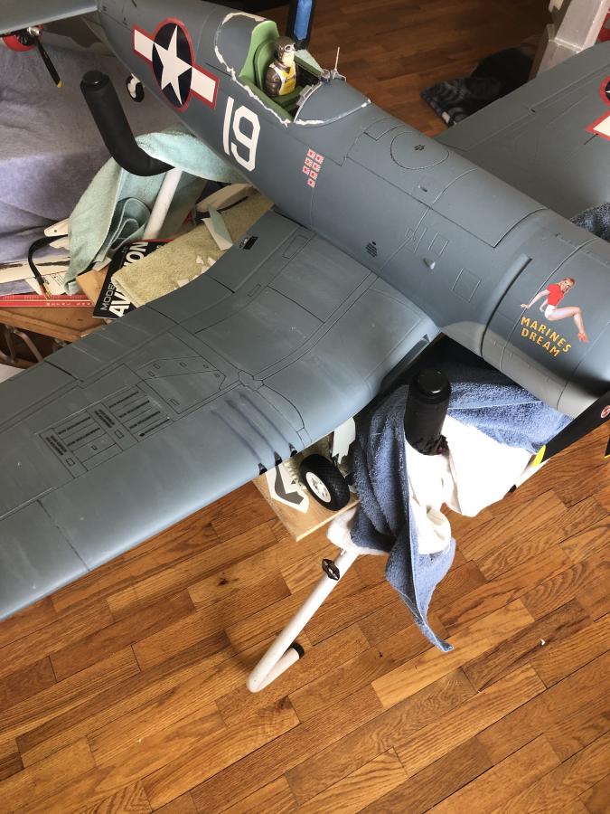

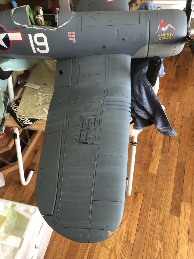

        • Okay, so for any of you who have this issue in the future, here's how the LED light wire is inside the wing:
          First, I had the able assistance of my good buddy RichJ53, who was not only the hand model for the photo, but a valued encouragement in this process given my horrible attitude!
          As you can see, the connector is about 3 inches into the wing from the end of the channel at the tip (that is under the tape). It was stuck inside the wing with some packing tape, the same kind as hold the wires in the gear bay, and in my case, the wire had pulled apart at the connector, but the tip end connector was still sticking to the tape and preventing me from getting it to move. Given how close it is to the wing tip though, there was no way to access the connector from either the aileron servo hole or the outboard flap servo....you have to pull it out from the tip end.
          Once I removed the decorative tape from the channel at the tip, it was pretty easy to pull the LED wire back out, and the other piece (with connector) all the way through the wing from the gear bay to the tip. With the connector exposed we put shrink tubing around the connector, and then pulled the wire back through the wing from the wing root.
          The things we do for a stinking light!!! Back on the flight line!
          Rob

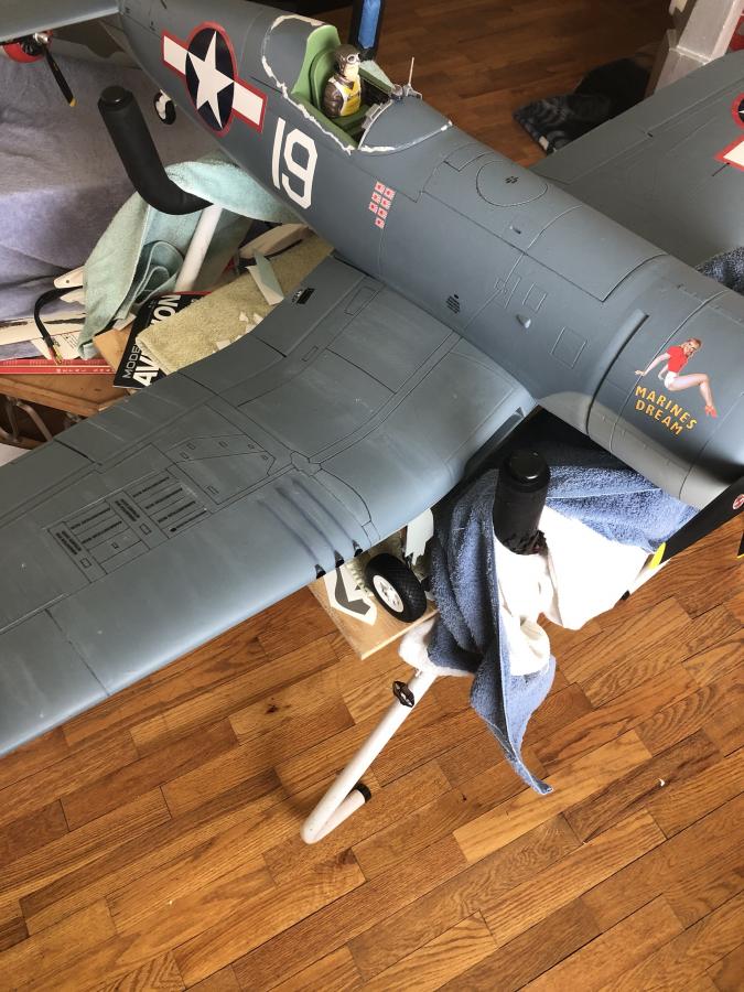

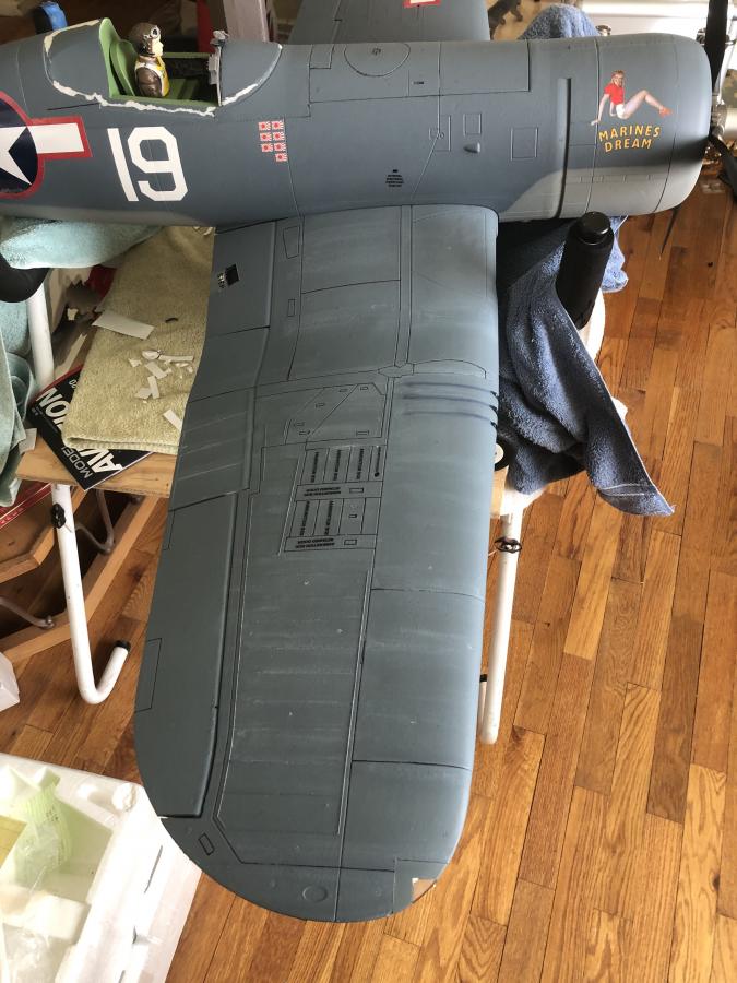

          • Originally posted by RCAV8R View Post
            Rob
            Good job Rob, sometimes it only takes a little encouragement for these little annoyances.
            by the way with the LED connections out near the tip, it allows you to just plug-in a replacement without needing to solder on the existing wires. For those that don’t like soldering, it’s probably a much easier fix.
            the LED lights are available at MRC just need one that’s from many freewing or flightline kits.
            examples: https://www.motionrc.com/products/fr...-led-light-set
            Rich
