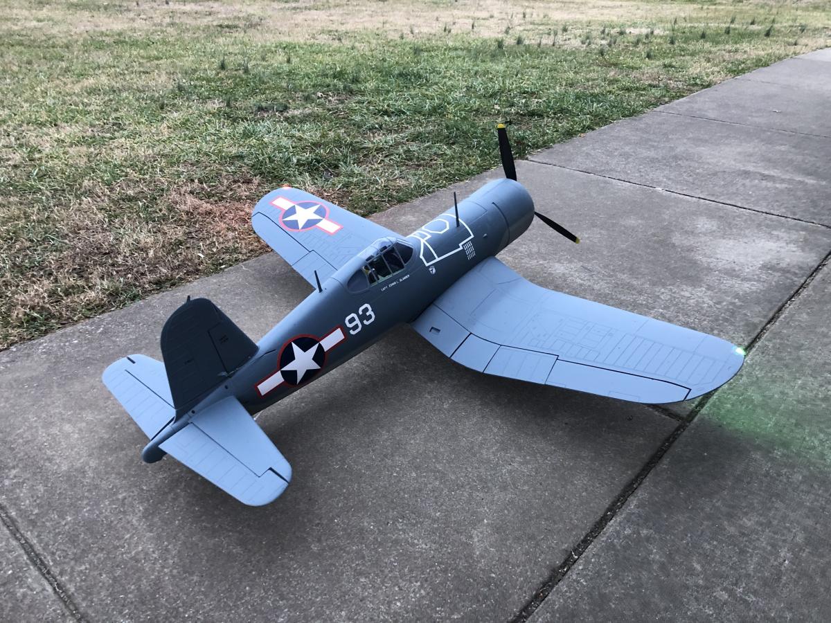

ID:	290222 Got 2 flights in before dark. Love this plane!!
