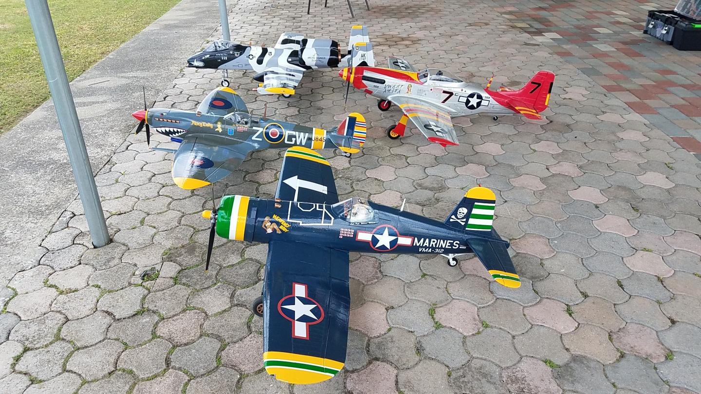

              Got 5 flights in today on my Corsair, running 8 minutes on a 5000. Plenty of power, smooth landings, just a real pleasure to fly. Same with the FL Spitfire, but with that I'm getting almost 10 minutes on a 5000. These are 2 of my favorite prop warbirds and FL did an outstanding job with them. Also got 5 flights on the FMS 1700mm P-51. I like the size and it looks good in the air, but it is still a dog compared to the Corsair and Spitfire. I have to use a 4000 because any heavier battery really degrades the performance. Although it has the 360 Kv motor, the aircraft is just way too heavy and I suppose going to an 8S setup would help, like with the FMS Corsair, but I'd rather spend my time and money on another FL/FW model. It still flies OK with the 4000, climbs decently and gives just under 5 minutes.

                Just checking ................... The stock FW Corsair has a 340kv motor. Did you transplant the FMS 360kv motor into it? I fly my FW Corsair with the stock motor and ESC but I'm using the FMS V2 Corsair 4-blade prop. I find it flies quite well, perhaps marginally faster than the FMS Corsair with the 360kv motor. I'm going to experiment with my FMS with the newer V3 prop hub and V3 blades, then with V3 prop hub, V2 blades and 8s on the HV ESC as per RC Informer.

                  No, I left the FL Corsair with the stock 340Kv motor and the stock 18X12 3 blade prop. It has plenty of power for my style of flying, takes off with about 75% throttle and I only use full throttle on the climb out of cuban 8's and split S's and a few other maneuvers. The majority of the time I'm at 45-60% throttle so I can get well over 8 minutes of flight time. The FMS 1700 mm P-51 still also has the stock 360Kv motor with the 17X10 4 bladed prop. The P-51 weighs just under 10 lbs with the sound system, while the FL Corsair with the sound system weighs under 8 lbs, so that extra weight in the P-51 seems to make quite a difference in it's flight characteristics. I've tried it with a 5500 and a 5000 mAh battery and that additional weight really degrades it's performance and I have to use more throttle, which ends up not giving me much additional flight time. With the 4000 mAh battery, it flies and climbs much better but flight times are reduce to 5 minutes or less and it definitely seems to fly much "heavier" than the FL Corsair. The 360Kv motor in the P-51 already draws 83 Amps and 1780 watts on the 85 Amp ESC so if I were to go with an 8S setup, there may be quite a few changes I would need to make and that may be beyond my limited capability to pull off. At this point, I'd rather spend my time and money on something else because the P-51 is still "flyable" (is that even a word), just nothing to write home about.

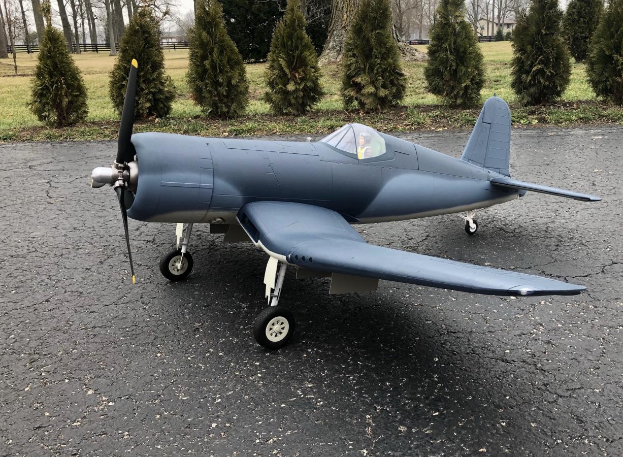

                    Hey everyone. Got this far yesterday with my Corsair. I used a Home Depot paint code I found on this thread for the intermediate blue. Thanks to whoever it was that did that research, I think it looks just about right. Sent a request off to Callie this morning for decals. I’m going to try not to go crazy with weathering etc. This should be a fun one!

                      E6, Looks like the perfect canvas, Sir. Which livery did you choose? Any mods in mind? Looking forward to seeing your progress. Best, LB
