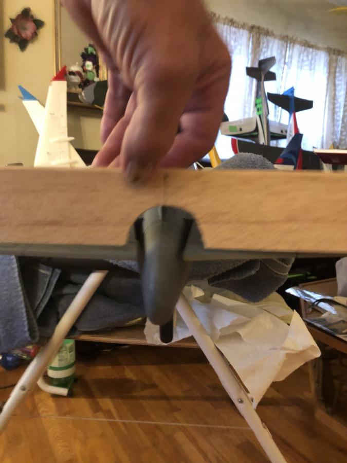

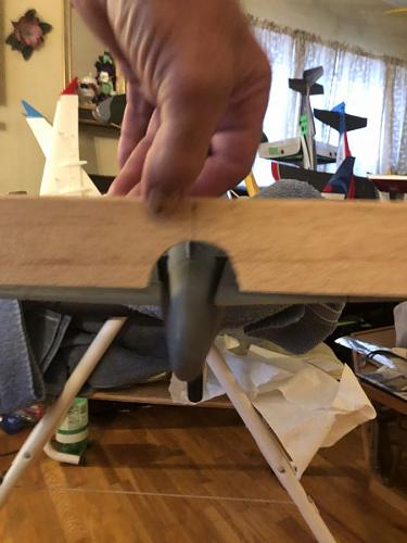

    Performed some foamectomy surgery on the fuselage and printed some mounting parts. Dry fitting shows me some hinge line redesign is needed, but overall I was in the groove.
    I'll need printed reinforcement as the remaining foam is thin (.140" +/-) where the flaps lay straight, but no biggie.
    Might add CF square or rod in the 12 and 6 o'clock positions as well to tie the forward nose back to the fuse.
    I like where this is going thus far. More when there is more. Best, LB

      That’s looking great LB. I must say, it takes some nerve to cut up a brand new airplane like this! Keep up the good work.

        Jesus Elbee!! You the man!!! Brass Balls !

          Outstanding looking design Elbee , can't wait to see the flaps in action. Looks like you're going with the thin steel cable option. BTW, I thought that was supposed to be Mrs. LB's necklace, what's up with sticking it on a Corsair? She can't be too happy about that! And I guess it's not exactly a "new" airplane your chopping up, since it's been sitting in a box at your house for a couple of years, probably for production batch #1.

            Outstanding looking design. Looks like you're going with the thin steel cable option
            Thank you all.
            Hugh, the cable is actually an old guitar string and I'm using it as a curved hinge. More fluid and simpler than the bent aluminum "L-Shaped" wire I had used.
            As for actuation, cable is an option, but I only need to move 2 or 3 of the flaps to extend and retract all. 10, 2, and possibly 6 o'clock if required. Not there yet, but thinking it's quite doable.
            Best, LB

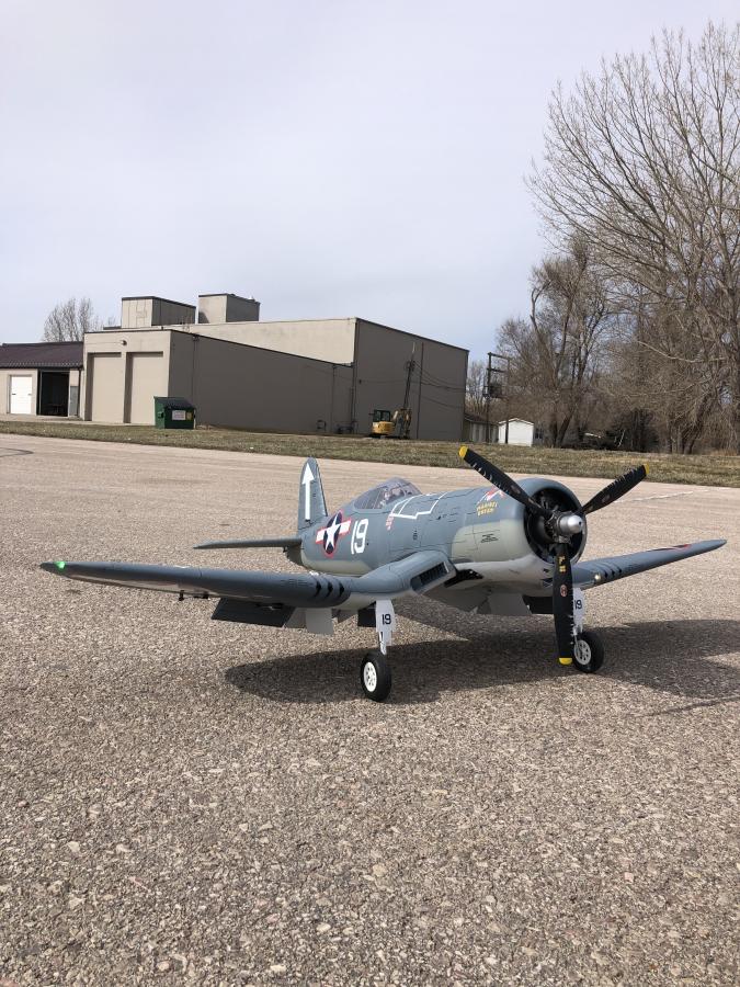

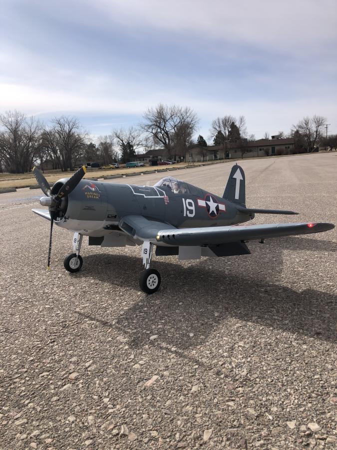

                        Yesterday was the first day in weeks here in the Back Hills of SD, that we had a nice cool non windy day. The wind was a ;ight direct 5 to 10 cross wind out of the East the wide parking lot I use for a runway run 18 & 36 straight north and south. So I Test flew my F-4U-1A Bird Cage Corsair the test flight did not go the best, the ailerons, or flaps maybe even the elevator halves were out of trim Here is the video of the test flight and a photo afterwards https://www.youtube.com/watch?v=qzucmjSlliQ

                          WM, she is gorgeous and in one piece. Sounds like a great day to me. Best, LB

                            Elbee. So much for just Eye balling the surfaces. The split elevator halves were off, the Flaps were off, and that made the ailerons off too. At least the landing went just fine She's a great flying War Bird for sure. I made a straight edge with a notch in it to get both elevator halves the same and used a straight edge to set neutral on the flap sections and the ailerons today. I guess I have gotten a little complacent while setting the surfaces of late weather went south again windy for the next three days or so plus rain instead of snow but snow expected in the Hills Hopefully the second test flight will go much better
