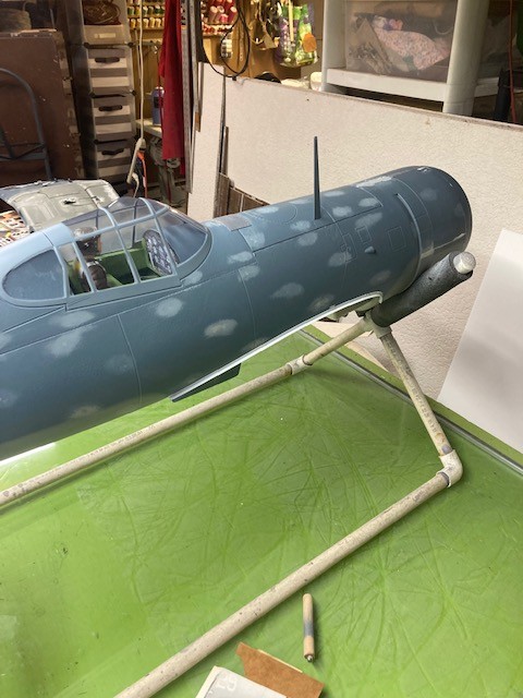

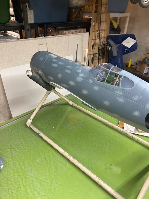

    Well guys another small detail almost finished, Pitot Tube. Plane is starting to look like a speckled egg with all the molds getting sanded. Hope its ok if I post these kinds of photo's. Don't want to bore everybody. Regards, Rex

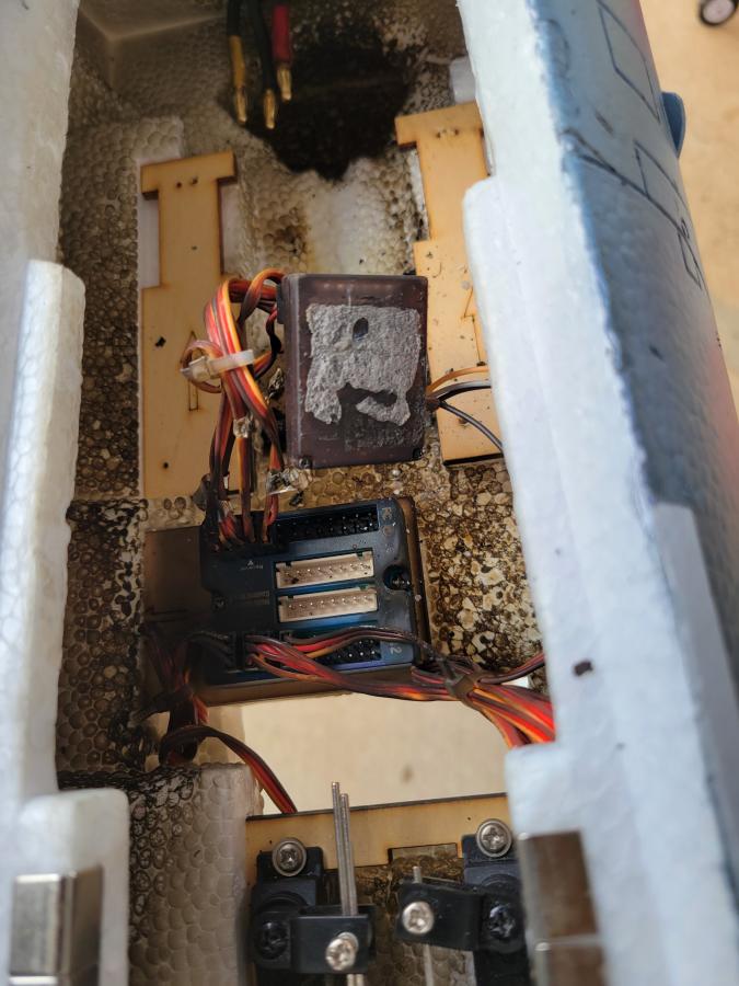

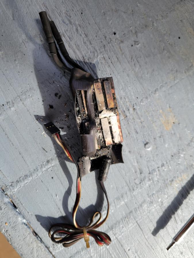

        It happened AGAIN today at the field. Had two very good flights with no issues. I went to take off for a third time, nice easy throttle advance, the tail came up, and then white smoke came billowing out and the ESC burst into flames! This is the second time this has happened. The exact same thing happened about 18 months ago, and all components are OEM. I can understand an ESC having an issue once in awhile, but this is the second time the Freewing ESC has burnt to a crisp and toasted all servos, retracts, blue box and receiver. After the first time I put a 100A Freewing ESC in it. I've done power checks before and Amps and Watts were both within the motor limits. Has anyone heard of this before?? I can't believe this happened twice to me with no warning
        . :face_with_symbols_o

          So sorry to see this. I have not flown mine yet but always have a fire extinguisher in my flight box. Hope you figure it out and continue to fly your Corsair.
          Best Regards. Rex
            #5285
            I have yet to have this happen in a freewing plane, but I have had similar things happen in fms planes yes.

              Looks great, Rex. I assume it is removable when not in use? Is it made of brass, or some other material? Most of mine are a combination brass, plastic, wood, etc. I've tried different materials, always removable, and have tried styrene lately to try to break off easier if it goes off-runway and gets ripped off. The styrene seems to do less damage to the plane a couple times that that has happened. 👍

                It is made from brass, aluminum and now I have the little arrow installed on the aluminum tube after squeezing it to look like the real one. It is styrene. I also added the metal strips on both sides of the fuselage over the wing. They are from 3/16 angle styrene glued to the fuselage. Added Elbee’s panel on top of the hatch and put a magnet in to remove the hatch. Pictures later
                Regards, Rex

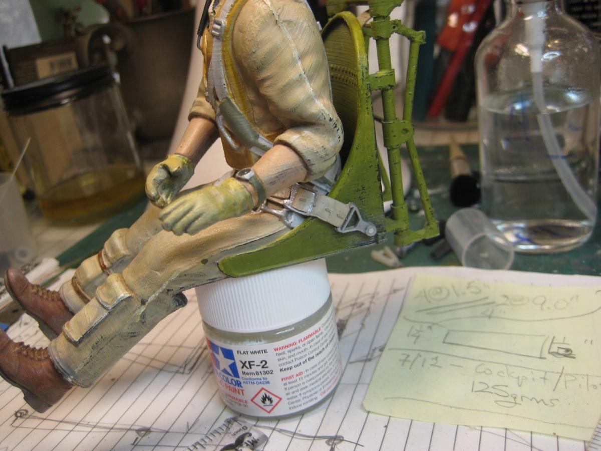

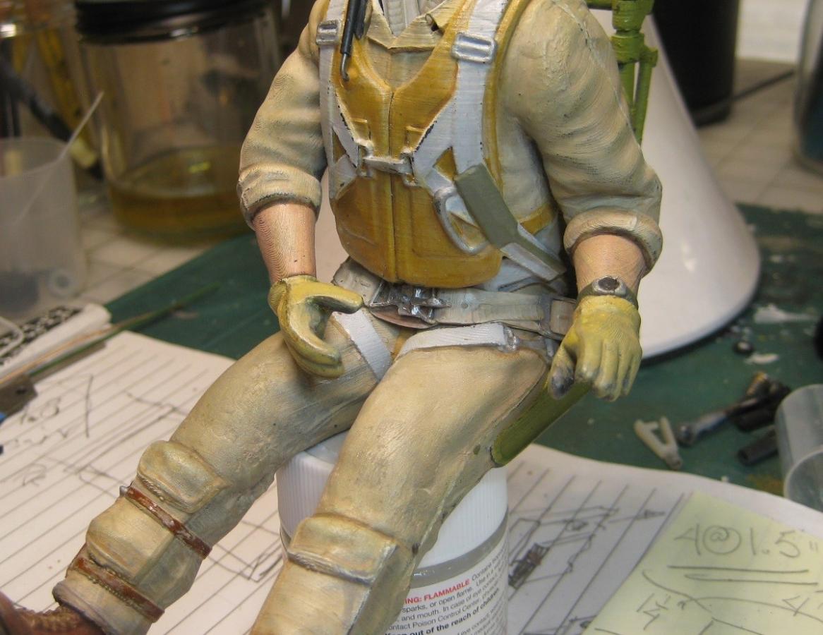

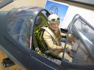

                    Corsair Crew, I've been trying to give my Pilot the best shot at surviving my flying skills with a decent 'seat harness'.
                    The Lap Belt is complete> AND so is the "Shoulder Straps". WOOHOO ! Best, LB

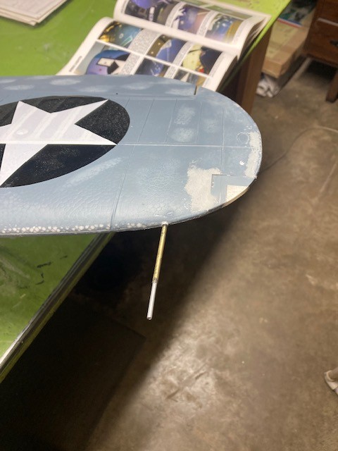

ID:	367379 Thank you Elbee for the comments. Believe me Davegee is far more the detailer than I. I still consider myself a beginner and trying to add what I see in my mind. I am stealing techniques from guys other builds and using what I think looks right. My Corsair stock weighs 7.8# with the Robart wheels installed and no battery in plane. Hopefully with lite weight materials and a new paint job I will not add excessive weight. Will See! Here are a few more photos that are in progress. The Dog says it is time for our afternoon nap so will continue later this evening on the build.

                        Pilot is looking mighty fine, LB! Don't worry, you'll do just fine flying your Corsair with your new pilot "cinched down, real good!" I have found the Corsair a delight to fly, with really no bad habits, with the exception of giving it a lot of right rudder on takeoff to keep it straight down the runway, and for landings, keeping the power in there some until touchdown in a two point attitude, and slowly bringing the tail down as you keep it straight with the rudder. It really is a fine flying plane!

                          I like the idea of your sanding off the little marks made during the injection process. I hadn't really thought of sanding them off, but it is still a good idea, I think. I don't think you'll have any problems with the weight of your plane affecting its flight performance. I have flown my Corsair with stock wheels and then with the Robarts, and I could not see any difference at all, with the exception that it lands better and sticks the landing almost every time with the Robarts!

                                I was in contact with Martin at MotionRC today going back and forth on email. I really thought they would be willing to help out a little here. When the Freewing ESC goes, it sends 20+ volts to everything and frys them! I'm looking at $240 just in servos and retracts alone (for the second time), not including a new ESC. I'm not looking for something for nothing, but a bit of a credit towards purchase of the replacement servos and retracts that the ESC took out would have been a nice gesture. I guess 2 Avanties, a Tigercat, a Corsair, and a Spitfire and a ton of parts was not enough to matter. I'll have to seriously think about my future purchases and recommendations. I would recommend using an external receiver battery and disconnecting the ESC power wire to the receiver.

                                  I'd recommend you ditch the stock setup... actually, ditch the Flightline Corsair altogether and get an FMS 1700mm Corsair. It is bigger with a tad bit more scale bits. You will need to upgrade the ESC as I did in the attached pic. I put the 8s, 150a ESC from Freeing in the nose. The added weight also balanced the plane out perfectly. You've likely seen this video already, but if not, here's how it performed after I did the upgrade: https://www.youtube.com/watch?v=5GwGxeurpDs&t=72s
