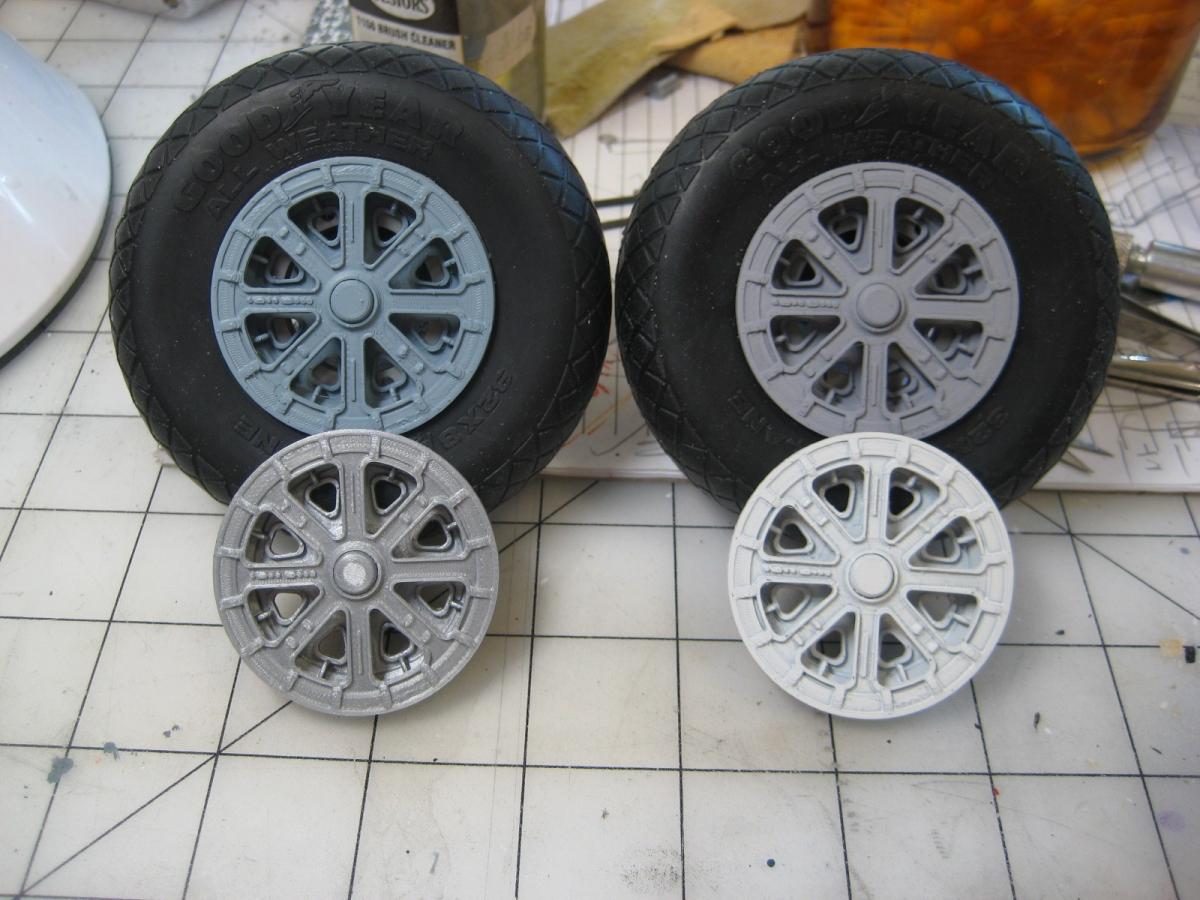

                If you use your Robart 3.5" wheels, I have included 2 STL files of a wheel/hub insert I designed. This adds a bit more detail than the OEM.
                The design prints well and fits great. Best, LB
                3.5RobartWheel_HubOnly.zip

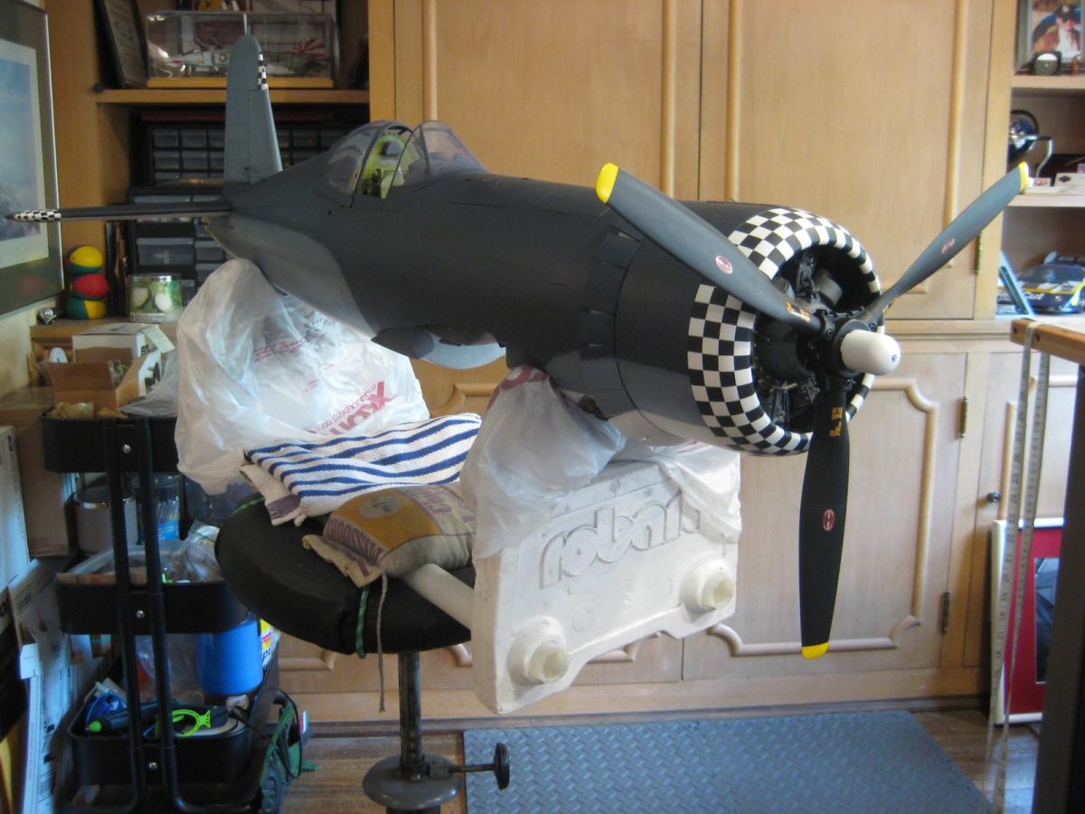

                  • My moniker at RCSB is Jetfool. I have three builds on there and I am working on the F4b this winter, hope to have it ready for next season. I usually cut my parts by hand and cockpit details are scratched too. Retired so take my time. Thanks for the wheel hub I will give the Hs kids something to do. Plan on keeping them updated on the build of my Corsair and want to take it to their class when done. Who knows might encourage some to get involved in rc or an aviation career. Rex
                    • Beautiful work. I can"t get the attachments to down- load could you send them again. Your fuselage looks great, love the open canopy. Is it movable or fixed? Would like to make mine to open if possible. I have a parkzone Corsair with retracts and the Banana Hobby Wildcat. They both fly great, retracts up or down. Glued the Wildcat canopy open and looks realistic in a fly-by. Both retracts have held up well with no problems. Rex
                        Elbee commented
                        Editing a comment
                        Rex, the canopy slides backward/forward and is servo driven. The cowling flaps open/close and are servo driven, as well. Best, Steve
