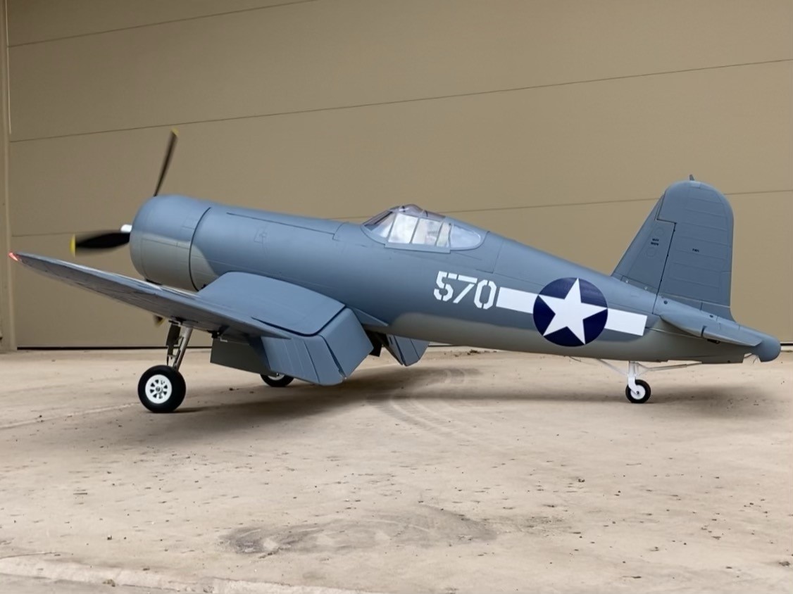

                            Took the 'ol Corsair out for a few flights this morning. Beautiful, almost calm weather. I would concur with Nuts-n-Volt's comments on flying this aircraft in a previous notice above. Rudder is a key, BIG rudder sometimes, and NOW, when required. I have also found that my changing out the stock main tires for the 3.5" Robarts helps in ground tracking and "sticking" it on the ground on the mains when landing. Definitely bring it in with some power to touchdown, to be sure. Two-point, tail low, works for me and realism for the real plane.
                            My plane commemorates one flown by one of the great American aces of WWII, Capt, Robert "Killer Bob" Hanson, USMCR, MOH (posthumously). He was the top scorer in the Corsair aircraft (25 kills) before he himself was killed on a fighter sweep in the Solomon islands a couple of days before he was to be rotated home for R&R, and just after his 23rd birthday. RIP, Bob.
                            Today is the 77th anniversary of VJ (Victory over Japan) Day celebrated on the 14th in the west, but on the 15th in Asia (time zone difference.)

                              DG, Just a beautiful repaint and mod of a memorable aircraft flown by a courageous naval aviator. Bravo Zulu, Sir. Best, LB
                                Thanks, Elbee. Your opinions are very much appreciated.
                                Bob Hanson was one tough marine. He got those 25 kills in just a matter of months through hellbent fighting to shoot everything down that he could. A few days before his final mission where he was killed, he came back from a fighter sweep and somehow had a landing mishap where his plane flipped over, severing his thumb in the bargain. The last squadron group photo shows him wearing his usual camo's with a bandage on his hand where his thumb used to be. He went right out and flew missions again. It's good to remember our war heroes like Bob Hanson and all the rest, I think.
