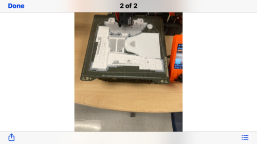

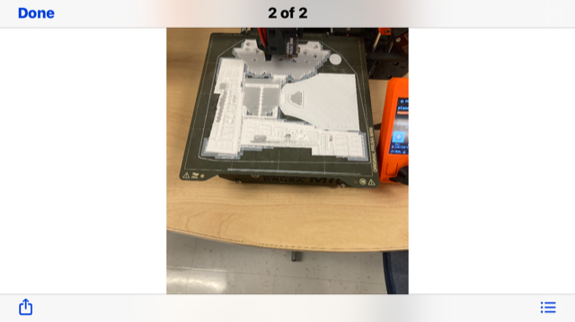

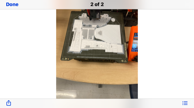

Thanks Steve. I gave him all your parameters for set-up. He and his teacher set it up and looks like it is going to be a nice cockpit. What do you do first to start painting, wash with soap and water, sand, prime
then paint? My first time finishing 3-d parts. I have watched the videos on here and practicing.

Rex, Other than ABS, most 3D prints using PLA or PETG plastics do not sand well. Depending on the detail level, examine the part for major defects, these can be filled with Thick CA. The parts you have printed are going to need some clean up as the curved side panels were printed with supports most likely. Those can be testy to sand/cut away, but you've no doubt done this before.Originally posted by jetfool View PostThanks Steve. I gave him all your parameters for set-up. He and his teacher set it up and looks like it is going to be a nice cockpit. What do you do first to start painting, wash with soap and water, sand, prime, then paint? My first time finishing 3-d parts. I have watched the videos on here and practicing.
Going to be a great x- mas for me this year. Birthday is next week and wife has ordered the Tiger Tank Pro from Motion today for b-day present. Got everything paid off and enjoying retirement. Rex
. You can use a Bic lighter to quickly melt away the fine hairs and goobers if need be. A good off the shelf primer will work, I use Black or Dark Grey Rust-Oleum from Home depot. I usually do not sand the parts after priming. Any enamel, acrylic or lacquer paints will work as long as the primer is dry.
