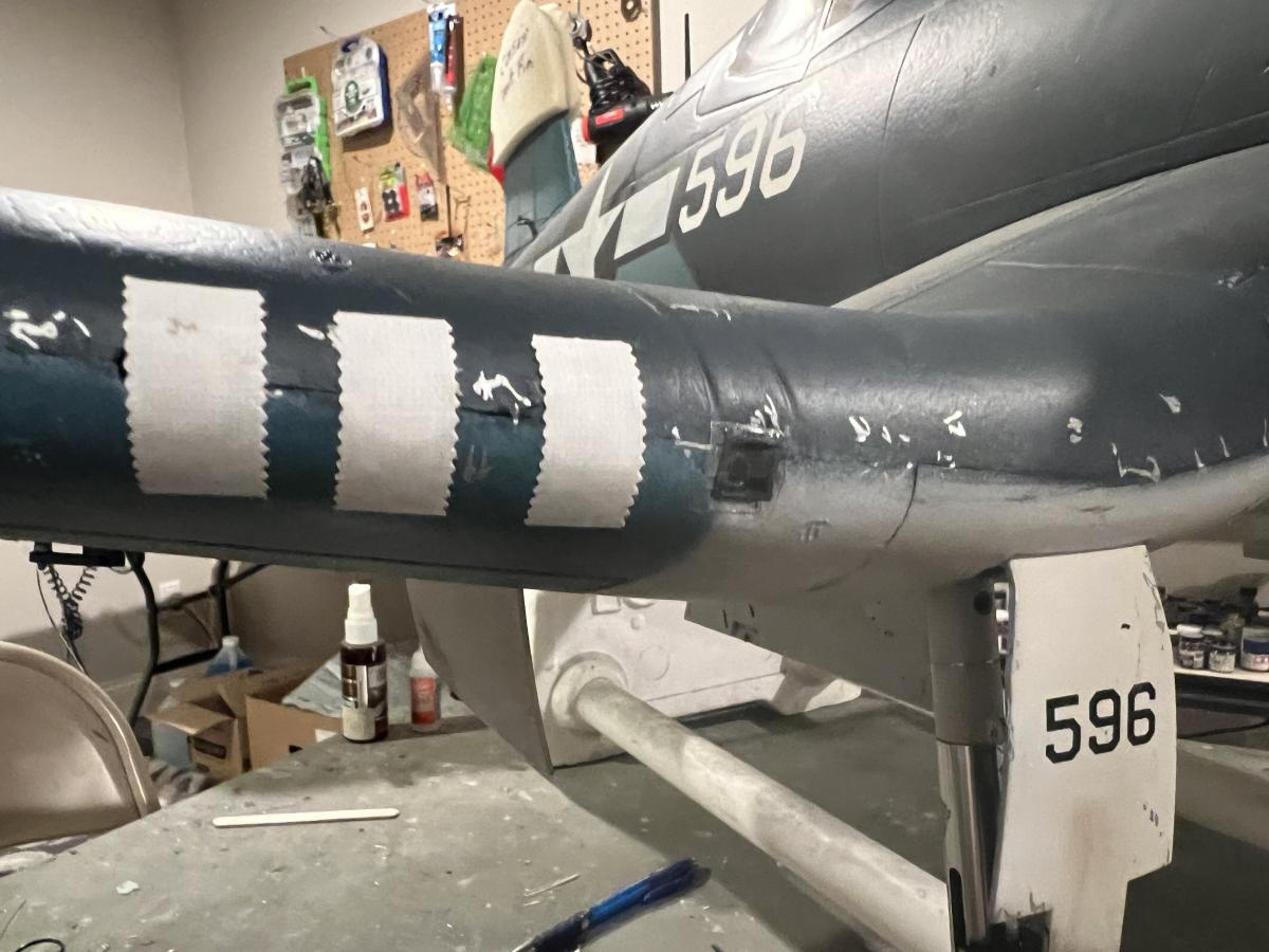

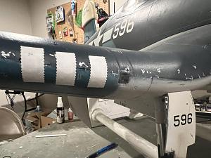

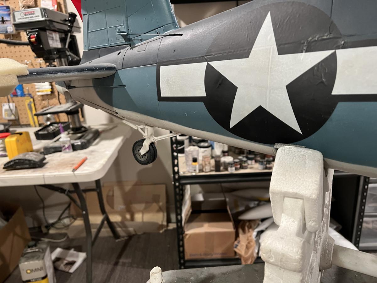

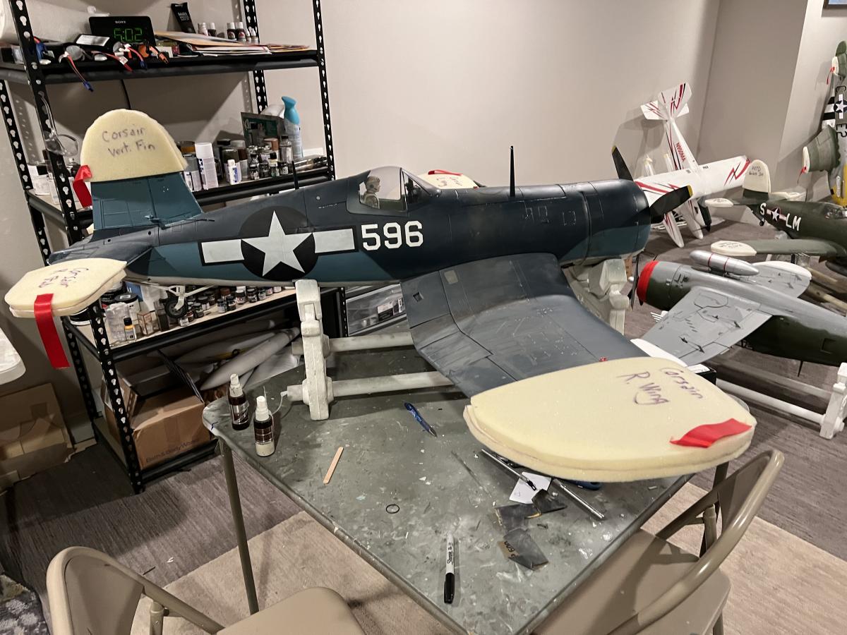

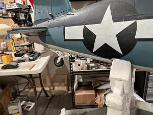

                      Did some work on my Corsair today. Haven't flown it since last fall, but as soon as I get a decent day with little wind, I'll take it out for a flight. One of the things that I had planned on doing but I guess forgot to do was make a simulated gun camera port on the right leading edge wing. I did that today, even added a little tube inside that mimics a camera lens inside the protective clear plastic cover. The white patches over the guns, for those not familiar. were taped over by the armorers after they had loaded the .50 cal bullets and the guns were ready to shoot. It was meant as a safety reminder that those guns were fully loaded and ready for the next mission.
                      Also got LB's magnificent printed tailwheel installed, so I'll be all set when the weather cooperates. Attached are a few pics in the shop today.
                      Cheers
                      davegee

                        Your Corsair looks great. T/W adds a better touch than the OEM. I planned to add the camera lens also and you just saved me a lot of measuring where it goes. Thanks!

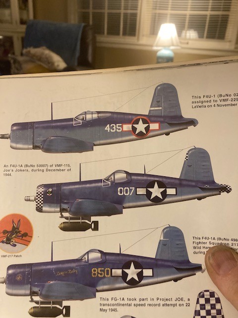

                        Elbee, I found a profile of the Corsair your coping and it is shown with a bomb on the Brewster bomb rack. Might be something interesting to add. Not many will detail the bomb rack like you can. Found this in my Squadron book Corsair in Action.
                        Looks like spring will be full of gull wings.

                          Elbee commented
                          Editing a comment
                          That is so cool. I will have to find a copy. I also see the aircraft is misidentified as a VMF-115 "Joe's Jokers". That is a common error with that livery I have found. Best, LB

                        Looks like that is one book I don't have. I probably had it before the big move three years ago, but it was a brutal downsizing, stuff I had been accumulating in our house for 27 years before moving. We probably got rid of 75% of the books we once had. I still have some of the more important books in a book case in my study here In WYO, though.
                        I had to "eyeball" the gun camera port a bit. Ended up using a piece of Evergreen white tubing, about .3" square. I took the tube and carefully started pushing the end where I wanted the camera to go. It made an indentation in the foam, and I carefully used a exacto knife and a needle nose piers to carefully pull the foam pieces out of the hole. Then I cut a section off the tube, maybe 1/2" long, and started sanding the front of it so that it would conform and be flush with the shape of the leading edge of the wing at that point. Painted it Navy blue to match the rest of the upper parts of the airplane, and glued it in place. Cut a small piece of K&S aluminum tubing, not sure what the diameter was, but something to look believable as a camera lens. Glued it in. Then, found a piece of very thin, maybe .005" clear plastic from the packaging of a sharpie pen, found it had a slight curve in it, and cut it so I could glue it over the hole, slightly bigger than the square tubing I had put in. Used that same white glue I mentioned previous above, taped it in place, and Voila! You got yourself a camera port.
                        I'm pretty sure that it is right where it is supposed to go. Had several good photos for reference.
                        Let me know how it goes.

                          Thanks Davegee for your installation instructions. Yours really looks great. I will try it on mine.
                          Elbee, You could make it operable and as it swings down to drop the bomb, a cable fixed in the bottom of the fuselage would be pulled out of the holding pins in the bomb to release the bomb. I use old broken control line cable for these things. The cables are thin enough that they won't distract from the model. Just something for you to think about. Ha!

                            jetfool I like both bomb racks, the Brewster and the field modified. I don't know how I'd make either of those operable until I decided to build one. Aesthetically, I like the Brewster, but also like the idea of a bomb under each wing. Time will tell....Best, LB
