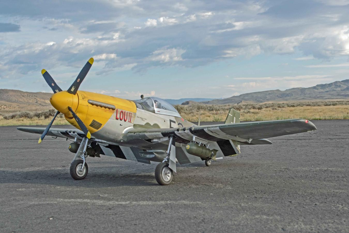

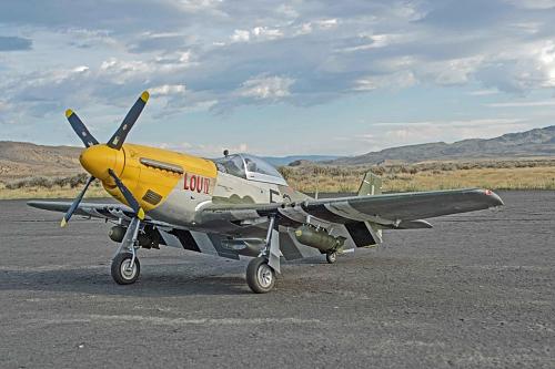

                        I think that is a very noble project to do, of Ken Walsh's airplane. He made a tremendous contribution to our success in the war in Asia during WWII. I also think you are probably better off, even though it will be more work after you carefully peel the stickers off, as you will now have a "fresh canvas" and don't have to react to inaccurate or mis-sized decals that you have to work around. If it were me, I'd get all new stuff from Callie, in exactly the size, shape, color, and detail that you find on Walsh's airplane.
                        I did a total redo of the E Flite P-51D that is currently on the market. It is painted up as modern day paint scheme that has been used on a full sized P-51D on the airshow circuit. It is "roughly" a replica of the real plane flown by Col. TJJ Christian, Jr., the commander of the 361st FG out of Bottisham, England in WWII. Christian was actually killed in this same aircraft during the war, leading an attack on a rail yard in northern France in 1944.
                        At first, I thought I could just paint out the gaudy and inaccurate blue top cover to a olive drab. But what I opened was a Pandora's box! Turns out, every single decal or sticker applied at the factory might have been ok for the modern replica that they chose to model, but for an accurate WWII version of this plane, Everything had to go. I'm glad I didn't try to work around the stickers that were already on the plane. It was better to do all the work with my "fresh canvas" and everything was then scaled to fit this airframe.
                        Regarding the "shrinker bars", I might put something in there, I have done it before using a small piece of aluminum tubing on the back side of the strut. Interestingly enough, for bigger birds like I used to fly, they actually did make a landing gear with a Working shrinker bar that actually pulled the gear strut a scale amount of length to fit in the wheel wells. I think the real plane had a 9 inch long length that had to be shortened to fit in the gear well. All a matter of compromises, and I salute the Republic engineers for coming up with this ingenious design.
                        I will see how the shrinker bar looks, especially that it does not interfere with the extension or retraction of the gear.

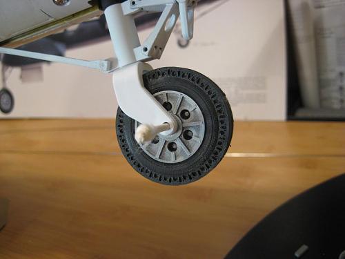

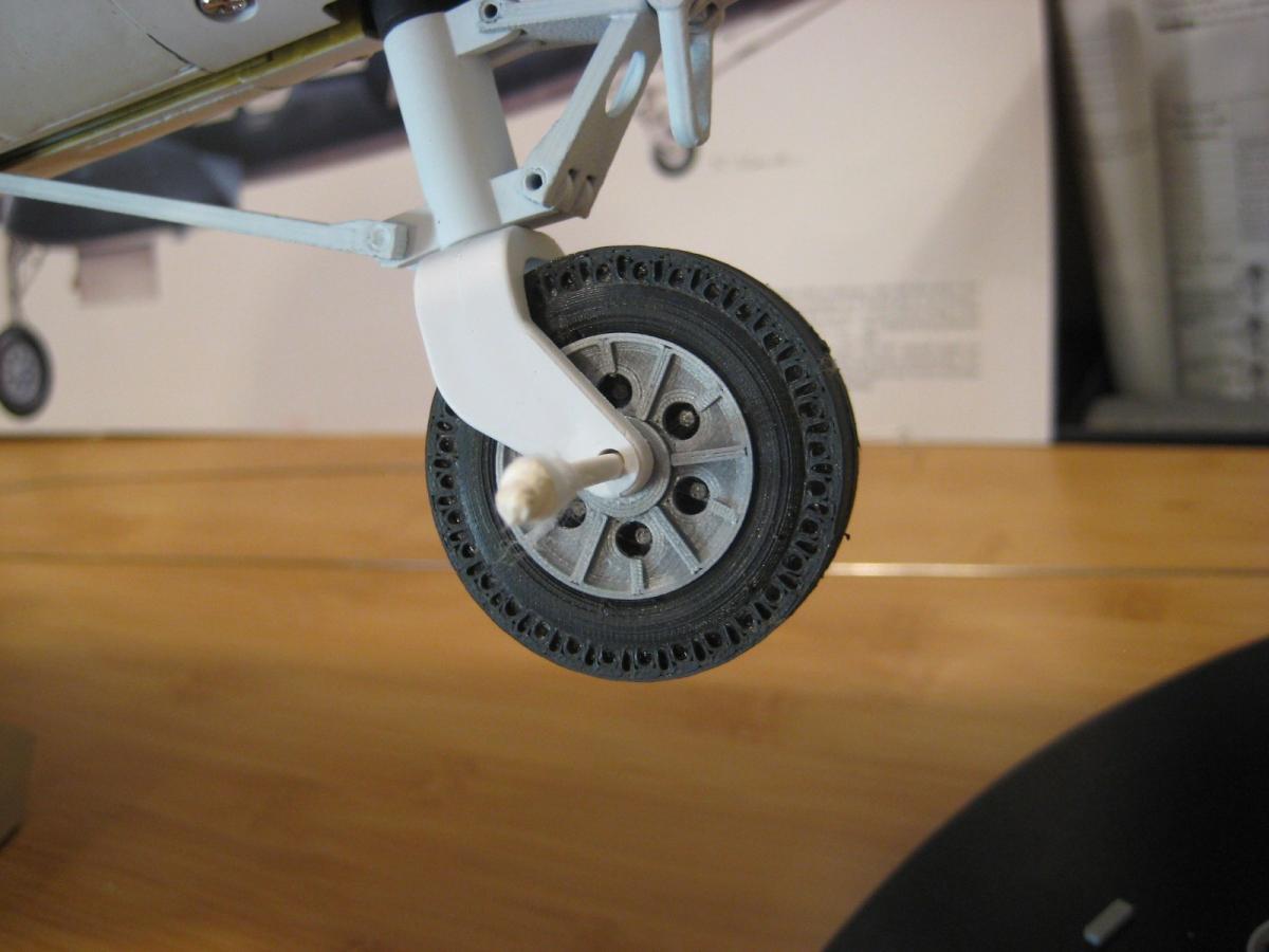

                            Found some good pictures of the open tail wheel which looks more traditional. Much like the Robart MG Dress Up rims this prints similarly in parts.
                            Also, I have printed the tire several times with TPU (flexible filament) to find an infill pattern and percentage to allow for a "soft bounce" but not spongy or rock hard.
                            The TPU prints details well with some tinkering, but is quite glossy, so some weathering is needed. Note: tire has one coat of a grey/brown wash, wheel does not.
                            Note: my wheel and tire are not accurate to most Corsairs but more period-looking than the FL OEM.

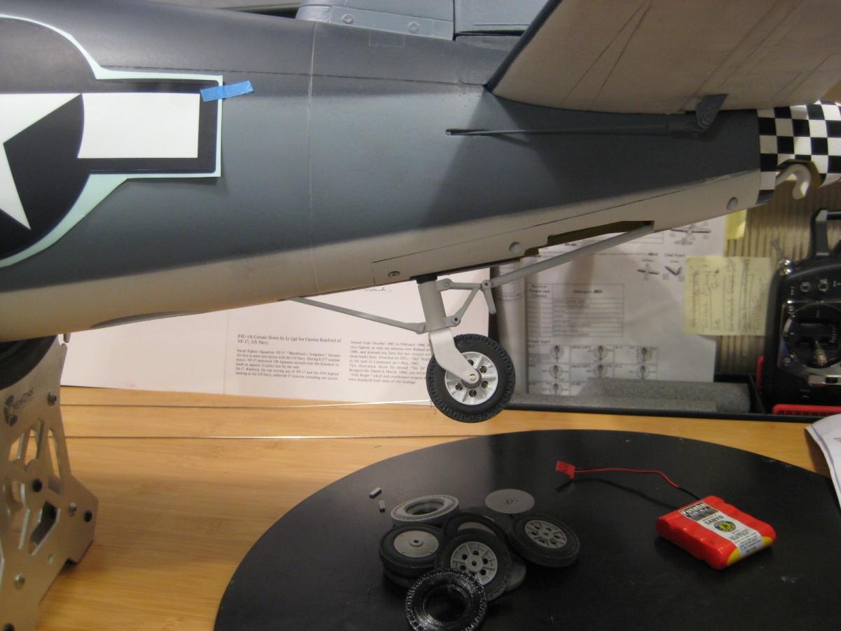

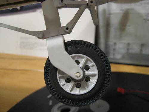

                                  jetfool Yeppers, got to get in my 8-8.5 hours-o-sleep each night. It just takes 10 hours to do that due to all the bathroom visits .
                                  Last iteration of the open whee/tire combo; wheel is a bit larger in diameter, tire profile shorter and overall height a smidge shorter.
                                  Wheel paint is okay but I will weather the entire TW assembly when I weather the bottom of the fuselage. Did a repeat of the brown/grey wash on the tire.
                                  Had a couple of nozzle glogs with the TPU this afternoon, thinking it was due to the glue on the heat bed.
                                  I have never used glue stick on the heat bed before this, but that was suggested by Prusa Folks when using 'flexible' filaments.
                                  All your grandson's work seems to be paying dividends. Good lookin' parts there, gang.
                                  Best as always, LB

                                      You couldn't get a better looking tire from Goodyear! Well done, Steve!!
                                        • 4848
                                        #5260
                                        jetfool and davegee , I thank you, Gentlemen. I have been thinking about a redesign of wheel/tire combo for some time, actually since the first time I dropped the gear and recognized it as the nose gear wheel/tire from my Freewing F-18C.
                                        Gotta love those 'economies of scale' and I am not faulting anyone, I get it. It's the way to overall costs down, but I just wanted to do something, you know. Anyway, thanks again, Steve
