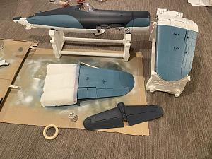

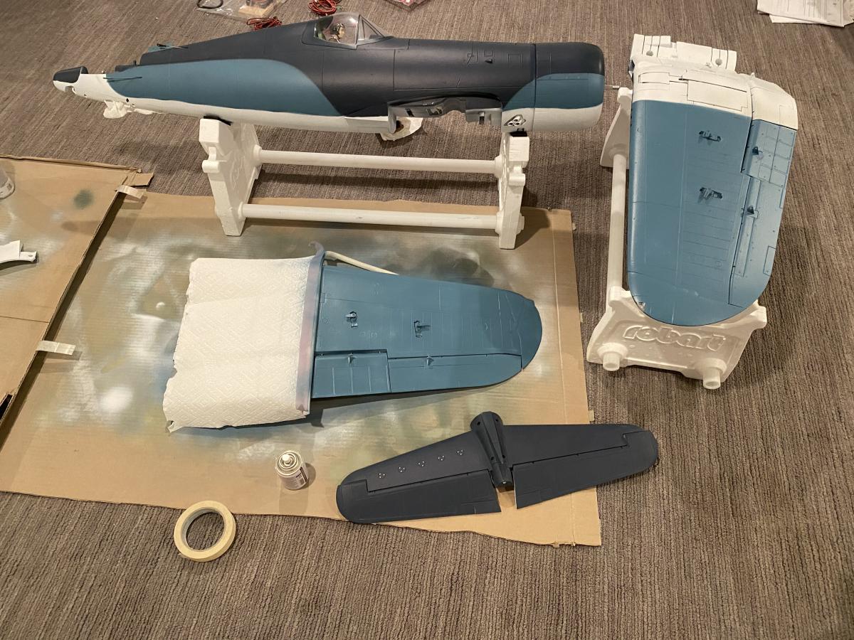

I must be a modeler with "the fever" or possibly an idiot, or a combination of both. Today, I drove two hours each way to get a root canal done, and when I got home, I started in painting my new Corsair that came in the mail yesterday. Building (or at least assembling) and painting and detailing these foamies is still fun for me.

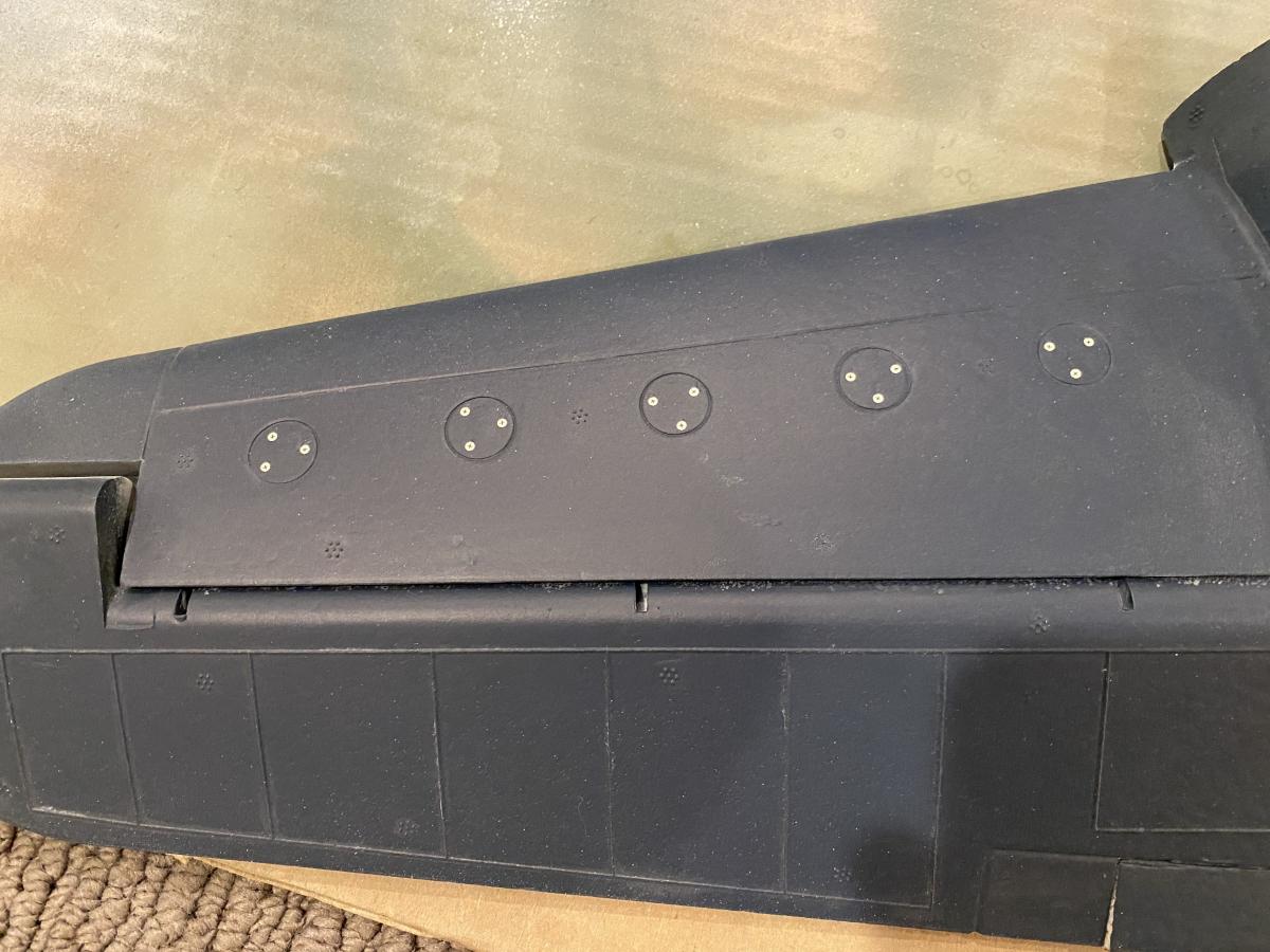

I'll attach a couple of pics I just took. On the horiz. stab picture you can see tiny scale screw heads for the inspection panels on the left stab. The same is done for the right stab, which has the inspection panels on the bottom, as these were interchangeable units. A pretty sage idea for back then, in my opinion!

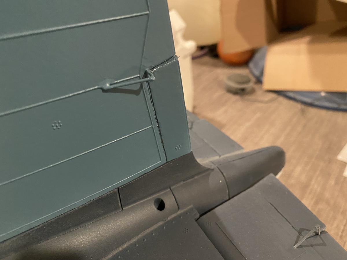

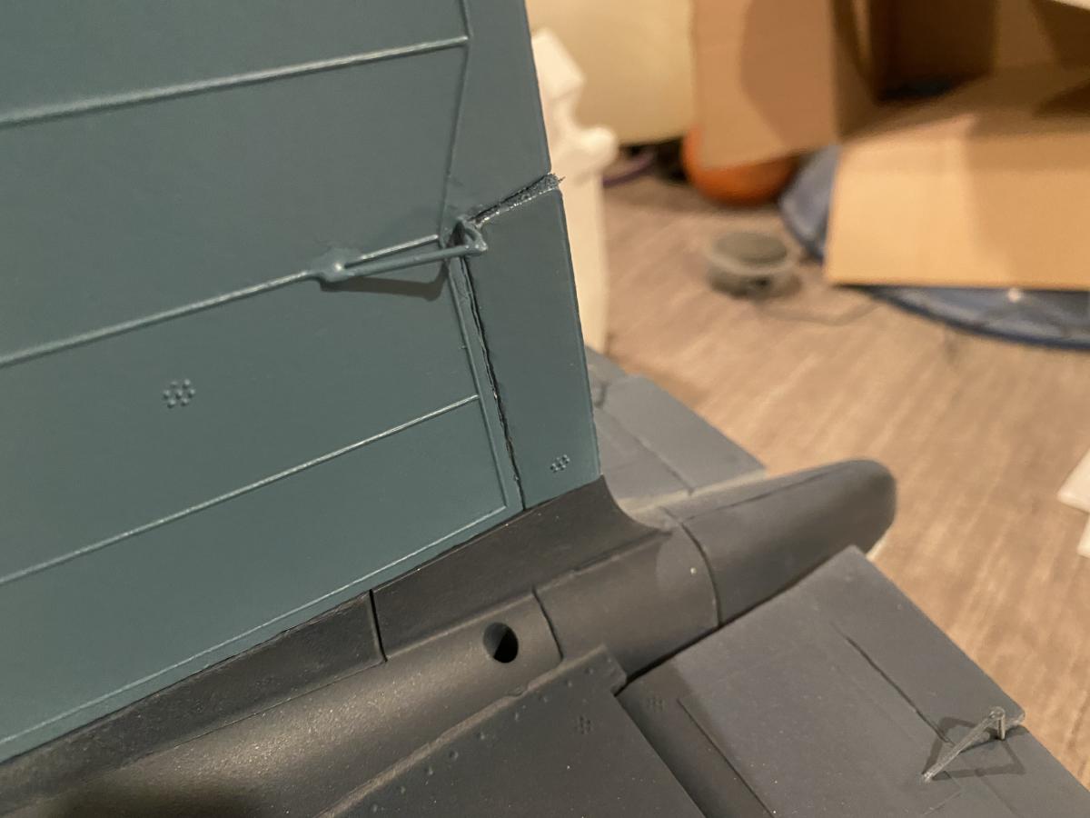

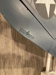

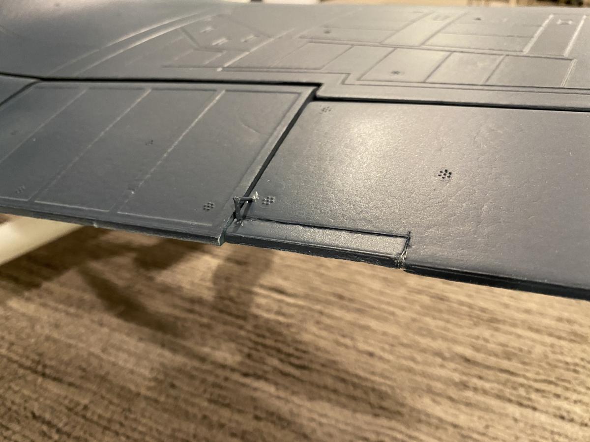

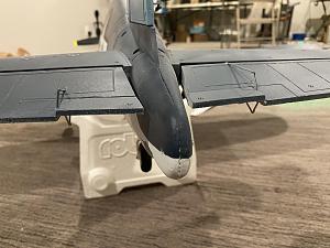

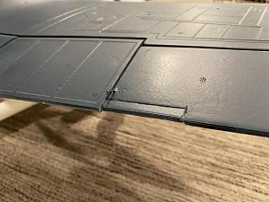

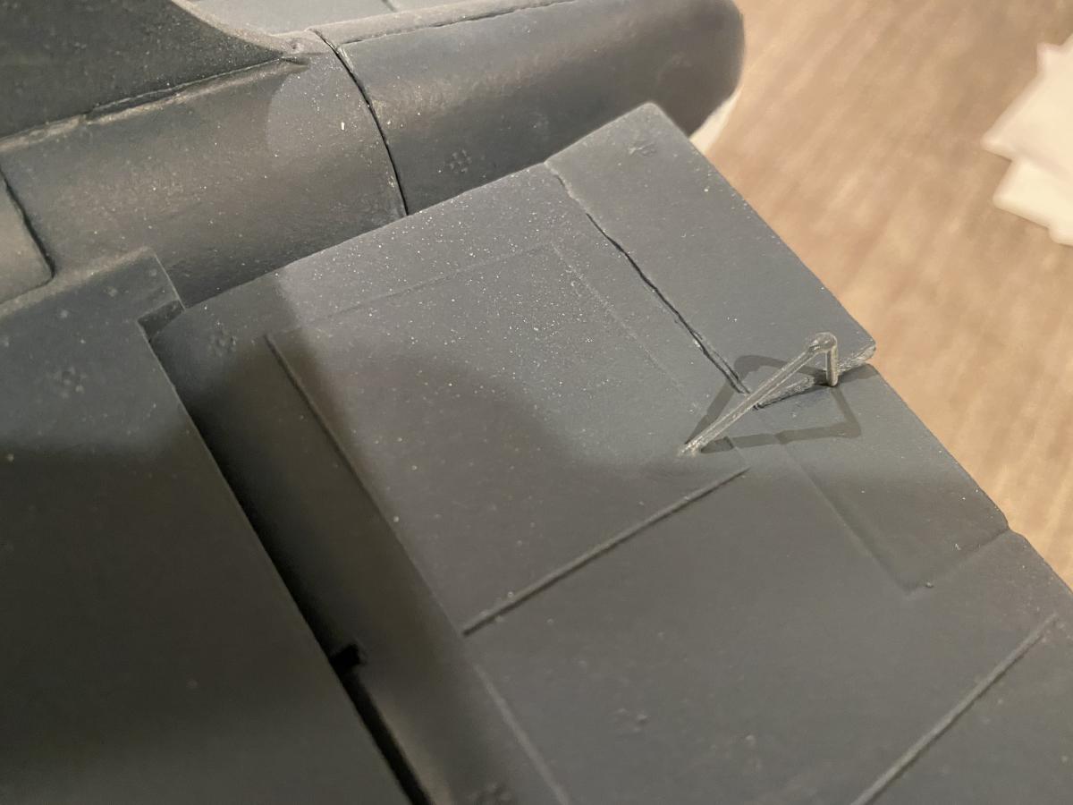

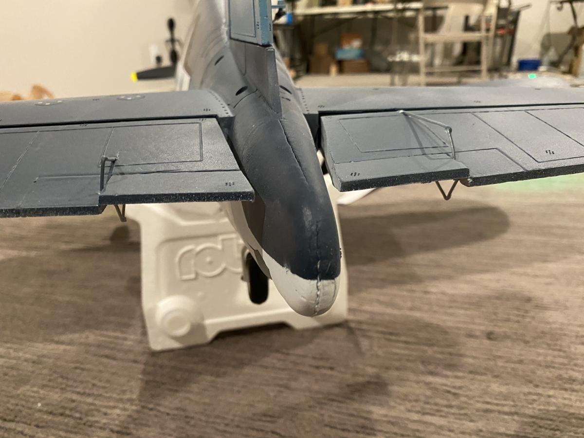

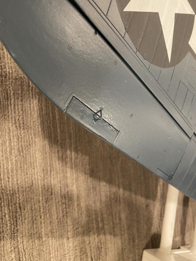

I decided to model the trim tabs on the Corsair like the real one, making little actuator arms and cutting the tabs out a little bit to reposition them slightly from totally faired to a look how they might be as the pilot makes subtle changes in trim. I don't think my deflecting these little trim tabs out a bit will cause any problems for the actual airplane flying. I've done it on big gassers, but not the little foamies yet.Here is an update to my
Corsair project. I've decided to let out all the stops on this one, or at least some of them, even if it is just a foamie. It's still fun and a challenge.
I never cease to be amazed at the incredible forward thinking design of this aircraft over 80 years ago. And, they kept improving the Corsair and I think it stayed in production until the early 1950s which is pretty good considering everyone was going to jets back then.
Anyway, here are a few shots I took just now. The aileron had a trim tab on the left wing, and a smaller one inboard of that that I think was like a balance tab: that is to say, it moved mechanically when the aileron moved to lower stick pressures to the pilot.
The rudder had just one trim tab. The elevator was the complicated one. Each elevator had one trim tab (the bigger one) and one balance tab which moved automatically to reduce stick pressures like for the ailerons. And, these stabilizer/elevator units were completely interchangeable, so you didn't have to worry about being on some forsaken island in the Pacific waiting for a "Left Elevator" assembly, and get sent 20 for the right one! Whatever your needs, you were covered.Comment
LOVE LOVE LOVE!
I think the trim tab mod is such a great scale mod for this model! Well done sir! What did you use for the actuator arms? Bravo Zulu to you!My YouTube RC videos:
https://www.youtube.com/@toddbredaComment
Thanks, Aros. I just used some aluminum metal rod from my scrap box, probably less than 1/16 inch in diameter. To simulate the moving joints on the actuator, I used a drop of white glue and played with it a bit with a toothpick to shape it before it hardened. Wasn’t hard to do, especially since I did this with my last Corsair that crashed a few years ago, and two 1/5 scale ESM models I did for museums several years ago.
cheers
davegee
