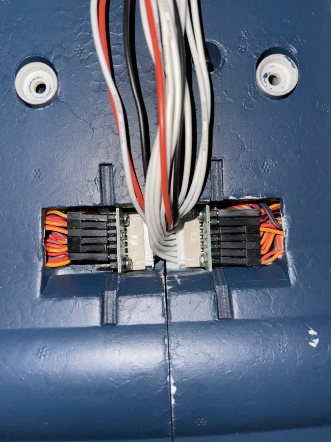

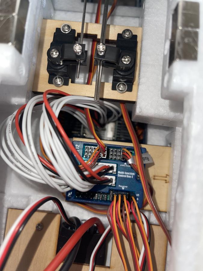

                    #4669

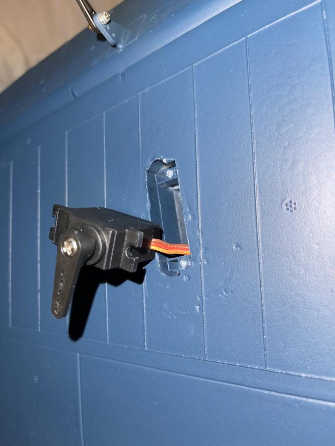

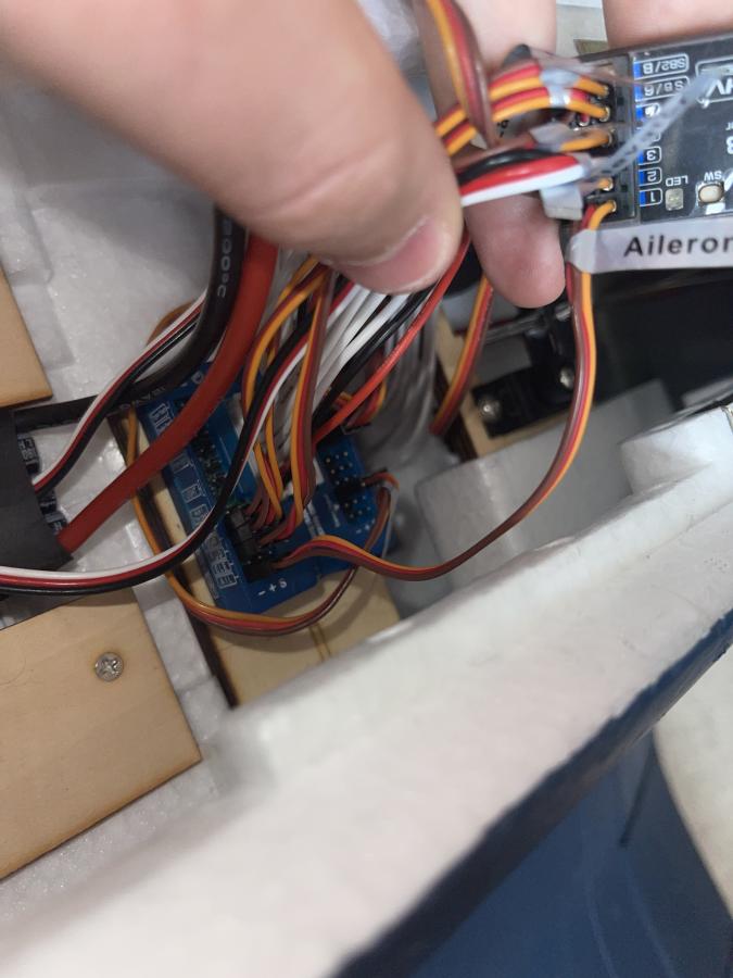

                    Hi all,
                    My ailerons still not working on the Corsair, I’ve tried every combination of the ports as well.
                    not easy to test the Servo as trying to find the ail lead amongst the very tightly crammed multiplug in mid wing is tricky. None of them are labeled either at that point.
                    ive included some pictures below of the current set up, incase you spot anything obvious.
                    Everything else works that goes through that multi plug so don’t thing that’s the issue.
                    even if I got working new Servos trying to feed them through the whole wing will be a nightmare.
                    thanks
                    fin
                      • 8795
                      #4670
                      Originally posted by fin121
                      Hi all,
                      thanks
                      fin
                      Sometimes, you have to use a little "out of the box" thinking. Yes, it's tight, but not impossible to do. You need some small hemostats. Just make sure you don't test the lights (2-wire) as you'll burn them out using a servo tester. That's why a servo tester is handy - for those situations where nothing is labelled.
                      Failing the above, have you tried the servo tester on the AIL lead that goes into the RX? If you look at the schematic that's included in the manual, you can easily see which one is the AIL lead. Yank that out of the RX and run it on a servo tester. (If memory serves me correctly, there is also a schematic of that wing board telling you which one is AIL.)

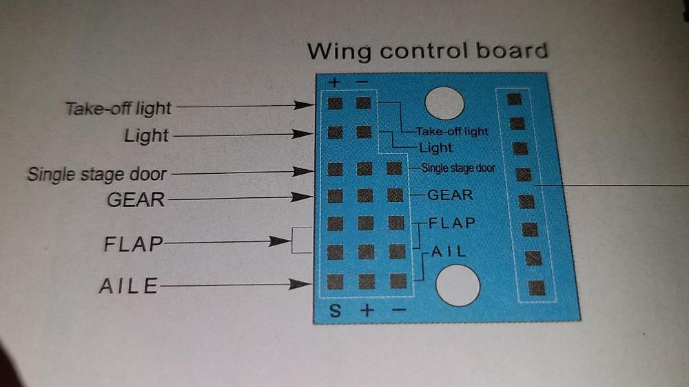

                          Yes, but that still requires you to find and isolate the AIL leads from the wing center.
                            • 2696
                            #4673
                            Hi,
                            thanks for reply. I’ll have to buy a servo tester as I don’t have any of the kit.
                            If it isn’t the servos (ie they work) a fella above mentioned to bypass the multi plug, is that the next best bet?
                            thanks
                            Fin

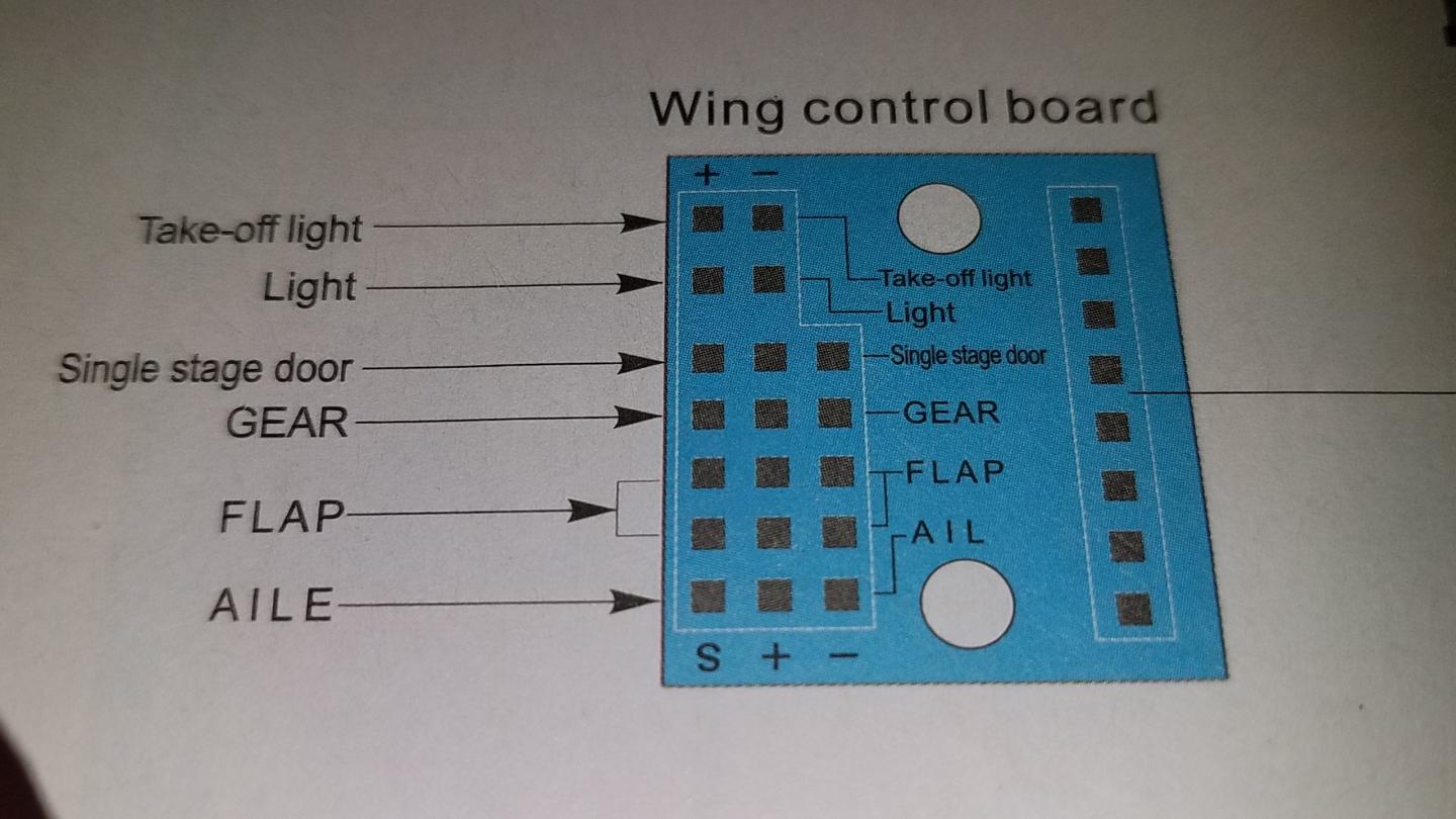

                            A little late here but my 2 cents for what it's worth. Since both ailerons do not work, I doubt the problem is with the aileron servos, nor is it likely the 2 ribbon cables going to the blue box. I would think it is either the single lead coming out of the blue box that connects directly to the receiver, possibly a poor solder connection inside or the lead itself (the blue box takes both wing leads and essentially connects them together with a single lead coming out to the RX), or for some reason you have your TX not set up correctly. I would try the following:
                            1) Since you don't have a servo tester, then as per the wing connector board pictured below, disconnect the aileron lead on one of the wings (should be easy to get at since you have it exposed and it is the first lead plugged in-opposite end is a 2 pin light lead), attach an extension to it and plug it directly into the RX. If it works, then there is a problem with the Blue Box. If it doesn't, then could be the servo or your RX setup.
                            2) If it doesn't work above, try the same with the other wing. Still nothing, then check your RX setup. I use Spektrum, so not familiar with Futaba, but I suspect that you need to make sure that your servo port for aileron is in number 2. Check the servo travel that shows the inputs on the aileron when you move the aileron stick itself and make sure it goes from 0 to 100 and 0 to -100. You can always connect the rudder servo wire directly to the aileron port in your RX to make sure the TX is sending the correct commands and now the rudder with move with as your aileron stick is deflected.
                            I think it most likely that either the blue box has an issue or there is something in the RX that is not set up correct, like the correct port, the amount of travel at 100, possibly for some reason the dual rates on aileron are at 0%.
                            Good luck, I know there is nothing more frustrating than having something so basic not working and being unable to get it right!
                            • fin121
                              • Sep 2021
                              • 9
                              #4674
                              Hi Hugh,
                              thank you so much for your help. And I think I have found the problem - as per advice 1) I have plugged the aileron directly into the RX ( it was long enough I could do without extension ) and it works so I think it is the single lead from blue box to Rx with a poor solder like you mentioned... anyhow I’m going to order an extension so I can plug both ail directly into RX, but before that I’ll order a new lead and try getting it working as per normal from blue box to rx
                              Either way problem and solution found.
                              thanks everyone for the help couldn’t have done it without!
                              fin
