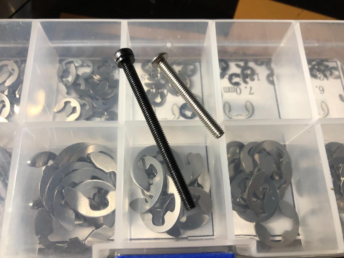

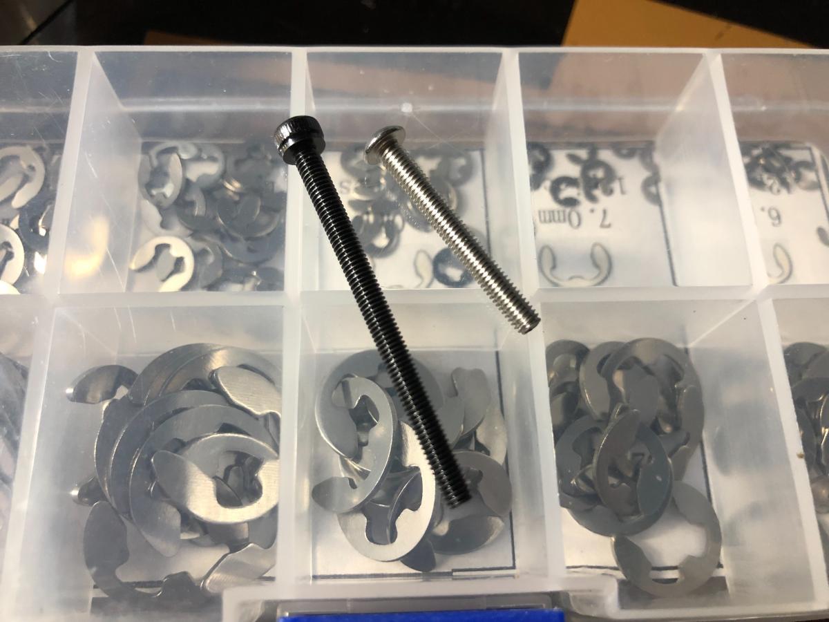

                          You don’t have to replace it with another grub screw. I believe those will be 3mm and any old screw can be cut to length and substituted. I do it all the time..., a button head won’t bind on it if you don’t bottom it out, thread lock it in and leave a small gap so it can slide.

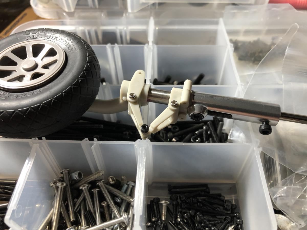

                          Look at this gear, nothing original about it, a modified nose gear.
                          It even sports a heavier internal spring to better absorb the shock of landing an EDF jet flying on a large 6s battery.

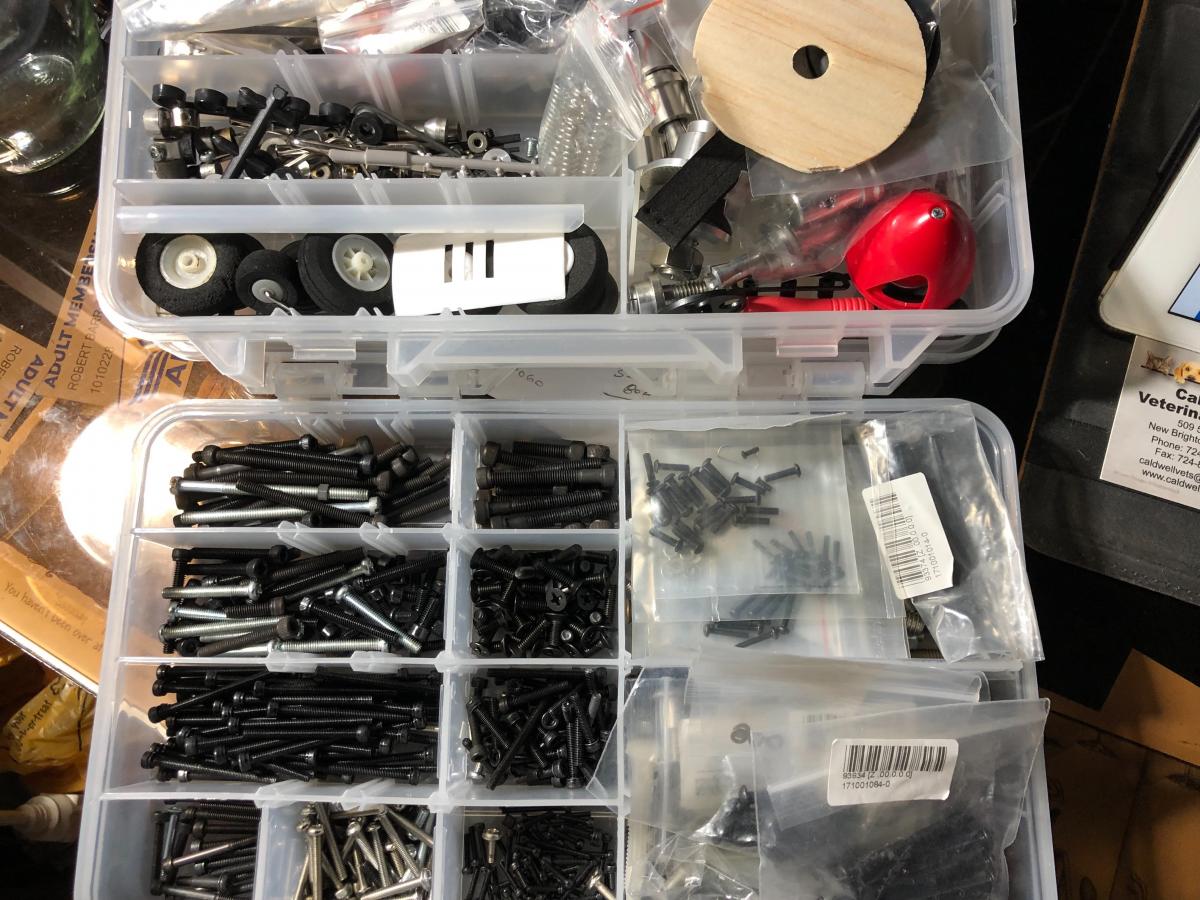

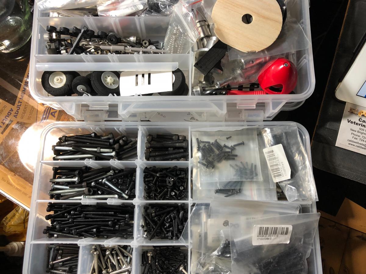

                          So, being the builder and mechanic first from models up through full size, I stock a lot of stuff...
                          Click image for larger version  Name:	58E9B21C-830D-4E69-95BE-17A4E4ACDA01.jpeg Views:	0 Size:	167.0 KB ID:	193075
                          Most of my small hardware comes from HobbyKing and my local hardware store, always ready to modify or replace lost, damaged, or junky kit hardware.

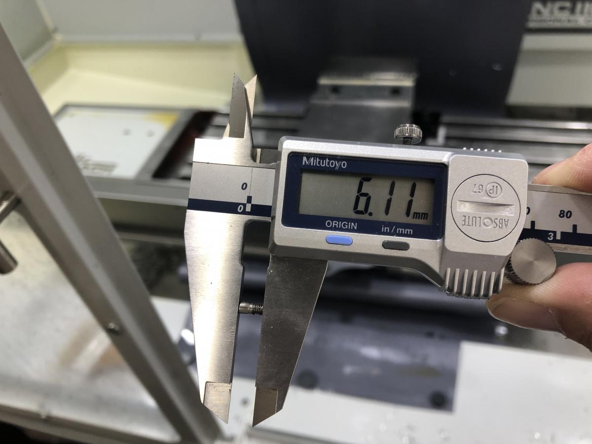

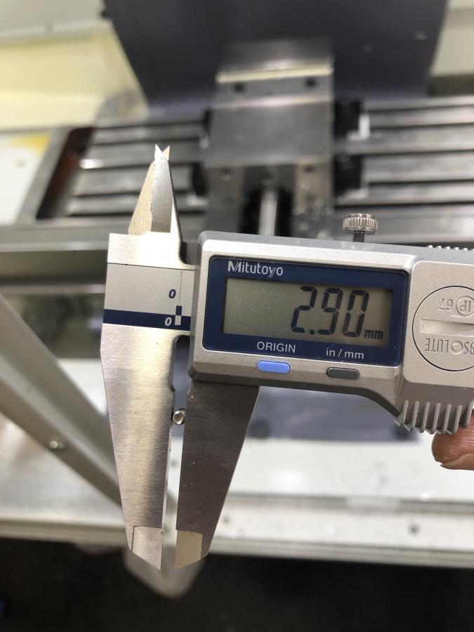

                                      Here you go. 3mm x 6mm. Might would dull the threads down that ride on the strut slot or use some JB weld to fill in the threads.
