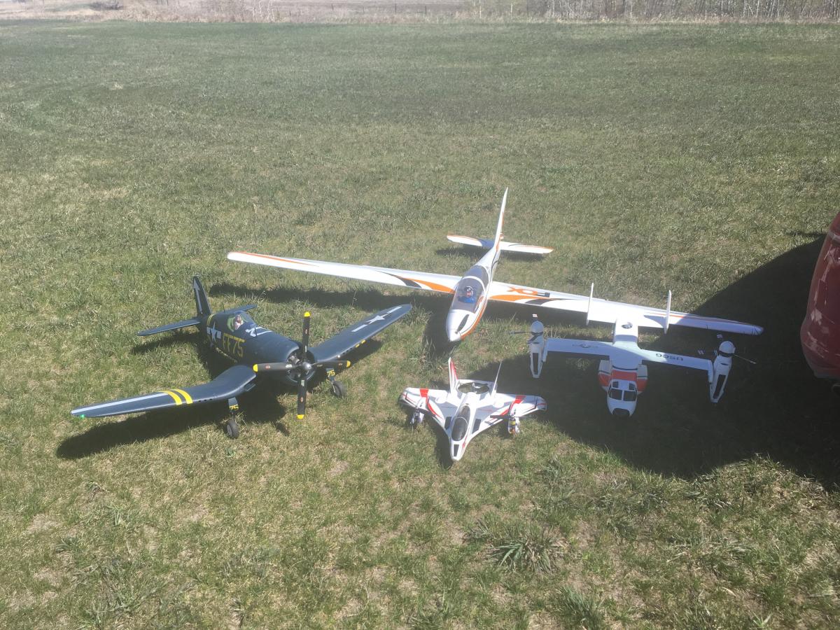

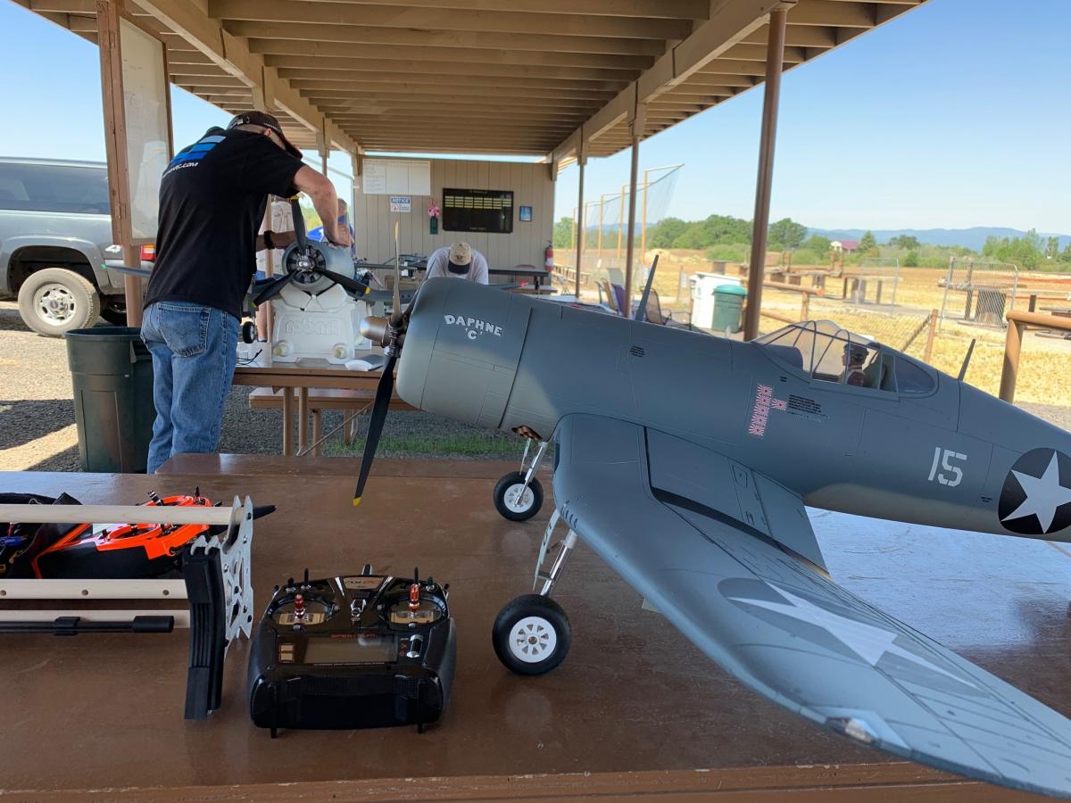

              Maidened mine today. Was going to get a video but camera failed. Had 2 flights, first one required a lot of down trim. (I think I'll put the remaining weights into the cowl.) Used a 5000 Turnigy Heavy Duty battery all the way forward. Once trimmed, it flew pretty good. Will still require more expo as I found it a bit sensitive, even on low rates. I'm not going to go into it in much detail. It's been done quite a lot already. I'll only add that I flew the FMS 1700mm Corsair with the upgraded 360kv motor and I flew the FW/FL with the 4-blade prop from the FMS Corsair two days apart. As far as speed and performance goes, even though the FMS is a LOT heavier, the two felt very similar on a full throttle fly by. Because the FW/FL one is so much lighter, it was more affected by wind gusts and cross winds but still manageable. I don't think a gyro will be necessary. The 1600mm does loops with more ease due to the light weight - requires less throttle. It was windy enough that I landed with no flaps and took off no flaps. It kinda floated in for the landing, not wanting to drop to the ground for quite a ways. Ground handling was better with the heavier FMS but the FW/FL was not a problem. I think it looks the part much better with the 4-blade on it. My personal preference (and I stress it's just MY choice) would be for the bigger, heavier FMS simply because I feel it's a more stable platform and it has a little more presence in the air. Flight times were similar with the timer set at 5:30 for both and ample battery left on landing. As much as I tried, I could not get the FW/FL to "whistle". I mean, they call it the "whistling death" but only my FMS does it so well. Even my sailplanes whistle on a fly by. I was going to give my FMS away, but as it stands, I'm keeping it and in time, as the FW/FL gets older and more used, I'll sell it or give it away.
              Here's a picture of it with the other planes I flew today.

                Good job xviper. Nice line up.

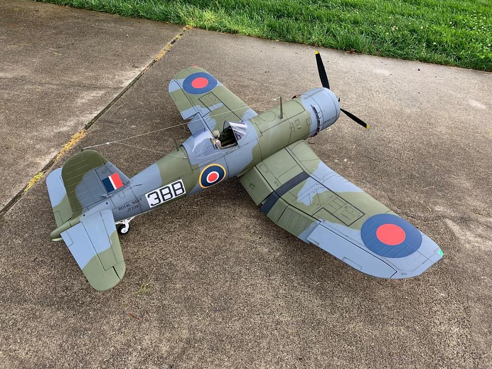

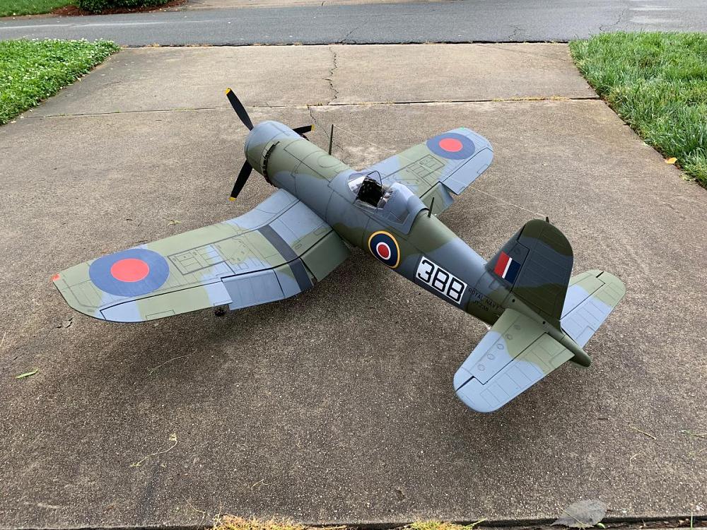

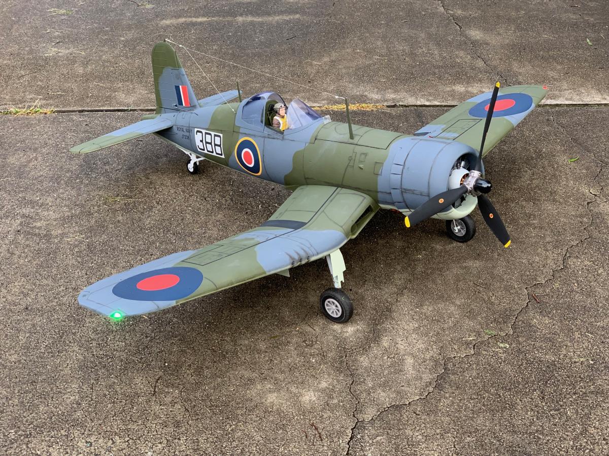

                              Here's my latest and greatest. It is the Flightline plane repainted as a Royal Navy Corsair Mk II. Decals are by Callie-Graphics. Added 2 3/4" Robart wheels, scratch-built cowl flaps and the Freewing Antenna wire set. Also printed out the 3D cockpit set, cut the wingtips down and cut the canopy open. Painted with Home Depot samples and weathered with chalk pastels. Only have about 3 flights so far. I'm finding take-offs a little squirrelly even with gentle easing of the throttle on takeoff. Once in the air, she's an honest agent though and landings are very predictable. I noticed that the full scale's retracts cycle one at a time. I'd like to do that but then will have to bypass the multi-connector setup. I disassemble the wings for transport so I don't know if I want to deal with that at this point.

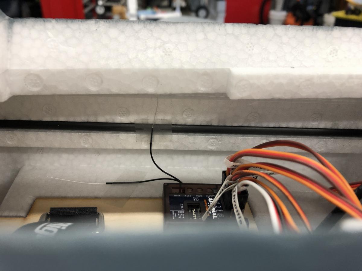

                                    Would a few of you guys mind posting pictures of how you have your RX installed and antenna placement?

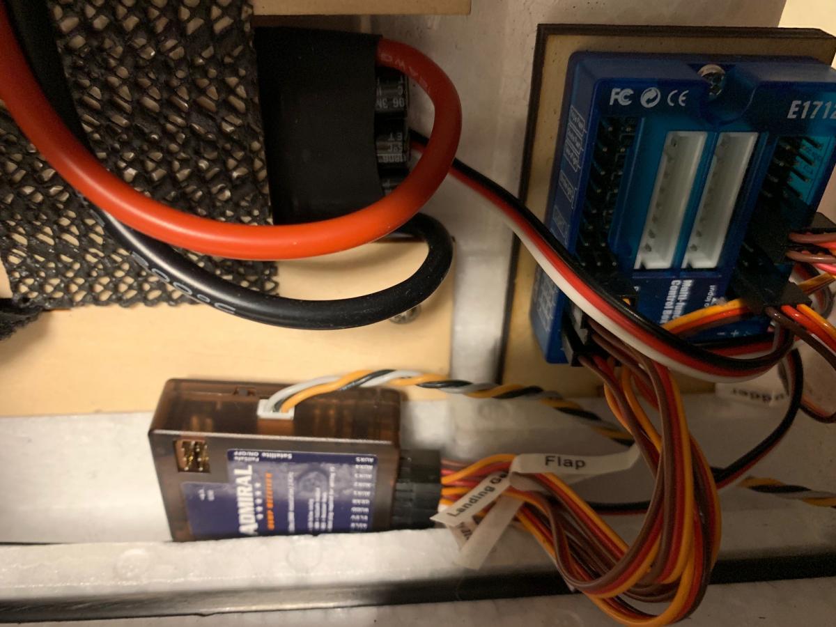

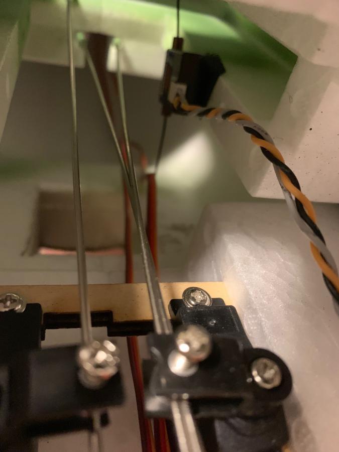

                                        These are shots of my Rx and Sat inside the Corsair. Both are mounted with Velcro and removable

                                          V, Your Corsair is gorgeous, sir. :)I really like the RAF livery and you've done an outstanding job on her. :Cool: Bravo Zulu. Best, LB
