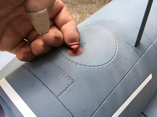

    I gotta thank whomever came up with the red fuel filler cap. I found an old fuel filter from my wife's old focus. I used a small pipe cutter and an old rc plane axle to replicate a fuel cap that doubles as an handle to remove the battery cover.
    This tiny little mod does give more character to the plane.

        Most grateful to MrSmoothie.
        By the way if you are looking for a touch up paint these two are almost perfect match. I have gone a little overboard with weathering towards the nose which needed a re-paint. I have put some comparison photos where you can see the match

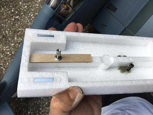

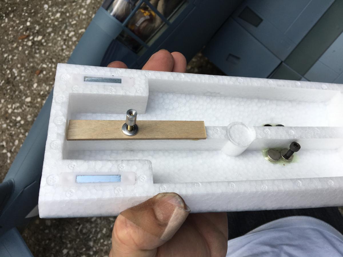

            In case anybody missed my hatch lift / gas cap, here are the pics again. A lot of ways to skin this cat, but the idea is here. I wrote some details about mine in an earlier post. Speaking of "posts", I've since discovered aluminum post screws at the local hardware (also on amazon.com) which are perfect for making these. I've since used them on other models, even if they don't have gas caps -- I kind of hate the dreaded "tape pull". You can also see where I epoxied some magnets inside the hatch to hold the four wing attach screws, as I can only fit this model into my Maxima wing-off. I only use hex-head socket screws (much easier to put in or out when you have to do it every trip to the field), and have switched to longer screws than those supplied with the model, once I realized how few threads were actually making it into the imbedded nuts.

              That's pretty slick.

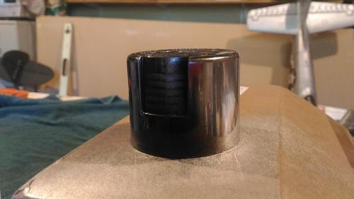

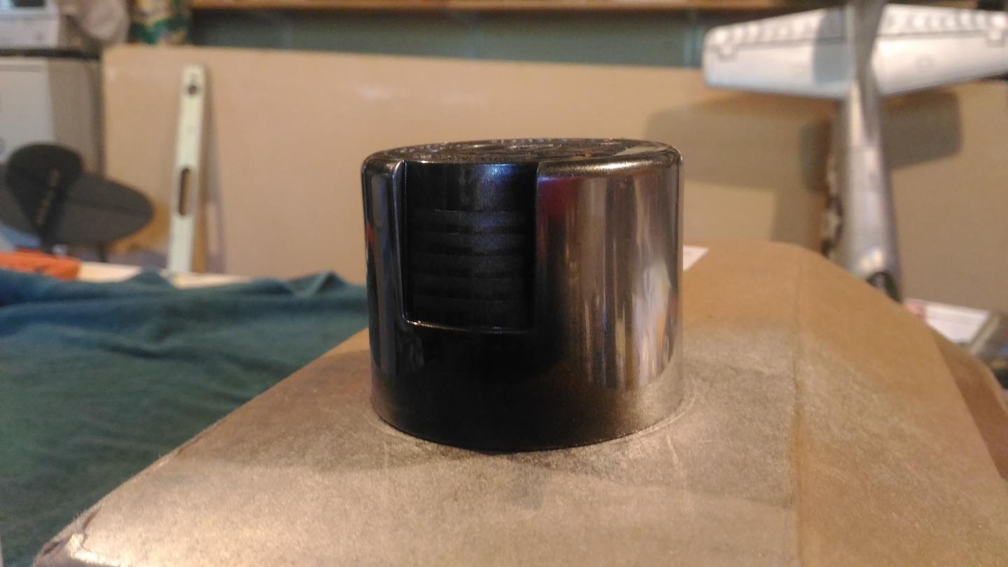

                Here's a shot of the prop hub with the new paint.
                DWL, What paint is it, Hmm? I really like the prop hub, detail. Best, LB

                    #2609
                    Hey Elbee, it's a paint called Alclad II that is used to resemble chrome on plastic models. To get the chrome look you have to make the surface super smooth and put a coat or two of gloss black as a base.. I used something like Krylon but it wouldn't stick to the stock silver very well so I wound up sanding it down to the white plastic base. I didn't go for super smooth as I was looking more for the polished aluminum look rather than chrome. After the black is looking pretty glossy, like Darth Vader's helmet, and dry you mist on a layer or two of the Alclad. It's pretty amazing to watch it flash off and get polished looking right before your eyes.:Cool: I didn't want to run it through my airbrush so used the rattle can version. Here's a couple of pics. I did a test on the gloss black paint cap to see what it looked like. Click image for larger version  Name:	P_20190428_090349.jpg Views:	2 Size:	83.9 KB ID:	192418Click image for larger version  Name:	P_20190428_090120.jpg Views:	1 Size:	81.7 KB ID:	192419 The alclad is on the right of picture. Hope that helps. It's allot of trouble for one little hub but I totally associate the shiny hub with the Corsair and Hellcat and many other radials. The stock silver paint just wasn't doing it for me. I found out about this from a buddy in Connecticut that built a Yellow P-38 for me. He used this process on the nose of his P-38 to resemble polished aluminum. Apparently in Europe, the gun noses of the bare metal P-38s were polished to resemble recon noses to fool the enemy. It was often mistaken by modelers and artists looking at black and white pictures from the war for the color blue hence allot of blue P-38 noses.;)
                          DWL, Thank you. Very impressive work.:) I have read about the Alclad paints here and online, you've convinced me to give it a go. Did you add a gloss clear final coat? Best, LB
                                  Thanks LB. I did not use a gloss clear final coat. I don't think it was recommended.
                                      Hey LB, I would just add one more piece of advice to you and anyone else trying this system. I wound up doing the paint scheme a second time after realizing, to my horror,:Scared:that I left a fingerprint on one side of the hub. Wound up stripping the hub back down to plastic and starting over. So, I've learned to go heavy on the gloss black base ie. several coats and light ie.one coat on the Allclad. The more coats you add, the less polished it looks. The gloss black base is critical to the polished look.
