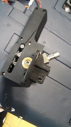

        #4604
        Anything new on the weak gear problem?
        Did my taxi test with my new Corsair, on freshly cut grass and both retract cases cracked. I knew there was a problem in this area of the Corsair, but never thought it was this easy to break the gear. Hope a solution is found soon as am a little gun shy at this point.

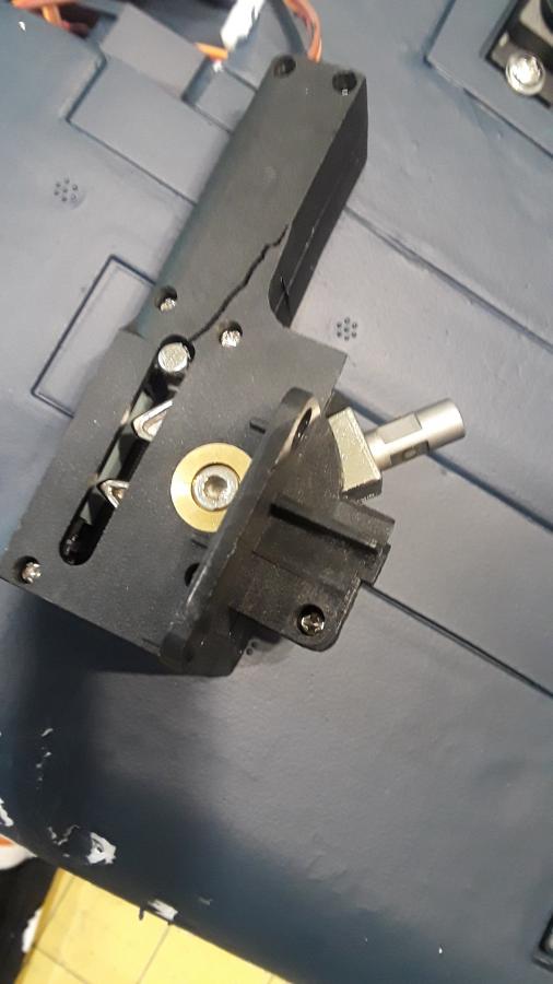

                        #4612
                        Here's were mine failed, both sides.

                          #4613
                          Originally posted by heartlandaccents
                          That's happened to several of my retracts on different planes, mostly very heavy, fast landing planes. It takes a very hard impact with something to do that. I highly doubt that just taxiing on bumpy grass will do it.
