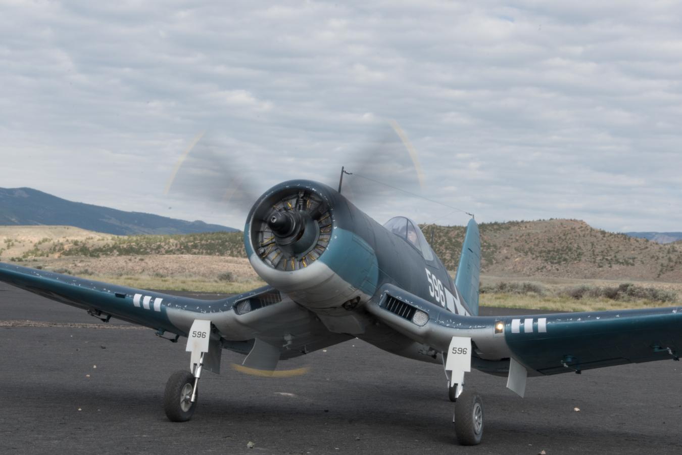

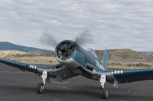

              Question on wheel bearings for Robart 3.5" wheels on Flightline Click image for larger version  Name:	_CAM0961adjusted.jpg Views:	0 Size:	96.0 KB ID:	319787 Corsair?
              Hi All: I converted from the stock Flightline wheels/tires to the 3.5" Robarts on my Corsair. Since the Robarts don't come with a wheel bearing that fits the stock axle on this plane, I used a 1/4" OD aluminum tube that slides on nicely over the axle and is fairly tight on the wheel hole. The problem is, since the aluminum is so soft a metal, it gets loose after flying it for a while, and the wheel wobbles left and right on the axle, making for some control issues, especially on landing rollout.
              I tried using brass tubes in place of the aluminum ones, but they are slightly larger and for me are too loose to use on this airplane.
              I'm curious what anyone who is using the 3.5" Robarts has come up with for a suitable, durable wheel bearing for this plane?

                I think I mentioned to you before, but I use the 3.5" Robarts and all I did was slightly enlarge the plastic bushings that come with their wheels using a series of drills until it was the correct I.D. I know that sounds funky, but I've got well over 100 flights and the bushing and wheels are still wobble free. Also used some silicone grease on the axel to keep it turning freely. Give it a try, nothing to loose. You do have to be careful in handling the bushing for drilling and I actually held in "by hand" instead of in a vise or pliers because that ruined the O.D. of the bushing.
                          Hi Hugh: I'm giving it a go using your technique of slightly increasing the diameter of the bushings so that they'll fit on the Corsair's axles. It wasn't without a little "bloodletting" as my thumb and finger slipped on the very sharp edges of the drill bit that I was using to hollow out the bushings by hand, but I survived.
                          Right now, I have the plane back together, I like what I'm seeing with the solidness of the axle and wheel, no more wobbling side to side as I had before using the homemade bushings. They are still pretty tight on the axle, the plane rolls smoothly when I push it with my hand, but I suspect that will undoubtedly loosen up some as I get some flights in. I'm going to do some taxi tests later today in front of my house to see how it does. Thanks again for your tip, I am encouraged so far!

                            I PM'd Hugh on this this morning, but I'd thought I'd finish my entries regarding the main wheel bushings for anyone contemplating substituting the 3.5" Robarts for the OEM main wheels that come with the kit.
                            I did two flights this morning with Hugh's suggestion and his idea that he used on his plane, that is, of carefully reaming out slightly the largest size plastic wheel bushings that come with the Robart wheels so that they'll fit smoothly on the axles on the main gear of the Corsair. I was able to do this using a couple of drill bits and gently twisting them by hand into the plastic bearings until I could fit them onto the landing gear axles.
                            I didn't want to ream out the bushings too much so that they might have a bit of wobble on the axle, but they turn fine when I roll the plane on the ground by hand, and worked very well on the takeoff and landing rolls on my two flights this morning. The fit now is very tight and no wobble back and forth on the axle that the aluminum tube bushing had that I had made up during these tests.
                            I'll continue to monitor and test these new plastic bushings, but I think if you can ream them out so that they'll fit on the axles ok, you'll be in business. Some silicon grease is helpful, too. Besides the functionality of the slightly modified Robart bearings, I also like the look of the plane better with wheels that are closer to scale for this aircraft.
