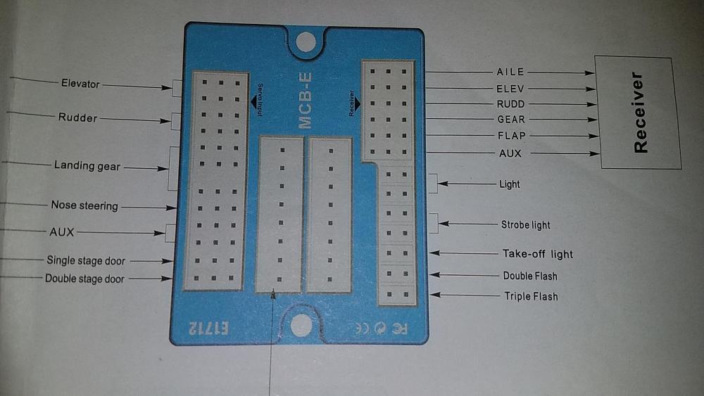

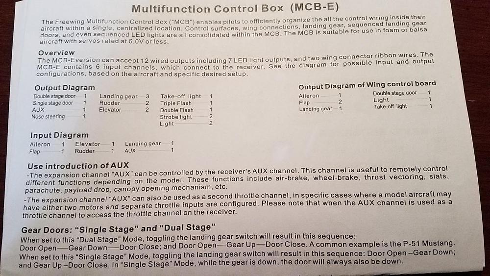

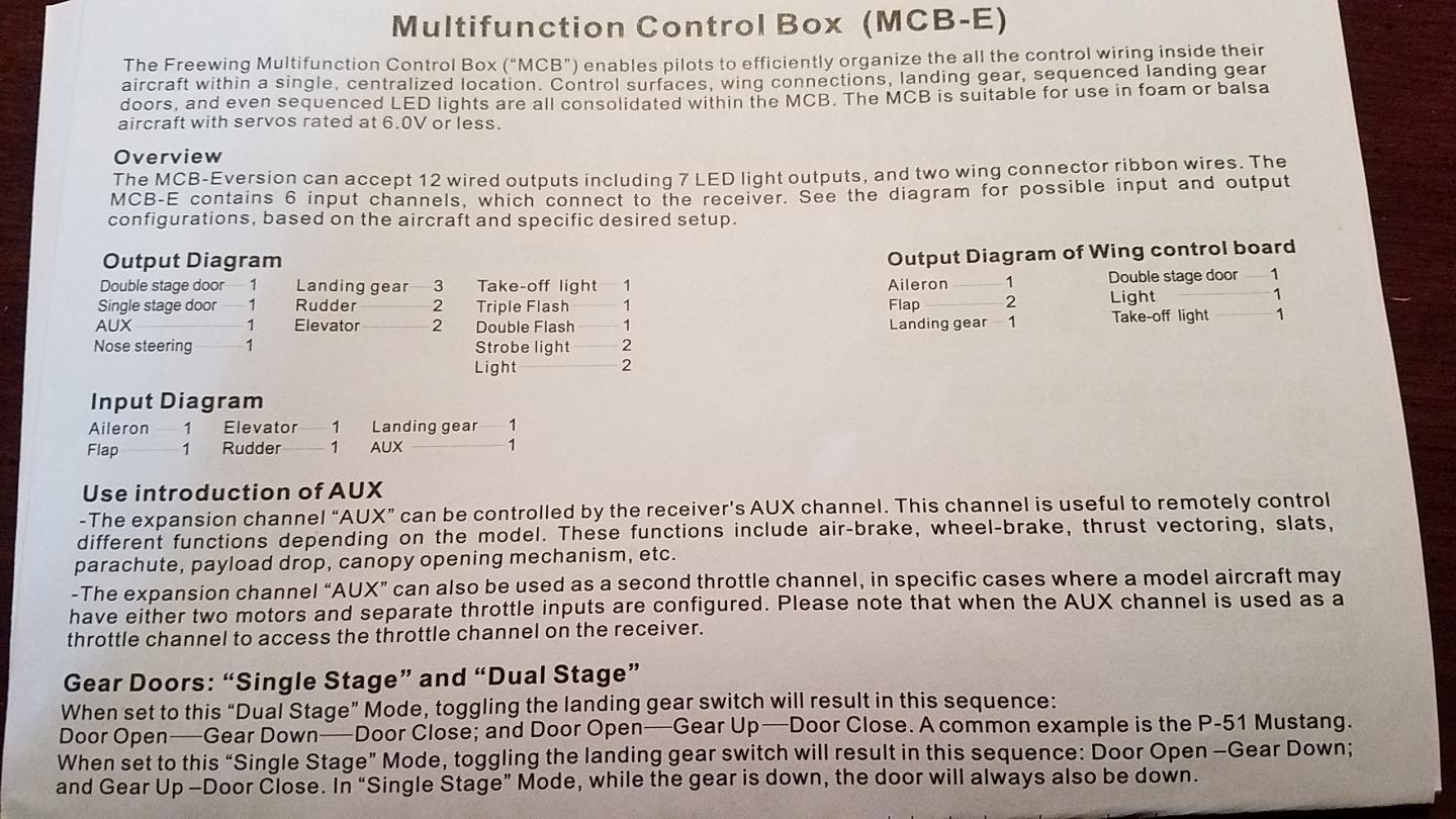

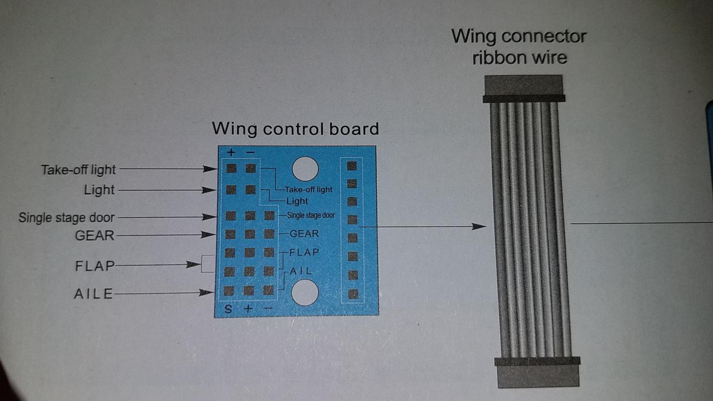

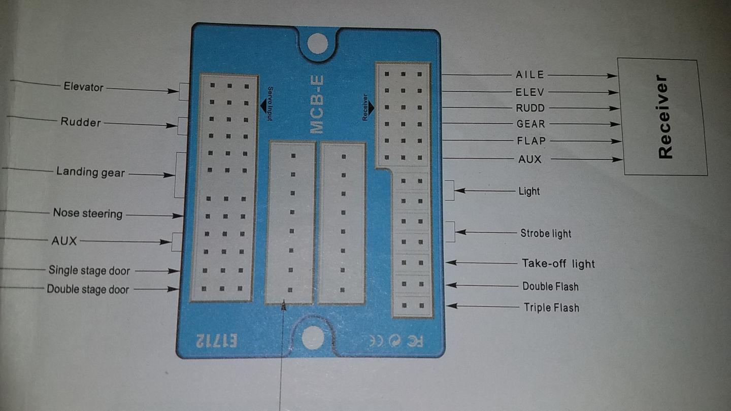

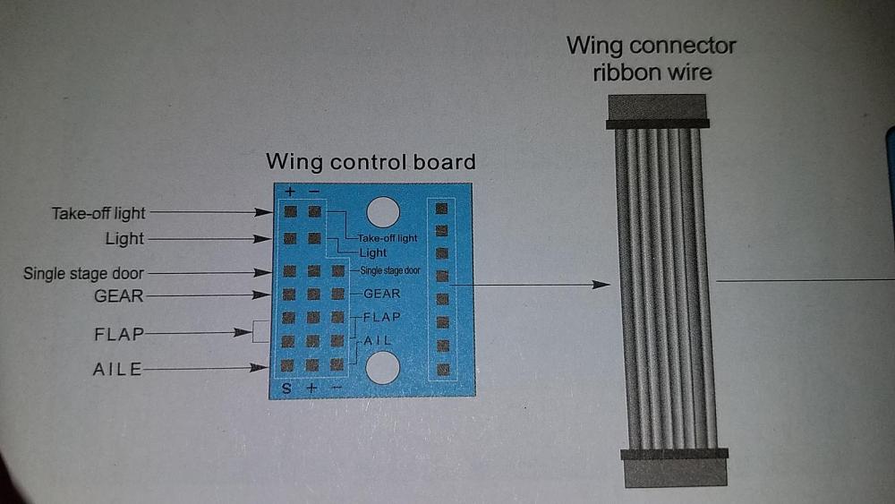

        Does anyone have that single sheet that shows the wiring diagram from the bus to the receiver and respective servos? Someone told me it came with the instruction manual but I don't recall getting one. I need to rewire it after doing some repairs and mods. Thanks!

          Is this what you're looking for? If so, I accept donations, preferably ones that FLY!

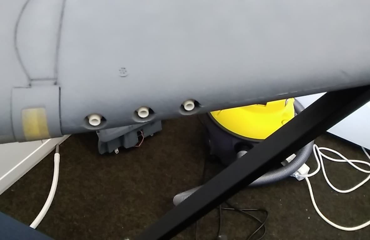

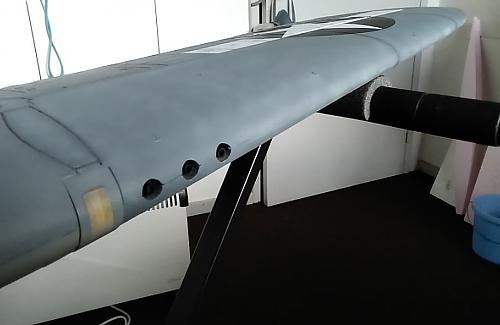

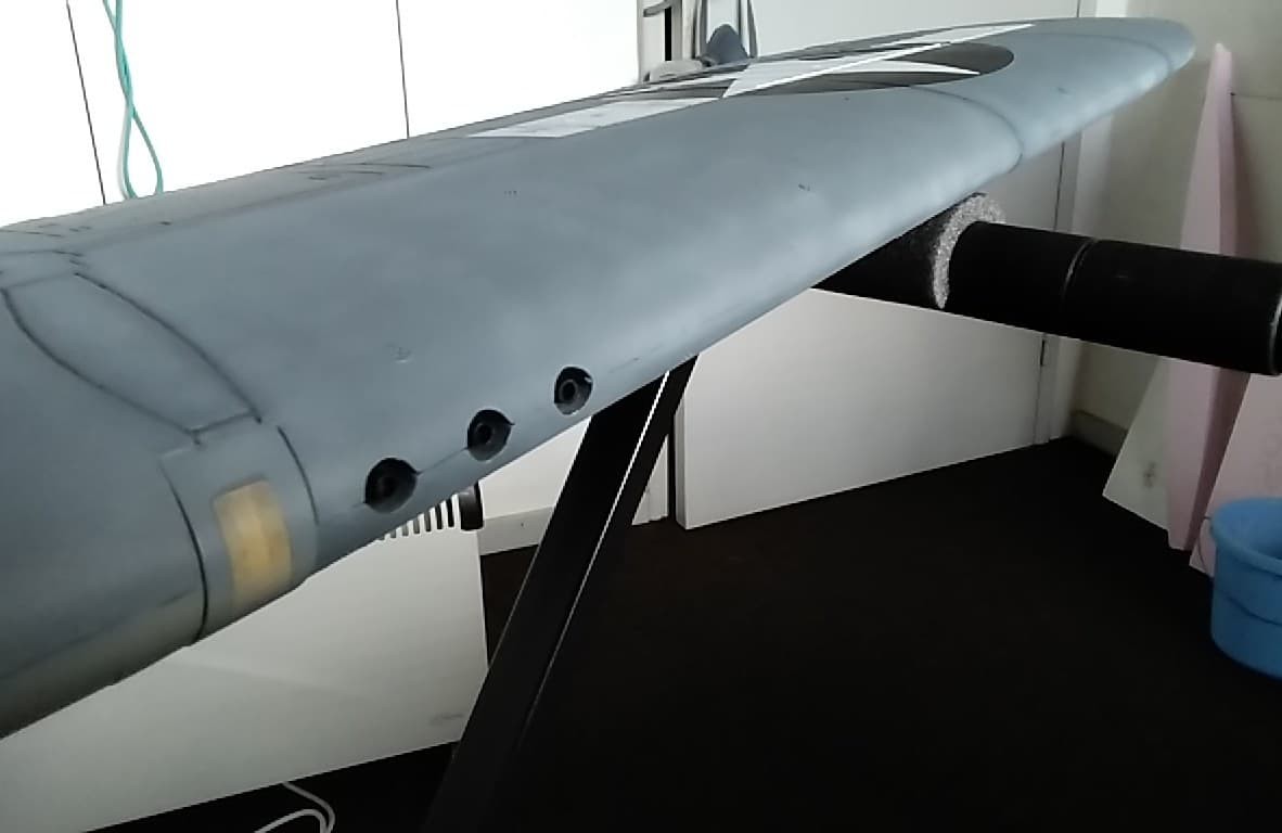

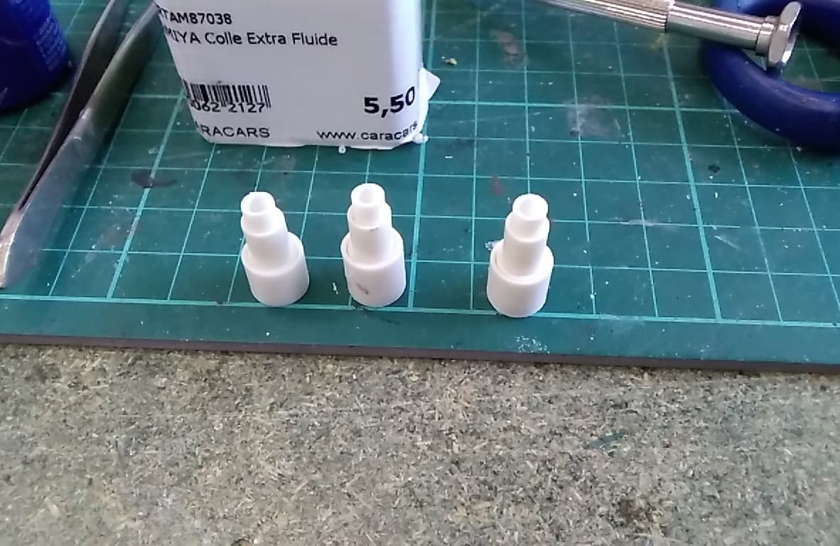

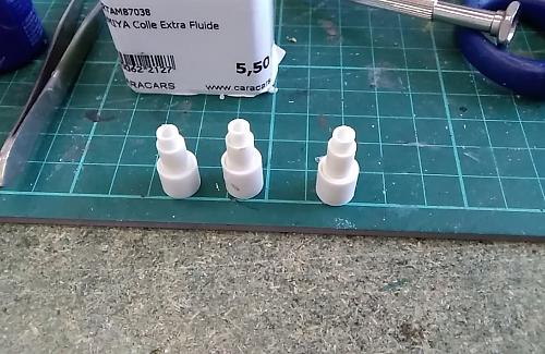

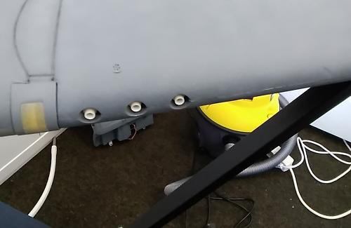

                        The wing guns were another addition, made from plasticard tubes, they fill the empty looking holes in the wings..

                            The wing guns were another addition, made from plasticard tubes, they fill the empty looking holes in the wings.Didier
                            DD, Great addition and nicely done, I might add. Bravo Zulu, Sir. Best, LB
