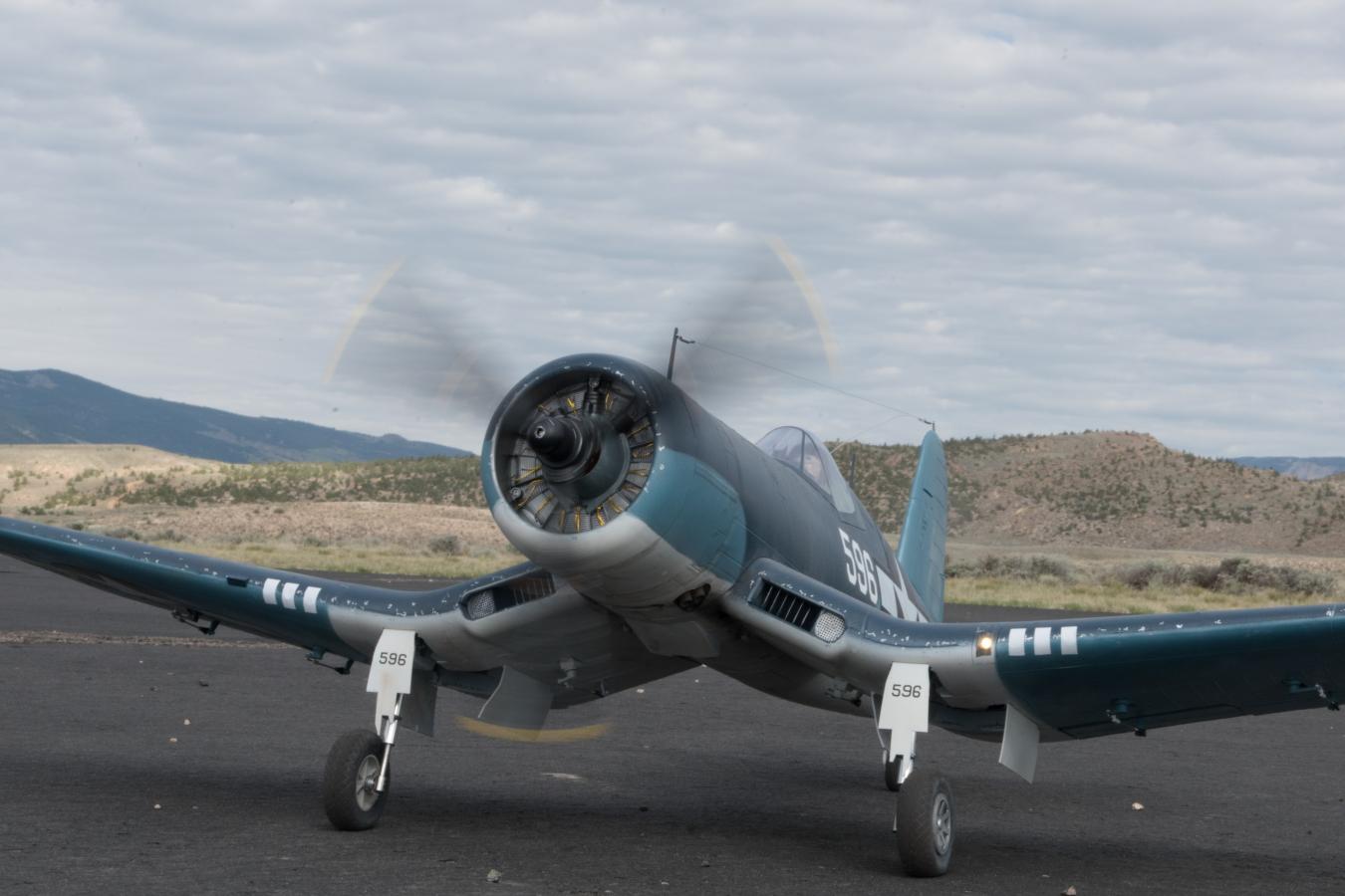

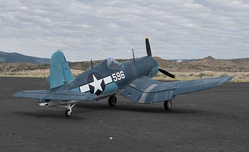

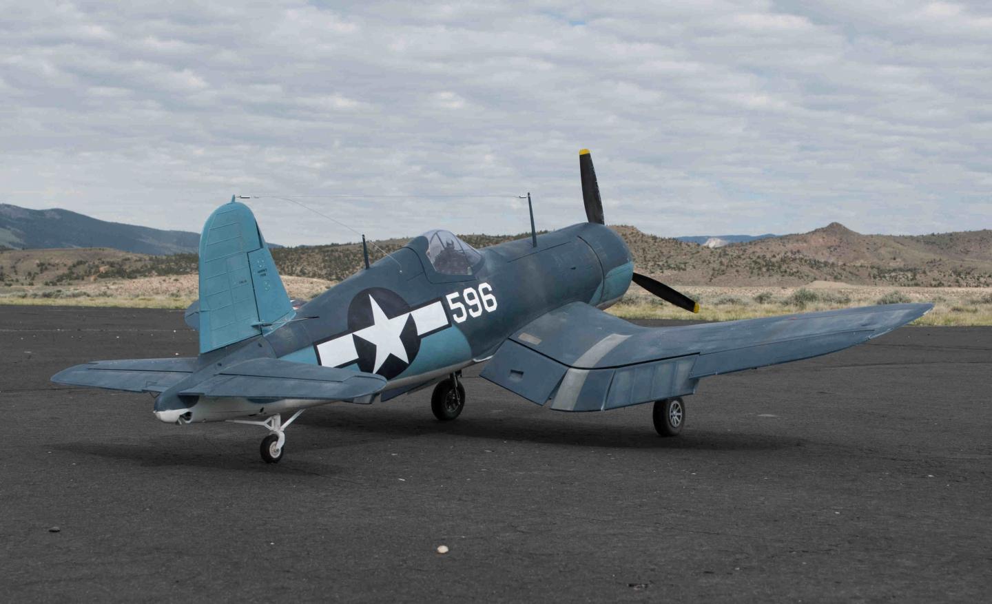

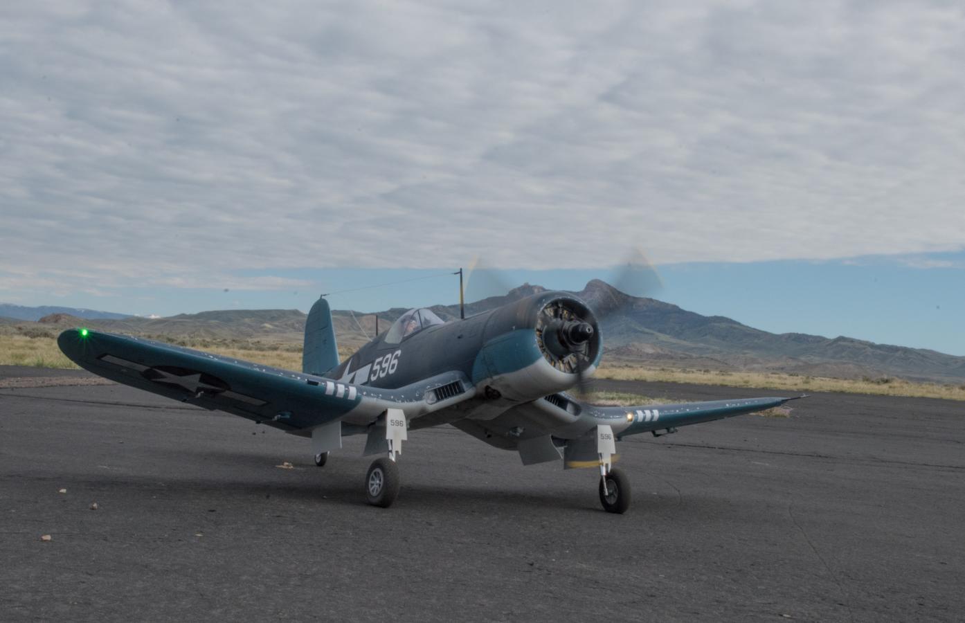

    • Click image for larger version  Name:	_CAM0969adjusted.jpg Views:	0 Size:	120.3 KB ID:	314863 Got several flights this morning on the Corsair. The Robart wheels are great, I was able to get the takeoffs near where I want them, still need a little work. Landings are about where I want them. The airplane "sticks" the landing when in a two-point, tail low attitude with full flaps. Rollout is straight and predictable with light winds.
      The only problem I had, and it IS a problem, is that I have something going on with the right wing outer flap servo. When flying, when I went to the takeoff flap position, the airplane made a sudden roll to the right, I went back to flaps up and it went away. So, here's what I'm seeing after several flights: the flaps go up and down normally on the ground, no problems. But in the air, the right outboard flap servo is not moving much at all, and because it is mechanically linked with a little plastic rod to the inboard flap set, it causes them not to deploy as they should. When I reboot on the ground, all work perfectly again. I'm thinking a faulty outboard flap servo on the right wing. Any other guesses? I'm going to contact Motion for assistance.
      I'll attach a few pics I took with a better camera this morning. Still a great plane, just gotta figure out what the deal is with these flaps.
      davegee Click image for larger version  Name:	_CAM0961adjusted.jpg Views:	0 Size:	94.4 KB ID:	314862

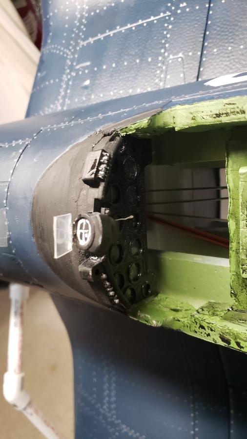

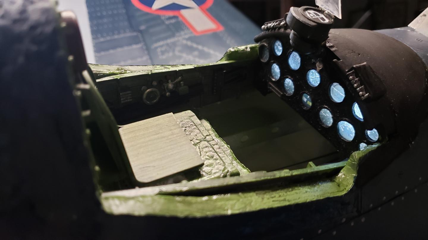

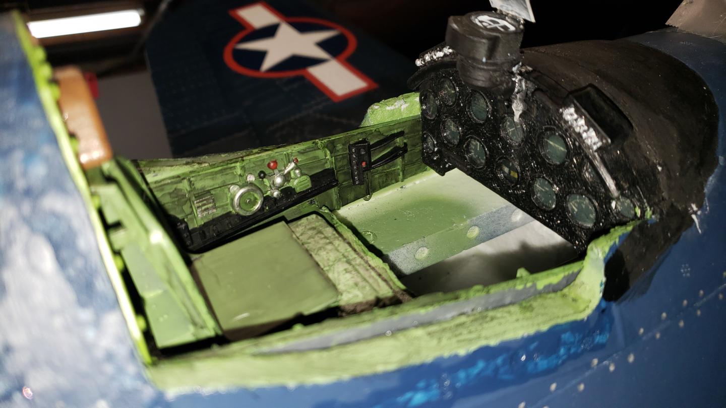

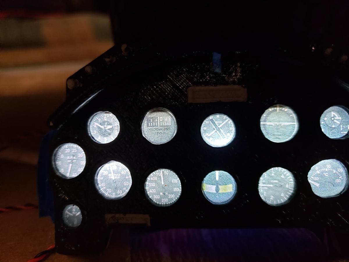

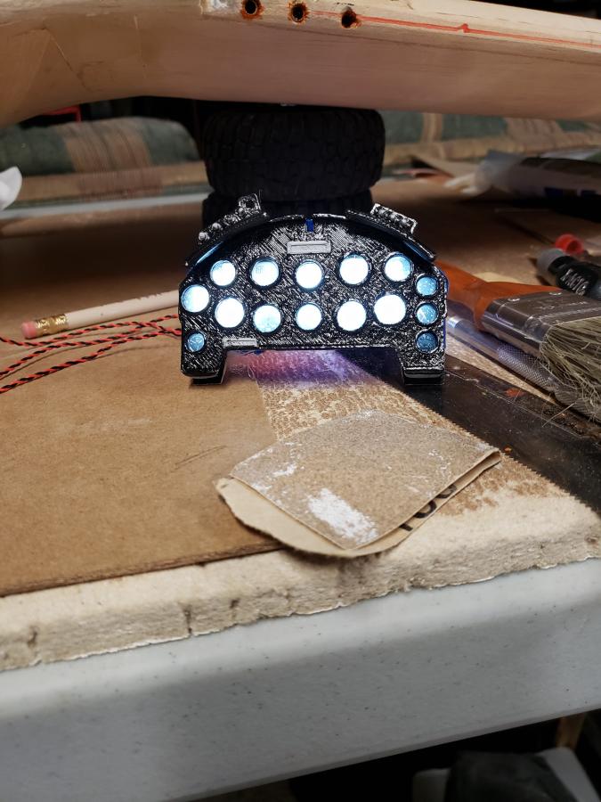

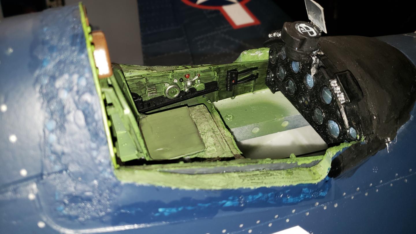

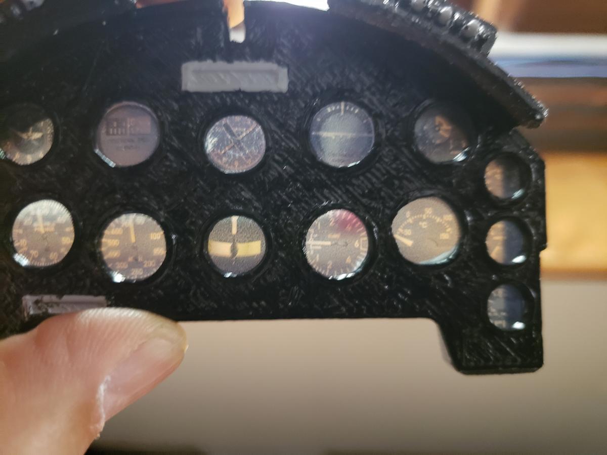

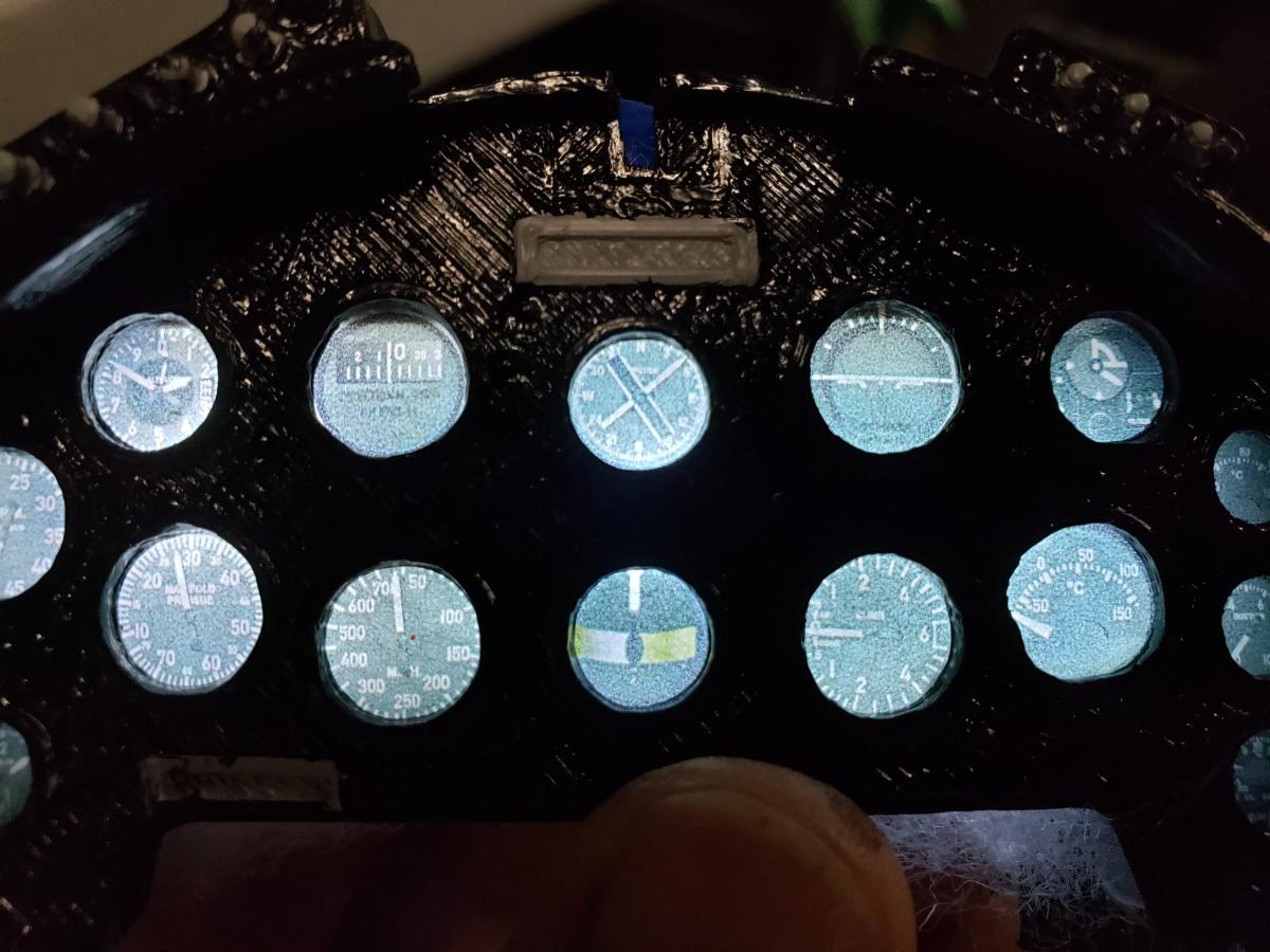

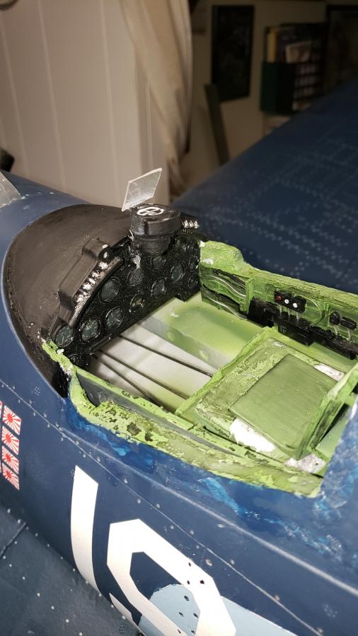

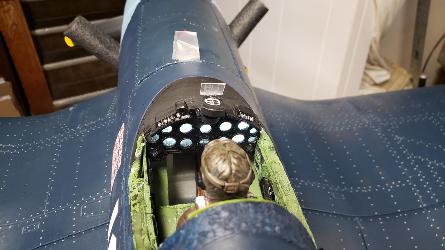

                    • This is Corsair_Smitty from You Tube. Here is the finished cockpit for my Flightline Corsair. It features a lighted dashboard. The entire cockpit is from the Motion RC 3D printer files that are available on the Flightline Corsair page. The dashboard also features the gun site and reflective glass. The dashboard is lighted up by 3, 5mm white LEDs. I had started with the Red LEDs, however they were not bright enough to light everything up and would have required a total of 5 LEDs. The pilot is the original one that came with the plane, just weathered a little.
                      How it was done:
                      I had Callie create the gauges (Graphics) on a clear background from the set that she currently makes, specifically for doing this. I built a back plate and sides from balsa for the dashboard. The sides are 1/4 inch between the dashboard and the backing plate. I have 3 hole drilled into the balsa for the LEDs. I also filled the in between space with a "poly fill" like is used when making stuffed animals. By putting the "poly fill" in between the LEDs and and the dashboard it reduces and eliminates the "hot spots" that the LEDs normally produce. The "poly fill" acts like a defuser to spread the light over a broader area. Since the LEDs don't get hot there is no fear of burning. I soldered the LEDs to the wiring and put connectors on the ends that fix right into the connectors on the blue Motion RC Blue colored E1712 controller, which the Corsair comes with.
                      • Originally posted by CorsairPilot17 View Post
                        This is Corsair_Smitty from You Tube. Here is the finished cockpit for my Flightline Corsair. It features a lighted dashboard. The entire cockpit is from the Motion RC 3D printer files that are available on the Flightline Corsair page. The dashboard also features the gun site and reflective glass..
                        CP aka CS, Great work. Bravo Zulu, Sir. Best, LB
                          This is Corsair_Smitty from You Tube. Here is the finished cockpit for my Flightline Corsair. It features a lighted dashboard. .
                          I was so impressed with the lighted instrument panel and the cockpit, I almost overlooked another one of your outstanding details: The Rivets! Can't wait to see the whole enchilada!
                              How it was done:
                              Nicely done! I really like the integral back lighting of those instruments. Congrats to Callie too, on making very believable period gauges similar to what planes of that era used. Cockpit really looks nice.
                              • Cool touch with the lighted gauges!

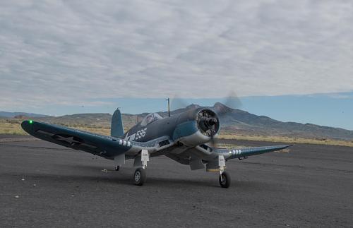

                                        A shot of my Corsair out for another mission the other day! Click image for larger version
