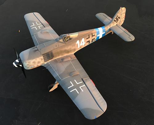

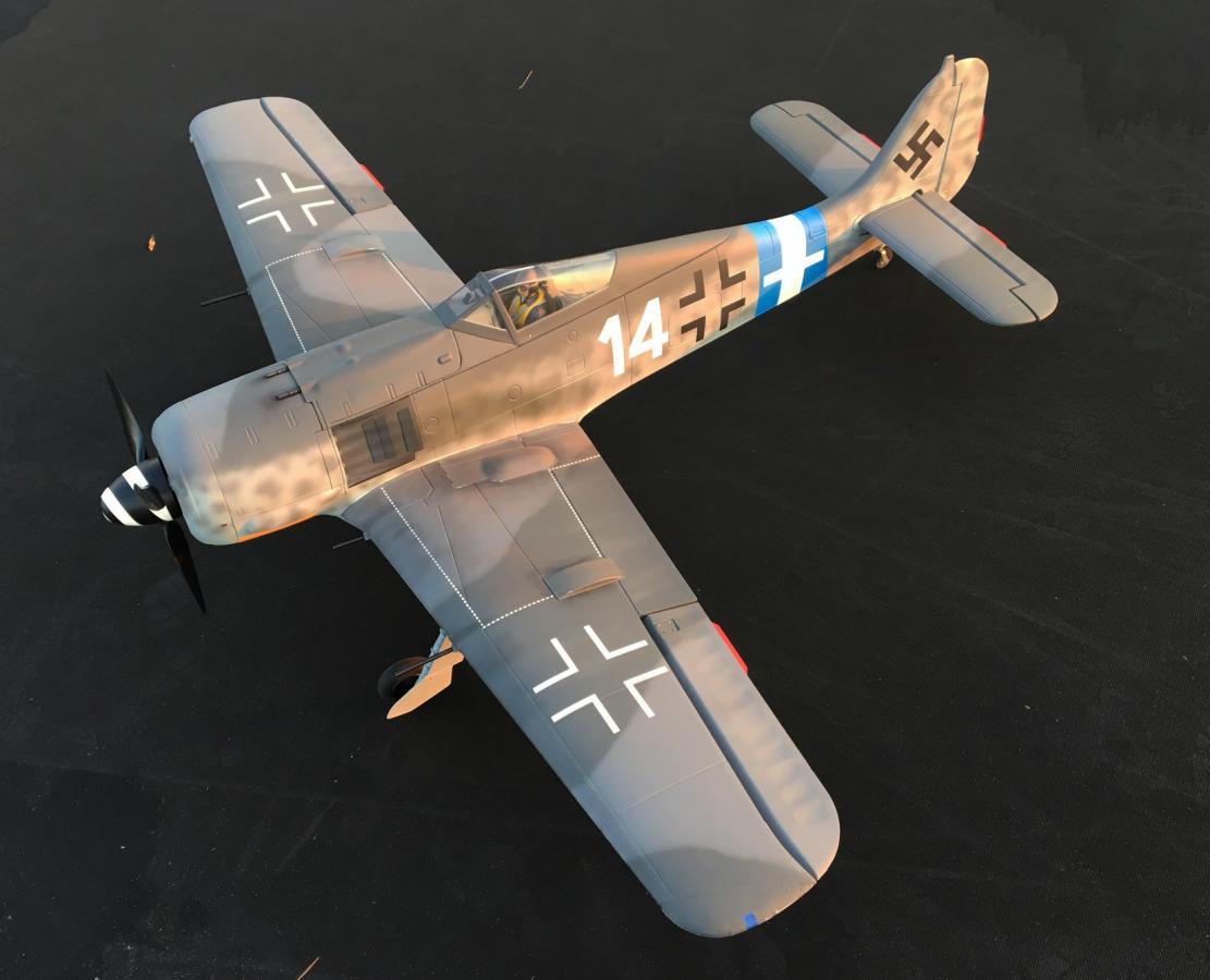

                            I'm just thinking of the amount of paint (number of coats) will be needed to paint the white over the dark blue.
                            I agree with Alpha -- paint over the stock paint. The weight savings of removing the blue paint would be insignificant vs. ending up with a less than smooth foam finish. I'm a big believer in using BEHR flat latex. I haven't tried white over anything dark that I can think of, but I've been surprised that light grays actually have better coverage opacity than dark colors like olive drab (I'm sure it has to do with the "base" used for each). You might be surprised that two coats of white flat latex will probably be enough, especially if you brush on one coat of Kilz2 latex primer first -- I usually brush on the first coat of color as well, using a decent quality artist brush between 1 and 1.5" wide, which gets into the panel line grooves. Using a fine brush pretty much eliminates brush marks. Then I roll the second coat on with one of those fine foam white rollers used for trim. The results are terrific and consistent. Best of all, these BEHR samples are super cheap!
                            If you want a soft edge between colors (when rolling or brushing), just use an airbrush with some paint thinned with Windex and go along the hard line. On the Corsair, not only was the line between dark and medium blue "soft", but also the line between the white and medium blue under the wing panels (ref: Dana Bell's new books on the Corsair).
                            Another great tip is to take advantage of all the work done by the plastic modeling community. If you do some research including looking at plastic model decal color scheme images online, eventually you'll find references to "FS" (Federal Standard) number equivalents for the various shades of blue. If you take these numbers to Home Depot, have the paint person go to "Competitor Colors" in their computer, and you sill see FS595 Federal Standards as one of the categories. Plug in the number and you will get a great match without having to guess and settle for something sort of OK.
                            The photo shows my latest housepaint special -- a 1600mm FW-190. This is painted to the German RLM color standards -- I found FS595 color equivalent charts online (thanks again plastic modelers) and had the paint mixed exactly -- no more guessing at the particular gray, or light blue!
                            If you don't want to try white latex, a good alternative is plain old Testors flat white in the small spray can. This is reliable stuff and covers super well. One can would probably do it (the outer wing panels are med. blue on the bottom), but I'd probably grab two cans to be safe.
                            Note, I didn't invent any of the above!!! Taking advantage of what others have figured out and doing what I can from there.

                                "I agree with Alpha -- paint over the stock paint. The weight savings of removing the blue paint would be insignificant vs. ending up with a less than smooth foam finish. I'm a big believer in using BEHR flat latex. I haven't tried white over anything dark that I can think of, but I've been surprised that light grays actually have better coverage opacity than dark colors like olive drab (I'm sure it has to do with the "base" used for each). You might be surprised that two coats of white flat latex will probably be enough, especially if you brush on one coat of Kilz2 latex primer first -- I usually brush on the first coat of color as well, using a decent quality artist brush between 1 and 1.5" wide, which gets into the panel line grooves. Using a fine brush pretty much eliminates brush marks. Then I roll the second coat on with one of those fine foam white rollers used for trim. The results are terrific and consistent. Best of all, these BEHR samples are super cheap!
                                If you want a soft edge between colors (when rolling or brushing), just use an airbrush with some paint thinned with Windex and go along the hard line. On the Corsair, not only was the line between dark and medium blue "soft", but also the line between the white and medium blue under the wing panels (ref: Dana Bell's new books on the Corsair."
                                Thank You MrSmoothie and Alpha.
                                Instead of removing the paint ( as I had originally planned) I plan to just hit the areas I'm going lighter with a coat or three of primer.
                                I will also be doing some weathering, wear and grime, etc.
                                Started to print the cockpit as well.
                                As much as I just want to fly this beauty It's just not a Corsair unless it's been through hell.
                                I'll try to take some pictures as I go.
