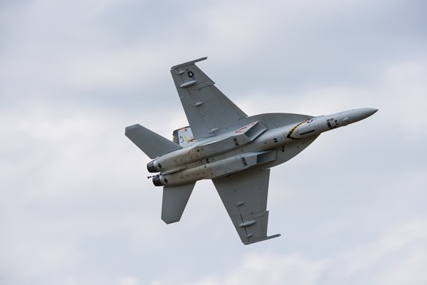

              Hi Tom: I have been experimenting with chalks and powders to do the weathering. This way, you really can't screw it up if you goof; it can be wiped off for the most part with a damp cloth to try it again. I concentrated on areas that would get the most abuse from the elements and weather in the South Pacific sun. Since the Corsair had several panels on the wings and elsewhere that were fabric, those would fade rapidly as would the top surfaces of the entire aircraft. My cardinal rule though, for me and when I occasionally judge at shows is don't overdo it! Some otherwise great looking planes look terrible (IMHO) like they went through an Earth reentry like an Apollo spacecraft! Convincing use of weathering in places where it is expected, usually working from a photo or even some old color videos sometimes is helpful. Having said all that, the Corsairs, especially fighting with the Marines in the Solomon Islands and elsewhere really started to look sun-damaged and a bit ratty, due to the extreme conditions that they were operating under. So, if you look at some pics from then, if you use some grey chalks, browns and tans here and there and brush them on in places where they should show the most weathering, you'll do well. I continue to add weathering here and there, eventually I'll set it with some clear flat spray to keep it from coming off when I'm satisfied I've done all I care to. I even rub some grey chalk on the wheels and tires to weather those, too.
              I recently helped a friend with his Skymaster 1/6 scale F/A-18F Super Hornet with some weathering on the bottom of the fuse. I used the same powders that I got from a train hobby shop, browns, tans, greys, as well as at a art supply shop where they sell artists' chalks that can be rubbed against sandpaper and then applied with a brush, dry. This photo of the Super Bug I took last weekend in a coordinated move from the pilot to me on the camera to do a sharp bank in front of me so I could get a good shot of the bottom of the aircraft to see how it looked. We are pretty satisfied with the appearance right now, and might hit it with a light clear flat spray to hold it for awhile. We used actual photos of real planes as a guide while applying these details.
              If I can help answer any questions for anyone interested in playing with this medium of chalks, please let me know, I'm happy to help.
