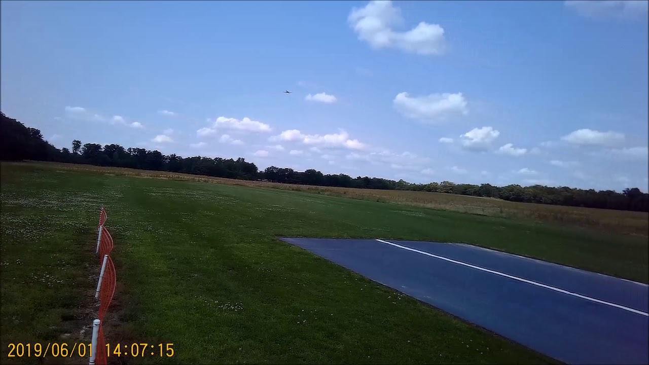

              • FINALLY GOT MY MAIDEN DONE!
                had this plane for ever it seams. initially hooked it up to the blue box and all was good w the world. then as the months rolled by the reports of blue box failures started to come in. having a little experience with circuit boards and a flight line spit I made sure the E,A, and R all went directly to the rx. when the rain broke I took it to the field and the flaps would not work. to test that I did not have the tx setup wrong I plugged the flap plug from the blue box to the aileron rx and still nothing. so back home I ran the flaps directly to the rx and looked up which lg cycler I needed incase that part of the blue box failed also.
                this Friday the wind was supposed to be 9mph down the runway. so after work I got there and noticed one of the flap linkages was flopping in the breeze. I did not have keepers on the "L" bend snap on thing. IDK if they came with the plane and I did not use them but it is what it is. I had the aileron linage in the furthest hole of the servo out put arm and the furthest hole of the ailerons and the servo EPA at 150 both sides. flaps were also on furthest out holes on both servo put and flap control horn. elevator and rudder servo output arms were from factory, E was all the way out on the control horn and rudder was factory.
                I pushed a old (that means heavy) 6s5a20c battery as far forward as it would go. I placed my backup battery between the drive battery and rx. handed the destructions book and tx to my son and he and the others at the field verified the cg and directions of all the control surfaces.
                with no more excuses it was time to put it in the air. I tuned on the tx, then back up battery and waited for the radio to come to life then plugged the drive battery and the motor chimed to let me know it was online. taxied out to the center of the runway and turned into the wind. did a quick check of all surfaces again and advanced the throttle. it tracked straight, with no rudder input from me. it needed hardly any trim then to the maneuvers my first loop was terrible with several sharp elevator deviations. I was afraid I had forgotten expo (that's what happens when months go by between build and maiden) after I landed I checked and the expo was on but on the low setting 30% and I left it there. continuing with the maiden, I rolled to both sides and it rolled faster to the left, barrel roles were nice and big and the heading was the same in and out.
                time to prep for landing, I slowed the plane and added flap as it slowed with no retracts. once all the flap was in I tried to find a throttle setting that it would fly level at it was a couple of clicks above off then put the flaps down and the nose came down a bit, perfect no roll! I flew it down and dirty directly in front of me and put the gear up and the flaps with the same throttle setting, the nose dropped a little and it was able to sustain a 15-20 degree down line. I pulled up and it came up for an instant than continued in the same down line.
                flew for a minute or two more and set up for a landing we were getting a blast of gust right into our face so as always start set up in a gust and it was gone by the time I was on final I had to carry some extra throttle to penetrate the wind down the runway which had picked up and touched down about 40ft before where I was standing nice and gentile on the mains, pulled the flaps up then killed the throttle and it still had not reached me before it was stopped.
                I flew it once more that day and realized that the jerking in the first loop was probably me getting used to the plane cause I never saw it again.
                while back in the pits after the first flight I noticed another flap link dangling, again after flight two, and again when I took it out of the car at home. it now has keepers on them.
                conclusion: I moved the aileron linkage into hole 3 of 5 on the servo output arm cause the maiden ailerons I had were little light, still faster to the left roll. the second flight had even more wind with no problems. it dose all the maneuvers with ease, with plenty of power for big loops.

                                    Nice job on your maiden! that's a beautiful flying field.
                                    Try using the flaps for landing, your bird will slow down very well and its very easy to handle, just keep some throttle on because they do add a lot of drag.
