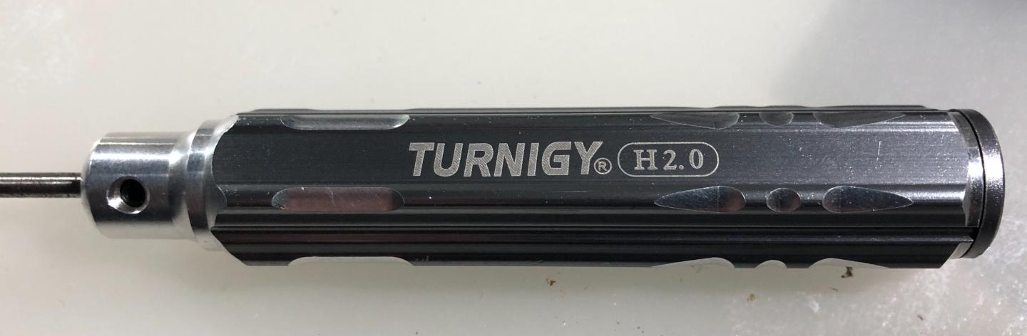

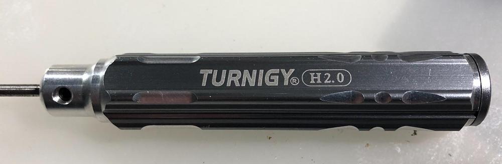

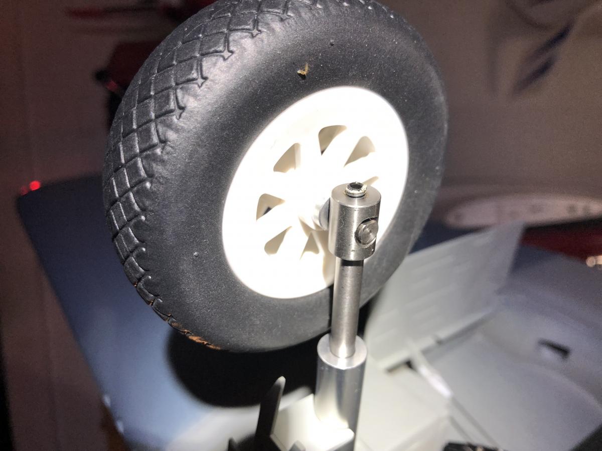

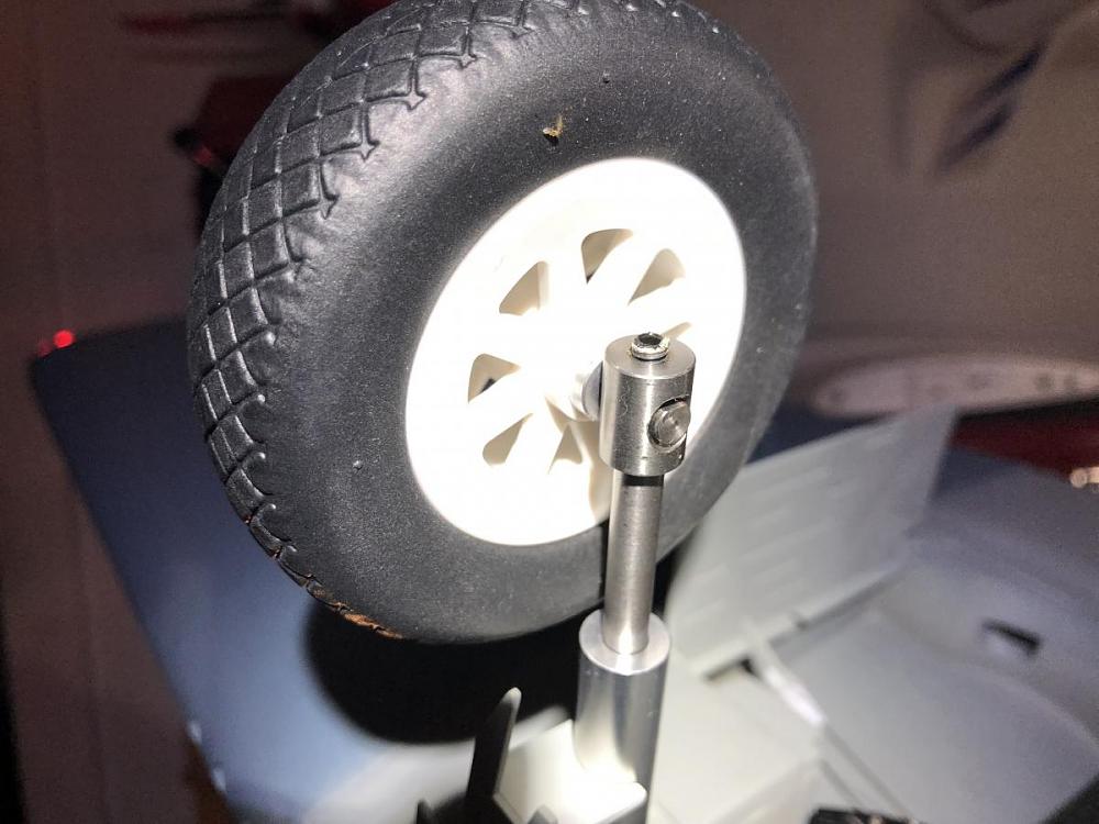

    They are locktited in. But not with permanent red. Both of mine made a cracking sound as they broke loose but came out fine. Heat from a soldering gun also defeats really stuck locktited fasteners as heat breaks locktite down. I did not need to heat these but heat is the only answer on red permanent locktite. The cheap Turnigy drivers have never failed me either.

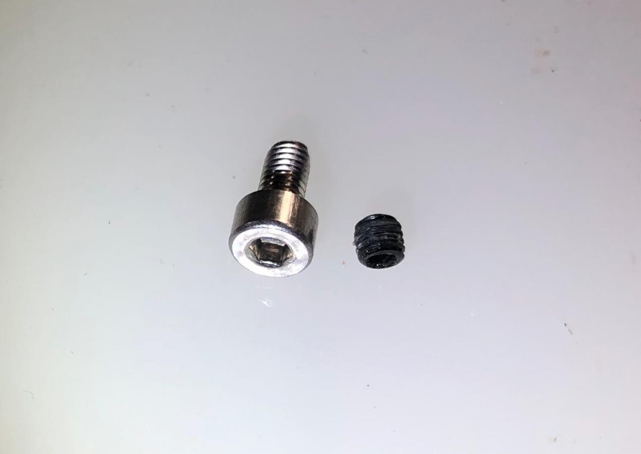

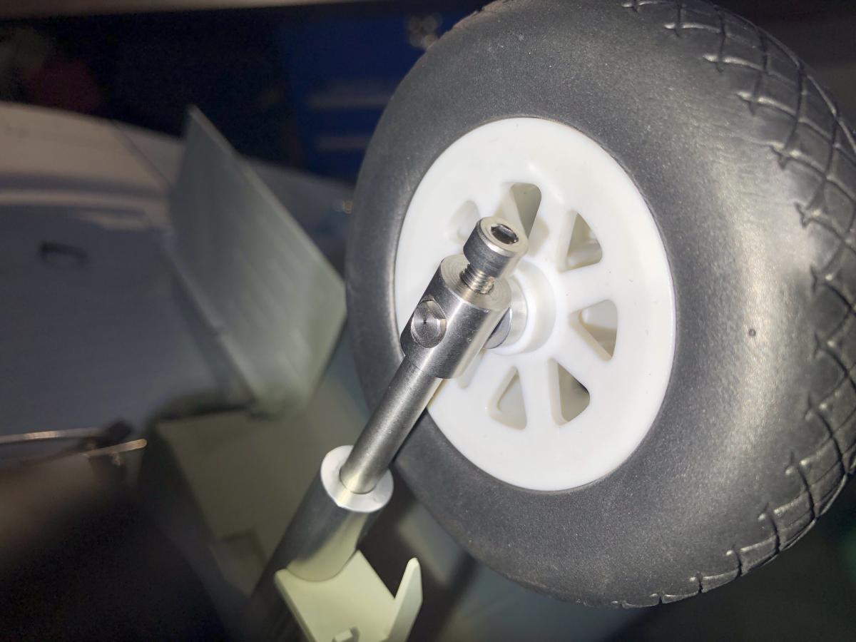

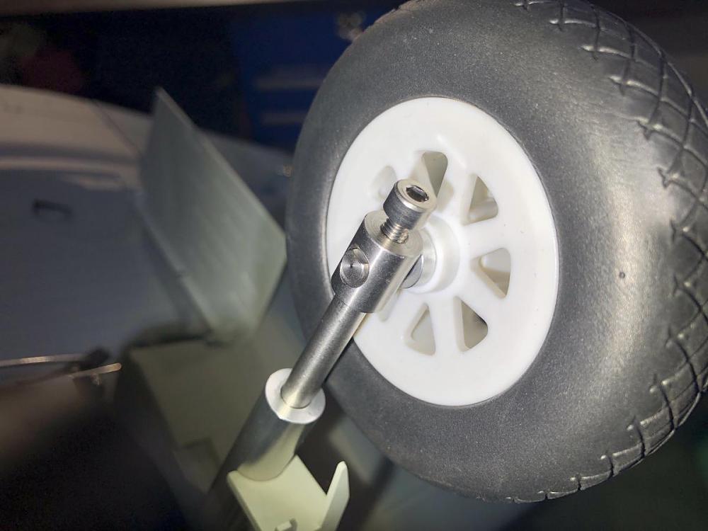

        I’ve had so much trouble with retracts and grub screws over the years I’ve adopted an upgrade. I remove the grubscrew and special cut an actual fastener to replace it, that way all the threads in the specific hole are utilized and a larger driver can be used to tighten or remove the new faster.

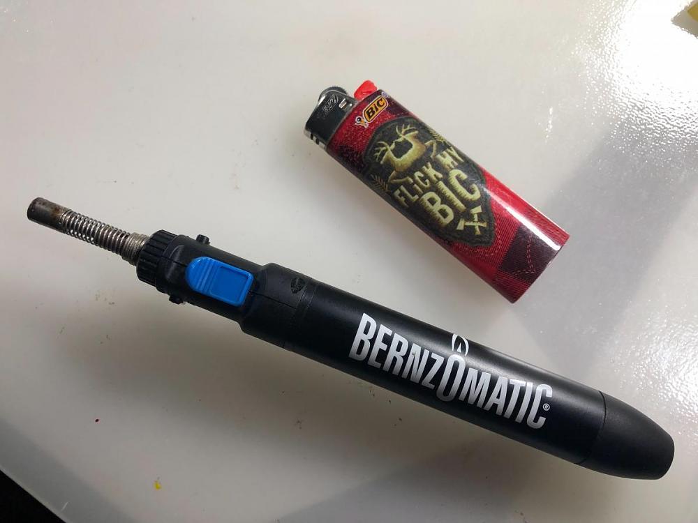

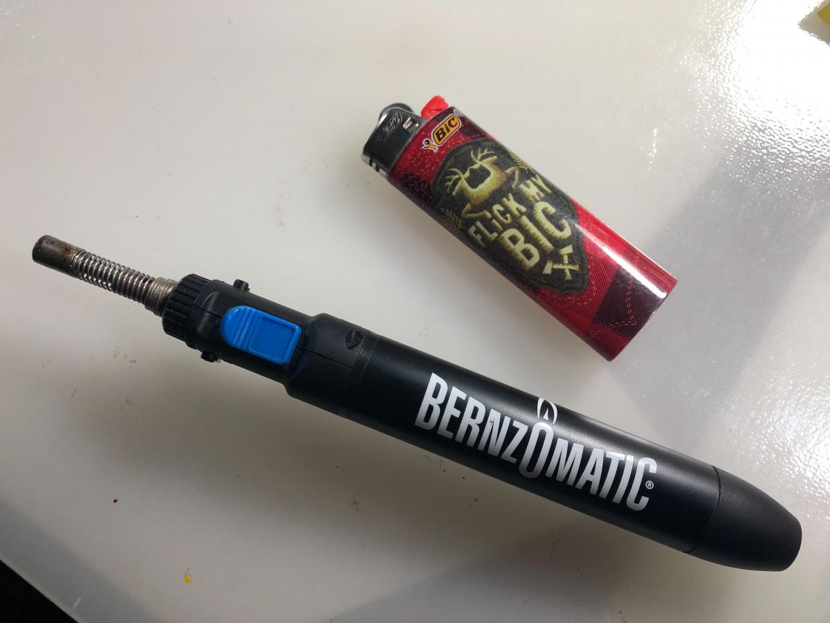

            I take a Bic lighter to it for 10 - 15 seconds before trying to turn it.
            By no means bashing your Bic lighter but if you haven’t invested in one of these mini torches, they are worth their weight in gold.!. :Cool:

              Grover, you can use the tip of a soldering iron to heat the set (grub) screw and then the locktite should let go without stripping the screw. That way you don't have open flames to set your whiskey on fire!!! LOL

                Nice! I have something like that to light my BBQ. The thing is, those Bics can be found at gas station mini marts for less than a buck and that's in Canadian dollar. LOL But Hardway is right. I run the risk of lighting my hooch on fire.

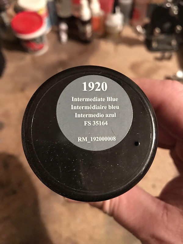

                                    Alright Brad I felt guilty for being too lazy to tell you the color I am painting "The Queen" so here it is...Model Master spray enamel...

                                      Thanks for digging it out but I was actually referring to the navy blue you painted the canopy about half way back in the Queen thread. You mentioned at the time that it was a tamiya navy blue. Just wondering if that navy blue is a good match for the mrc navy blue on the bubble canopy Corsair. I can go back to the thread and find it if you like...you posted pictures of the newly painted canopy at the time and somebody else mentioned it would be better to paint the inside first?
